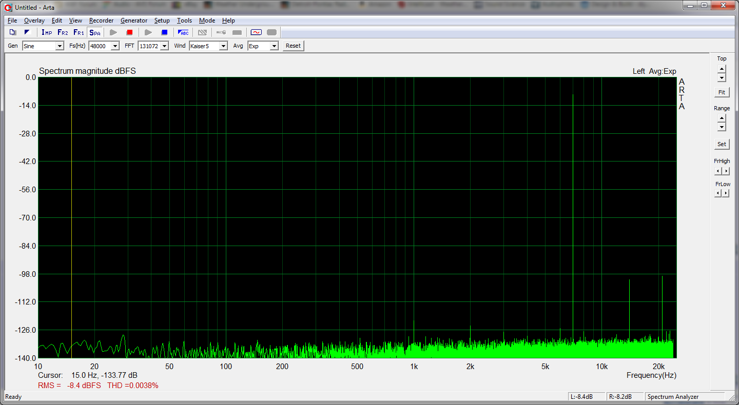

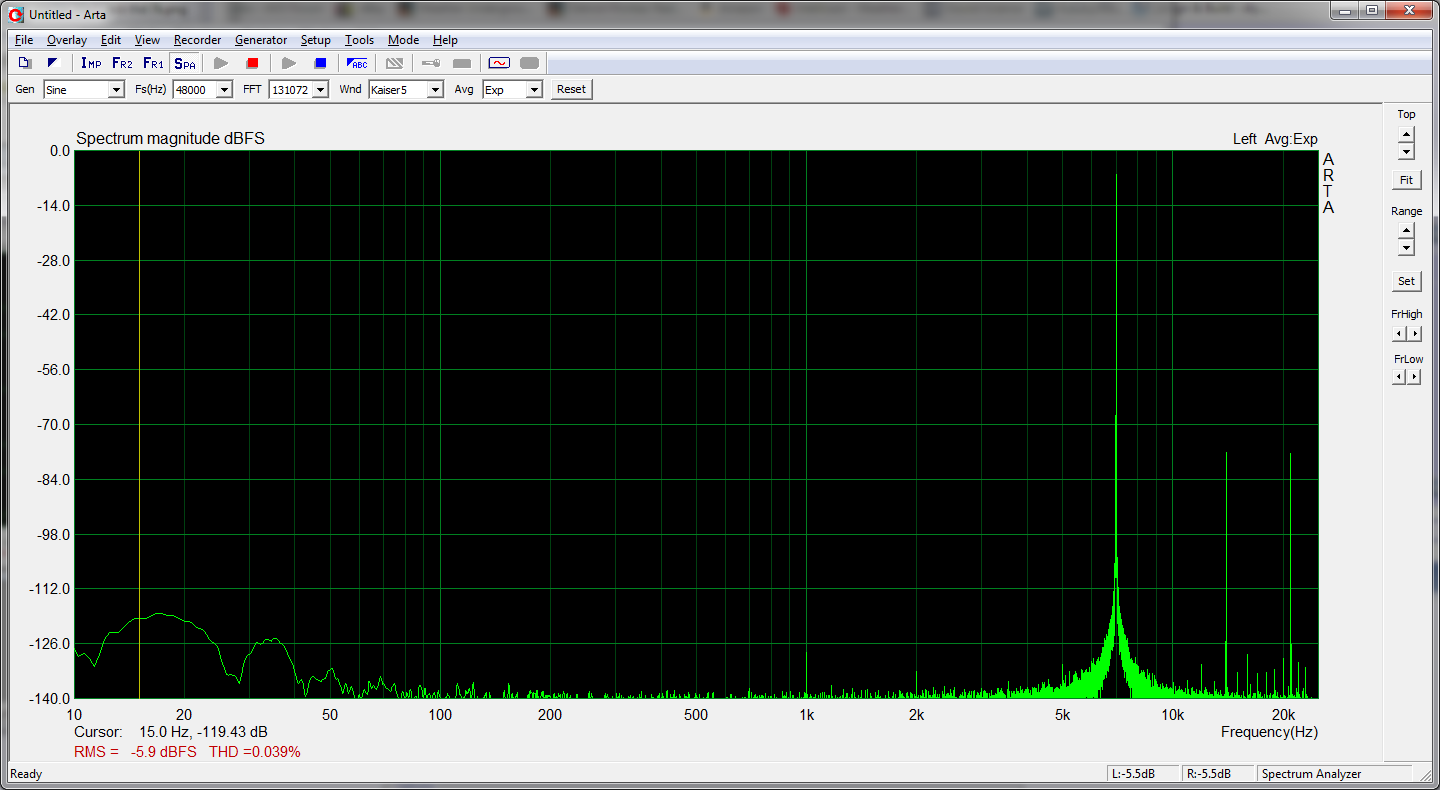

And for Anders, here is the 10100Hz FFT.

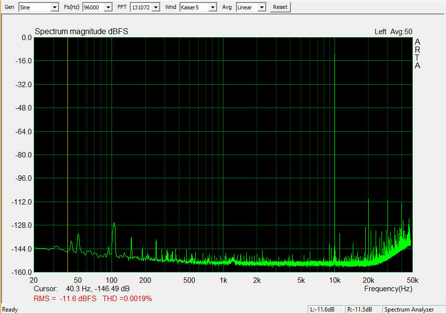

Nice. Do you hit 'sweet spot' at -6 dB?

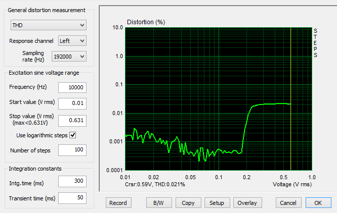

My Asus Xonar D2 performs best south of -12 dB , see below.
Loopback 10 kHz -12,5 dB
Loopback 10 kHz -11,5 dB
Some 'grass' could possibly be reduced. I have no view of the hardware since I remote this PC over VPN.
Distortion vs level shows the big jump...

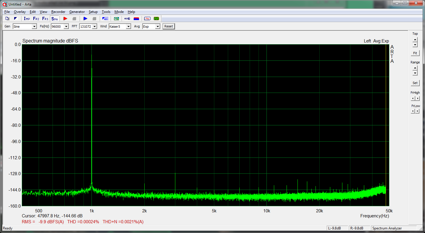

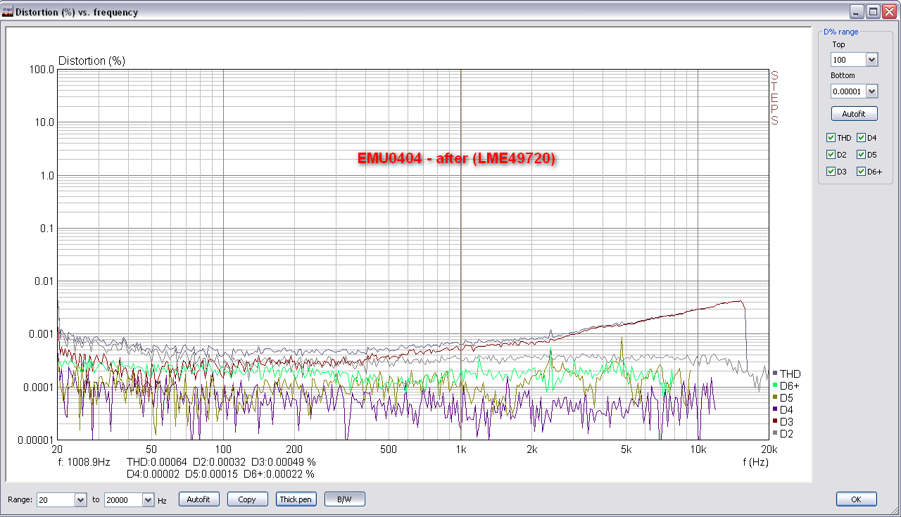

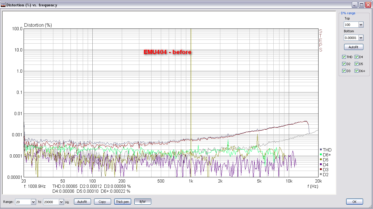

Here is my EMU0404 results, after changing 4 OPA left inputs + 4 OPA outputs with LME49720.
My emu has some pots modifies as described at posts 21 & 26.
There is no any significant improvement btw before and after to THD.
There is D2 improvement upper 5KHz that demonstrates much less distortion than default opa's.
Additional, a -3dB step capture was done.

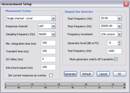

At the least, setup of step is including.

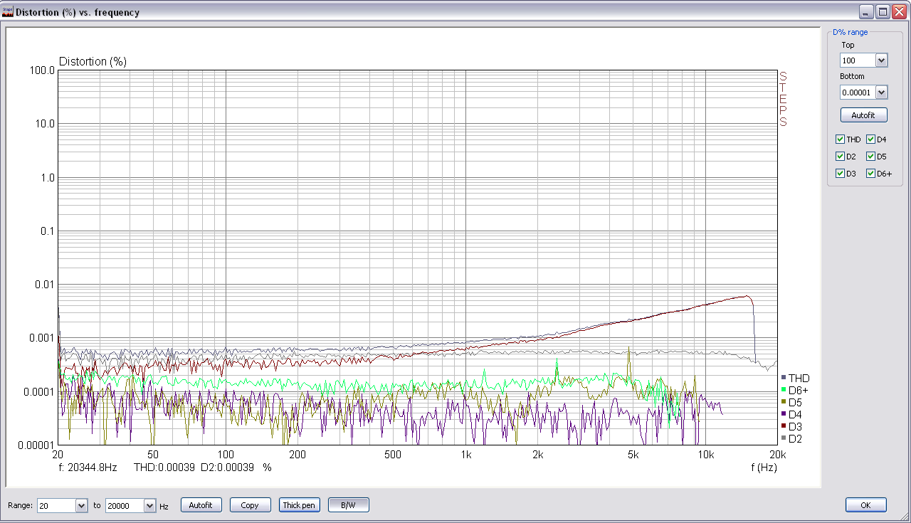

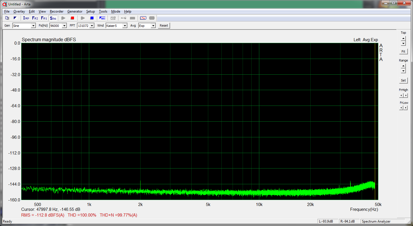

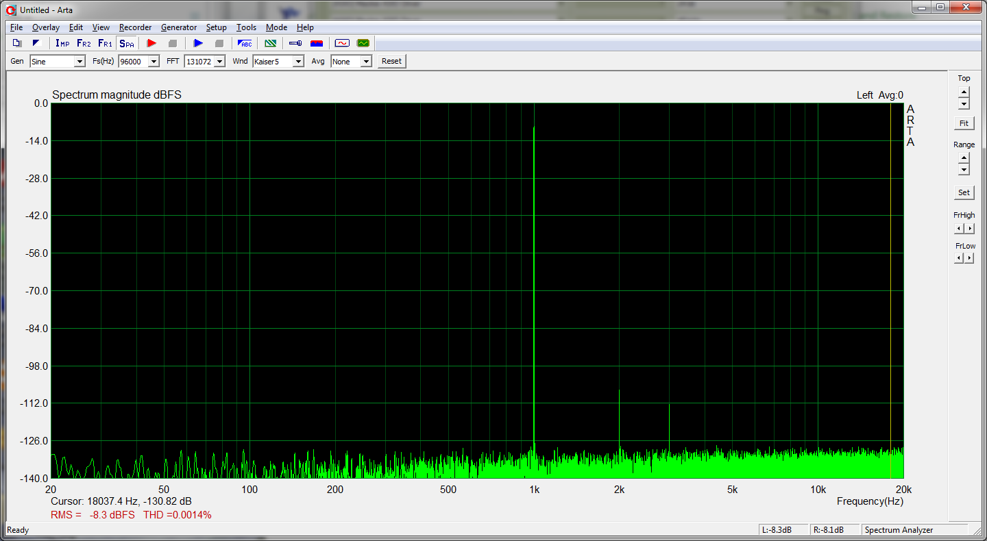

Quick look at hybrid (2 different audio interfaces, one play, one record) approaches.
First off, the noise measurements for the ADC side of the M-Audio AP24192 with 50 ohm termination resistors are better than one might expect from loop-back measurements:
Then I tried using an inexpensive interface I saw on eBay as the DAC
"Finished SU0 XMOS U8 DAC+ AK4490 top asynchronous USB decoder with headphone"
Finished SU0 Xmos U8 DAC AK4490 Top Asynchronous USB Decoder with Headphone | eBay
in combination with the ADC in the AP24192:
Vout from the DAC was 1.29 volts
Lemon, I suppose this is with unbalanced input. With balanced input, the measurements are bound to be better. Looking at the schematic, it is not difficult to see why this should be so. U15b performs a re-balancing act on unbalanced signals. In case of a true balanced signal with both signal lines swinging equally in opposite directions, U15 only functions as a DC reference.
In case of a unbalanced signal, U15B provides positive feedback to U9 so that the cold signal line becomes active and inverted. This ensures that whatever the input, balanced, unbalanced or balanced with one cold signal line, the ADC always get a balanced signal.
It works very well, but it comes at a penalty - most notably a rise in distortion with increasing frequency.
To make the EMU 0404 a better tool for unbalanced inputs, taking out U9 and U15b might work. It then has to be replaced by the kind of setup used in the 0404 to make a balanced output out of an unbalanced one, just a straight out inverting opamp. I haven't tried it and I doubt I will because of the time involved to do so.

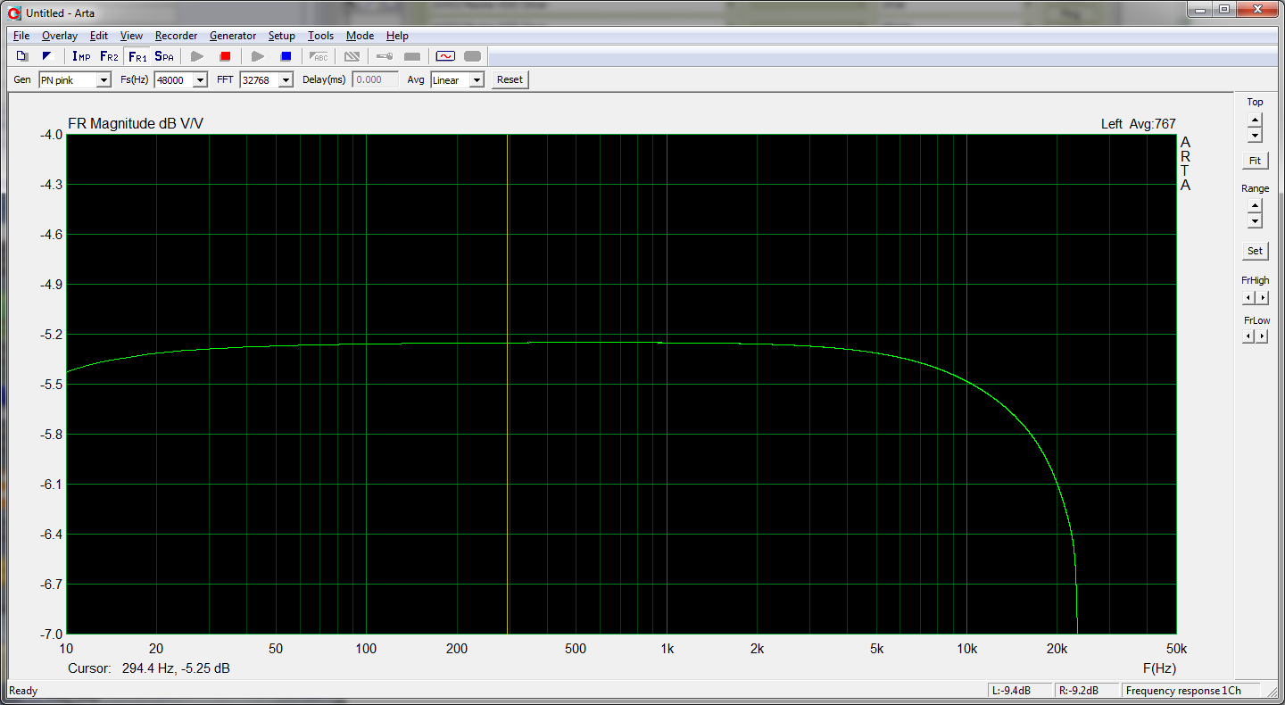

The price is right, but the product is a bit artificially limited. It comes wired with the poorest option for good frequency response and this can't be changed without a soldering iron.
It starts clipping just below 1.5 volts RMS output. The headphone jack has an approximate 50 ohm source impedance which is high.
The output op amp is a JRC 5532 (socketed).
The out-of-box 44 KHz sampling FR is about 5 dB down @ 20 KHz. Some of the other numerous FR options are far flatter and could be made user selectable with some simple cheap internal jumpers.
