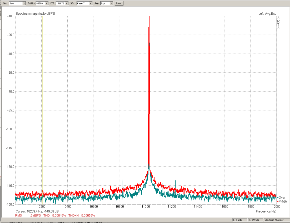

When I want to look at jitter, I do this, as in the comparison here. It is between the EMU1616m card in feedback, versus the AK4490 piloted by the Jlsounds+Crystek oscillators board. Red trace is the EMU, grey is AK4490.
The 11025 KHz carrier is always at -1dB, so the noise floor changes are correct with respect to each other (same resolution BW, aka sample length)
Yes, in the AK4490 trace there are some hum related sidebands.

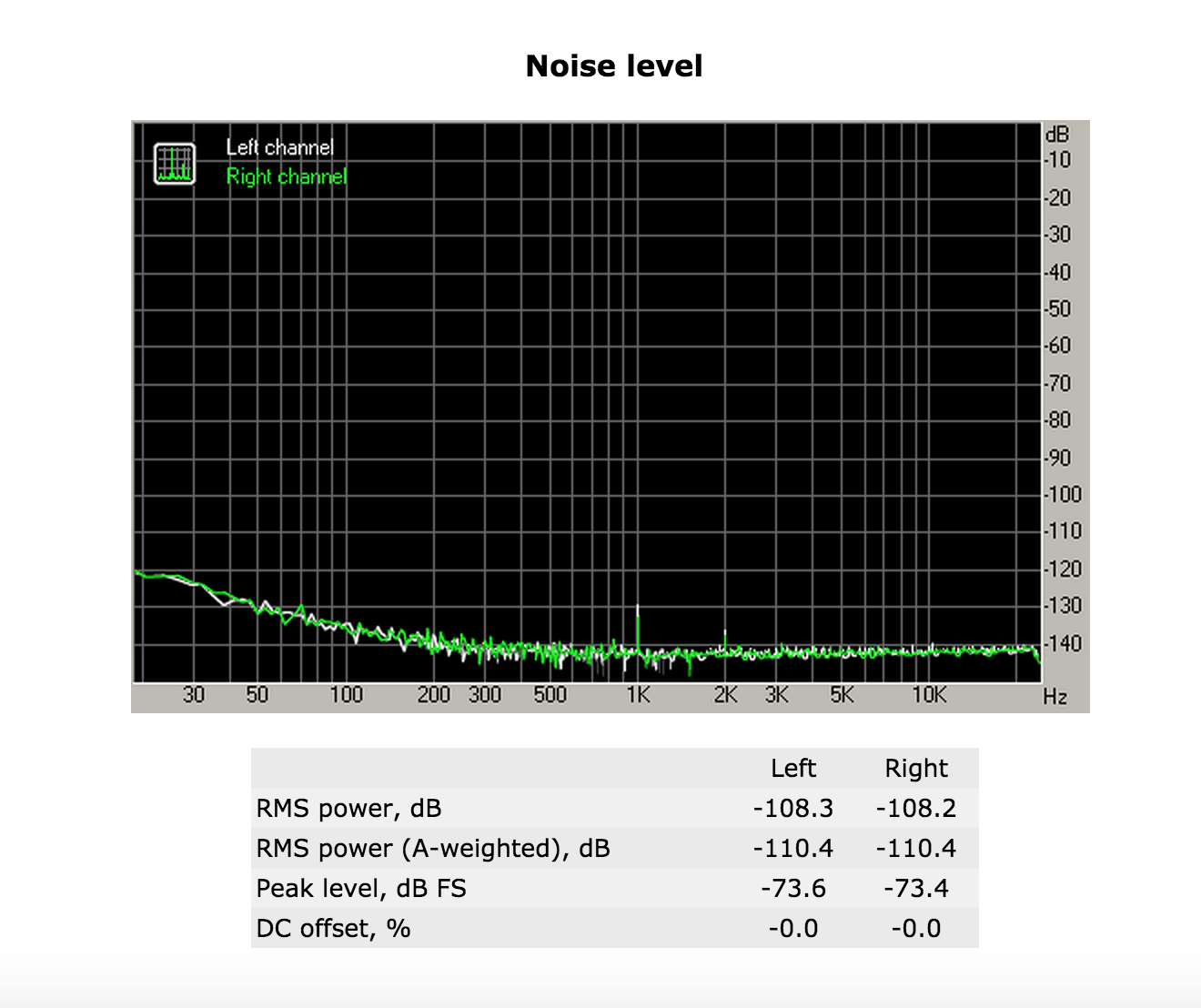

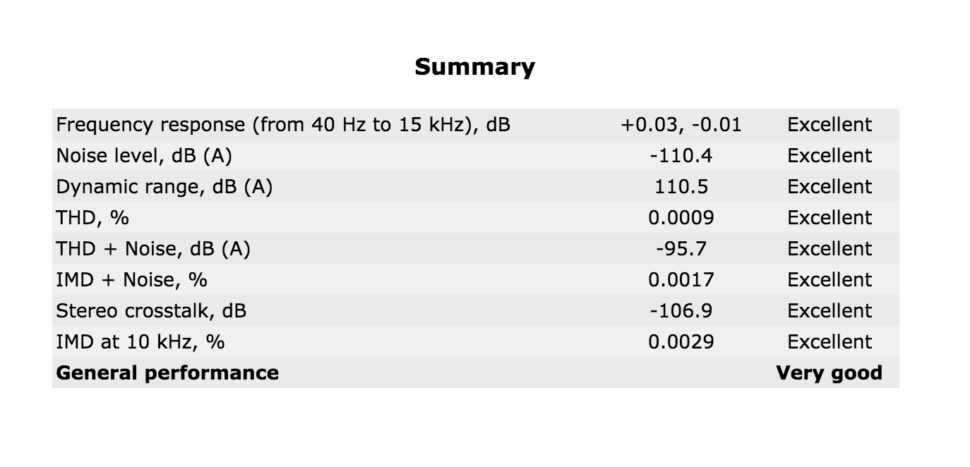

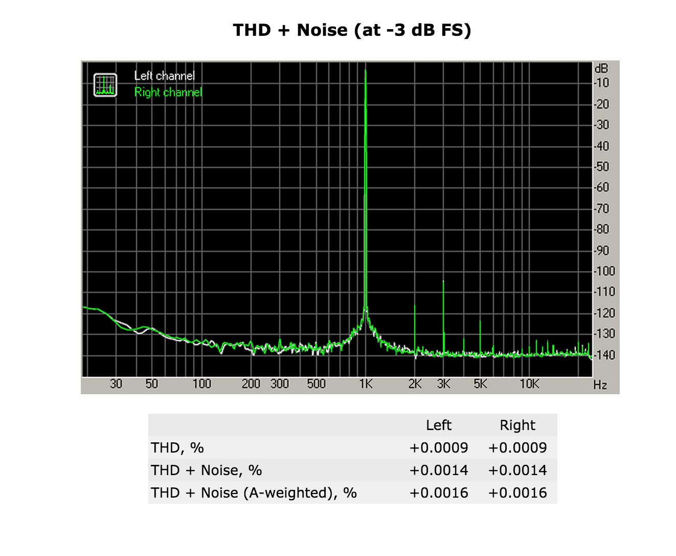

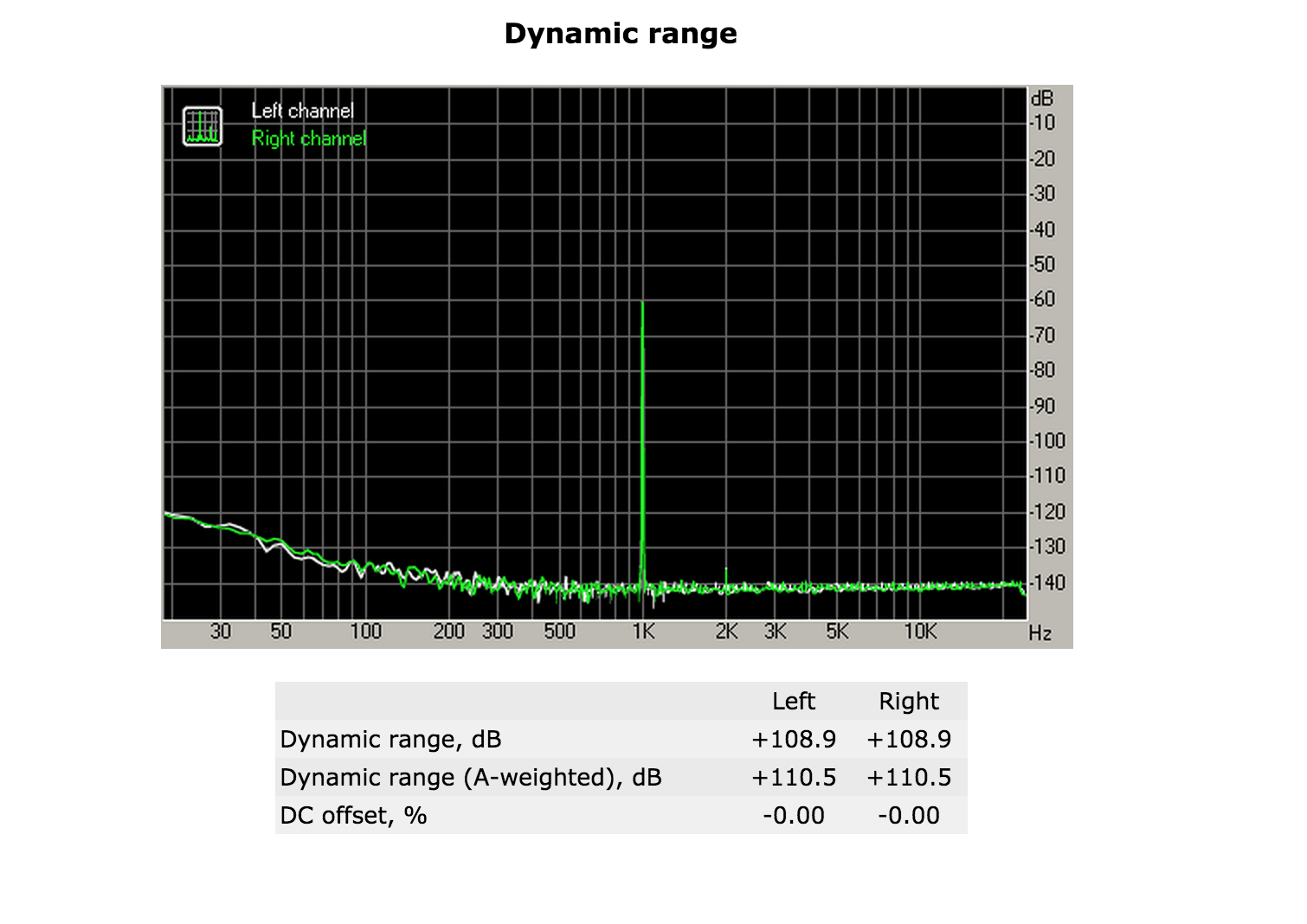

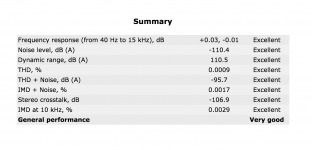

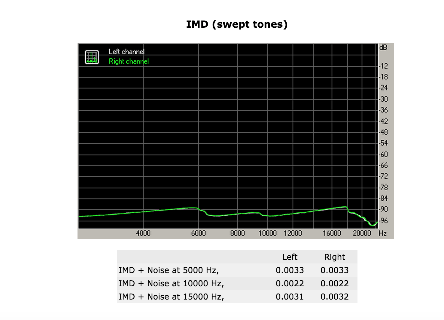

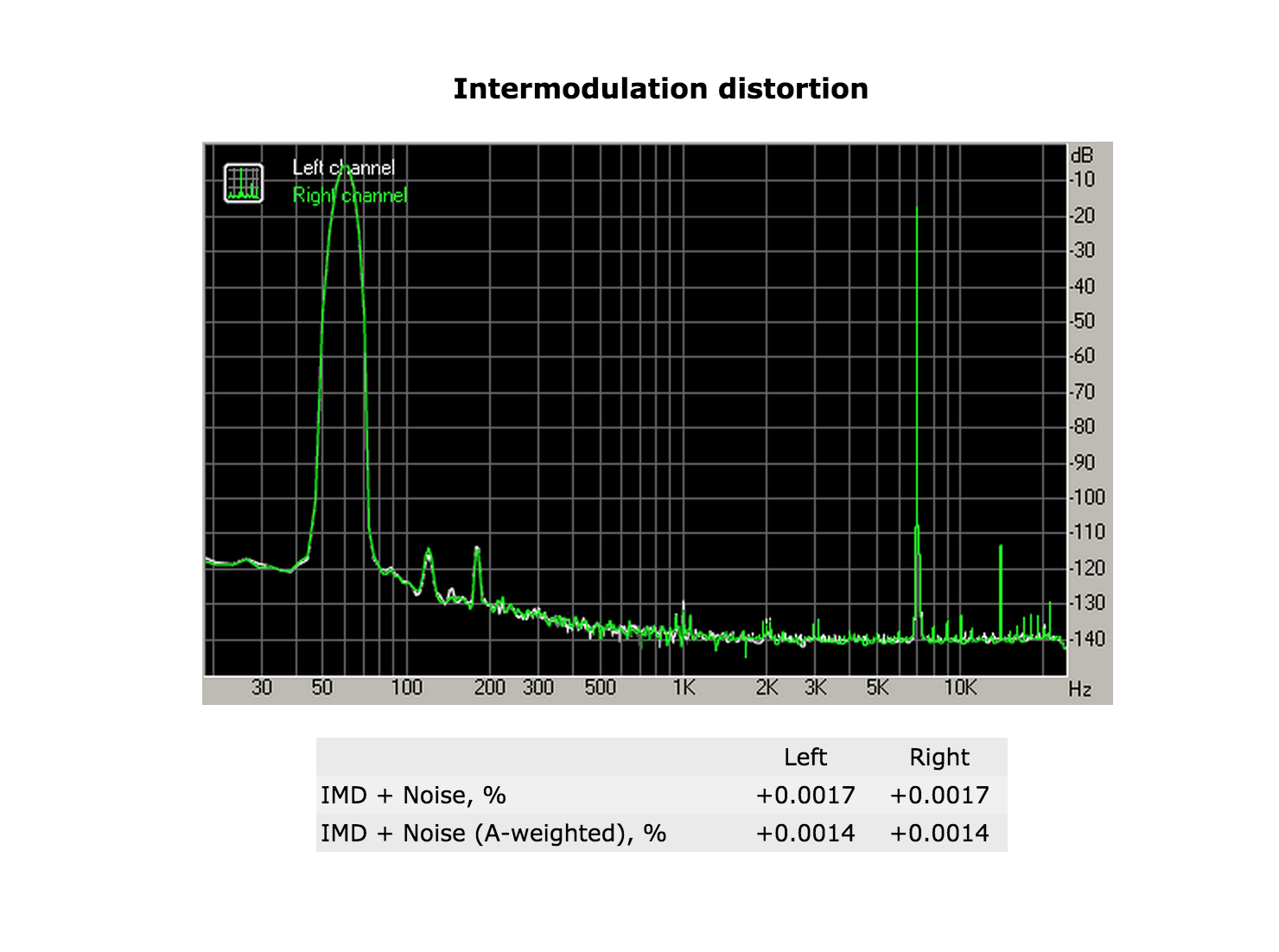

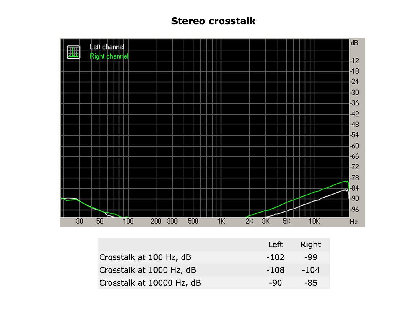

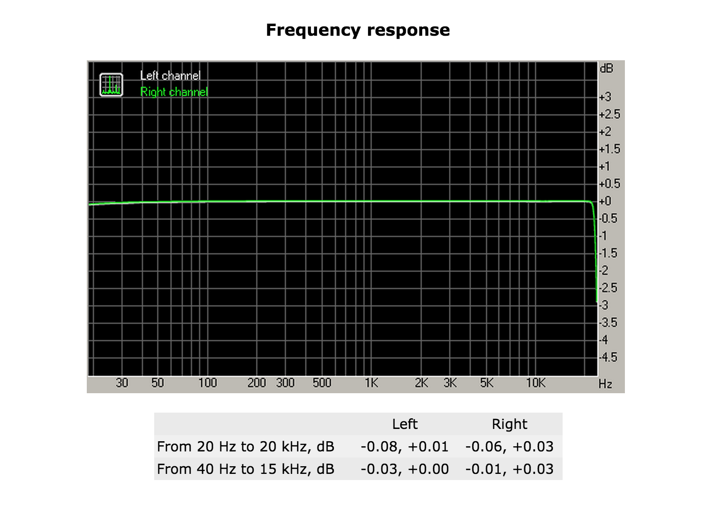

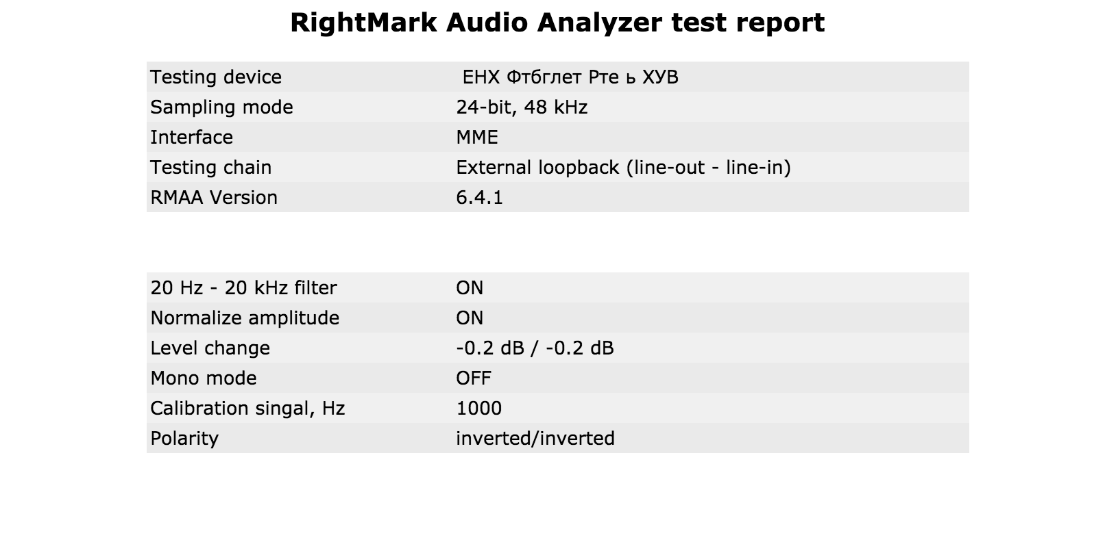

The specs I get on E-MU Tracker PRE with OS X 10.10.5 and RMAA via PlayOnMac.

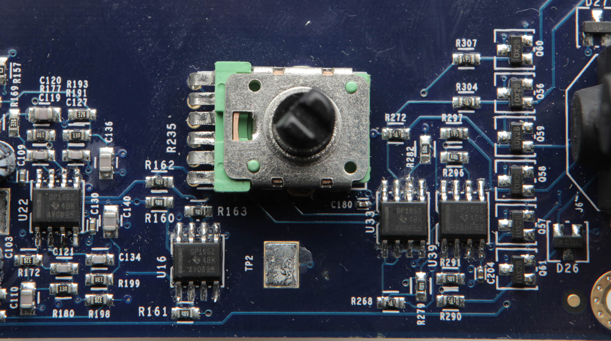

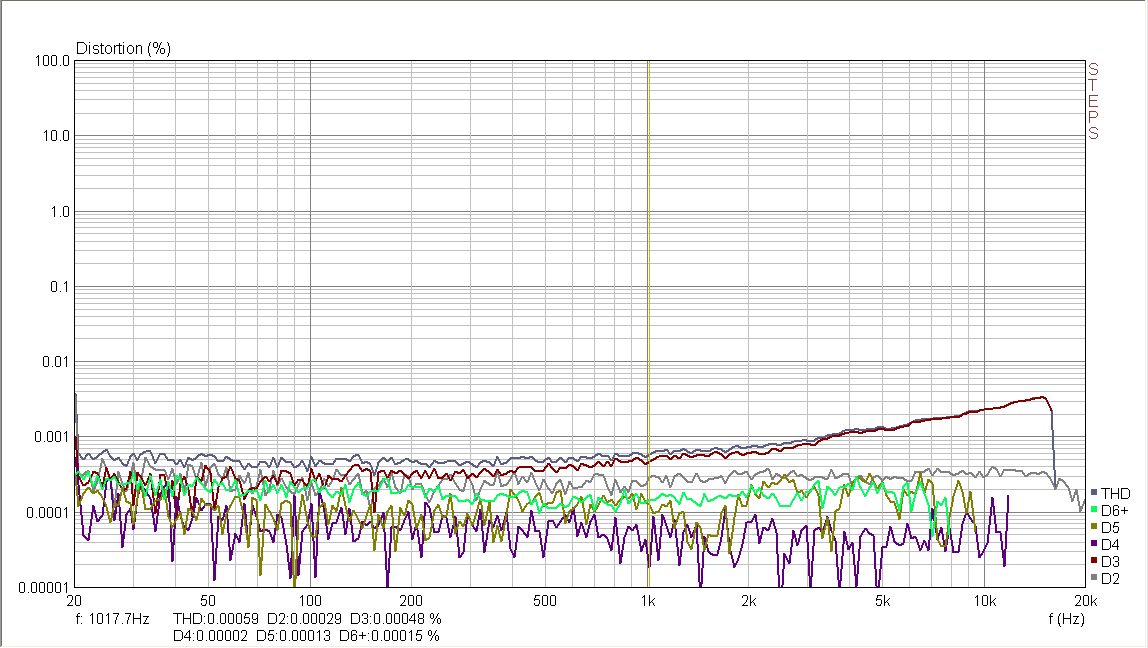

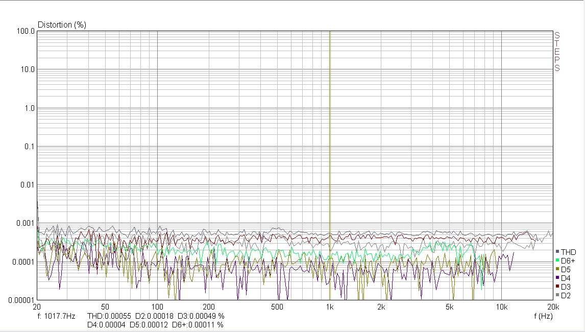

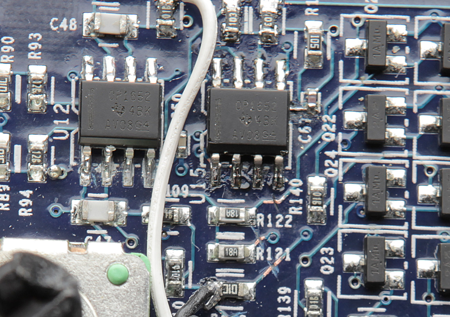

Ok, made some pics.
This one shows the output opamps replaced by OPA1652. Someone suggested OPA1612 might be better and I agree, but at 6 Euro's each they are about 3 times more expensive than the 1652.
What this does is reduce the upward sloping distortion somewhat, but the effect on total distortion is limited.

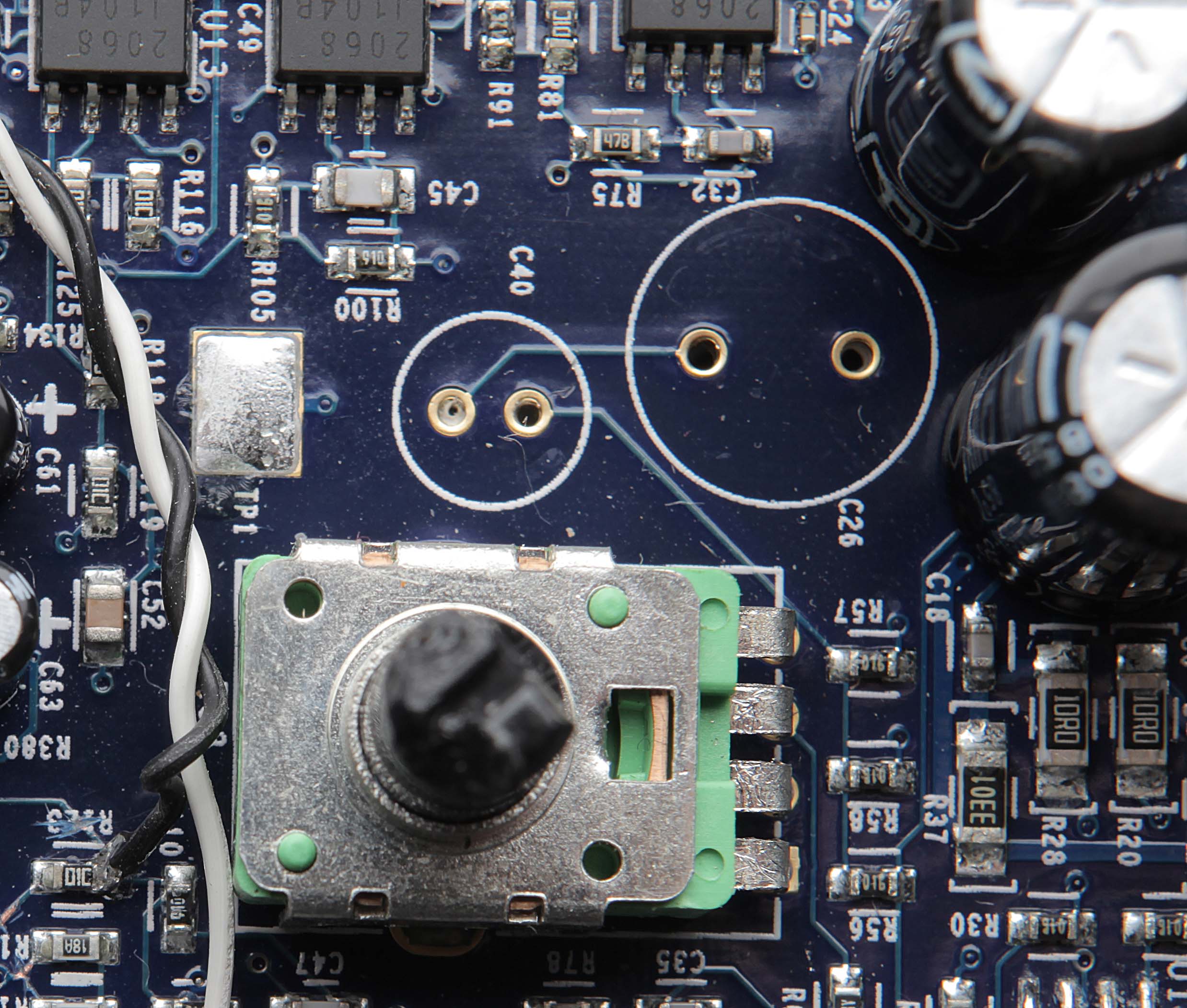

The next pic shows how the soft clipper is cut of from the circuit.
As this is basically a distortion engine for elevated input levels, as may be expected, taking it out of the circuit does lower distortion also at non-clipping levels. Also visible are the OPA1652's, replacing the JRC's. These have a form factor unique to JRC, but SOIC's align without problem.
Finally, capocide on numbers 26 and 40 eradicates the Whitlock style bootstrapping. For short measuring probes I see no advantage in this setup, but I can miss the positive feedback it gives for unbalances inputs like a sore tooth. It also eliminates the double bootstrapping to a node that is buffered from the input by U1 anyways.
Since the loop back distortion of this setup is almost an order of magnitude larger than that of the OPA1652 opamps I used, I don't think much can be gained by replacing them by 1612's or LM4562's, but than again, you just might push distortion even lower by a teeny-weeny bit. The ADC is specced as THD+N=-103dB, but S/N is -114dB. The DAC is -100dB and -120 dB respectively. So, in all likelihood, -114 dB is the absolute minimum distortion that can be achieved. With all these mods, the EMU almost reaches that level at some points.

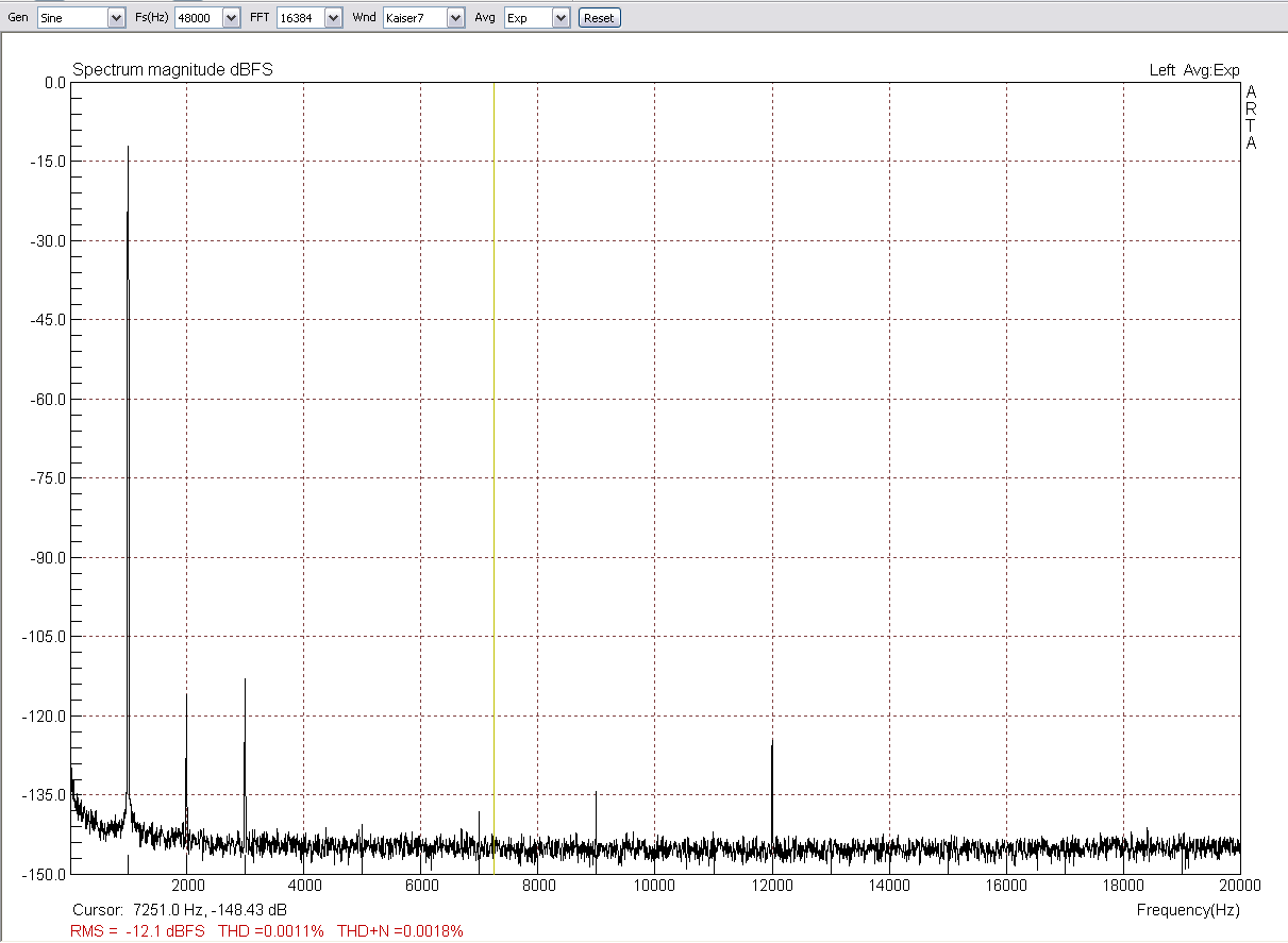

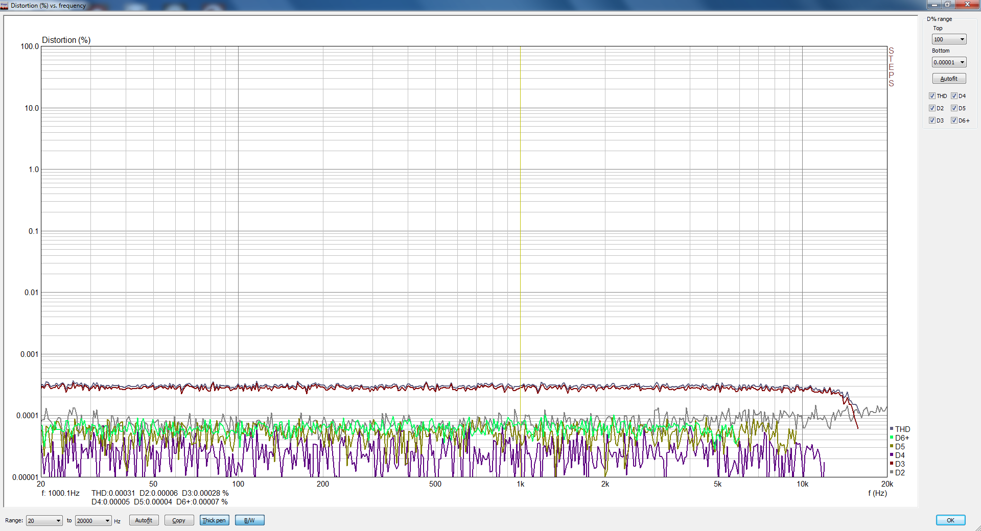

For the testing I removed the R89, R90 like Vacuphile and I repeat the testing.
With 96K sampling and -6dB signal the best step test that I have is the following. It is far away from the result of the Vacuphile test.
With the last mod (R89, R90) I see a small improvement at the 2nd and 3rd harmonic (THD Test) with 1 and 2 dB respectively.
The signal at the thd test was a 1Vrms (loop-back method).
