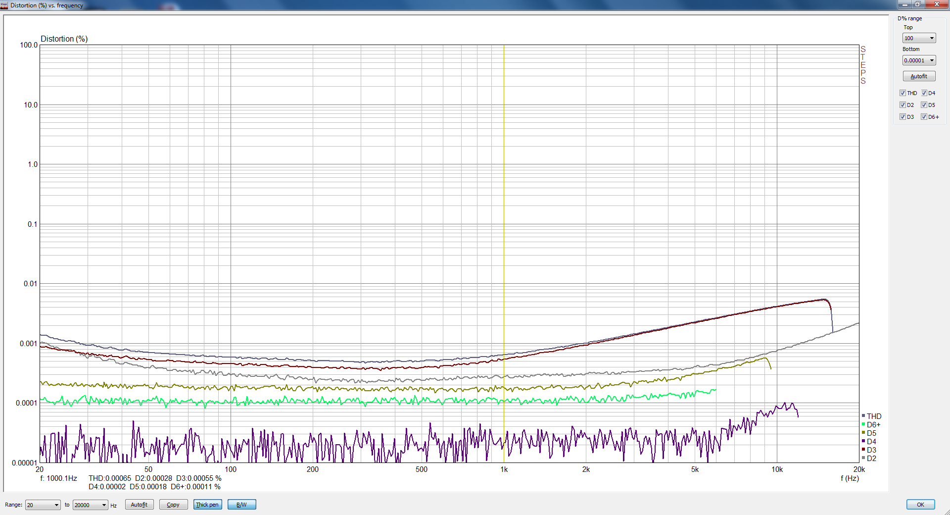

I've attached measurements of my Lynx E44, using balanced connections and +20 dBu FS trim.

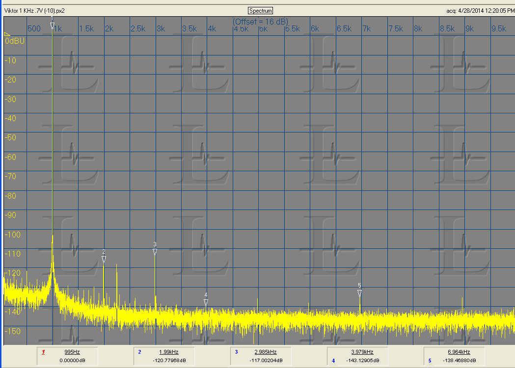

Below is the modified 1212M adc from a really low distortion source:

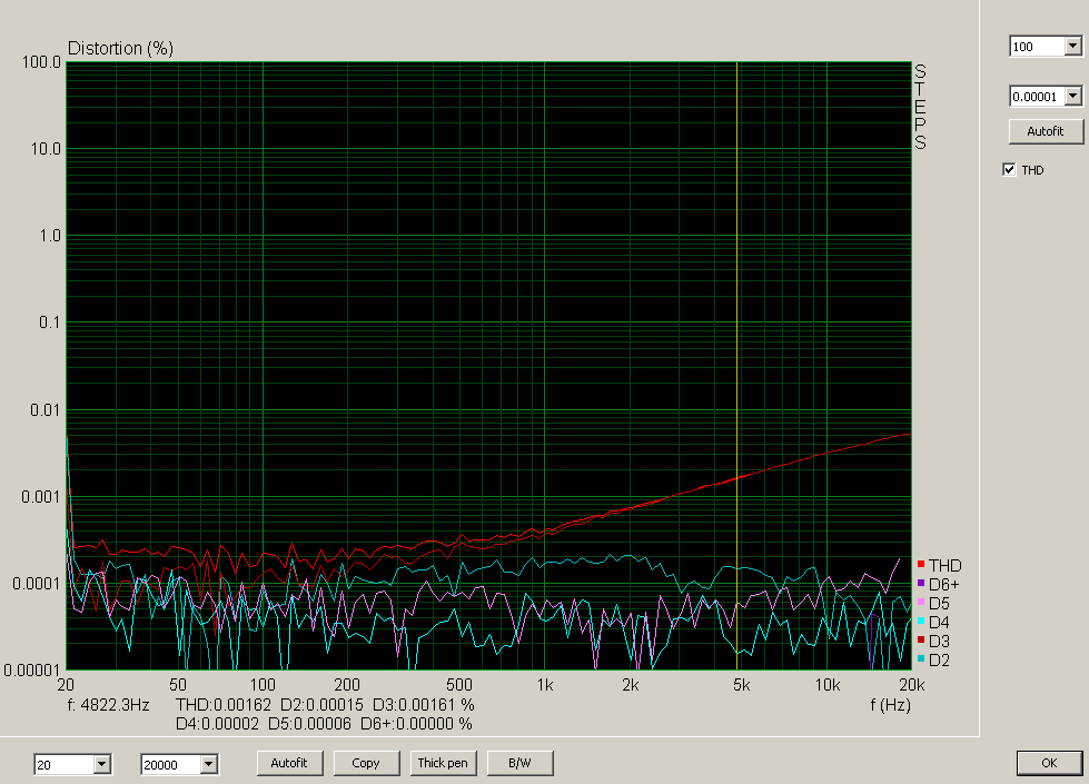

In any case here is the loopback at 192 KHz +4 analog settings. Its dominated by the 3rd harmonic. I'll need to figure out whether its the DAC or the ADC. Usually its the DAC. The ADC's are typically better than the DACs.
Everything else is exceptionally good. No known transducer is anywhere near as good as these measurements.
