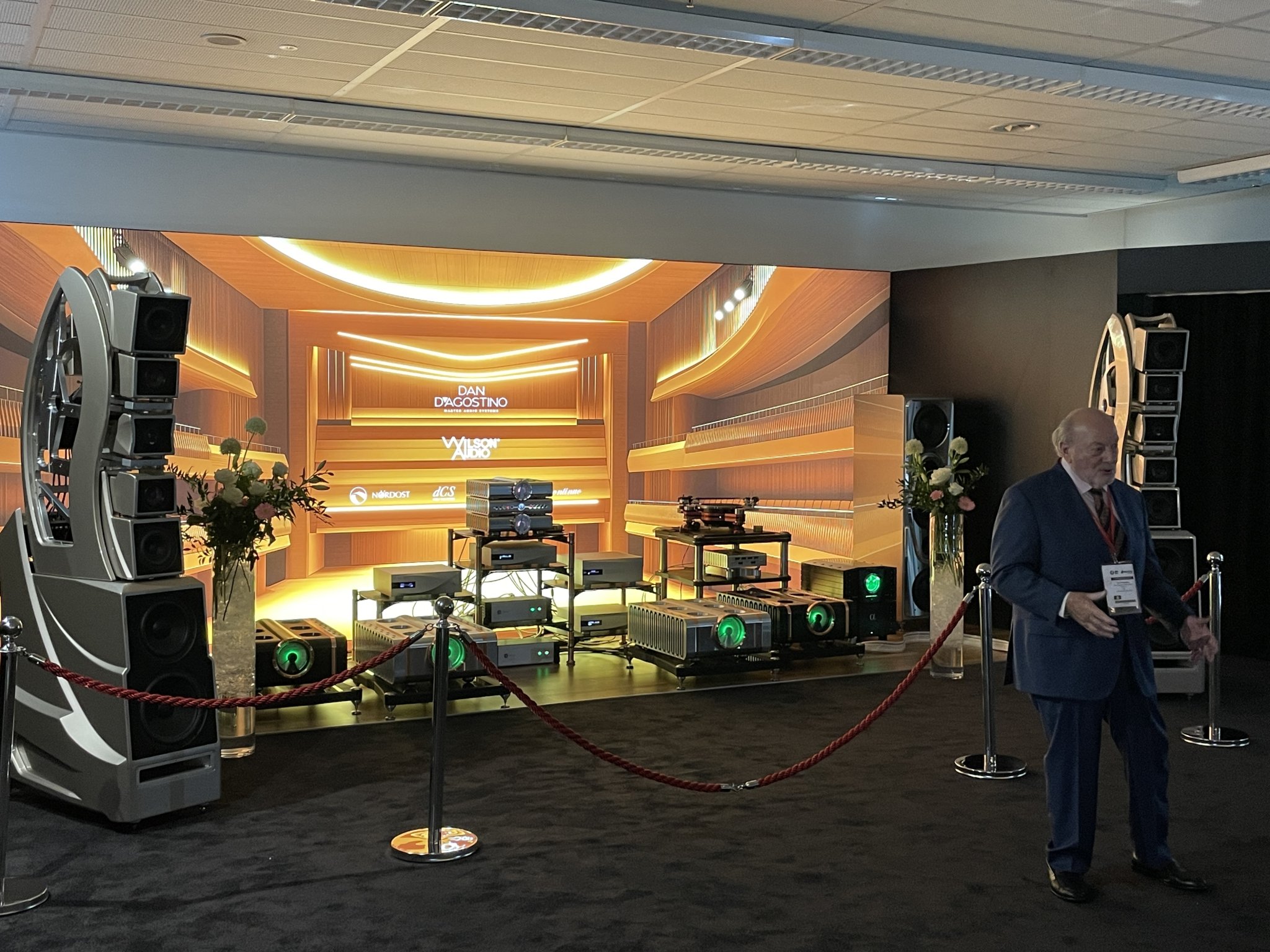

We have a local record store owner here in the Valley who is absolutely in love with this huge Wilson's. I'm ok with that, but don't come out with guns a blazing stating its the last word in accuracy and all out precision. Its just not.Full disclosure, I’m not a fan of the Wilson sound and have heard them in many dozens of systems over the years. To me, the common issue always comes back to the tweeter being driven to the ragged edge. It is common to hear them with a 1000 watts of amplification sitting behind them. Listening position to get the best from the speaker is always hugely restricted and and you almost feel you need to lock your head in a vice to avoid phase issues.
Sorry if I offend any fans but I would take a great AMT design over Wilson tiny tweeters any day!
PS. The attached image was from Munich last week. Sounded horrible and aggressive. View attachment 1464794

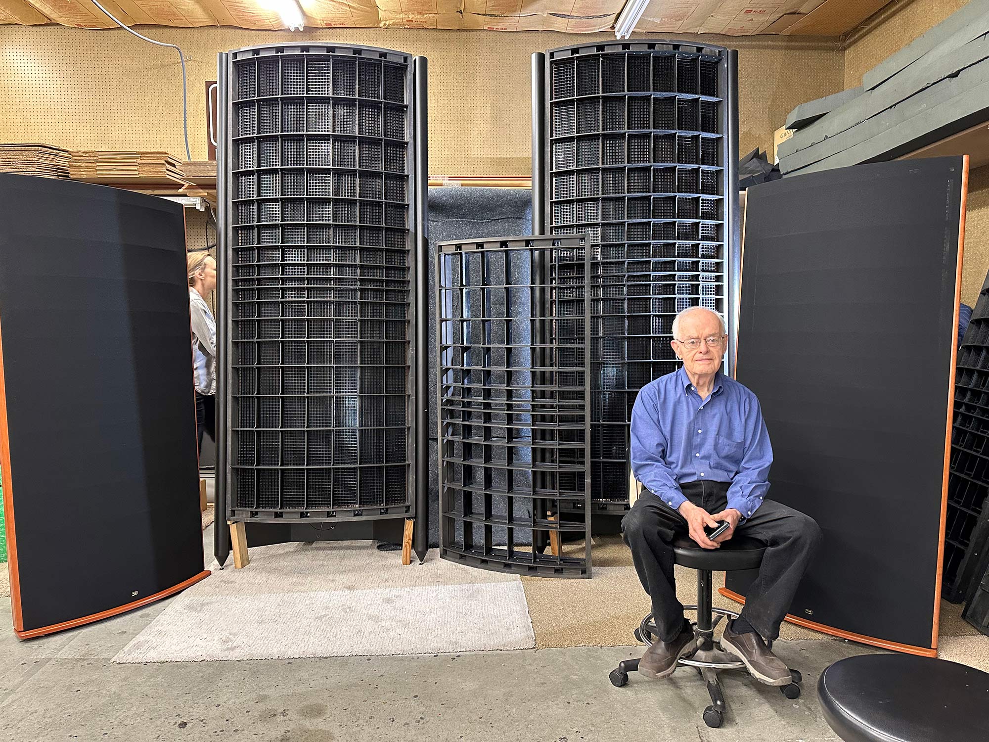

I used to own large Soundlab ESLs. They had curved panels which had considerably more output potential compared to other ESLs with flat panels, closer to the output capability of some larger box style speakers. With dedicated subs, they were capable of impressive dynamic range, almost on par with big multi way speakers.
When I invited others over to listen who were used to their highly colored large format multi way box speakers, they all had an interesting reaction after listening for a while. When I trying to talk over the music, they would often say "damn, that's alot louder than I thought it was". They were used to the distortion from their own speakers dominating the sense of loudness.
I ended up selling my Soundlabs to one of these guys since he loved them so much. He sold his Infinity IRS and ended making money from the transaction. He added some Genesis 15" subs (also designed by the same Annie Nudel from Infinity) and a pair of large Krell monoblocks. This was his system for 10 more years until his basement was flooded, which ruined everything. He had no insurance.... ouch.
The point of this is these big box speakers have more drawbacks than advantages. ESLs aren't perfect either, but have unrestricted dynamic range up top, which is more important than people think. A little dome tweeter just isn't going to keep up with a square foot plus of ESL HF element.

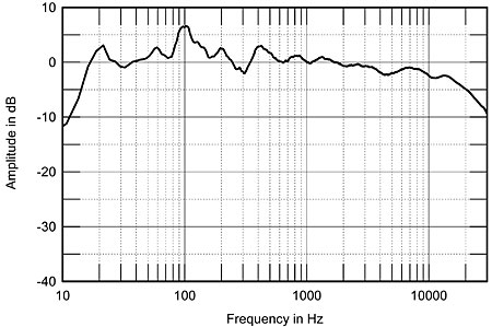

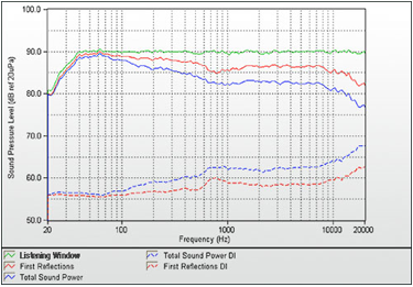

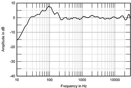

It is interesting to compare responses of Wilsons to Magicos which use hard "domes" or Revel with a waveguide-Be-dome
https://www.stereophile.com/content/magico-s5-mkii-loudspeaker-measurements
https://www.stereophile.com/content/wilson-audio-specialties-alexandria-xlf-loudspeaker-measurements
https://www.stereophile.com/content/revel-ultima-salon2-loudspeaker-measurements
