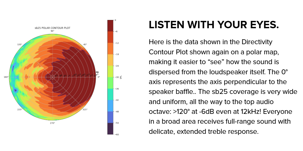

But I haven't noticed anyone having interest in achieving very wide dispersion from compression drivers. I sort of fights against the idea of a horn+CD...
Theory Audio design appears to be making that a goal, using small shallow waveguides with CD's.
