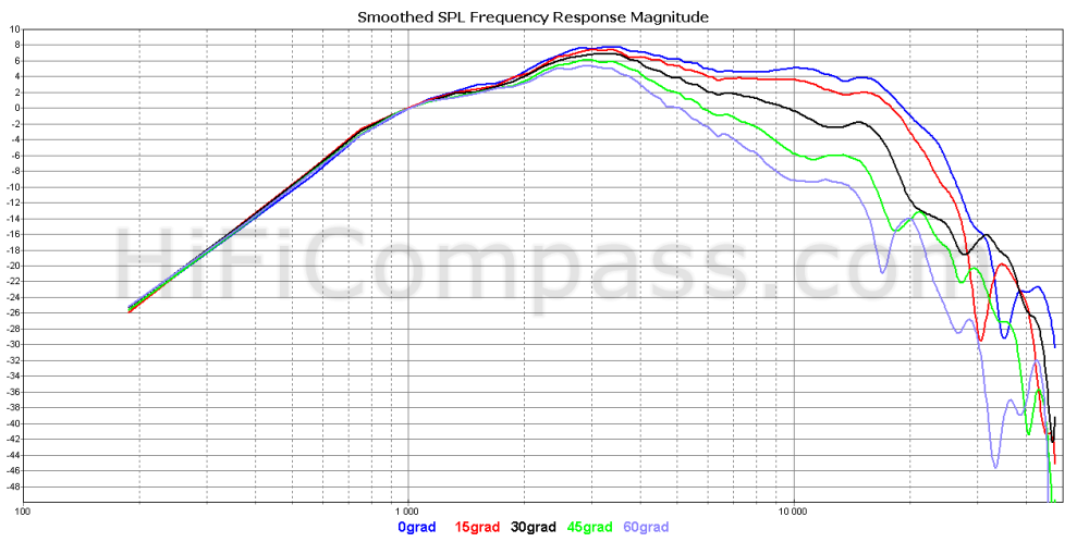

The Seas DXT tweeter does have some specific advantages over other WG "assisted" domes. The Morel CAT378 is a fabulous tweeter, but only crossed 1st order with 4 to 5uf cap along with an 8" midbass ie. Seas U22REX/P with a 1.5 mH air core coil + 3.1k LCR. Depending on baffle width, its a really accurate combo and delivers on almost every front. Horn solos sound pretty believable on a design like this.
Morel CAT378 https://hificompass.com/en/speakers/measurements/morel/morel-cat378
SEAS DXT https://heissmann-acoustics.de/en/test-seas-dxt-27tbcd-g/
But a wider wg can look like this https://www.somasonus.net/satori-tw29bn with Augerpro elliptic
Then of course the driver itself must have good motor and cone ...

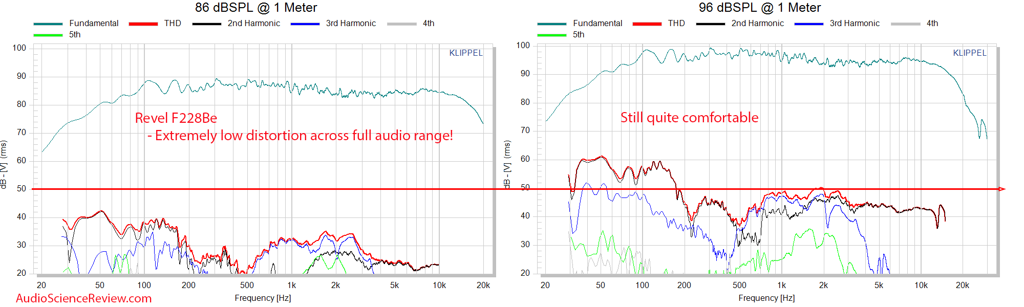

FWIW, here is the distortion plot of the Revel F328. It uses the same mid as the F226 but different tweeter and waveguide. Look at the third harmonic at ~2700Hz.
Here is the distortion measurement of the Revel F228. Same mid, tweeter, and WG as the F226. No distortion spike around 2700Hz.

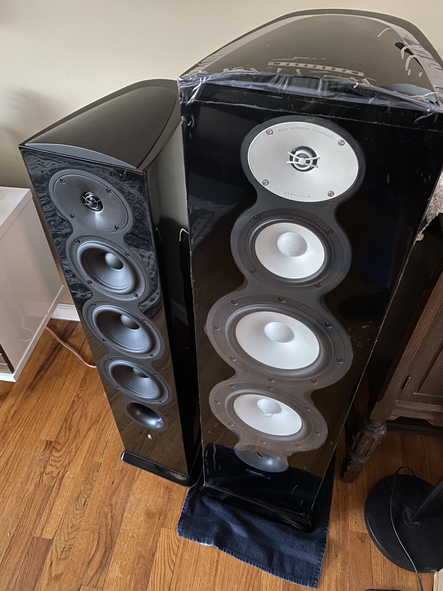

Here’s a pic of me unpacking my Revel F228s and placed next to my F206s to show scale.
If the F228s had cone breakup issues with the mid, either I can’t hear them (according to the plot above I won’t) or I don’t know that’s what I’m hearing and instead assume it’s room related. They’re placed in a living room and not a well designed, dedicated listening room. It’s hard to resolve nonideal speaker behavior in a nonideal environment.

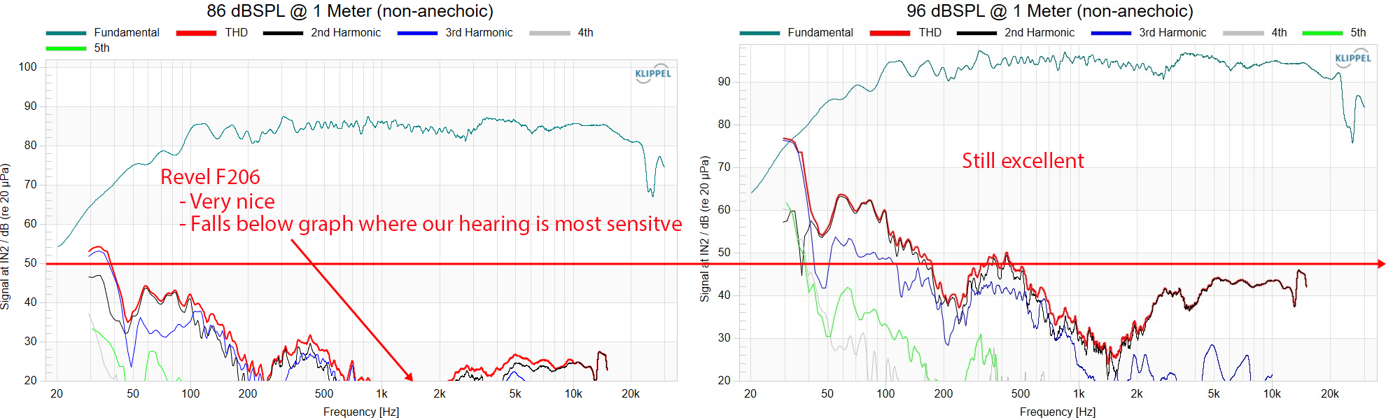

Wonder what's going on? Just took a look at the F206 and it's clean no peak. You can see the peak in the midrange driver but it looks to be suppressed enough. I have a pair in my living room they sound good. These F22's are the new and improved?

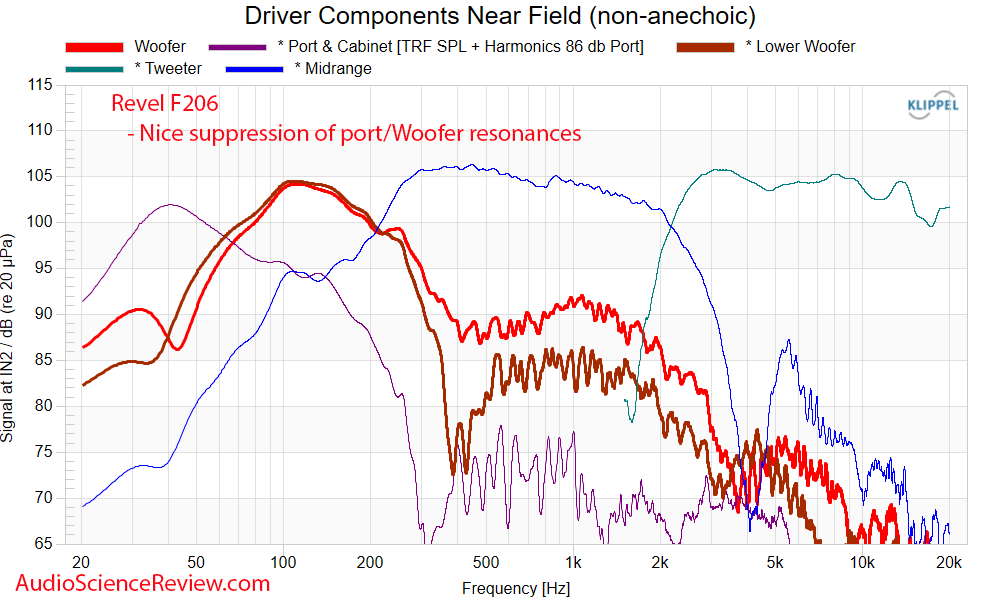

The F206, of the previous generation, were built using SB Acoustics drivers. These, as you can see from the pictures, use SBs ribbed metal cones. This ribbing does an excellent job of helping to suppress the HD peaks usually associated with metal cone drivers.
In their great wisdom Revel decided the best approach would be to copy the SB drivers and make similar ones in their own factories. Whether or not the ribbed cones were omitted due to patent, or because they decided it simply wasn't needed as a way of cutting costs, who knows. But that's the reason why the F206 have a cleaner HD in the midrange.
