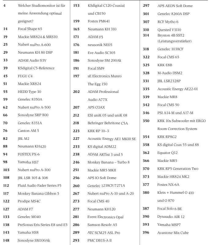

So I poured myself a coffee @Zvu and looked at over EIGHTY studio monitors. The only consistency I could find was...
...there was no consistency!
Even amongst similarly sized speakers, they vary widely in terms of dynamic range and/or distortion, diffraction, directivity, and delay.
So we have studio monitors AND domestic speakers that do not converge to any kind of standard.
In my view, unless the ITU, Fraunhofer, NHK, IEC, AES or other institution set/adopt a standard for directivity or dynamic range Toole's "circle of confusion" will continue, some 25 years after he first coined the term.

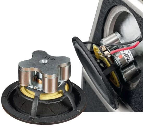

"QuadraMag was created as a modification of the "base" version, and this in turn looks the same as the well-known 18 Scan-Speak Revelator series...There is no doubt that both versions are manufactured by a Danish specialist. This is evidenced not only by the characteristic, slotted membrane, but also by practically all other visible elements (basket, specific lower spring with different folds), apart from... of course the QuadraMag magnetic system, which not only clearly distinguishes this version from the standard one, but also places it in the strict group of the most valuable speakers of this type. QuadraMag is not just a marketing slogan for the company's nth "patent", the technical essence of which or its real impact on parameters and sound we are unable to verify.
Taking the speaker out of the housing (and I hadn't seen it before or even read about it), I was sincerely happy - here we have something very rare. Quadra - four, Mag - magnets, but "exchanging" one magnetic ring for four smaller ones is only part of the attraction...The shorting plates have a shape similar to a four-leaf clover and hold four magnetic cylinders between them, spaced considerably apart, which is already an advantage as it allows for free ventilation of the coil – dissipating both heat and pressure.
A similar solution (but usually with six magnets) is nothing new; Focal used it (Audiom series loudspeakers), Scan-Speak introduced it a few years ago (Ellipticor series loudspeakers), and I don't deny this "merit" to a few others. However, in all the cases I know of (and so few), these rings are made of neodymium magnets.
Thanks to their strength (greater than that of ferrite), it is possible to create an efficient magnetic system with a structure in which the mass of the magnetic material is smaller. Neodymium also has other advantages – it creates a more uniform magnetic field… But in this case it is not neodymium, but an even more expensive material, although also well-known – Alnico, popularly known as cobalt, or more precisely: an alloy of aluminum (Al), nickel (Ni) and cobalt (Co). Each magnetic material has its strengths and weaknesses. A potential problem with neodymium (NdFeB) magnets is the loss of flux due to high temperature (above 85O). In this respect, Alnico magnets are the best, as they practically cannot be "overheated" (max. operating temperature 400º, before that the voice coil will burn out), and their Achilles heel is greater susceptibility to mechanical damage (the material is hard, coarse-grained and breaks easily), which, however, is a problem mainly during production (and increases costs).
Once we have a speaker with an Alnico magnet installed... if we unscrew it, do not approach it with a steel hammer, and we will be happy with it for a long time. The parameters themselves do not fully explain the great esteem that Alnico magnets enjoy in audiophile circles. Some attribute to them sound properties that are simply miraculous, but - as in many systems and devices - the final result depends on the quality of all the parts, the matching of all the parameters. Undoubtedly, on the basis of the 18 cm Revelator, which already has a refined vibrating system in its standard version, and thanks to this, smooth characteristics, with the use of Alnico, it was possible to create an outstanding midrange loudspeaker. Even if we put aside (without denying them at all) the promises of a warm, sweet, beautiful, "alive" sound coming from the manufacturer or Alnico enthusiasts, the resistance to high temperatures alone means a lot here, because we are dealing with a single midrange speaker in a three-way high-power system, and as our measurements show, the crossover frequency is not high (which we will not worry about at all, if only the speaker can cope with such a challenge without increasing distortion).

The wrenching side of me likes Audio.com.pl explanation - it makes me want to understand how it works!
