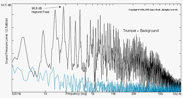

Stressing sounds... trumpet might be the most challenging acustic instrument for loudspeakers (excluding cymbals and hihat). It's sound is mostly distortion, not only harmonics. Very high spl peaks up to 10kHz in most recordings, but fortunately short duration. Practically all recordings are dynamically compressed, but if you are a fan of big band jazz or funk, be aware! Typical hifi loudspeakers will not play these realistically.

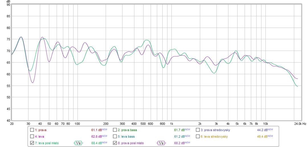

Did you do measurements at the listening position before and after the mod? Might have been interesting.
The measurements in the listening spot, ~3m distance from the loudspeakers, before upgrade. I did not find the measurements after the upgrade though.
This was 9x5m listening room, 3m ceiling height. Room had very good acoustic treatment. No DRC, DSP, ....
The bump at ~500Hz correlates well with 1m measurements. Elevated 4-10kHz correlates well with the listening impression, before the upgrade.
