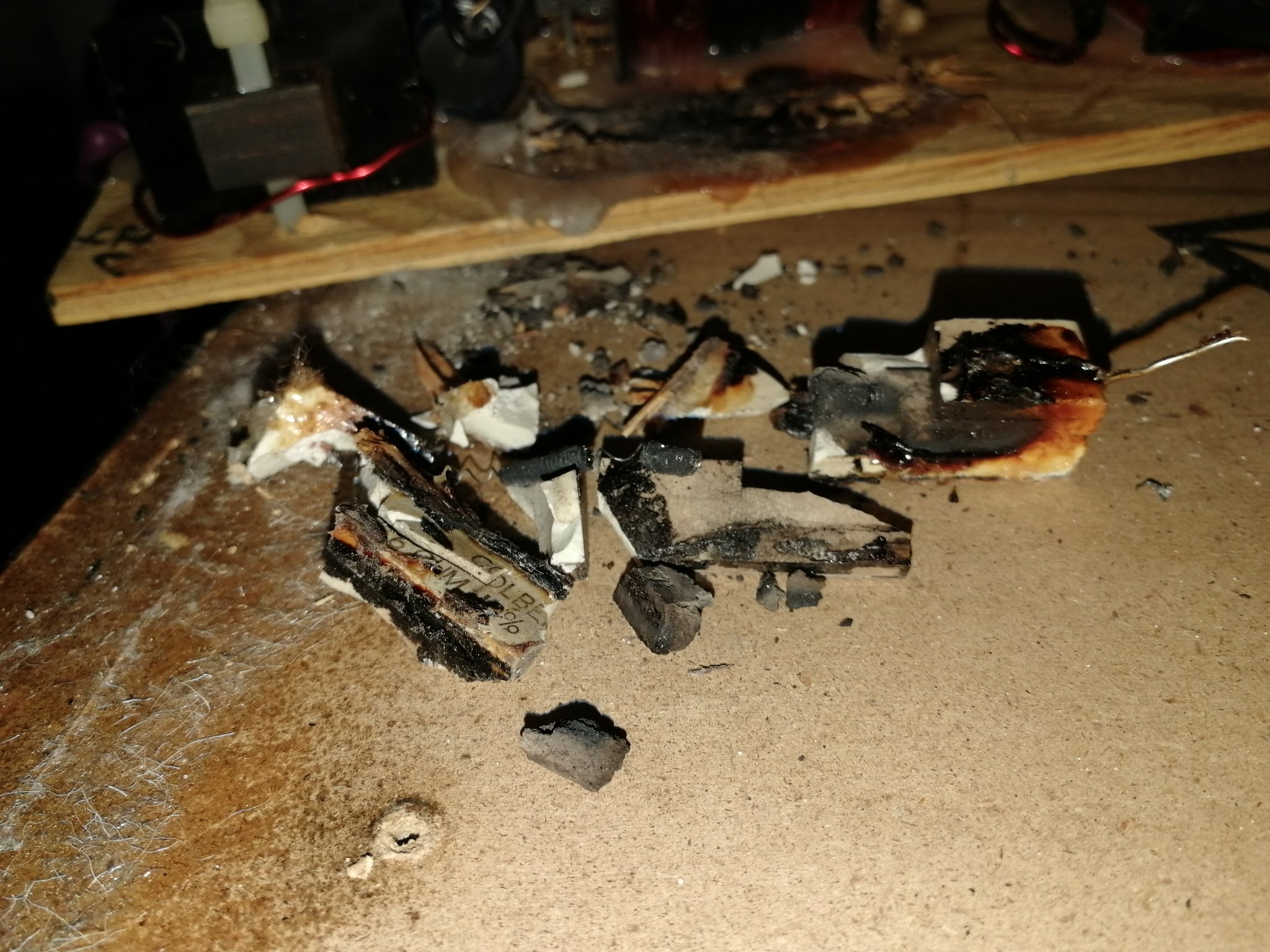

Midranges on the contrary i destroyed 4 times (7 in total), both melted coils and cracked cones
Also destroy woofers 2 times (4 at once one time), and destroyed resistors... and one coil on Revel Salon 1 front tweeter

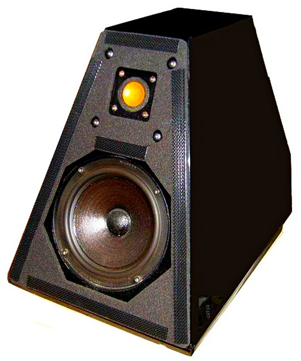

He had a few revisions of this big speaker before releasing a stand mount monitor called WATT, which costed 3 times higher than other monitors in the marketplace. It was in for US$4,400 in 1986 (~ US$ 13,000 in 2025) This time using drivers from SEAS and Focal.
Wilson WATT loudspeaker

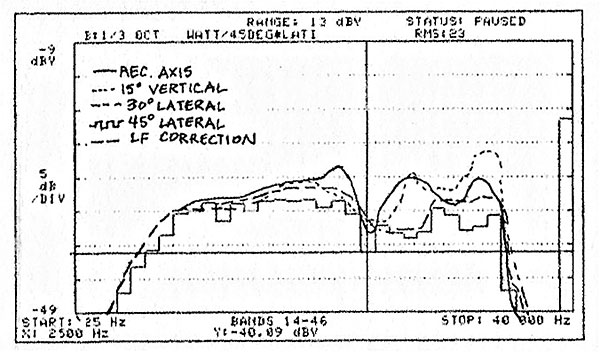

CommentaryThis is a truncated pyramid shaped enclosure, which we now know can mitigate diffraction. Of course, whether this was a goal by design or lucky coincidence, we will never know. What we do know is that it is an incredibly dense- 1/3 cu ft (9L) enclosure weighing 60lbs (27kg).
Here is a 1/3 octave amplitude response according to Stereophile:
I will give David Wilson (and/or Stereophile) the benefit of the doubt, because measurements were pretty rudimentary in 1986 ( MLSSA had not yet just been released )
However, the impedance is marred by a drop below 1 ohm:
The Puppy was a small woofer enclosure turned it into a 3-way Watt/Puppy. Various revisions were made to the WATT/Puppy speaker, throughout the years and by 1994 the the "series 5" had switched to a "7" coated-pulp cone"
"The driver complement is one 1" inverted titanium-dome Focal tweeter, and one 7" Scanspeak midrange/woofer. Both are proprietary designs which Wilson has further modified—the Scanspeak driver looks a bit scabrous, as it has been treated with some sort of (randomly applied, it seems) damping compound"

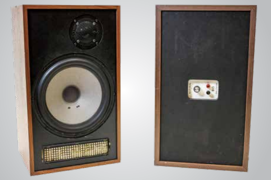

David Wilson was NOT the first to use to Scan-Speak- that honour belongs to the David Hafler The background for this was American David Hafler had founded Dynaco in 1954. He's probably best remember as selling the vacuum tube stereo amplifier like the Stereo 70 (1959) or as a kit (Dynakit) to hobbyists to do final assembly at home, which were both sales successes. During the golden age of hi-fi, many start-ups came from employees leaving B&O, Telefunken, Magnavox, Jensen etc. One ex-B&O employee starts Audio Dyne in 1965, to import Dynaco amplifiers to sell to the European market.Scan-Speak
By 1967, with Hafler's support, turns this company into ScanDyna. The idea is that ScanDyna would build the cabinets and use transducers sourced from SEAS, and have the whole thing assembled in Denmark, and exported to be sold to the large American market. The first product was the sold as the Dynaco A-25 (1968), using a SEAS 10" woofer with a rubber surround (innovative for the time), and one of the first soft dome tweeters- SEAS 1.5", model H87. It's consider small in it's day... despite measuring 50x29x25 cm ~20"x11"x10" (HxWxD)
We have to understand that in the 1950-60s, Denmark had a significant furniture and wood products industry (Ingvar Kamprad had not opened his first IKEA store in Denmark until 1969)
Looking for a 2nd supplier, Hafler meets an enterprising Ejvind Skaaning, an ex-Ford mechanic, ex-scooter business owner and owner of record company Quality Sound Recordings. Skaaning builds a prototype and convinces Hafler that he can also supply speakers. He gets the contract, and continues builds speakers using SEAS drivers. The A-25 speaker is a sales success for Dynaco, and both SEAS and QSR benefit greatly.
SEAS was not happy with QSR being a competing supplier for Dynaco. SEAS engineer Mogens Hvass is fired from SEAS for co-operating to build a 1.5" D3806 soft dome tweeter for QSR. Ejvind Skaaning boldly hires him, and then hires Ragnar Lian from SEAS months later. In 1970 Skaaning converts his business to Scan-Speak So ex-SEAS employees Mogens and Ragnar are now back together, making drivers as Scan-Speak.
Meanwhile Hafler has a hit on his hands after Stereophile gives it a positive review in 1969, and Consumer Reports gives it a "Best-Buy" award in 1970
(US$160/pair in 1969 -> $2000 in 2025!)
Commentary:Each time Scan-Speak, or SEAS, releases a new product line, it doesn't necessarily replace the old line. But the prices definitely go up. They are, amongst others, the boutique parts for the "high-end" market.

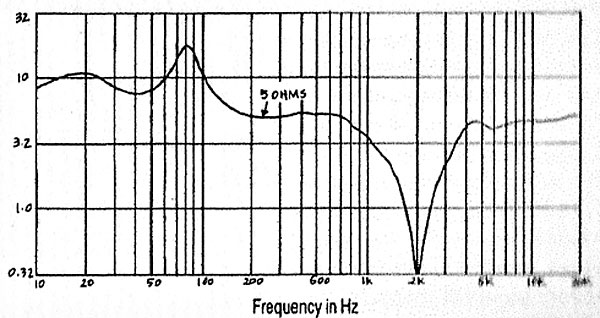

That impedance response though that's almost a complete short at 2kHz. In fact it probably is and only the cables, and any series crossover resistance, are keeping it completely off the floor! Ironically if you look at the impedance response, as if it were a frequency response, then it looks like a superb reverse polarity null centred on a reasonable crossover point of 2kHz. Flip the polarity of the tweeter and I'd much rather listen to the flattened impedance than the actual frequency response!
Clearly these were designed without any measurement or simulation gear. No bafflestep compensation and one heluva wonky frequency response. No thanks!
I don't think I've ever seen a Wilson speaker that I thought measured well though. The same could be said for a lot of high-end speakers.
I don't think so. It was too long ago to remember for sure. I have a different release now, and I'm not sure if the audio changed between versions. I think it might have been the last fight scene where Neo jumps inside of Agent Smith. Seems likely that I would have had the volume up there.Is this the one?
I thought it would be obvious if I watched it again, but honestly there's so much unnatural high frequency content in the movie it's hard to say for sure. The scene in the train station when Trinity transfers out and the phone gets shot is another one that has some piercing high frequency content that's not in multiple other spots. The sentinels' lasers are pretty tough on the ears, but I don't think the thing that killed the tweeter lasted as long as those effects.
Based on this quote from Stereophile it sounds like a resonant circuit directly across the amp, although it's not clear. I have doubts about the quoted guess as to the purpose.In fact it probably is and only the cables, and any series crossover resistance, are keeping it completely off the floor!
Stereophile said:In fact, it was so low that many cable sets will provide some partial protection, typically raising the impedance to a total of 0.5 ohm. For some reason, Wilson has chosen to suck out electrical energy in the crossover by a parallel tuned circuit—perhaps to correct the phase/amplitude response at the crossover frequency between the two drivers. Such a circuit, if unbuffered by a series crossover element, will go to nearly zero resistance at resonance—the residual value measured is the product of the speaker's internal wiring, the equivalent series resistance of the resonant capacitor, plus the winding resistance of the corresponding resonant inductor.
@AllenB A decent amp won't have a Zobel in series with the speaker. Cheaper ones sometimes do however. Most of Wilson crossovers are shrouded in mystery and aren't shown to the consumer. They're often potted in epoxy to hide component values. That's another big no for me, as it means they have something to hide and don't want anyone else repairing it. The things they usually hide are capacitor values and also how cheap the caps are, being some of the speakers use a series xover topology. Thats usually only for saving money. Needless to say, most of the Wilson crossovers are difficult to drive thanks to the weird xover topology.
I'd like to clarify are we talking about a Boucherot cell or a speaker system impedance conjugate. I was talking about the latter.
If it is then I've seen things like this before, although their effect is unclear at best.

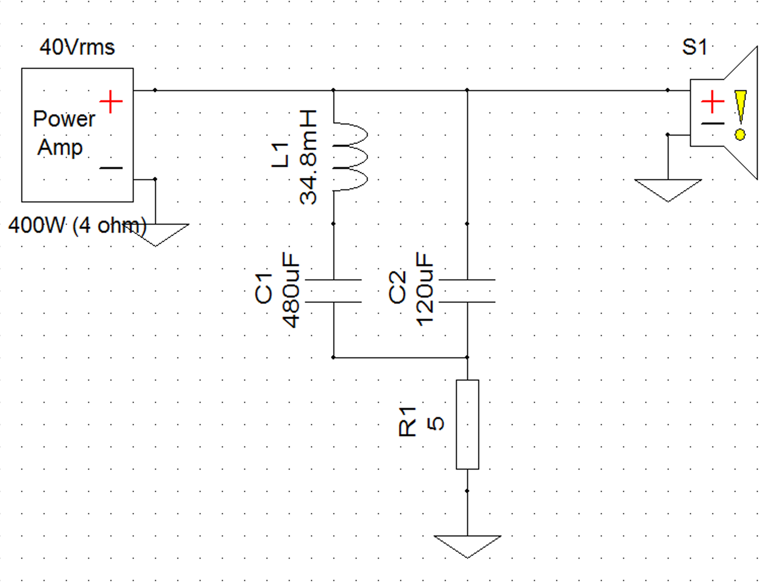

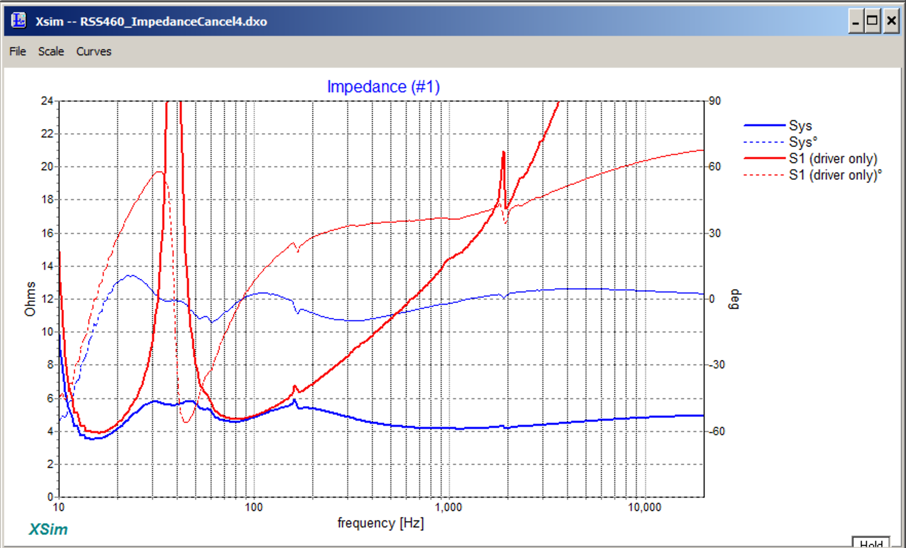

Funny you should mention that. A couple of months ago I tried a conjugate network for the subwoofer because the impedance phase angle was a tad sporty. The plot has the cabinet impedance in red, corrected impedance in blue. Note the impedance angle has gone from +-55 degrees to +-10 degrees, a much more congenial load to the amplifier.
The surprise was how low drums cleaned up. I thought I heard a difference but it wasn't terribly obvious full range. Only after turning off everything above 160 Hz did it become clear: fast kick drum hits [1] which had previously run into each other were now quite distinct. Instead of going thumthumthumthum they became thwack thwack thwack thwack. I did have to rebalance the system a tad -- a couple more dB on the subs -- since spurious bottom end was no longer a factor, and what had been slightly irregular bass guitar, with some notes booming while others were thin, is now more even.
[1] Neil Peart, of course.
Ignore the kank at 170 Hz, it's a cabinet panel issue I haven't sorted yet. The conjugate network is a bit over the top; the caps are 120 uF polypropylene (I didn't want to deal with electrolytic aging/tolerance issues in that value), with 4 in parallel to make the 480 uF, and Mouser gives you a break when buying ten of them: 12 bucks a pop plus the %@&%&#&%#$(@( unfortunate tariff.
I sometimes use conjugate circuits across the amp, like with yourself for clear reasons.
