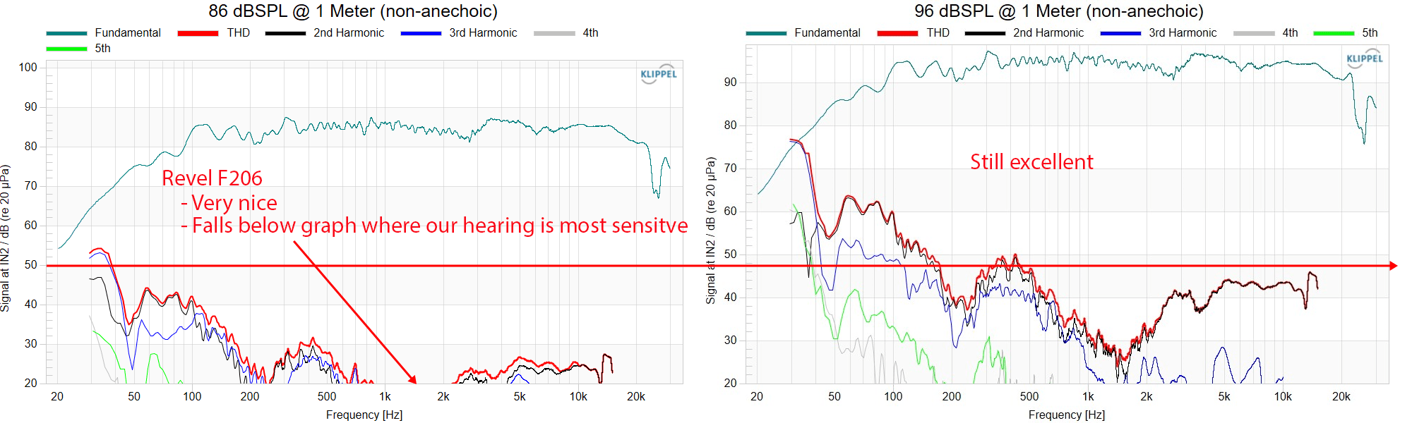

Revel F206 by ASR https://www.audiosciencereview.com/forum/index.php?threads/revel-f206-tower-speaker-review.53691/
F228 https://www.audiosciencereview.com/forum/index.php?threads/revel-f228be-review-speaker.23659/
F328Be
.. I would not say that 2,7kHz harmonic peak is a problem, it is still lower than both above
F328Be

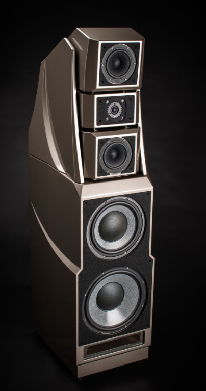

Why? I'm just trying understand why they use such a small tweeter crossed so low (in relation to how much bandwidth it actually has to deal with). Thats an honest question. So far I've come to the conclusion its a considerable mismatch in spectral power distribution. Trying to get a small dome tweeter with a HP set at 1.4k (at any slope) to keep up with so much more thermally and acoustically capable drivers leaves a big hole in output capability, creating an imbalance in the mids.Hi there,
is this the design you want to talk about?
https://www.wilsonaudio.com/products/alexandria/alexandria-xlf
So far - so good, Stefano
If this is the subject we should leave out design questions - please - i think it's awful ...

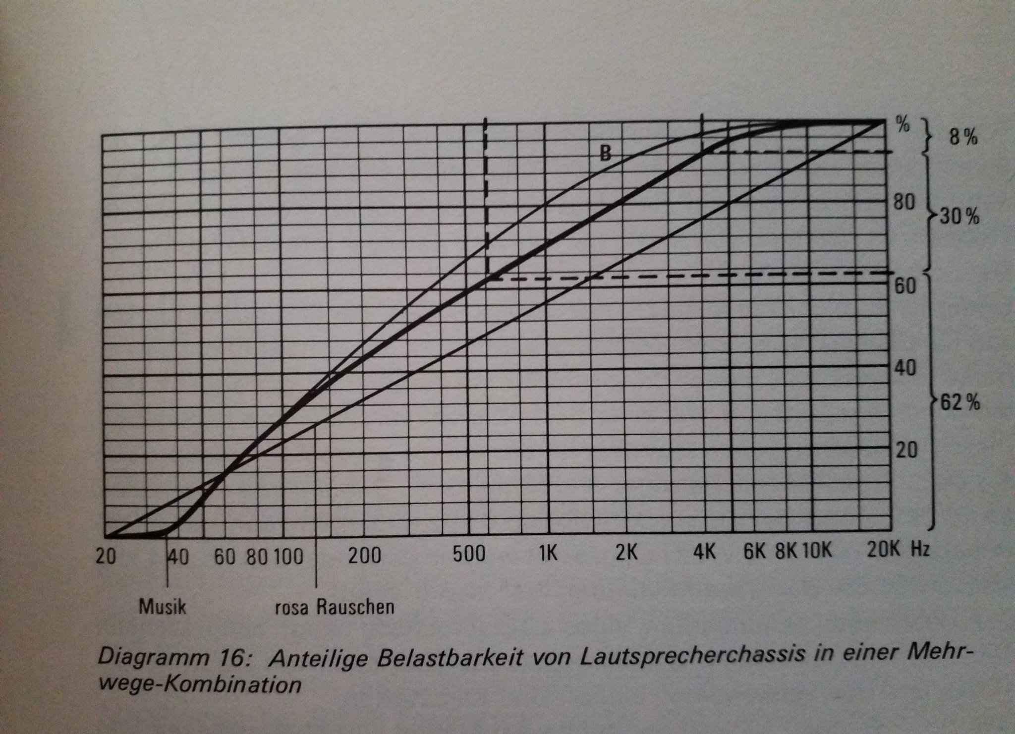

Here's the fundamental distribution of power all conventional multi way speakers have to deal with (taken from my old German speaker design book I've owned since the mid 80s)
You can see the fundamental power distribution for specific crossover frequencies and their spectral distribution of power across all the drivers. Yes, music has changed, but not by that much. With large orchestral transients, the tweeter on these Wilson's will be overwhelmed. It won't matter how steep the crossover slope is at below 1.4 - 1.5k

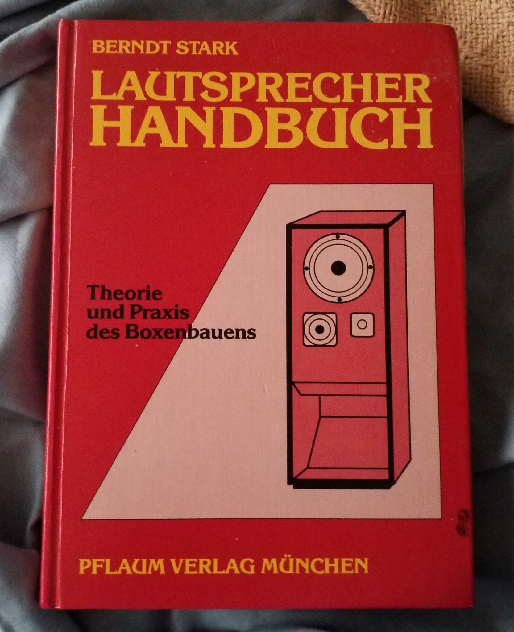

I've owned this book for a long time. It's what got me into building speakers back in 1984 when I grew up in (West) Germany. Lots of great specifc info in this book.
if you're not able to translate from German -
Rosa Rauschen = pink noise
The top curves are referenced to different types of music.
A typical system with a tweeter HP crossover point of 1.4k will require 10 - 25 % power distribution to the tweeter.
If system power handling is 100 watts while playing "music", the tweeter will see an average of 10 - 25 watts.
Even at very conservative power distribution, the tweeter on the Alexandria will need to deal with at least 10 watts. This is considering an average tweeter sensitivity to be close to the same as the other driver chassis. You can fudge it a little with more sensitive tweeters to increase power handling through voltage deviding networks (resistors).
This is all pretty fundamental speaker design knowledge. Just posting it in case there are some others who are doubtful.

The curve from your book, is it about acoustic or electric power? More recent scientific work seems to point out otherwise and even rock music doesn’t take more than an average 16% acoustic energy in the range 1k-4K. Above 4K the energy drops rapidly to a mere 2%.A typical system with a tweeter HP crossover point of 1.4k will require 10 - 25 % power distribution to the tweeter.
Plus you’d have to take into account that a lot of speakers have tweeters that are (far) more efficient than the mids and woofers, especially when baffle step is part of the deal. Imho (low) mid frequency drivers often are more limiting than tweeters.
Funny you have Berndt Stark lying around. I must have it somewhere too. Did you read the theoretical pieces of the Lautsprecherhandbuch from Michael Gaedtke too? Really underrated work from the ‘80s to me.
@markbakk I have his book as well buried somewhere. I sometimes brush through the old stuff to reacquaint myself with how things used to be done with charts, scientific calculators and even slide rules. I think I still have my old ported box tuning chart to figure out crude box tunings. 4th order bandpass just started to come out. We licensed it from Procus for the ACR Isostatik.

The Alexandria essentially appears to be a large 2 way with an extended range subwoofer underneath it. It looks and sounds alot like the equivalent of an old 60s Camaro with a 396 big block and Muncie M22 under the hood.
Anyways, I think the tweeter issue I have beef with is sort of self answering. Tweeter efficiency levels have risen a bit over time, but I don't see much evidence of this with speakers that utilize wide bandwidth tweeters.
I agree the Alexandria's tweeters (there are two per cabinet) are unlikely to be able to provide realistic "front row" orchestral transient levels, even with THD exceeding 10%.Yes, music has changed, but not by that much. With large orchestral transients, the tweeter on these Wilson's will be overwhelmed.
Seems your old German speaker design book is assuming the crest factor to be the same across the audio spectrum, like pink noise.The top curves are referenced to different types of music.

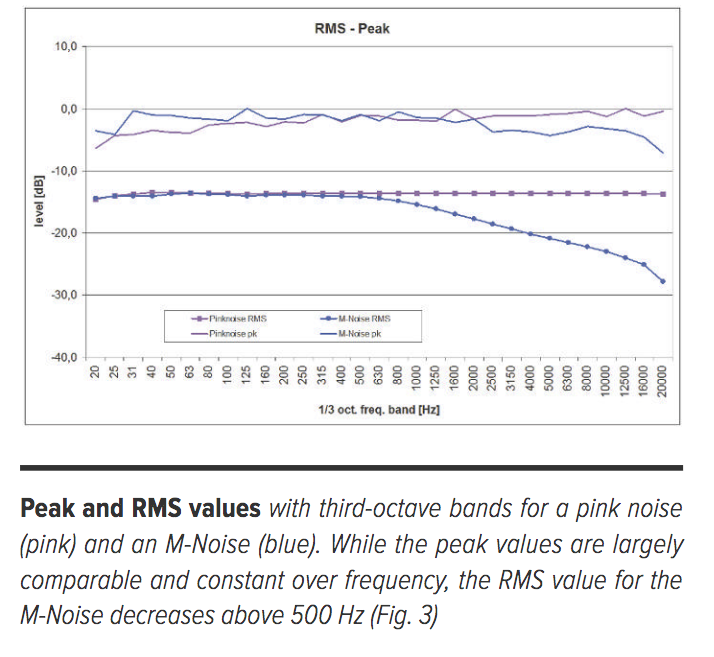

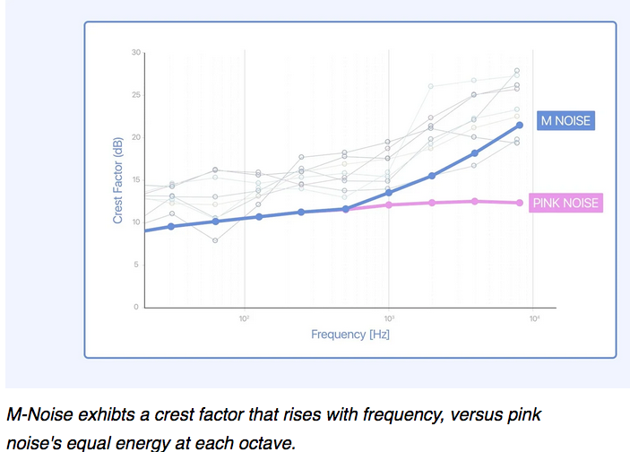

Meyer Sound did considerable research into the spectral content and dynamic range of music, in 2019 they came up with a new test signal to better represent it, "M-Noise" (Music Noise).
Although the peak levels are similar to pink noise (~12dB crest factor), musical crest factors rise with frequency above ~500Hz.If system power handling is 100 watts while playing "music", the tweeter will see an average of 10 - 25 watts.
The resultant average power decreases by ~-3dB by 1400Hz, -10dB by 10kHz.
That would cut your tweeter average power estimate by 50% or more, reducing the 25% to under 12%.

FSAF testing came to my mind with regards to this too as the music stimulus will prevent tweeters from attempting to spontaneously combust.
It is absolutely true that a tweeters power handling is lower than that of other drivers within a typical system and if you're going to do high level sine sweeps of any duration, stepped sine testing, or subject them to any steady state dual tone sine stimulus then they will quickly go up in smoke. It's also a fairly gross misrepresentation of a speakers capability too. If sine testing causes a tweeter to fail, or show excessively high distortion, but FSAF does not with 99.9% of music, then you can conclude that a speaker is fine with music signals specifically because of it's typical spectral power distribution.
But we can do power analysis using software that doesn't require looking at books with decades old power distribution charts making assumptions about what the tweeter is being delivered in terms of power. We can analyse music.
So I loaded up a piece of heavily compressed modern jazz/rock/pop. Lots strings, brass, distortion guitar, drums, bass, so it's spectrally dense.
Average level -11.6dB relative to a maximum peak level of 0dB.
Now lets apply a 4th order highpass at 1kHz average level -18.5dB.
2kHz -22dB.
3khz -25dB.
Lets say you were listening full-range at a level that required 100 watts when a peak of 0dB came along. Full range the speaker would be dissipating an average of, wait for it, 7 watts.
How about with the 1kHz high pass? 1.4 watts.
2kHz? 0.6 watts.
3kHz? 0.3 watts.
Scale this up by a factor of 10, so that the peaks require one thousand watts, and the tweeter is dissipating 14 watts on average.

Three highest octaves are mostly just harmonics in music, and low spl. Ie. up from 4kHz

There are a few tracks in my music collection with a 20dB peak to average ratio. Obviously short transients and most people wont have these records but still within THX specs if you listen at an average of 85dB at the listening chair. I tend to listen a bit lower than that.
