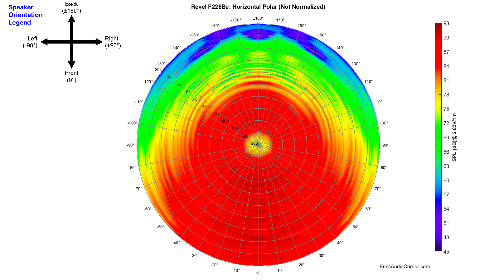

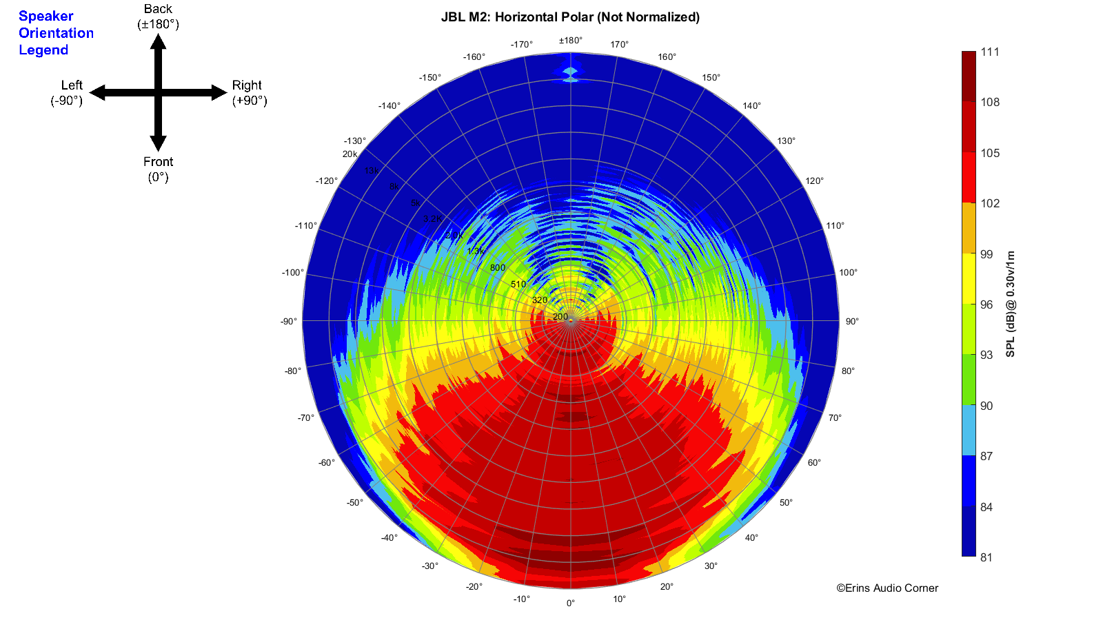

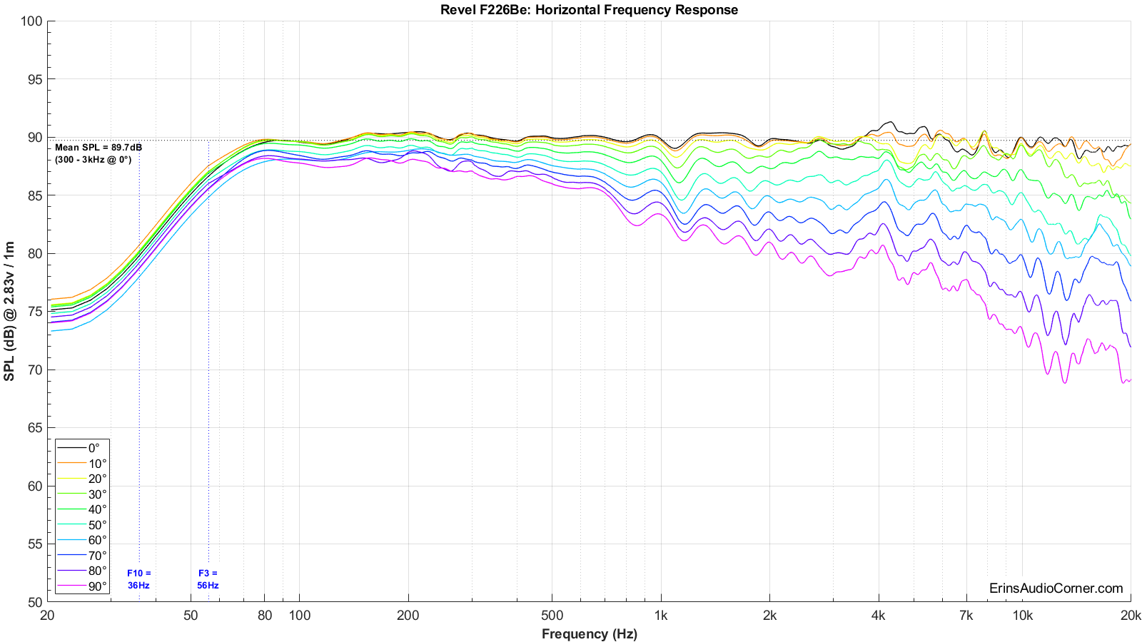

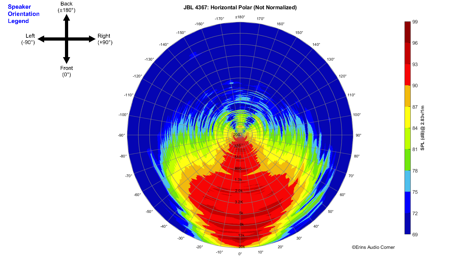

Sorry, but 4367 is not wide or smooth
compared to M2
huge difference to narrow box+WG Revel F226
compared to M2
Right!huge difference to narrow box+WG Revel F226
But keep in mind the difference in scale 30 dB for the first two and 50 dB (or 48) for the Revel.
NFS software settings had changed - here both in 50dB scale, but still different smoothing
Revel
M2

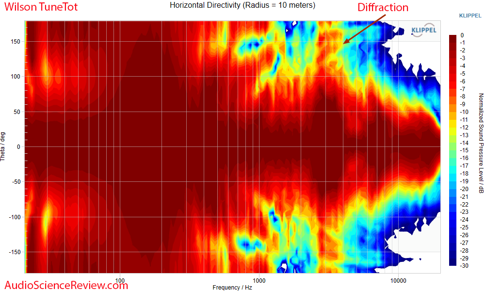

and Wilson TuneTot https://www.audiosciencereview.com/...eview-high-end-bookshelf-speaker.29219/page-3
(sorry different type of graphics)
Revel
M2
There is more than one way to pull dispersion out wider than the direct radiator would (besides a typical diffraction horn with a slot at the throat).This is one way you can see what you have.
The OS waveguide eases and guides them out that way. If the wavefront or the waveguide are not right, it won't be effective. The LeCleach horn has a similar way of following extra-wavefront expansion, but has a different outcome.
Another way could be to diffract the wavefront using champhers out from the throat, similar to the way Olsson used the secondary flare to create functional diffraction.

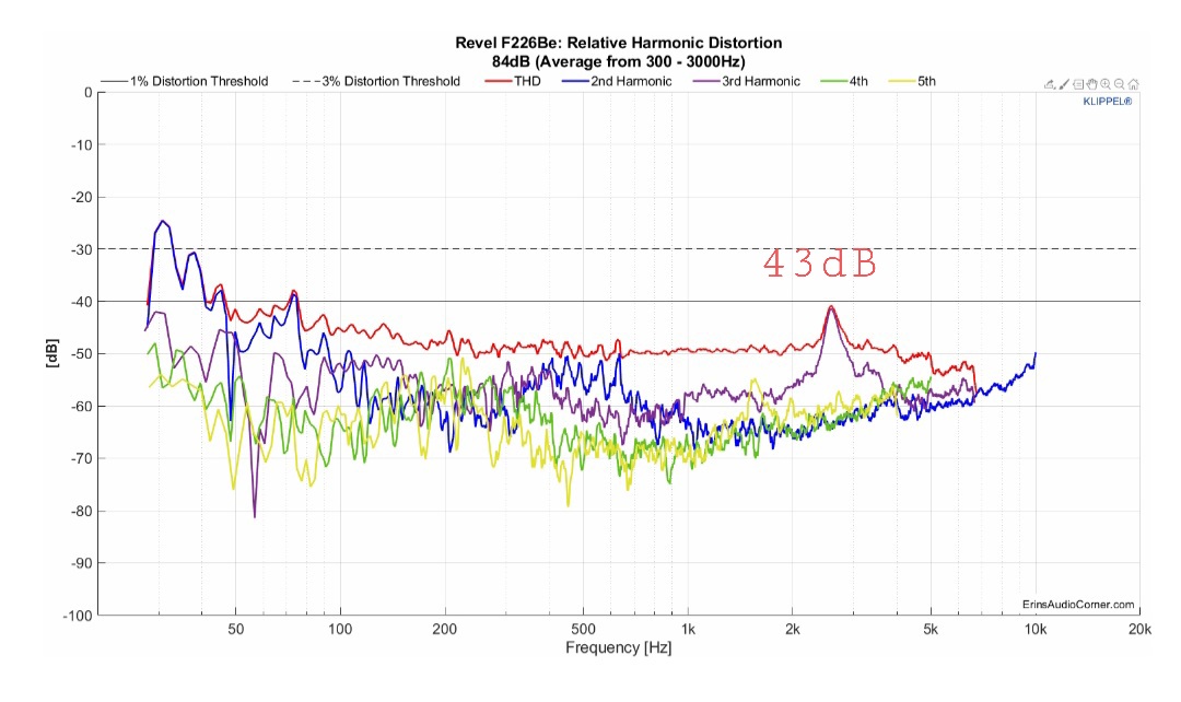

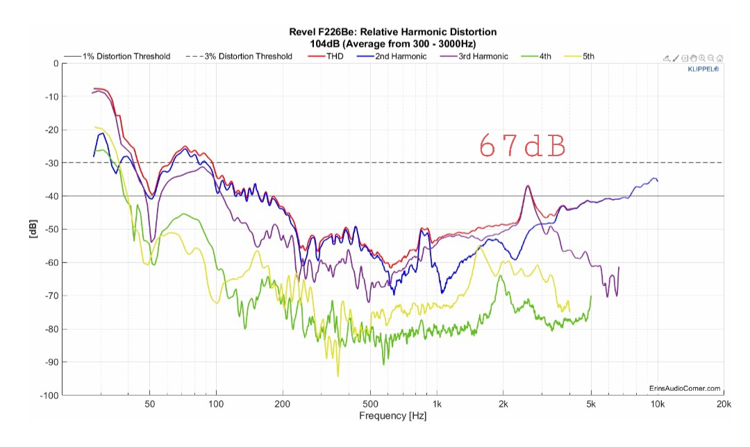

With the Revel223, here is a good example of a distressed sounding tweeter. This will be a very audible 3rd order harmonic at 2.5kHz.Right!
At 84 dB nominal output level, the 2.5k, 3rd order peak will be a 43 dB peak
At 104 dB nominal output level, the 2.5k, 3rd order peak will be a 67 dB peak

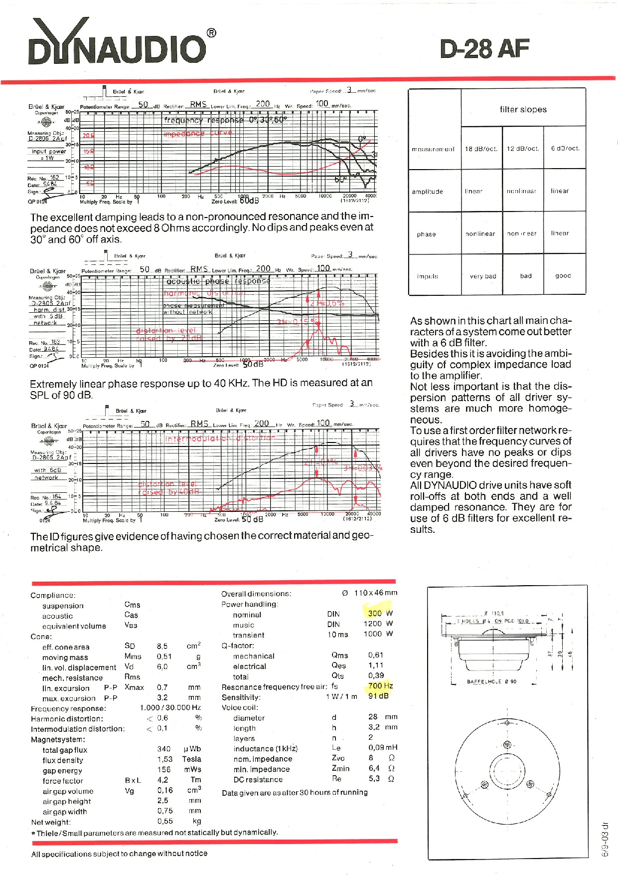

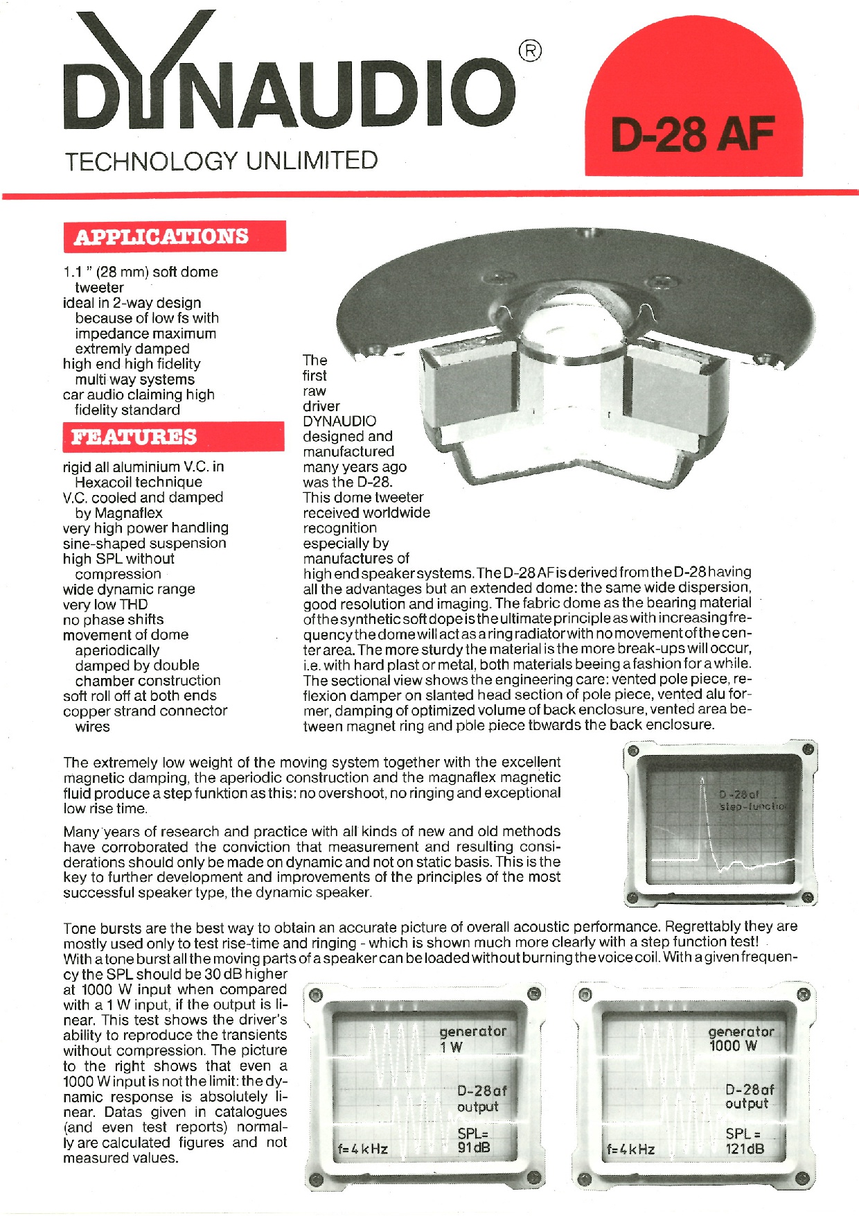

Dynaudio used to market some of their drivers being able to handle 1kW sine burst without compression, don't know how much that is worth, they had some oscilloscope pictures which is by today's standards a bit crude.
For instance, the D28 AF has a power handling capability of 300 Watt DIN, and 1200 Watt DIN Music. (To be honest it sounds quite a lot)
https://hifi-wiki.com/images/4/4b/DYNAUDIO_D28AF-001.jpg
https://hifi-wiki.com/images/c/c1/DYNAUDIO_D28AF-002.jpg

@UniQ That peak power handling is sort of a redundant number which can be comparable to quite a few other decent HF domes.
Just because the VC is wound from a hexagonal wire cross section doesn't designate it as being able to handle any more amount of peak power than any other higher performance soft dome ie. ScanSpeak D2905-9700.
The aluminum VC former is more of a designating spec than anything else being able to absorbe the peak thermally. The Ferrofluid is another one of those little details. It will conduct a large part of that thermal peak to the motor.
In the end we're only dealing with a driver that has an average thermal constant power handling of 10 - 15W on a good day. The physical mass of the VC, its neighboring components and the adhesives used to attach them all will define this number more than anything else.

Are we sure that's even a tweeter issue? It looks like it could very easily be a resonance amplification from the midrange driver. The frequency is perfect for a primary breakup of 8kHz. Besides a 1" dome struggling with a frequency of 2.5kHz and in a waveguide? If the tweeter was struggling you'd expect the 2nd order to be on the way up too and it's not.With the Revel223, here is a good example of a distressed sounding tweeter. This will be a very audible 3rd order harmonic at 2.5kHz.
At 84 dB nominal output level, the 2.5k, 3rd order peak will be a 43 dB peakView attachment 1465992
At 104 dB nominal output level, the 2.5k, 3rd order peak will be a 67 dB peakView attachment 1465993
Actually look at the 4th and 5th harmonics in the midrange. There's your 2kHz and 1.6kHz bumps. This is not the tweeter struggling it's a midrange distortion peak from cone resonance amplification. Revel should have stuck with SB Acoustics and their ribbed cones.
If you've listened to these and thought something was the tweeter struggling then you were fooled by a midrange issue.

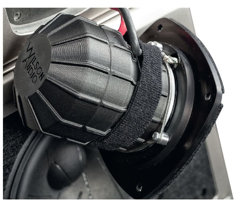

attach a big a large rear chamber, like Wilson Audio do:
and crossover at ~1.1-1.2KHz LR4, like Wilson Audio do, in their XLF, and then play some music.
An off the shelf-D2904 (4 ohm-impedance)/7100 0X(faceplate variant) has a voltage sensitivity of 94.5dB /2.83V and Fs of 520Hz
And if this tweeter can have a sub 500Hz Fs, it wouldn't be unfathomable that Wilson's tweeter, with a, IMHO, enormous midrange sized rear chamber could have an Fs well below 500Hz, and thus handle a crossover point a relatively low XO point, with real music?

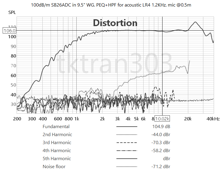

Here I am stress testing a smaller 90dB/2.83V 4ohm nominal off-the-shelf dome tweeter at 100dB/1m, with an acoustic LR4 @ 1.2KHz
But even thought we may like to do sine sweeps... to show that this tweeter can manage LR4 1.2KHz, an exponential sine sweep, with a duration of seconds (12 in my case) is not all representative of real music...

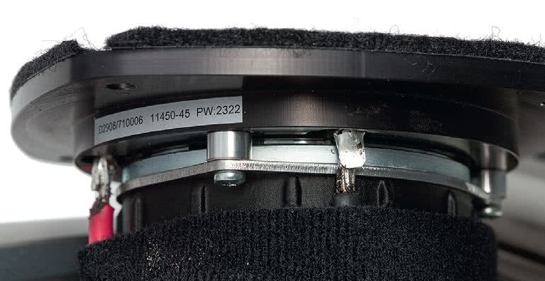

Soldered wire to a terminal appears as if it were DIYed. Is that supposed to be original or modded?
Why not just use it through the resonance? By increasing the box size, the response near resonance will droop and have to be compensated for by more drive. The low end will be more extended.. will that be reduced with heavier filtering or will it contribute to needless excursion?enormous midrange sized rear chamber could have an Fs well below 500Hz, and thus handle a crossover point a relatively low XO point, with real music?
in a 9.5" waveguide!that this tweeter can manage LR4 1.2KHz
Original.Soldered wire to a terminal appears as if it were DIYed. Is that supposed to be original or modded?
Those pics are from the later Alexia V model, which was crossed at 1.5KHz, whereas in the Alexandria XLF it appears to be around 1.15KHz.

@stoneeh ‘s look at higher 110dB SPL sine sweep in a 8” waveguide. Also, Polar map measurements here
