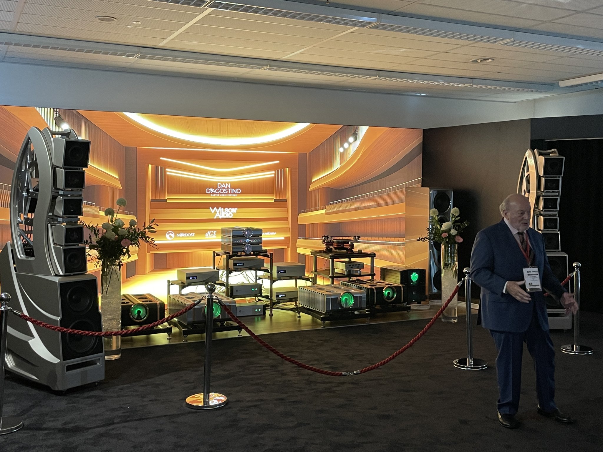

That is one ugly loudspeaker.Hi there,
is this the design you want to talk about?
https://www.wilsonaudio.com/products/alexandria/alexandria-xlf
So far - so good, Stefano
If this is the subject we should leave out design questions - please - i think it's awful ...
