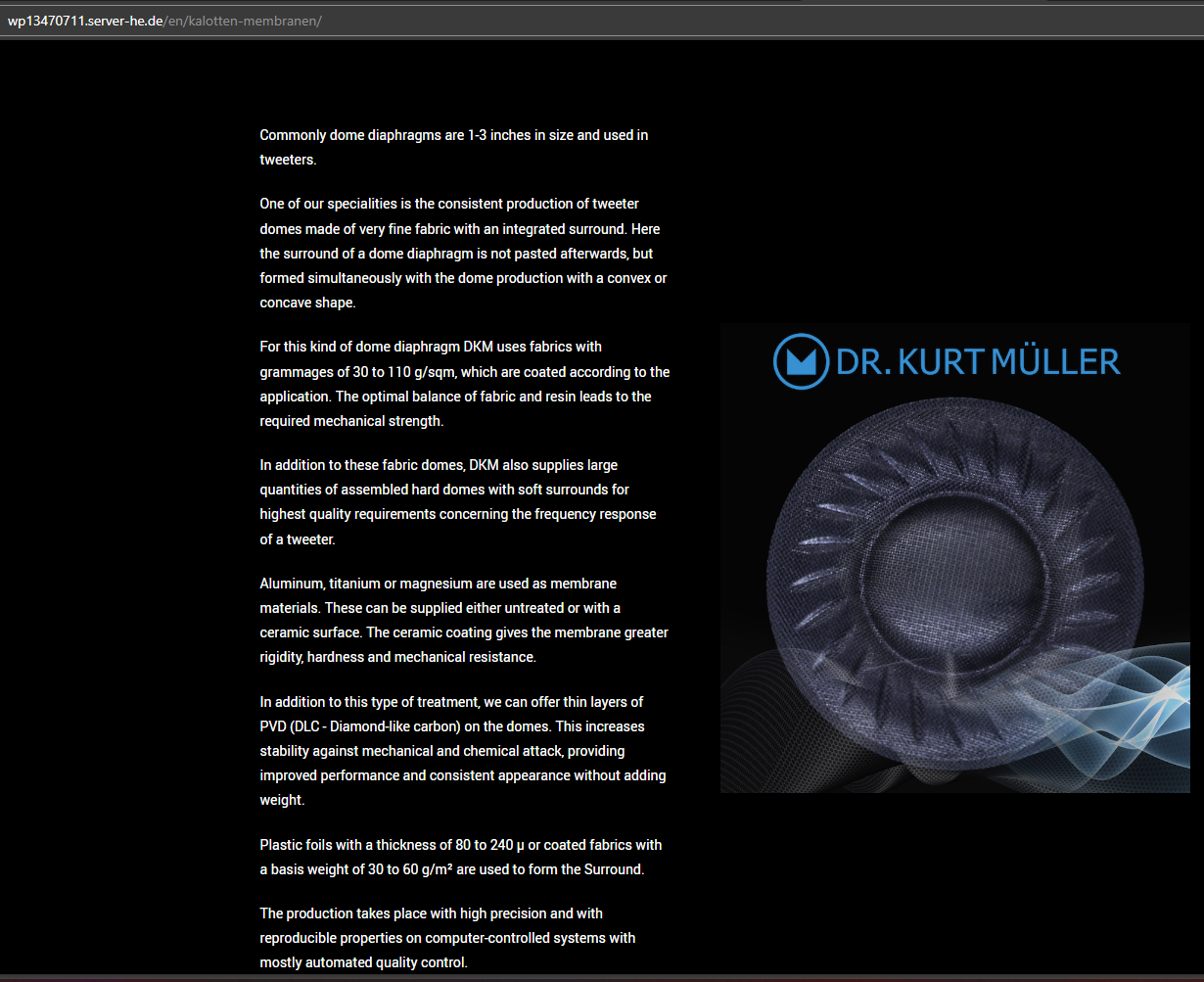

- Tiny tweeters used in the Wilson Audio Alexandria?
