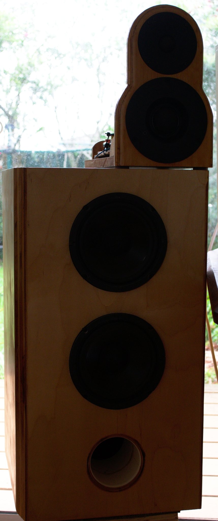

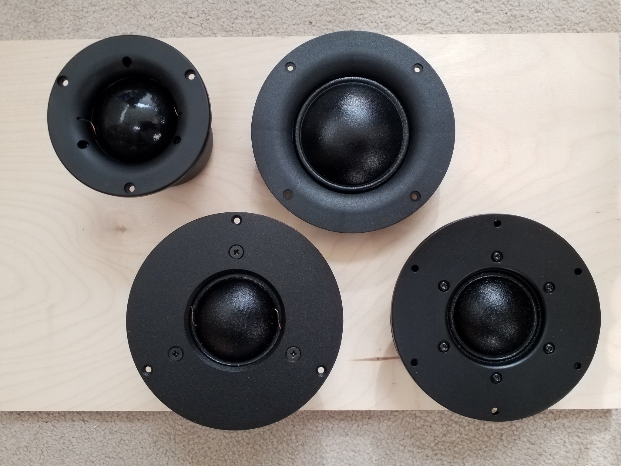

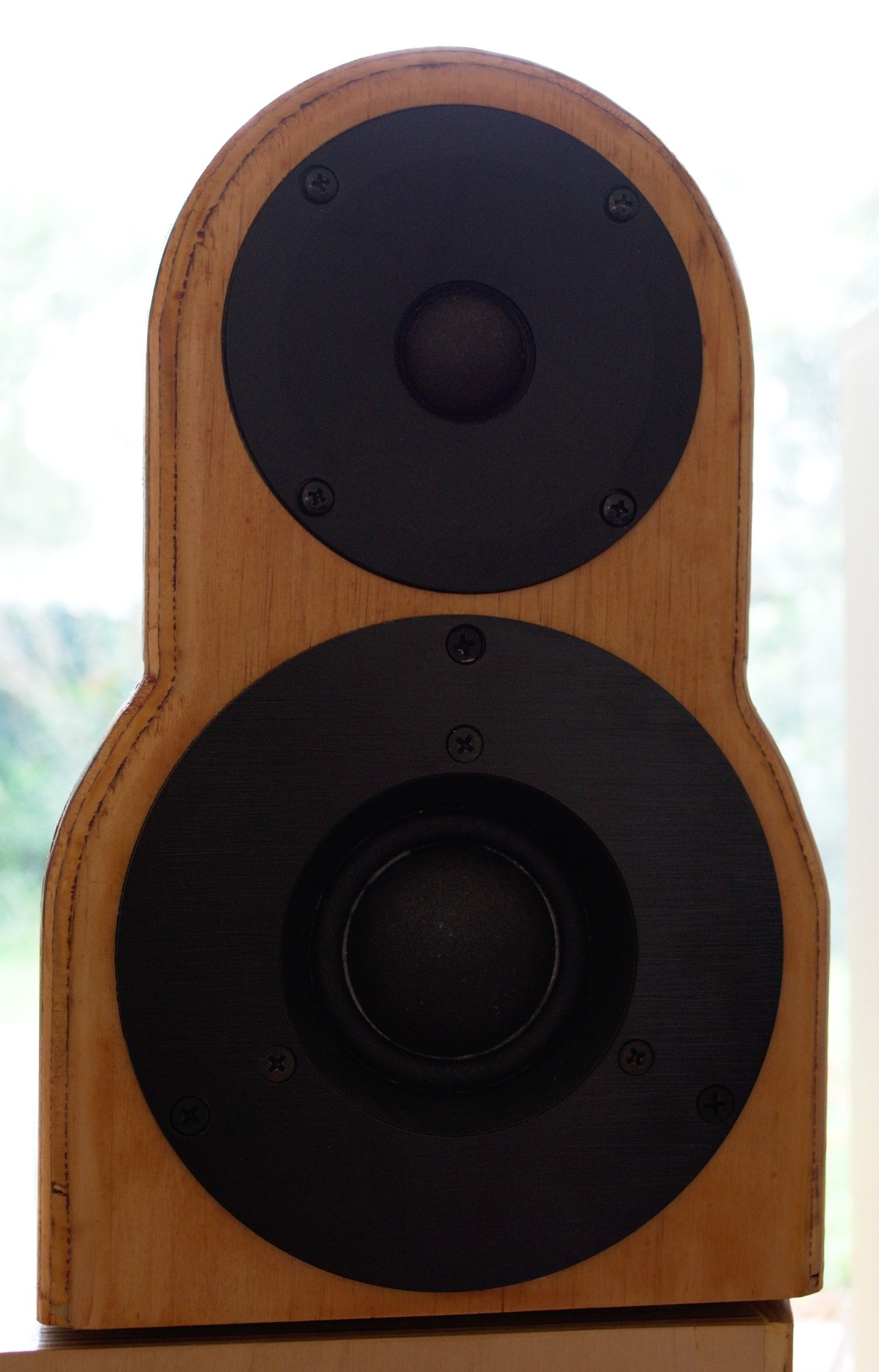

As you can see, I'm a big fan of dome mids...
Pictured are the Morel CAM558 (MDM55 with round faceplate)
Scanspeak D7608-9200
Dynaudio D52AF
Hivi DMB-A

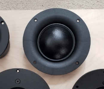

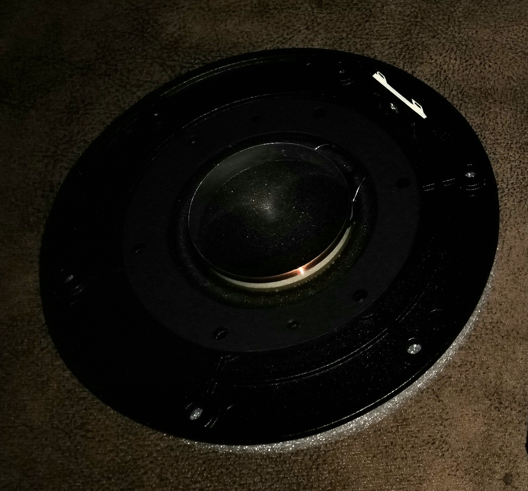

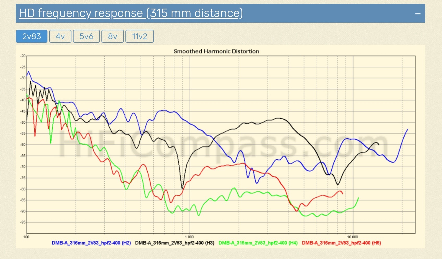

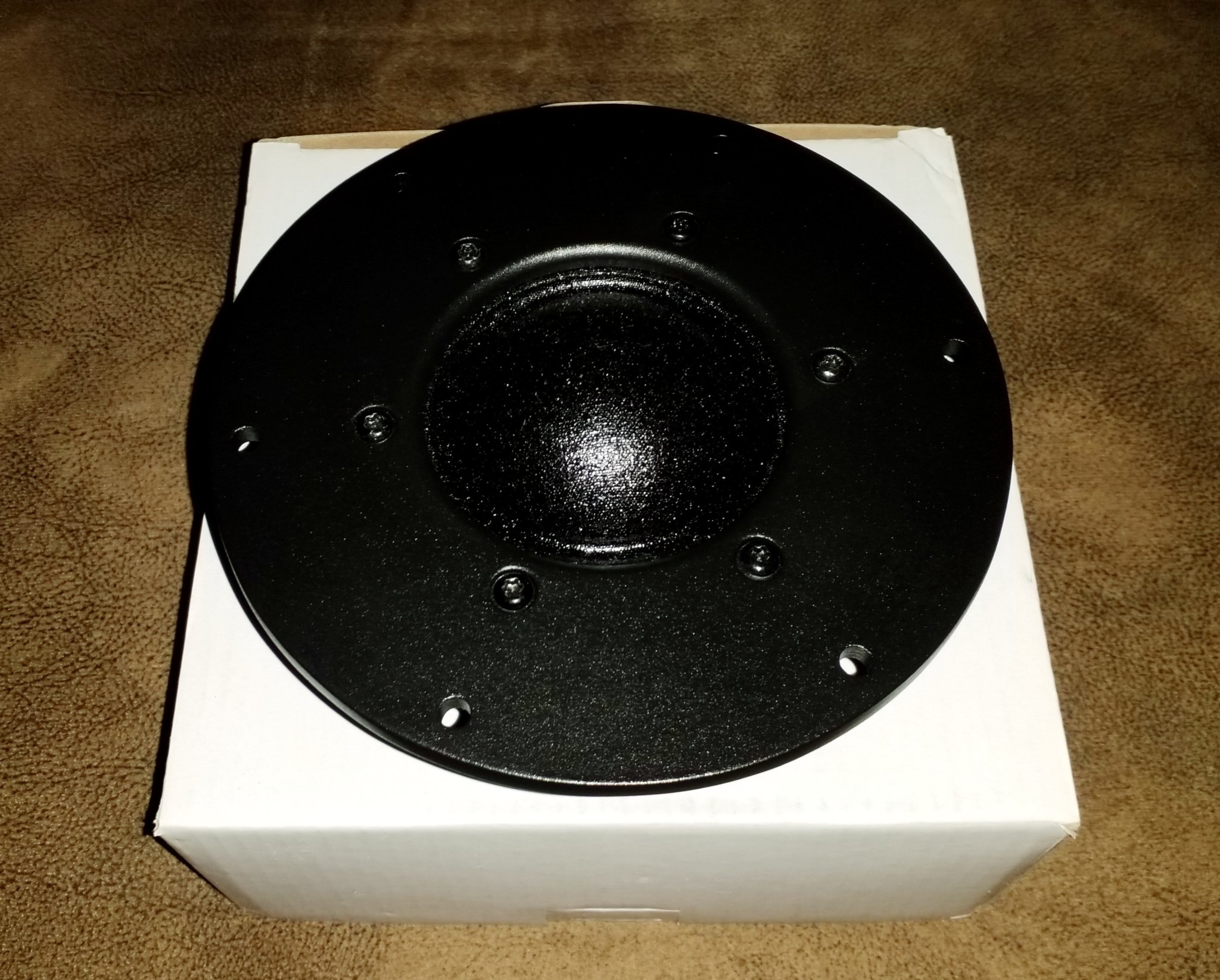

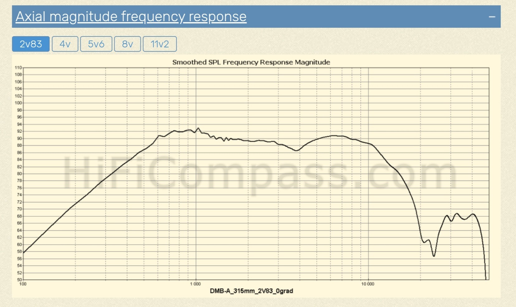

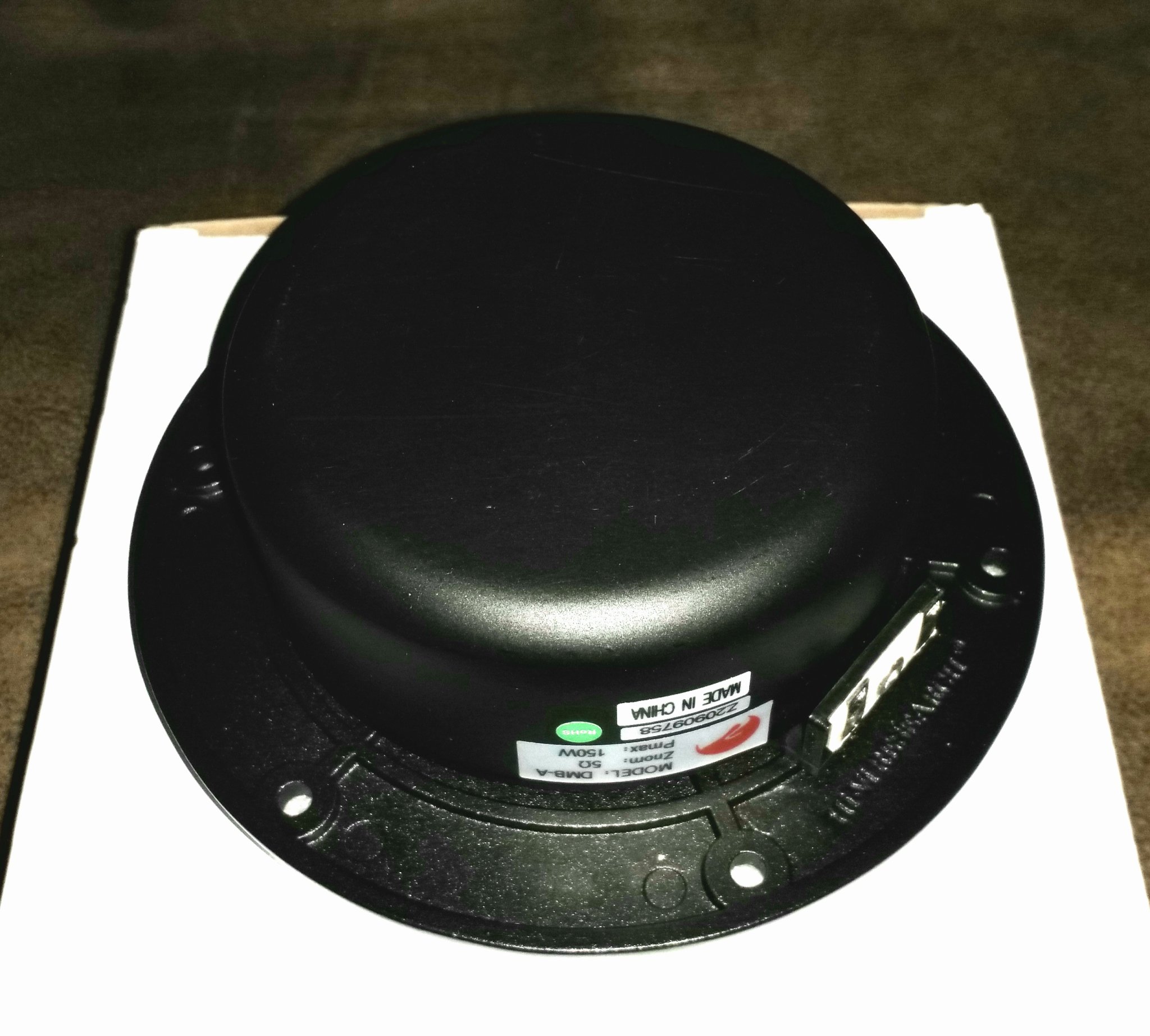

Here are more of the Hivi DMB-A
Its sold for under $30 and is quite the bargain.

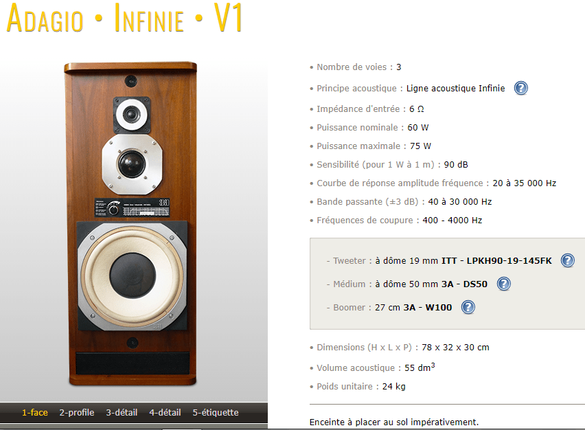

Sorry @profiguy : I never used any dome midrange despite their excellent qualities... Why ? Usually in a 3-ways configuration :
  • Average to low dB efficiency, barely over 90dB/W/m.
  • WF to MR Xover transition frequency that must be set quite high (600 to 1000Hz) due to FS in the 500-900Hz.
One (French) exception was the 3A Adagio Infinie, (below) which used a 2" dome midrange able to reach 400Hz :
For a 4-ways (bass/mid-bass/high-mid/treble), it would be much more favourable concerning the usable bandwidth, but dome midranges with higher efficiency are rare...

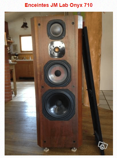

Another (French) exception was the 4-ways first series JM LAB ONYX 710 (below) which were fitted at the top with a 3" dome used in a high-mid configuration - I think it was a rebadged SEAS model ? Not sure, though. These large loudspeakers were rated at 95dB/W/m efficiency :
But both the 3A DS-50 and JM LAB H304 large dome midranges are not available anymore today, to my knowledge...

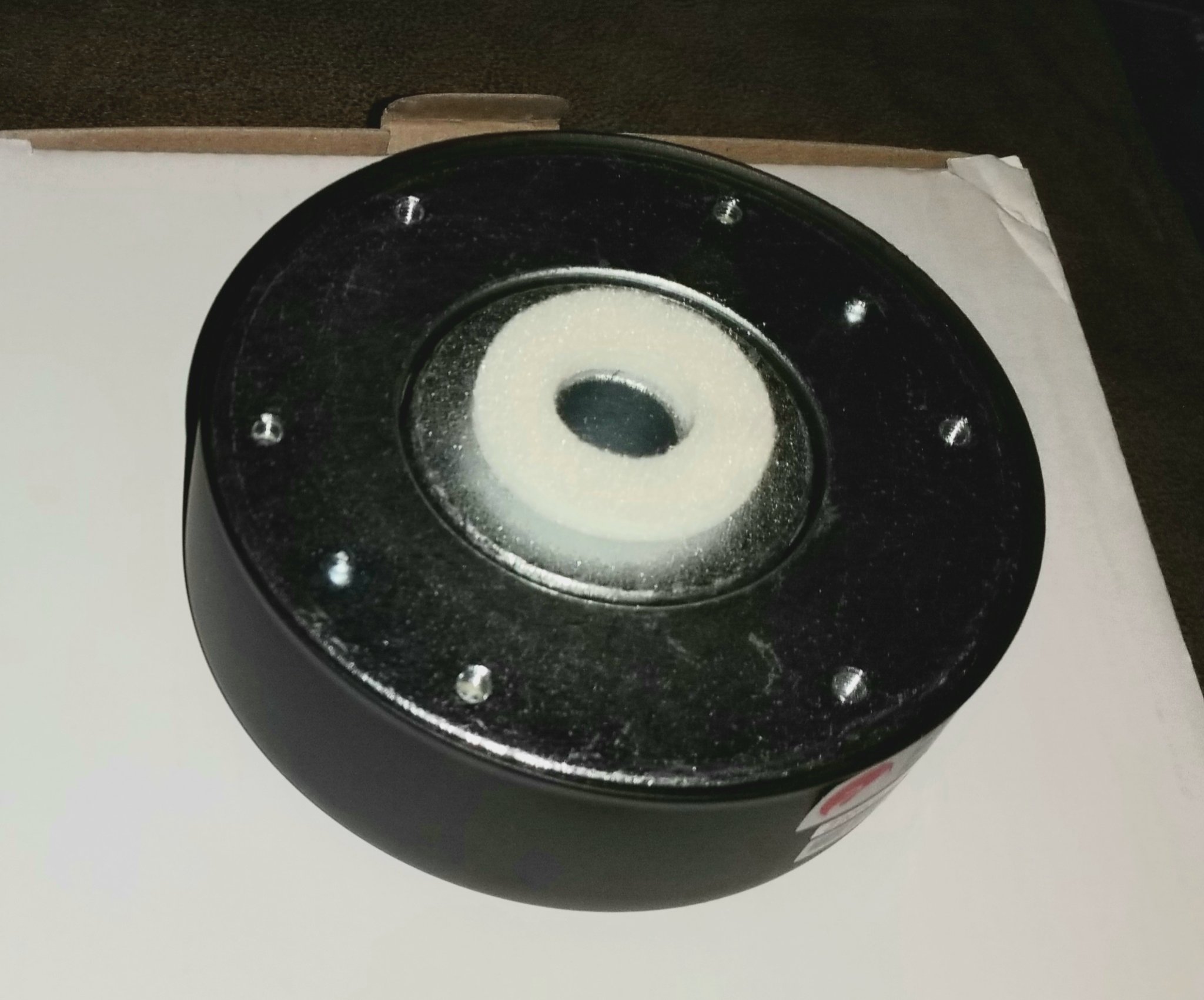

Two questions from me for now. First, does using a dome mid mean you can work with dome tweeters on a flat baffle (stepped/tilted baffle or waveguide not needed) without alignment worries? Second, for the D7608 chamber, why is a cup better or different from just a correctly dimensioned closed chamber in the cabinet as per any design with a cone mid?

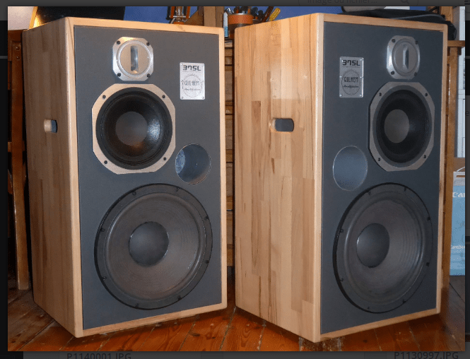

Well, this large dome midrange would have been a cool addition to my 95dB/W/m DIY Vintage Monitors 375L (below)... If it had reached the required 95-96dB/W/m too ! 😕
But since I have a project of big sealed enclosure with a circa 92dB/W/m efficiency, then I could shift from a 3-way to a 4-way configuration, using that Scan-Speak D7608-920010 in the High-Mid position... 😎

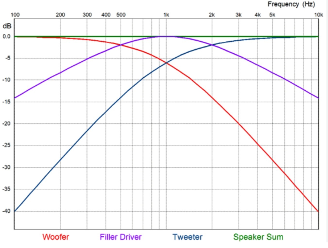

Concerning the sensitivity figures, you have to remember that a mid driver with lower efficiency can compliment a higher sensitivity system simply due to lower level FR overlap of the LF and HF drivers adding to the total midband energy. This let's a mid with a few less dB sensitivity combine to produce flat FR. Add to this any peaking of the HP and LP filters and it further lowers the necessary sensitivity of the mid itself to compliment higher system sensitivity. The mid essentially takes on the roll of a filler driver rather than a wide band mid.
