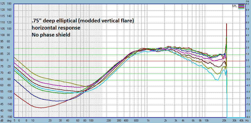

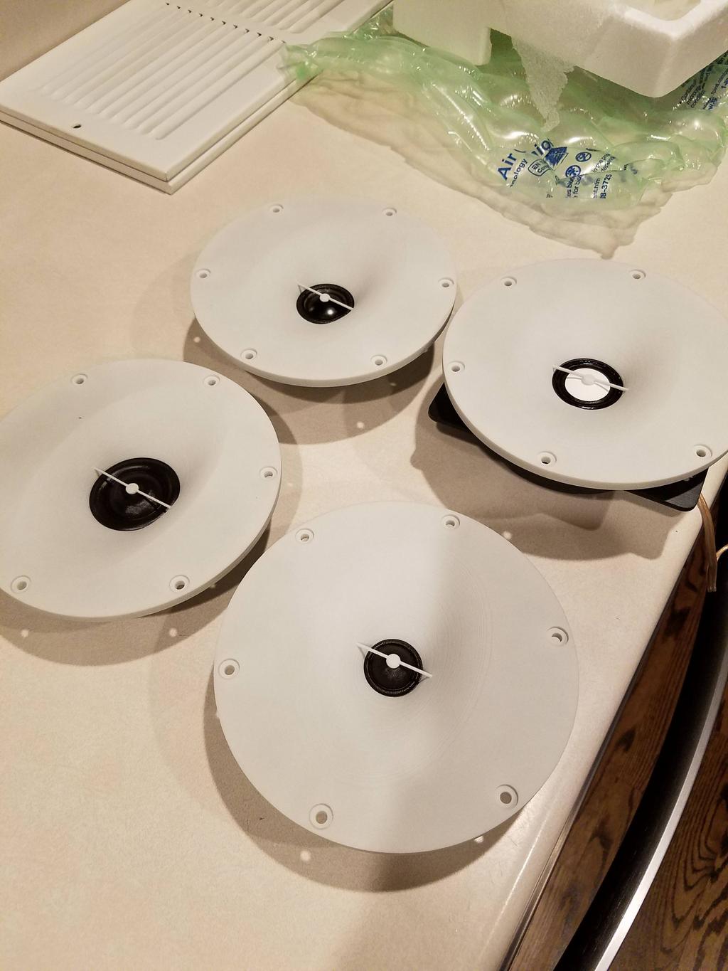

I've been working on a waveguide project where I would develop high performance waveguides for some popular tweeters, and than share the files for anyone to print or CNC as they are able. The discussion started here: 3D printed waveguides - Techtalk Speaker Building, Audio, Video Discussion Forum for more details. The short summary is starting with the SB26ADC and a 5" waveguide, I varied flare radius, phase shields, depths, etc. I've started to find some best practices (at least with this dome/horn combo) and all future guides will have elliptical mouths, and with and without phase shields. I then skipped to 8" designs to verify those best practices scale, so anything in between should be trivial to design and still have the expected performance. Tweeters that I'm currently designing for are: SBA SB26ADC, SBA SB19ST, Satori TW29RN, and Transducer Labs N26C-A.

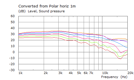

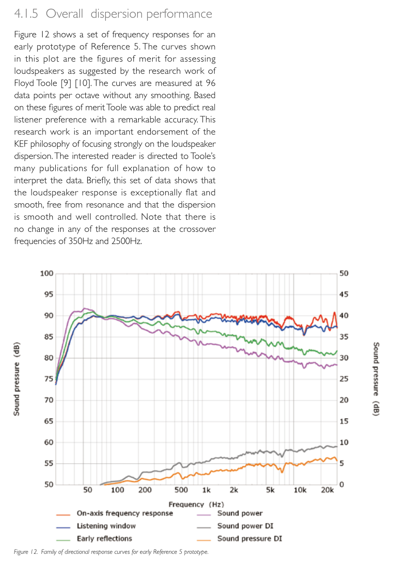

To get some frame of reference, here measurements of the Kef Reference 5 prototype, and Revel Concerta2 (which I suspect also uses the SB26ADC):

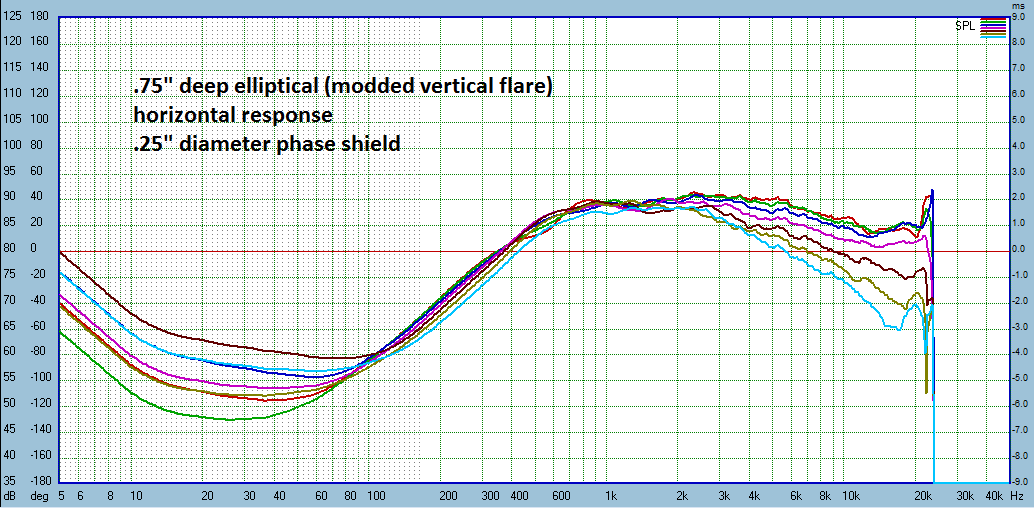

Here is my "C" waveguide with SB26ADC, with and without phase shield:
Quite good results I think, better than Revel achieved with the same tweeter! Anyway, the reason I am posting now though this project is still in its infancy, is I've connected with a couple gentleman with the ability to model waveguides. This could speed things up considerably, as waveguide design is extremely iterative otherwise because 90% of the performance happens at the dome/throat interface and this is not easily modeled.

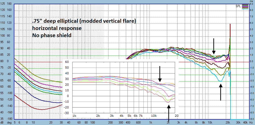

We've started with verifying that the sim can accurately predict reality. With as close a representation as possible of the dome here are the results:
Extremely encouraging! I'd like to do some additional verification - particularly of the 8" guides I've started working on - and then I hope to push the sims to the max, and start producing some really excellent guides for popular tweeters.
BTW I should add some background on measurement conditions. I use MLS signal with a 6ms gate to remove the first reflections. Measurements were at 1.5m or so, with a calibrated mic. The baffle was not the big baffle I used for measurements at my drivervault site, but 2'-ish by 3'-ish rectangle with the driver offset. Sim showed quite smooth response to about 1khz, but I suspect diffraction is starting to creep into the measurements <4khz and are significant closer to 1khz. Angles are 0-60 in 10 degree increments.
Very cool work. So these just mount on top of the existing tweeter faceplate? No disassembly of the tweeter?

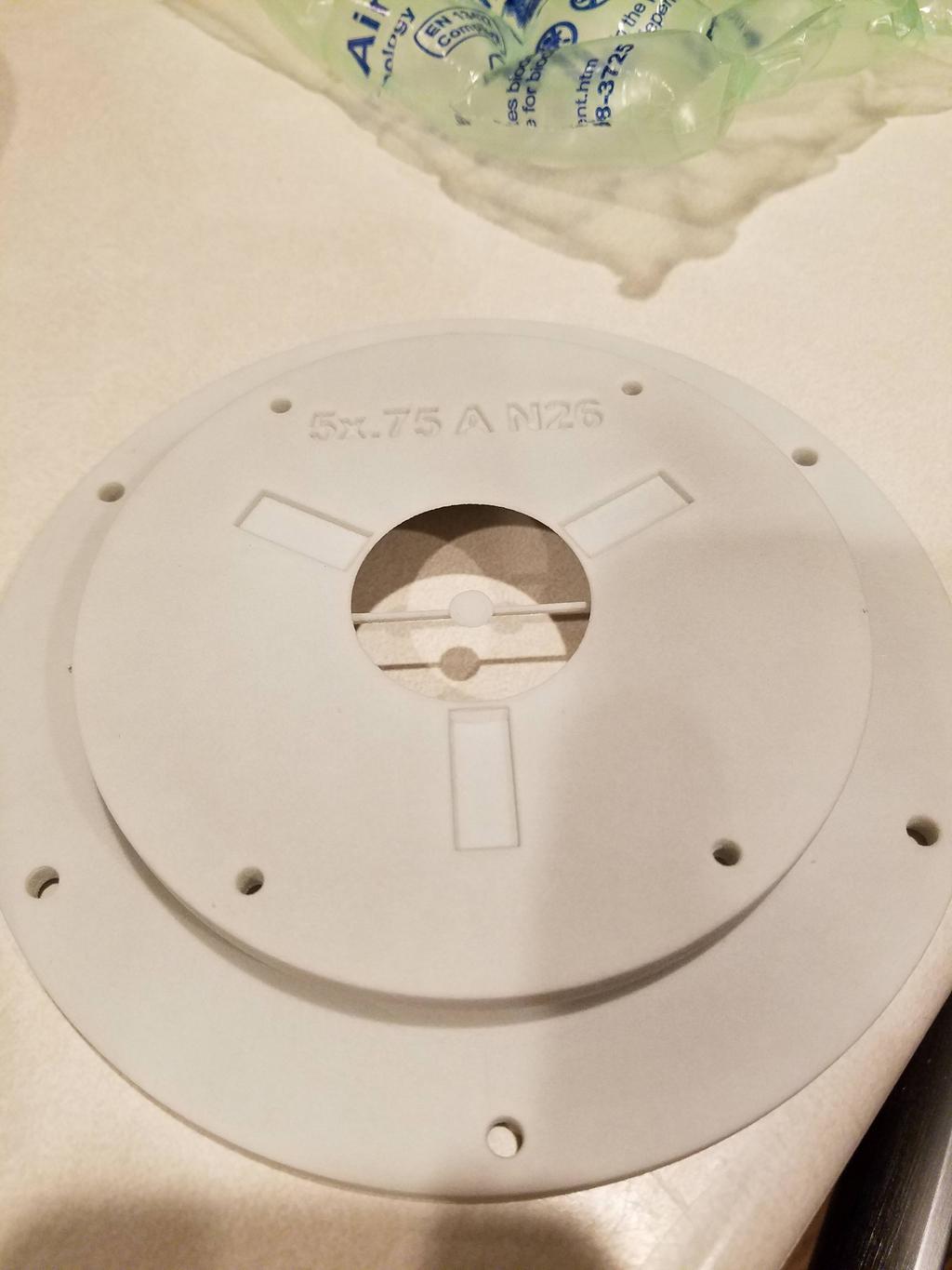

I have access to a CNC machine, if you want to prototype a pair in aluminum let me know, I can probably make that happen. Not sure I can make the waveguide with integrated phase plugs though. Might have to be 2 pieces, or it might just be really difficult to do in any case. If you have 3d files in .stp format it's pretty trivial for me to see how bad the CAM work would be.
Mounting depends on the tweeter. For all the SBA/Satori drivers, their faceplate comes off easily and is not integral to locating the diaphragm like many tweeters are. So pretty easy to mate, and they have keyholes, so matching that in my design makes centering the dome pretty much plug-and-play. The Transducer Lab tweeters require the faceplate to stay attached or you'll rip the diaphragm off with it. Luckily there flat faceplate again makes mounting very easy.
Early on in the thread at PE, we discussed this, and it would be fairly easy to design the phase plug as a standalone item with cylindrical keys at the end, with a matching depression in the waveguide wall which would be easily made with the end mill of the CNC. I "hope" with some optimization the phase plug won't be necessary.
