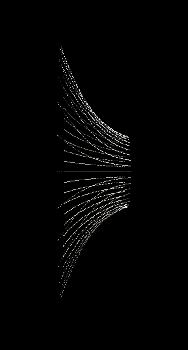

Open source Waveguides for CNC & 3D printing!
Nate, I'll post the project here or give a download-ling via PM. It will need some time, as I have to clean up the scipts - I did not have in mind to share, when setting up simulations for these waveguides.

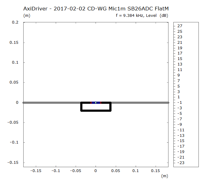

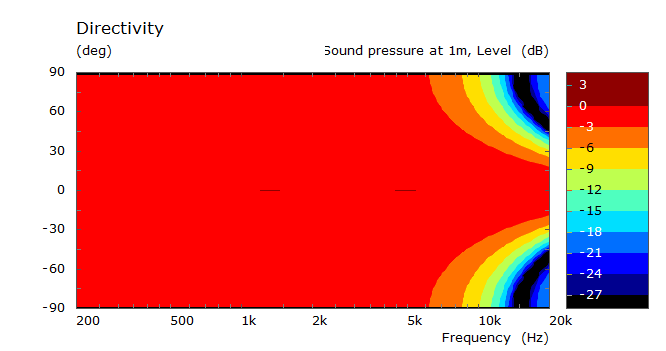

I did some simulations with 3 different phase plugs. I think that the specific design of phaseplugs/phaseshields for a waveguide is a very good tool to achieve (as good as possible) constant directivity up to the high frequency range.
Reason is that a 1''-membrane already starts to beam >6kHz. This simulation (done using AxiDriver) shows a 25mm membrane in an infinite baffle (with SB26 TSPs):
and the respective directivity plot (normalized to 0°):

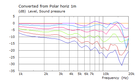

Now, where do 'phase-shields' (often seen as small, round, transparent plastics fixed at the back of protecting grids in front of metal domes) impact the directivity of dome tweeters?

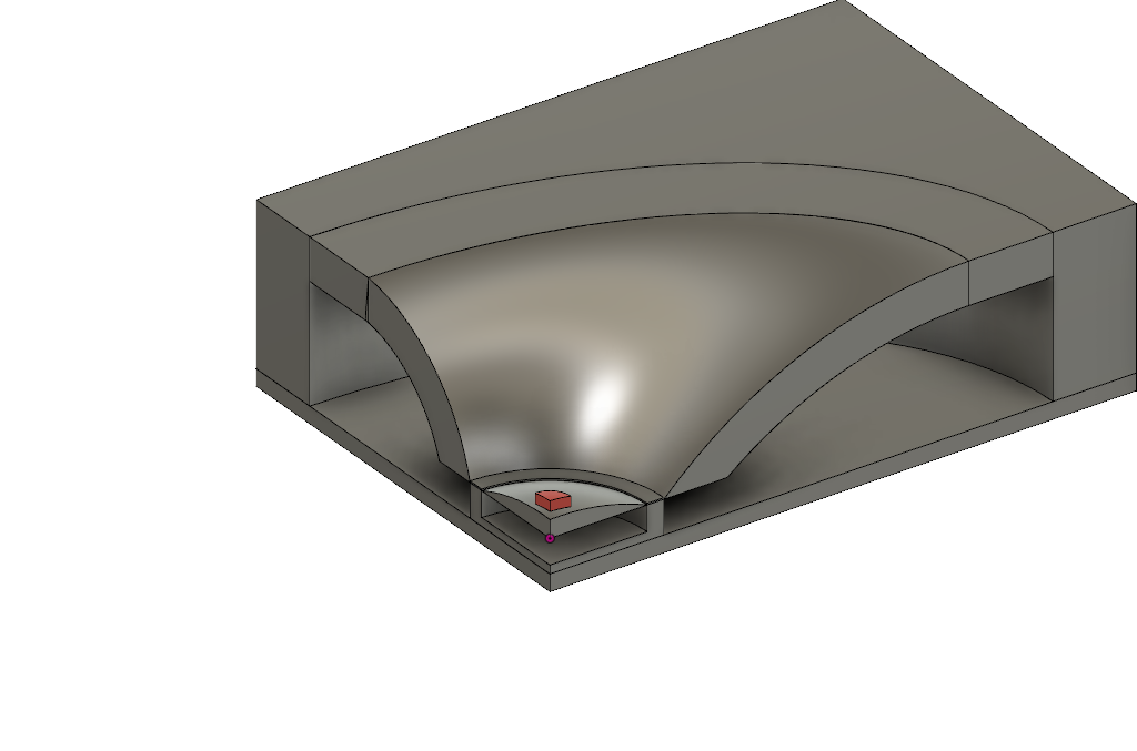

This is a simulation of Brandons eliptical waveguide 'C' with a small phase-plug V1:
The respective SPLs from 0-90°, 15°-steps, normalized to 0°:

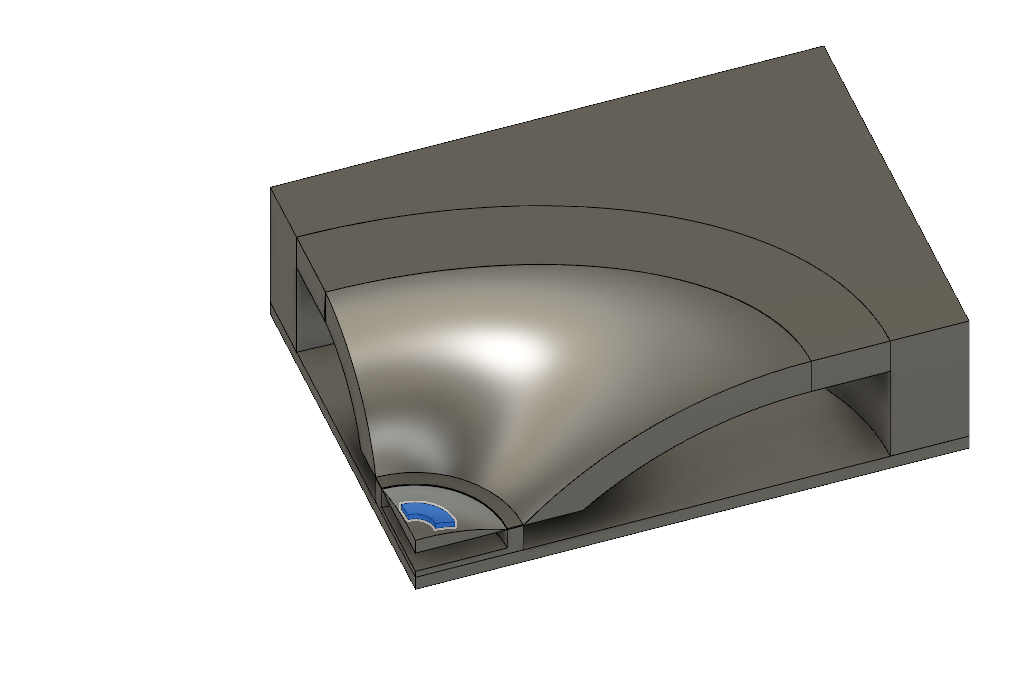

And a phase plug version 3, a ring with central hole:
Again the directivity 0-90°:

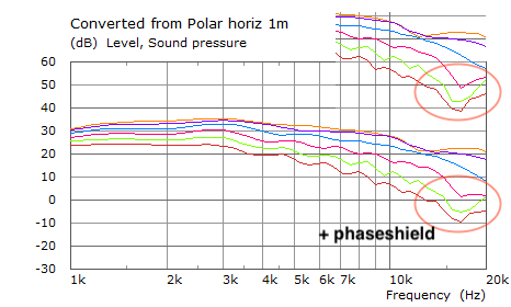

Where does the phase plugs impact directivity? As a comparison, the directivity 0°-90° of the waveguide without phase plug vs phase plug V2:
For better comparison the horizontal directivity without phase plug:
The effects of the phase plugs appear around 13-20 kHz, where the WG-contour has no effect (may be beside bad match of tweeter membrane and WG-throat).

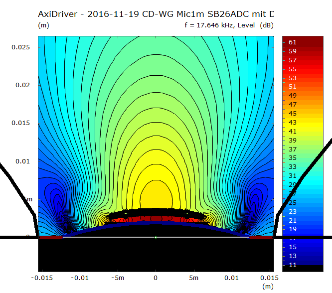

I did simulations to compare the impact of a simple 'disc' vs a 'ring-type disc' in the waveguide thread here. Diameter and placement of the 'disc' and 'ring' were identical.
Here, the ring had a positive impact in that it resulted in a more constant directivity between 15 and 20 kHz.
Simulations done using AxiDriver. Disc phase plug in front of SB26 dome:
Directivity -90° to 90°, normalized to 0°:
Note the 'widening' aroud 17kHz.

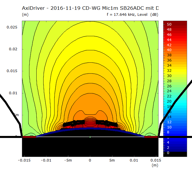

Same simulation with 'ring' phase plug:

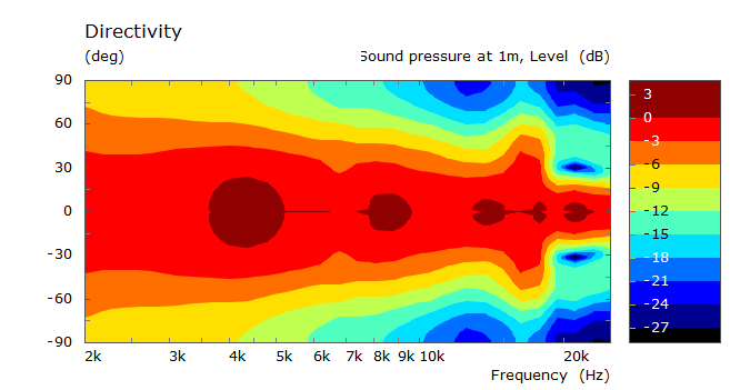

Directivity, normalized to 0°:
The 'widening' smears over a larger frequency range and shifts to higher frequencies, resulting in a more constant directivity.

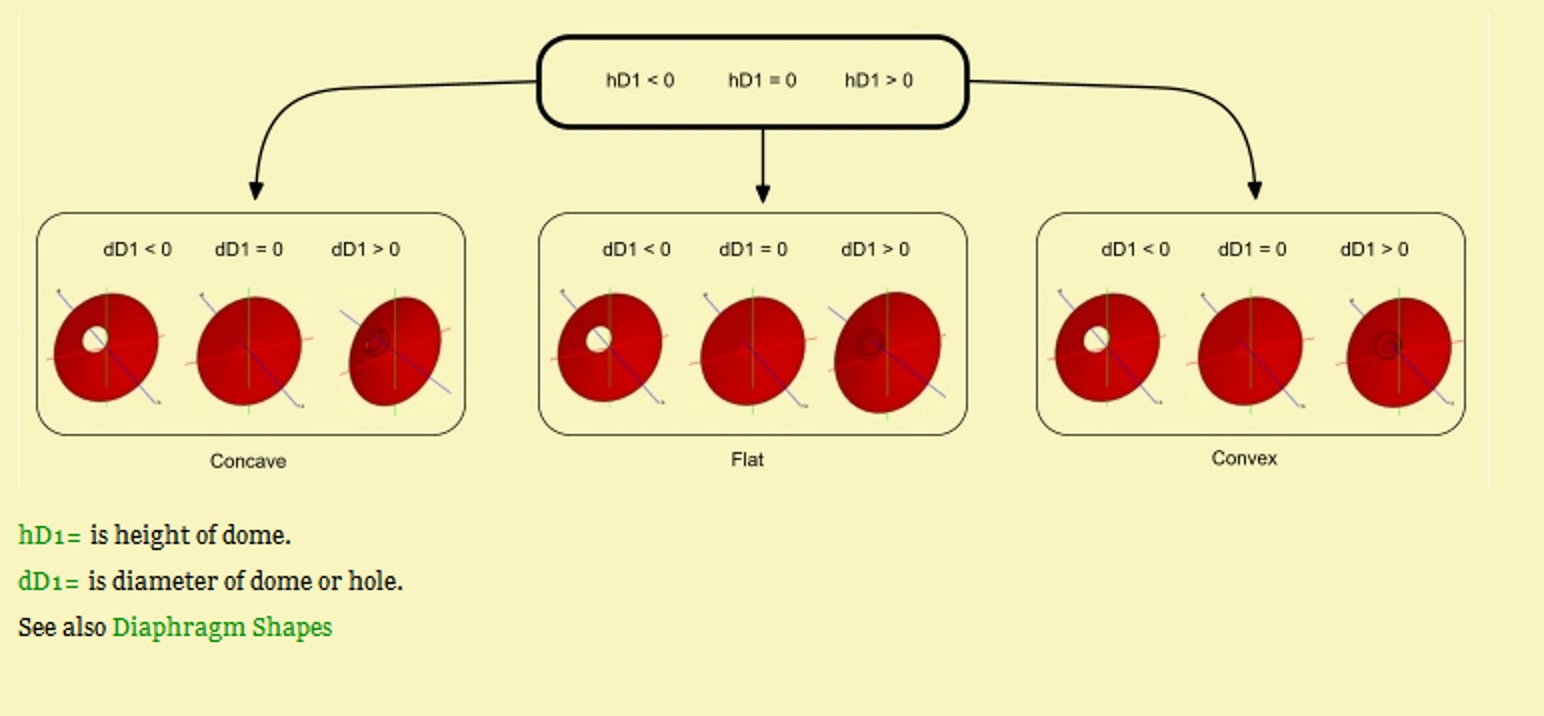

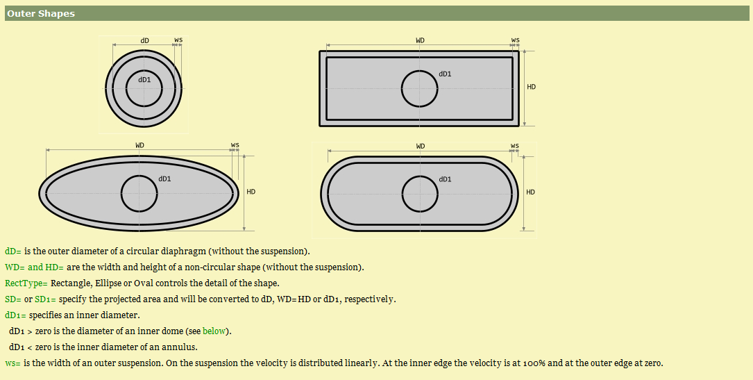

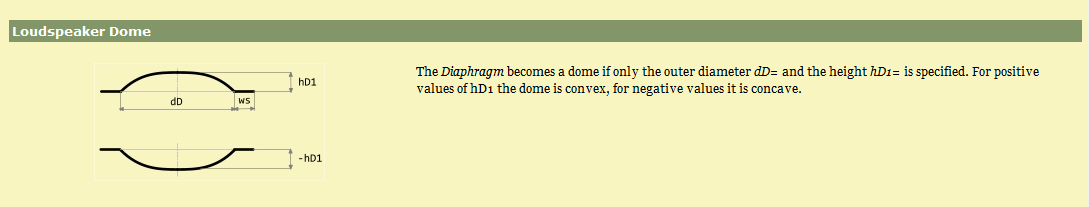

Looking at the Diaphragm Shapes and the Case Tree, it seems only regular cone & dome shapes are supported:
So I'm guessing modeling the TW29RN dimple dome isn't possible with ABEC?
Christoff might shed a light on this.

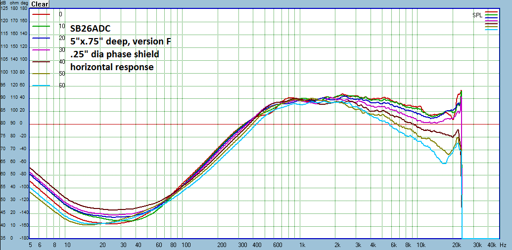

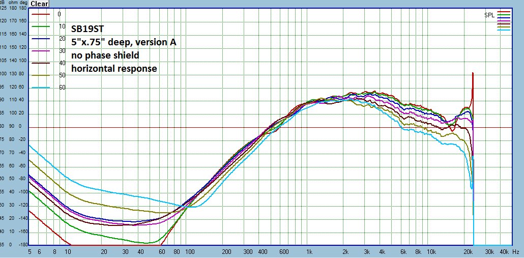

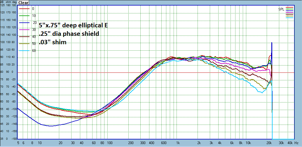

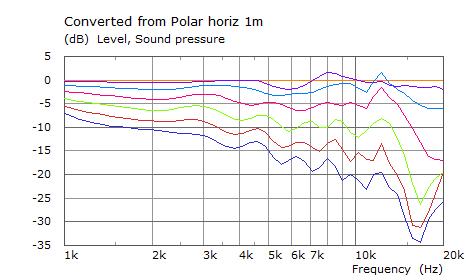

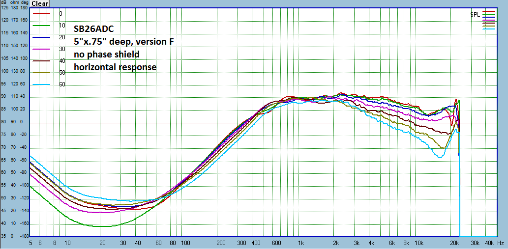

Here are results for the SB26 5" waveguide version F, and the SB19ST 5" waveguide version A. I'll get the TW29RN and N26CA out over the next couple days.
SB26ADC:

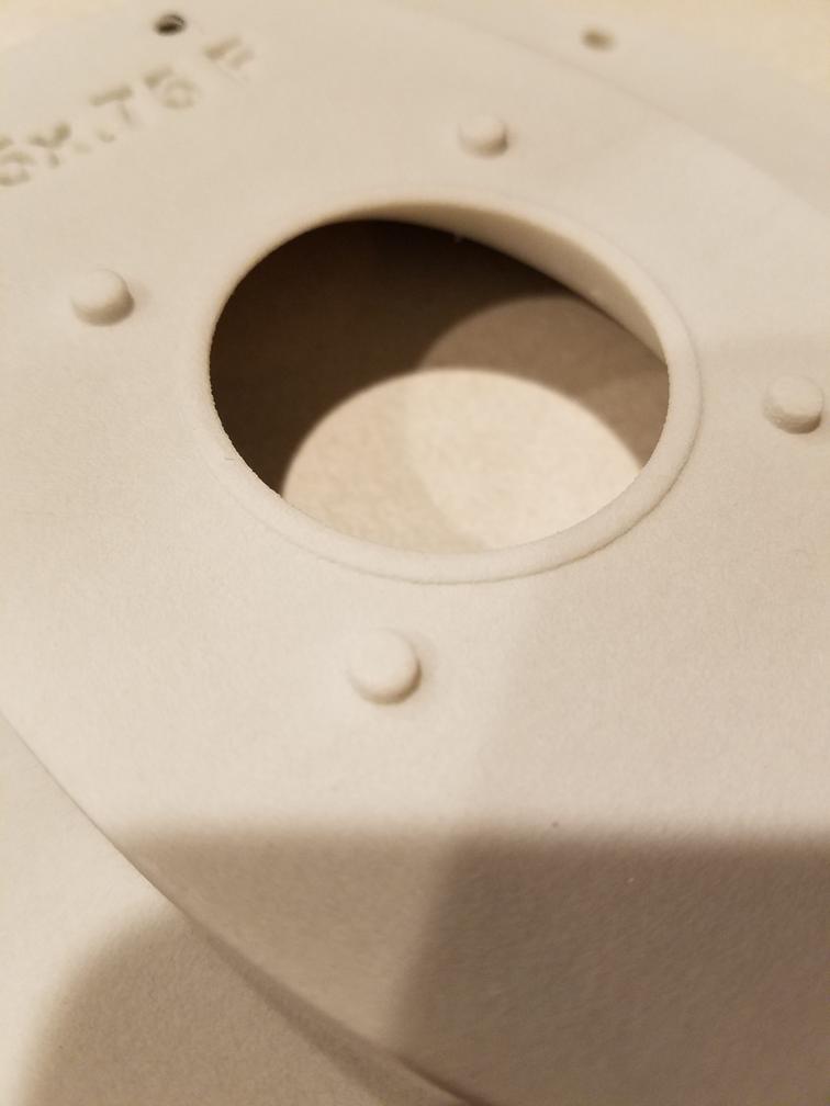

The midband is much smoother over previous results due to the .02" lip I incorporated after shims and putty showed the faceplate was not sealing well against the mouth of the waveguide:

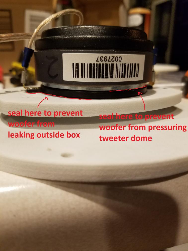

Speaking of sealing, in actual use you want to seal a couple gaps on the tweeter that do not seal like you might expect. I would use blue tack putty, easy on ,easy off:

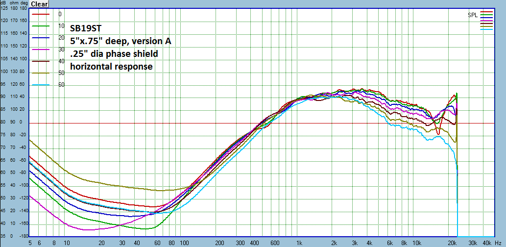

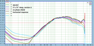

The SB19ST:
Unsurprisingly the phase shield was slightly worse with a fabric dome. OTOH I didn't expect that on axis dip even without phase shield. I believe the shape of the dome requires another look at throat angles as this a small diameter but tall dome. Nearly a 180 degree hemisphere. I'm *guessing* I need to relax the throat angle some.
One thing I've noticed so far is that everything looks much better on the 8" waveguides (results coming soon). I guess I assumed that a little waveguide would cause little problems, but that does not appear to be the case. In fact just going to say, 6" wide waveguides might solve a lot of the top octave issues I've had to solve. But I had to start somewhere!
Just now actually looking at the results...I'm really happy with the way the lip smoothed the response of version F, but now the plots (say 10-40 degrees) are not as straight as version C in post 1. They have more arch. I didn't want that and not exactly sure I how I got it. The only other difference was the flare radius vertically: C is 1", F is 1.1", and E (below) was 1.25", which I didn't care for and should have even worse curving of the responses if that was the cause, and it doesn't.

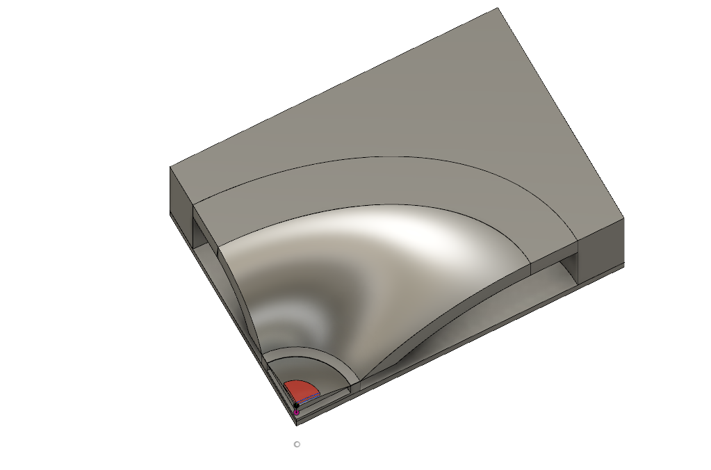

Dagnabbit, I had a flawed phase shield that I *thought* I had corrected before this went to the printer, but had not. Rotating one direction vs the other produces a different response above about 8khz, with one direction being much straighter and the overall response lifted >8khz. The corrected phase shield *should* be an average of the two differing directions.
Now I have to print to verify. I can do other tweaks while I'm at it, like changing that lip depth, which impacts the very top of the range near the soundcard's cutoff. The dome's resonant spike is near there and some tweaking could get it to be nulled down.

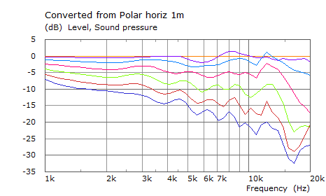

Christoph> if you get a chance, work the sim more on the SB26ADC. Of interest: a shim at the throat to move the dome back, vertical wall radius, and to a lesser extent the horizontal wall radius - though I feel that is pretty right on.
Christoff, if it's not too much of a hassle, it would be interesting to see the effect of a small area of "low curvature" (or even flat) in a (rather deep) waveguide for a hemispherical dome tweeter.
Some space of 2-4mm around the surround "to breath" > might eliminate/cancel interferences.
Smiliar to this:
