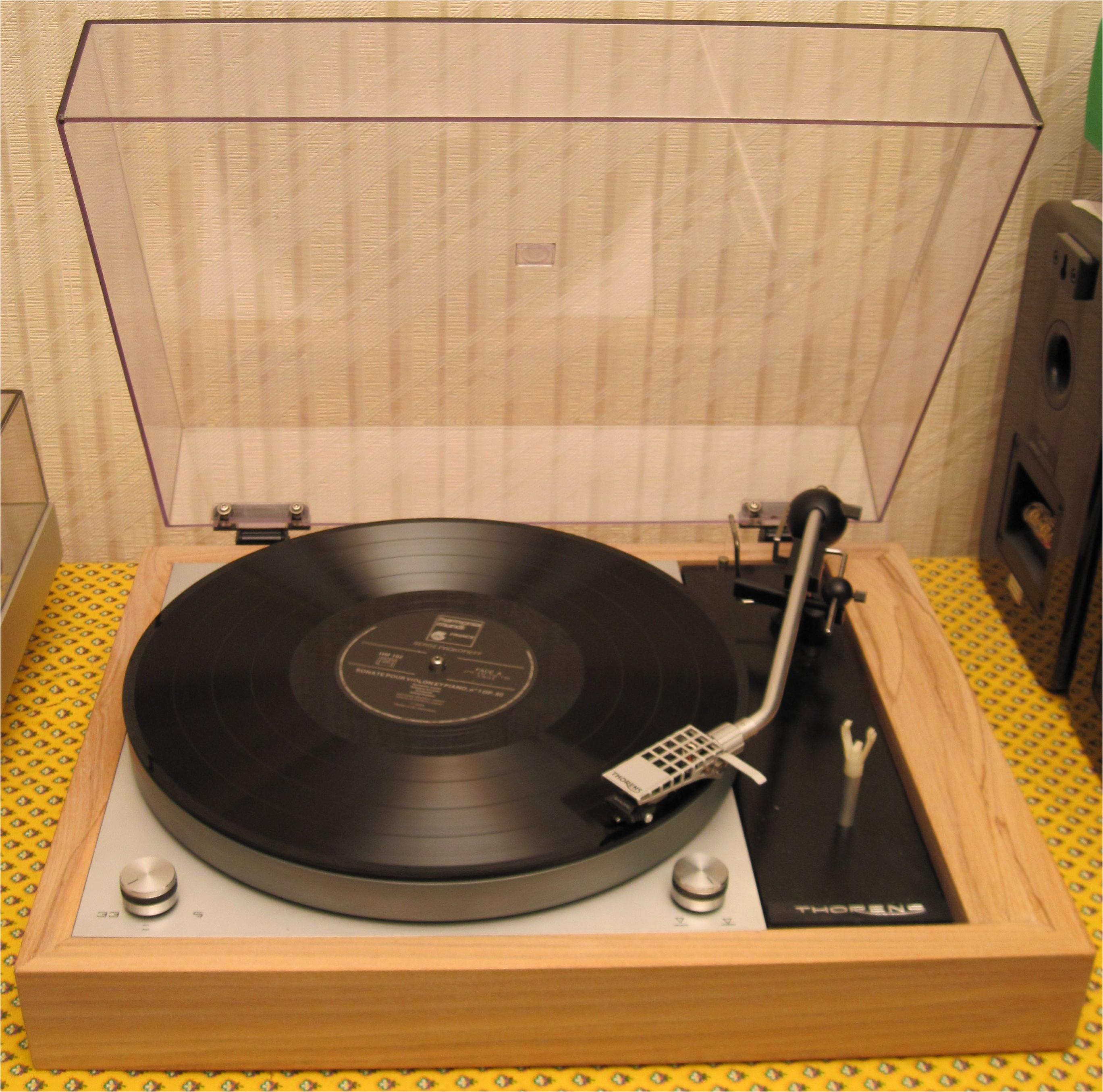

As you are talking about the Thorens TD-150, here is mine :
A DIM plinth with the dustcover of a Technics SL-20.
The best usage of a Technics SL-20.
