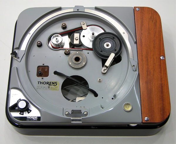

Ive only briefly come across the term Hybrid Belt / Idler, But have no Idea How its been done. Any links would be appreciated.
The venerable Thorens TD124 uses such a system. The motor drives a belt which drives a stepped pulley which drives an idler wheel. In the attached photo I drew the belt in red. The TD124 's proponents state that it is quieter than the Garrards of the same day. It is an interesting option. Just do a search for Thorens TD124 information or reviews. There are tons of places to look, but as usual, user510's site is a great resource. (Steve Clarke)

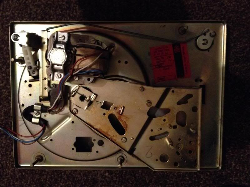

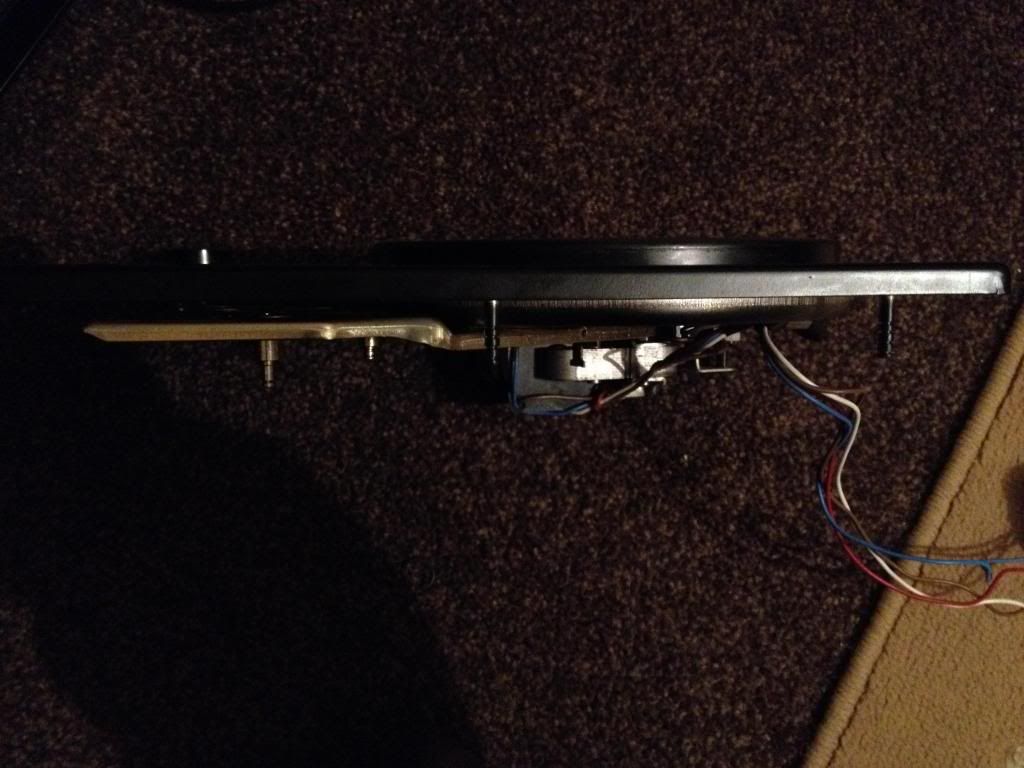

Another plinth template model attempt, but more successful.
all:
Well I reverted to a less elegant solution for this. Previously I had started to "hog out" a piece of rigid foam insulation board. The turntable now fits it (although it is slightly fugly). The basic shape is there though and I could glue small pieces of board to the existing one to fill in the gaps. I suppose I could tear everything off of the metal top plate and start with a "raw board, then build little covers for each of the most significant protrusions, then glue that to the existing board.
The idea of course is to end up with a close fitting plinth. Once the shape is roughed in I'll use drywall mud, plaster of Paris, or plasticine to to finish the interior (the female mould of the turntable parts as installed in playing condition). I imagine a lot of sanding to get the shape fairly nice. Then I'll create a drawing with better dimensions, and transfer it all to a single hand sketch of it, including contour lines (or take a photo of the underside of the Garrard) Another alternative (remember I thought the foam would be quick and easy, would be to create a drawing from an underside view of the tt, then do measurements for 2D locations. Once done then do some measurements from those points to a "z" axis for 3-D information.
As it appears now it is far too terrible looking to provide a photo 🙁 .

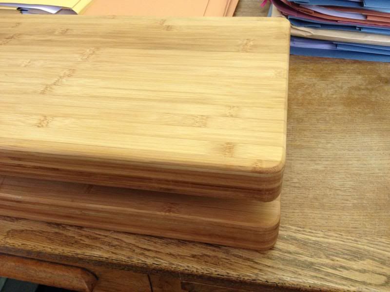

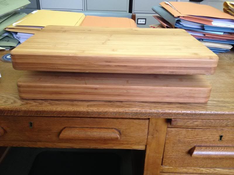

Not sure if you would class these as ugly but having had my eye on these beauties for a little while now I decided that if I'm going to do this then I'd better bite the bullet.
Lovely compact bamboo boards in a perfect size. They have a good solid weight to them and I believe bamboo is a pretty good material for using as a plinth. My thinking so far is to cut a recess in the top board to sink the player so that the top of the deck is level with the top of the board. On the underside of the BSR are four legs,
Im thinking at these points I can sit four springs to suspend the deck.
I will need to route the cavity to take the bearing and motor etc which may come all the way through.
Plenty of space on the board for two tonearms and in the gap between I hope to hide a wiring setup for both tonearms wiring into a switchable single outlet to the amp therefore no more unplugging at the back of the amp when I want to change arms.
Chrome legs to seperate the two boards with some kind of rubber dampening and some nice spiked feet to sit the whole thing on its final resting place.
Comments and advice please.
Oh and the cost of the boards? A hefty £14.99 each 🙂

sreten and Squiffy: Thanks for your ideas and your observations. Yes I would like to model underside of the tt accurately enough to have it CNC'd if I decide the end result is worthy. A file could then be shared with any using the same or similar tt. I would prefer not to pay someone to digitize it as I am financially challenged.
I guess the alternative would be to take the time and manually draw out each layer. The fellow who I have in mind to do the CNC work is some distance away, so I will end up building a solid plinth (marine grade BB ply) with the correct over-all dimensions, and send it along to him and the tt, else send him the most accurate drawing of what I want the mould to be. The mould is intended to be a female one that can be filled with plaster of Paris or similar to represent the mechanical bits and top plate, then it can be altered relatively easily for minor variations. The mould would be effectively a complete plinth.
