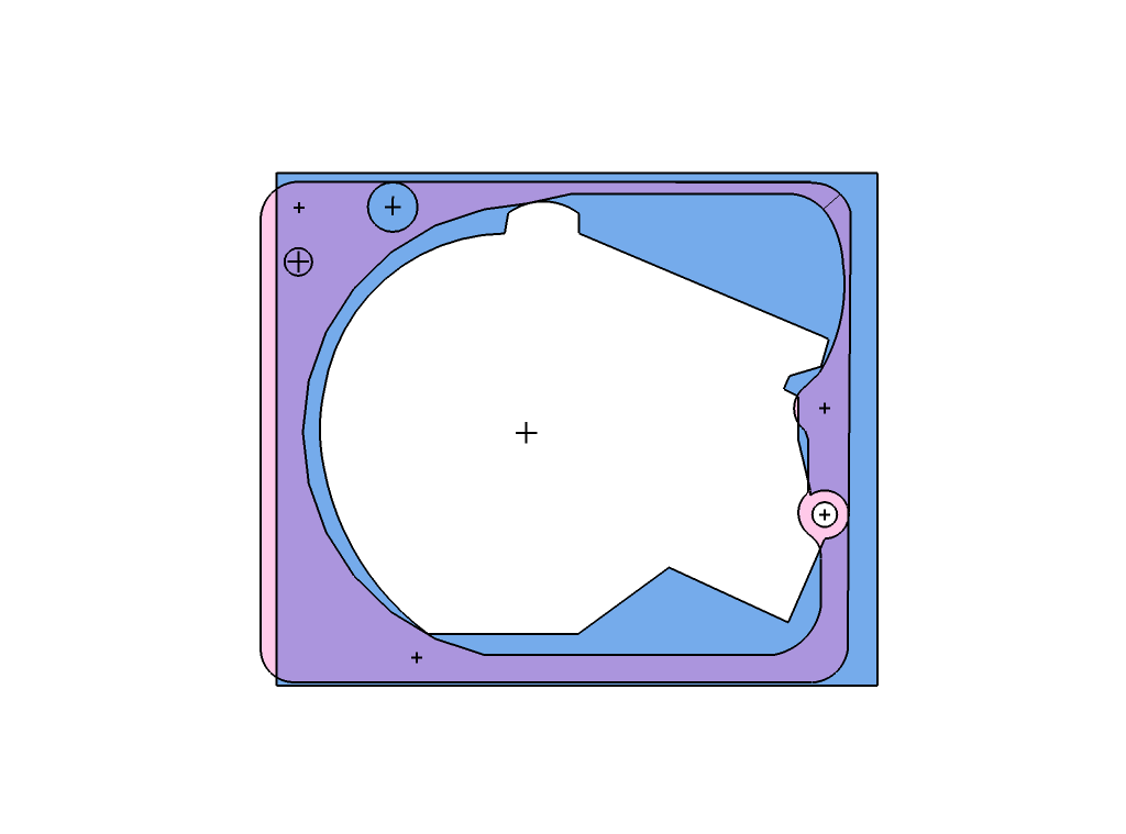

I did manage to finish a template diagram, that when used to cut out a top layer for a solid BB ply plinth for the Garrard Lab 60 allows clearance of everything. If any are interested, I'll post a dimensioned diagram of it. Once I fix a few minor mistakes in cutting, I'll post a picture of the top layer as cut.

My plinth drawing is quite different from the Garrard outline cutout as I discovered when I looked at the Garrard 50/60 (or Lab 50/60 depending on where the turntables were marketed): pink= Garrard cutout diagram; blue=my diagram.
My diagram clears everything that I left intact: the bearing; the speed change mechanism; and the motor switch mechanism. The Garrard diagram assumes that the deck will remain as supplied with the springs left intact. My diagram assumes that the turntable will be hard mounted to a more "massy" plinth. Also for the sake of comparison I have restricted the dimensions of my diagram to those of the original so that a meaningful comparison can be done. The diagram is not dimensioned, I'll post a dimensioned one later today once I get the component depths included.

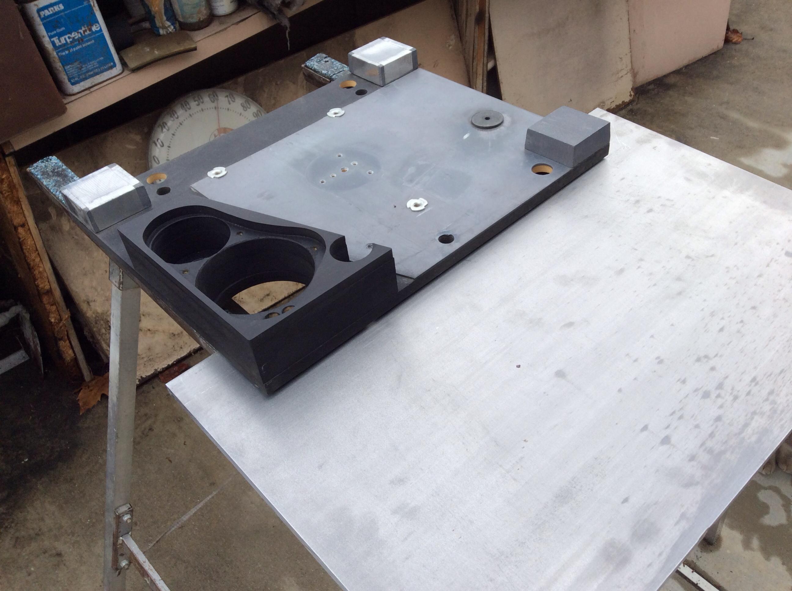

This is a 1/2" piece of 6061-t6 alum. and a SOTA star plinth (22lbs.) without platter
The SME mentioned uses a thicker piece of the same. I know SME uses a fluid and O ring suspension and when you bolt everything together you would get a reduction of resonance through the plinth, but it seems you would need more than this to really quench everything. Don,t know what there doing but it gets great reviews
My goal is a wider plinth to accept a certain type of tone arm (linear) where the aluminum is Swiss cheesed and a piece of 3/4" acrylic is bolted or glued on top to absorb vibrations.
The SOTA plinth is mundane 1/2" MDF but,.,there's so much lead that it becomes unimportant what is used as long as you keep a decent ratio of all materials to kill anything.

AVWERK: If and when I get a "killer" idler wheel set-up or make my own, something like that would be on my wish list🙂 Your turntable project looks very good. Is it posted in any threads?
Not yet. I have a few of these and the reason for modification is to accept a linear TA with a 1.4"' tone arm length (Versa-dynamics) style
with a possible 12" future arm and have it fit within the outside dimensions and at the same time make a more stable platform due to the wider dims.
The idler " transmission" style is an interesting idea and seems plausible , but for right now I,m planning the Cosmos mounting idea where the motor is on the moving plinth instead of separate.
I,m not sure it's a good idea but will make it dead enough using sorbothane (duro30) mounting pads to keep it disconnected as much possible
My goal and hope it's yours that what ever you do think about only the needle moving and nothing else.

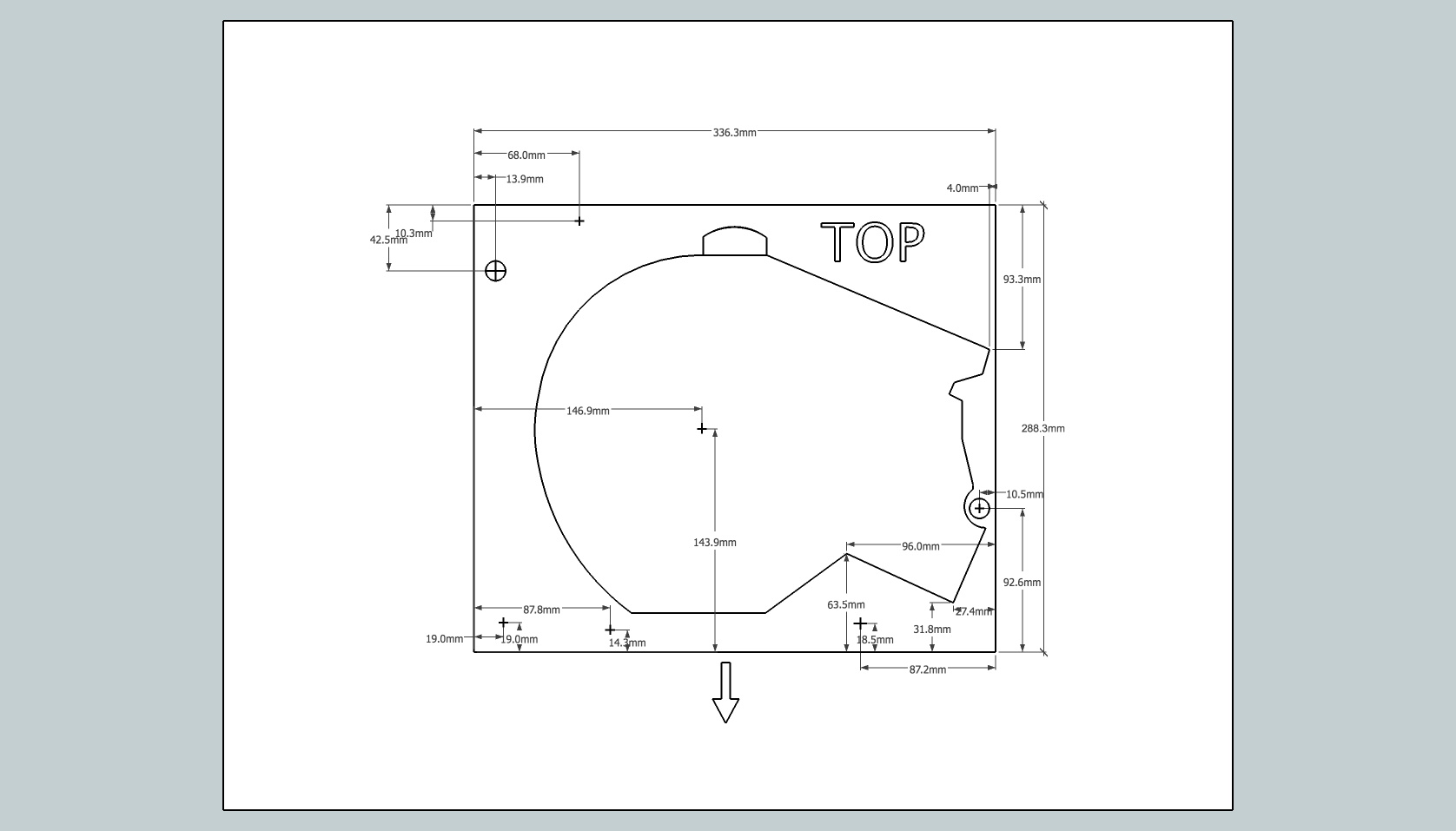

finally a dimensioned drawing...
...it should show up here. Hope there is enough information for any wanting to do a similar project.
added comment: additional dims may be required. If so I'll do the remainder and post a copy of it. The markup on the drawing was getting a little extensive.
The actual top plate isn't square. My skills suck.

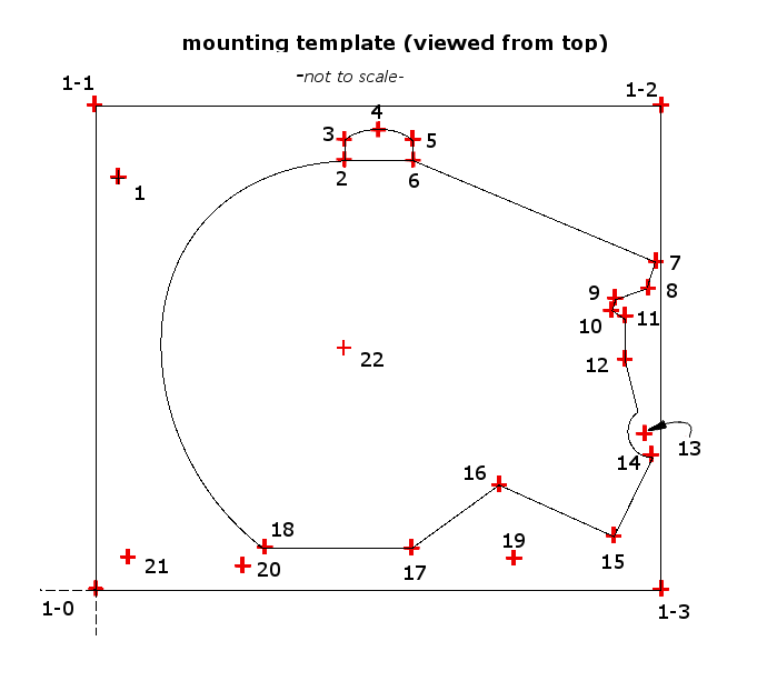

Just too many dimensions...
...it was SO confusing (a rat's nest of dimension lines, etc). So rather than confuse more folks than need be I drew out an outline as a jpg (saved as a png), and added location markers. Then wrote out a co-ordinate list and saved it as a pdf. This is a lot less confusing than the drawing ended up being. I hope it helps any that might want it.
Now I did make a fatal error when cutting out the piece. I marked it out and cut it out, but failed to remember to mark the template "this side up". Not the end of the world until you realize that there is no room for a tonearm on the RHS of the plinth. Any way, my error. If wanting to have a single plinth without a separate arm "pod" the RHS of the plinth should be extended to about 495mm from the left hand edge (or if using the pdf list, the x dimensions for pts 1-2 and 1-3 need to be extended to 495mm) if wanting to mount a 12" arm on it. Else size accordingly.

Is the diagram understandable?
All: Does it make sense to use a diagram with a table.? When I drew out the template using sketchup, the dimensions were just way too crowded. What do you think?
