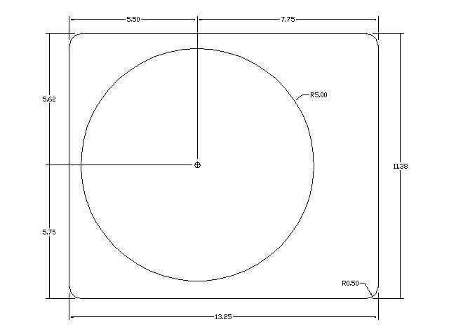

Here's a Quick AT-60...
attachment.php

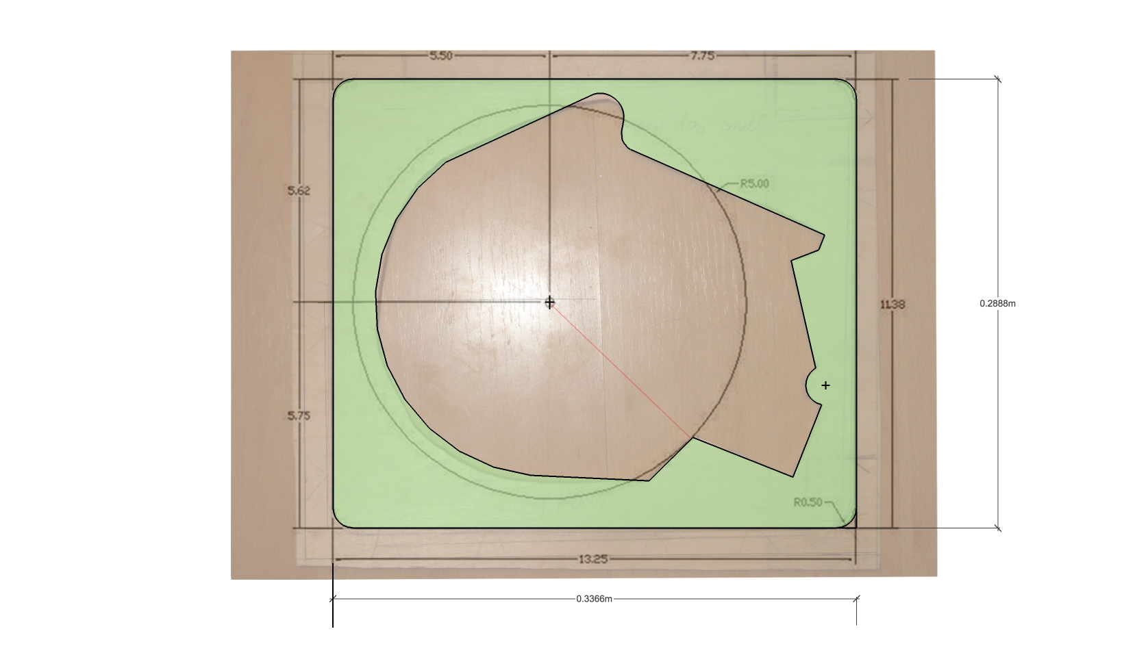

comparison of sled vs reality vs nanook
Guys: Attached is a png image comparing reality to sled's quick sketch and my sketchup of the required cut-out for the Garrard "AT6" (or "60" or "Lab60")
I overlaid sled's image and scaled it correctly (well actually scaled the photo and then scaled the photo to sled's image). Then ensured my cut-out diagram was in good dimensional agreement with both the photo and sled's image (dwg ?).
The reasoning for the difference in the circular cut-out is that the radius of my cut-out is smaller than sled's. sled (as far as I can tell) drew the platter, I drew the cut-out required to clear the underside of the metal top plate. It has a recessed area with a R=110mm. The platter has a radius of 132mm (as measured on my platter). So there are some minor discrepancies. Just remember everything underneath the Garrard's metal top plate will not be seen.
The manner in which the main bearing is supported is pretty shoddy. That must be addressed by any that are using changers as the basis of their project, if they use the caged "bicycle" style ball bearings. Either that or come up with an alternative solid bearing...

Sorry Stew...That JPeg was just a Quick Shot from the top, showing the 10" Platter...
sled: I assumed as much, but your jpeg was to scale pretty much. I suspect ACAD? My attached image was for illustrative purposes, that's it. But the differences between a drawing, and reality is interesting.

Yes, it's ACAD...And, JPEGs are only for Display Purposes..A PDF or PLT would have been More Accurate...

sled: why not just ask any to view the image with a dwg viewer?
a little Off Topic...
sled:I just wanted to highlight the differences between my drawing, the outline of the AT6 (as you kindly posted) and the reality of what I ended up with for the first layer. I have modelled the Lab60 in sketchup as well, which I'll post for any interested.

Last night I screwed together a plinth, making the required cut-outs as I went along, layer by layer. I'll do a double check on the BB ply thickness, but IIRC it is 12 mm. It seems that 4 layers should enclose most everything. Once the complete mechanicals are covered, I will add a final 3/4" layer. Once I am satisfied I'll then take it someplace to get the full thickness cut , take it apart and then take some photographs. Once photographed I will attempt sketches of each layer. and post them. The only "hard points" used for location of all the others are the 2 drilled holes for the transport screws.
