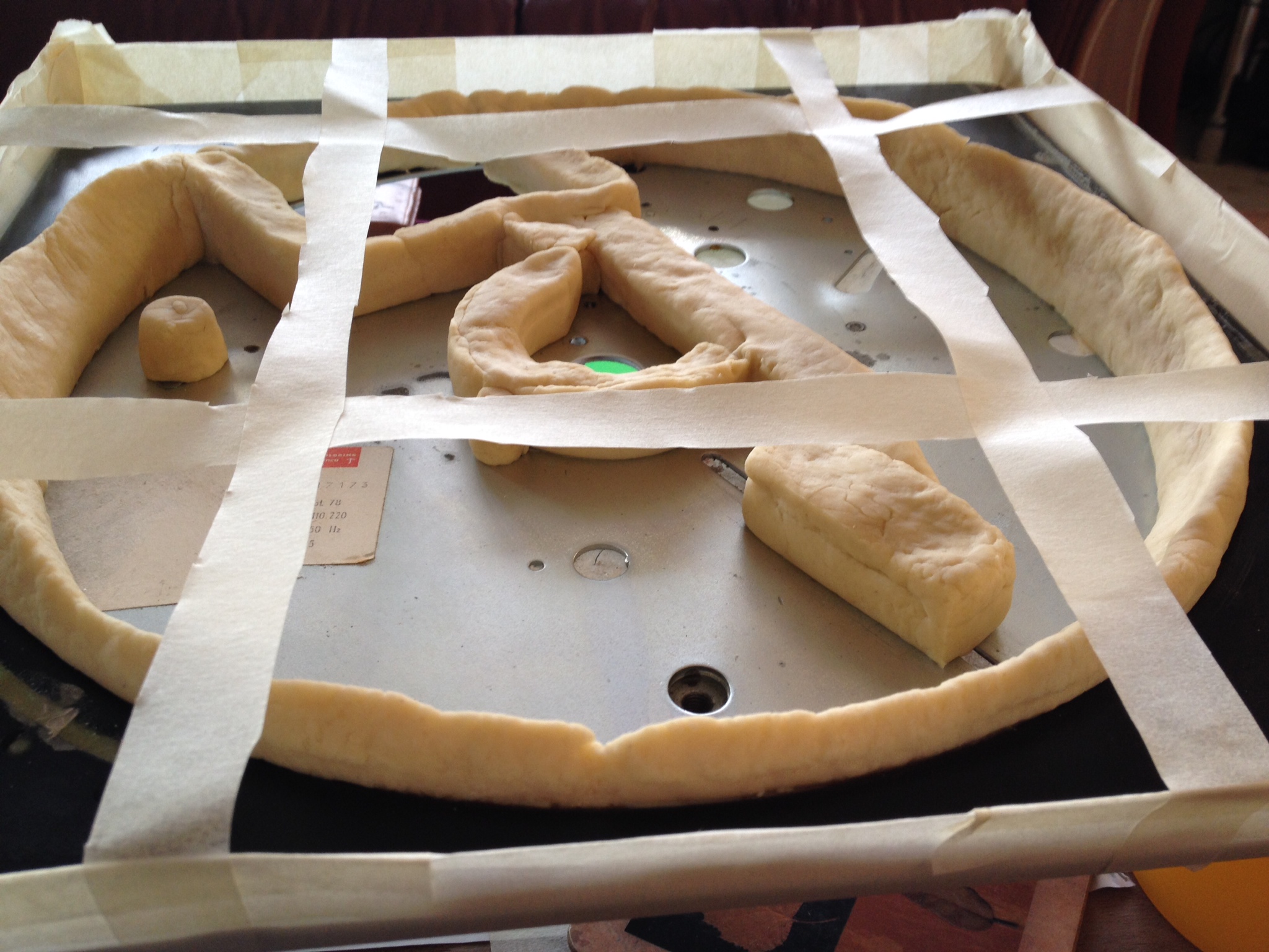

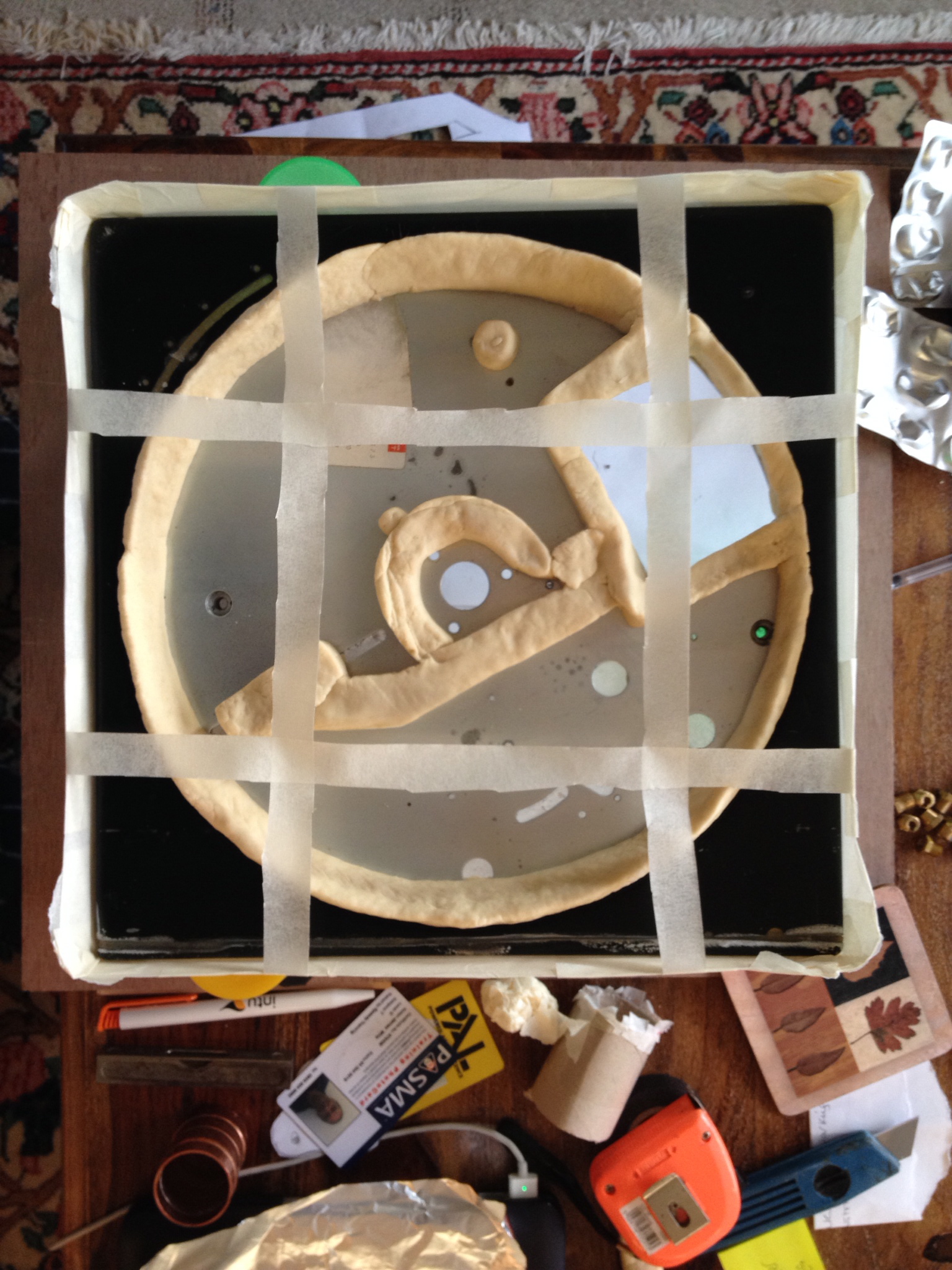

Back on topic, going to make some play dough today & start to add it to tt chassis.
Whilst listening to Decca London Blue in Audiomods arm on LP12 mmmmmmm
It's blowing a hoolie hear,
Anyway play dough made & ready to use

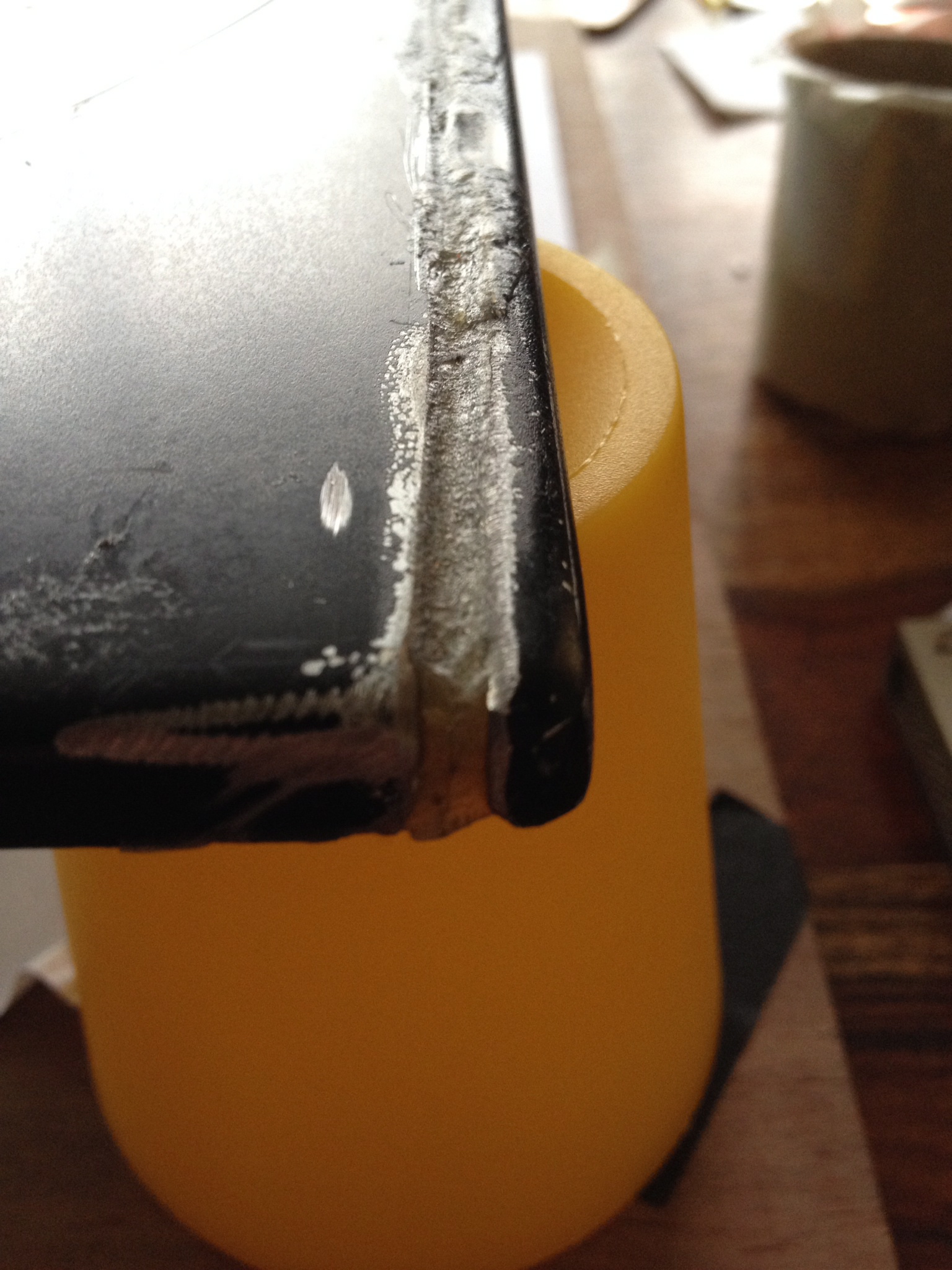

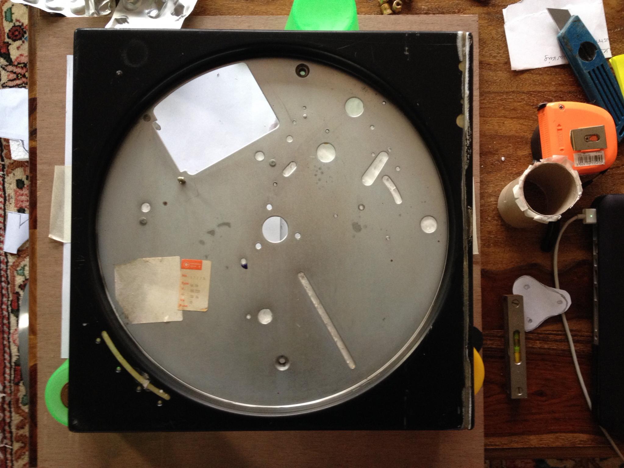

Top plate chopped & made ready for resin,
Playdough & masking tape attached to top plate.
The resin will be at different levels, inside the play dough area It will be about 10 mm thick, Outside on the black area only about 1mm.
So having the top plate level during the pore is rather important…
All it needs now for the First pore is some warmer wether!

I had to take all the dough off as I forgot to Key the top plate.
Still its ready again now.
Ive seen a few Resin based Lenco's, but not like I'm doing by encapsulating most if not all of the top plate.

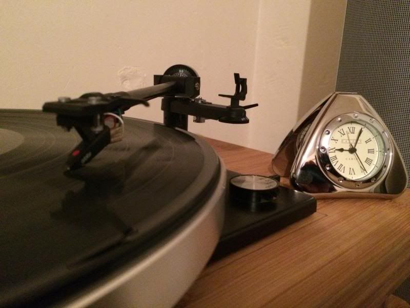

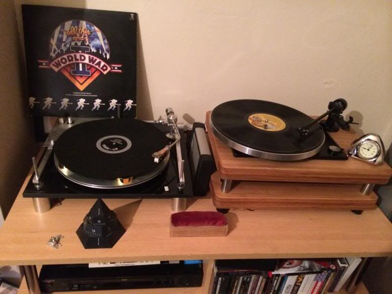

I managed to get a little bit more done this weekend including the drilling of a hole to fit a Linn Basik LV X arm and the fixing of a 'wobble'. This had given me real headache and I really thought it was the curse of BSR coming back to scupper my attempts to get this little deck to work. The platter when spinning looked like a warped record going round. What the heck was causing it? I checked the under platter and it didn't seem to be there when spinning on its own. Hmmm, I checked the upper platter to see if it had warped, nope it was straight and true. Ok have a look at the risers ( three blocks of wood and a 2p coin under each, I know it sounds crazy but it was just enough to sit the upper platter on the original to clear and spin smoothly 🙂 ) The wood was cut from the same piece and the thickness should be the same but no, one block was around a mm taller than the other two. Damn it!!
Ok methinks if I'm to get this working I'm gonna have to invest some money into the project. Now I've said before I don't have a lot of spare cash for my hobby and especially this time of year, what with Chrimbo creeping up on us. So I went to the cash draw to make a withdrawal. I found the plastic bag of foreign coins to see what we had. Yup as I thought we had loads of those little tiny silver American coins (?) Not the quarters, the really ickle ones that nobody spends. Three stacks piled to the height of the block and 2ps, taped up with insulating tape and positioned under the top platter and flick the go button. Taddah, it worked! Totally level, spinning on speed and near silent. I say near, there is still the faintest whurr if you listen very closely which might be the idler wheel on the platter, the bearing or possibly the motor but honestly you have to be so close to hear it. I will have a further investigation but this is so small it's not worrying me.
The next job is to make an electrics box to tidy up the wiring. I've salvaged a computer power supply and removed the plug socket which I will fit in a wooden box to sit at the back between the layers. I've found a 4 into 1 phono switch to allow me to connect the arms into with one output to the amp.
Does it play? Well I'd like to say it plays well and sounds lovely and smooth, no whines and groans as the platter turns, no motor problems, no tinny noises, no outside influences affecting playback.....
So I will! It sounds great. The Turd is whacking out the cool sound of vinyl as good as the other tables that I have and I am very very pleased with the result. Another BIG plus is that the wife likes it she thinks it looks cool and fits in nicely with my corner. OK that'll change when the second and third arm are added and it starts to resemble something outta Frankenstein's lab but for now she's happy and I'm loving it.
So for less than £40 (and around a couple of dollars in tiny ickle useless coins, I guess) I have succeeded in my mission impossible 🙂 and all done without an engineering degree in sight 😉

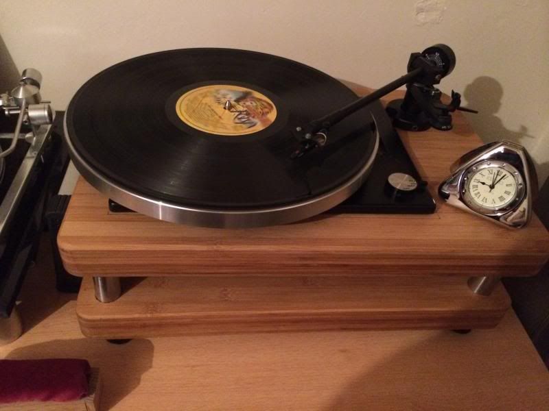

whats the advantage of the double plinth .....:scratch:
No advantage, as such, just a means to an end.
The idler fitted the original platter which was tiny. I wanted a full size platter and had the top platter down the shed. It didn't fit the BSR idler setup so my solution was to place it on top of the original using the, soon to be patented, three piles of nickels spacer technique 🙂
With the right machinery, skills, etc etc a replacement could have been designed and machined and a better solution could be engineered but a. It would have cost too much for this project and b. I certainly couldn't have done it myself. So in the best Heath Robinson style and using the tried and tested 'Bodge it Yourself' methodology I came up with this solution. I think it does the job and does it well both in function and design

The double platter was initially a concept that I'd had in mind that I wanted to implement....
Nah not really, they had a two for one offer down at TKMax in the chopping board section 😀
NO I'm kidding. The motor sits too low below the one board so I thought a double platter would allow a space for it to clear. I could have left it as a single as the feet would have given enough clearance but I will be fitting in the space a wiring box for the electrics which will be out of sight at the rear and a 5 into one phono selector switch to connect up to five arms outputting to one amp which will sit at the front.

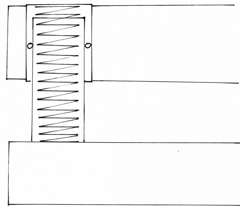

Also when thinking about the design of the two layered plinth I had originally thought of having the top section sprung using something like this:
Please remember I am not an engineer so ideas and drawings are not my forte. A steel cup cut into the top plinth layer about 3 mil wider than the leg support. A spring inside the leg support and a round rubber washer/ring to act as a guide. The spring to be fairly stiff, enough to assist in the absorption of vibrations but not to have the top plinth wobbling around like a bobble head. I may come back to this at a later date if I can source the three cups and springs needed.
