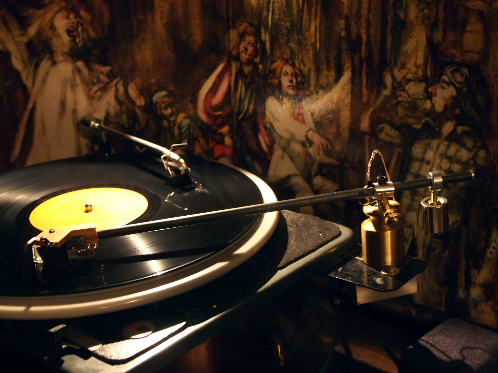

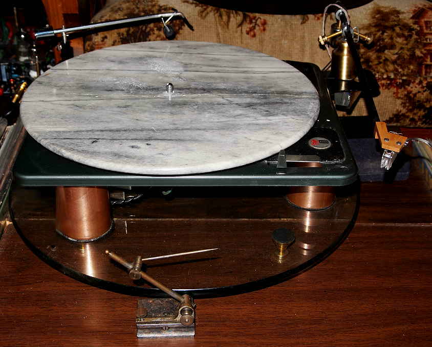

Alright...Sreten, you have the Talk...Show us your Walk...I've Polished my Garrard AT60 Nice and Shiny...With Stew's UniPivot Arm, and with a Marble Platter it's a Great Idler...For all of $100..What have You Made??

... looks great (as I posted in the tonearm thread). I really dislike carbon fibre for a number of reasons, and with the counter-weight that sled is using, there is no need for the outrigger weights, although they do make setting the azimuth a little easier.
Still wanting to make a modified version of sled's headshell as an experiment (I want the option of using a "0" offset, and negative overhang).

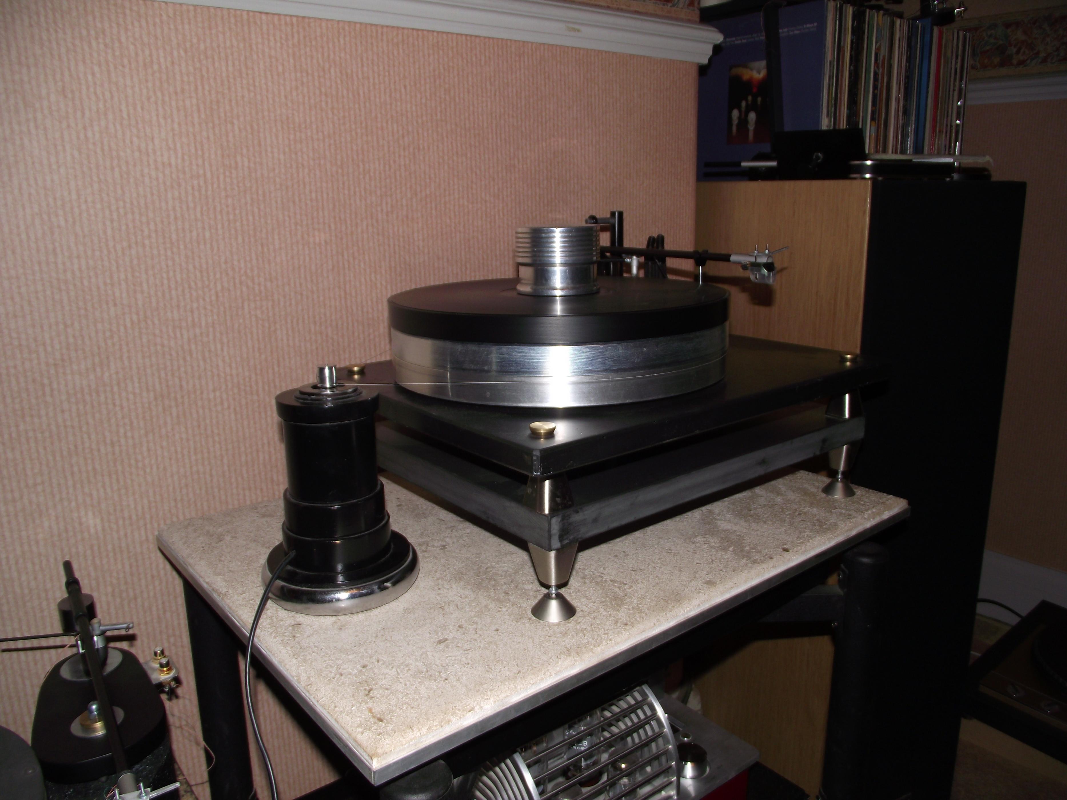

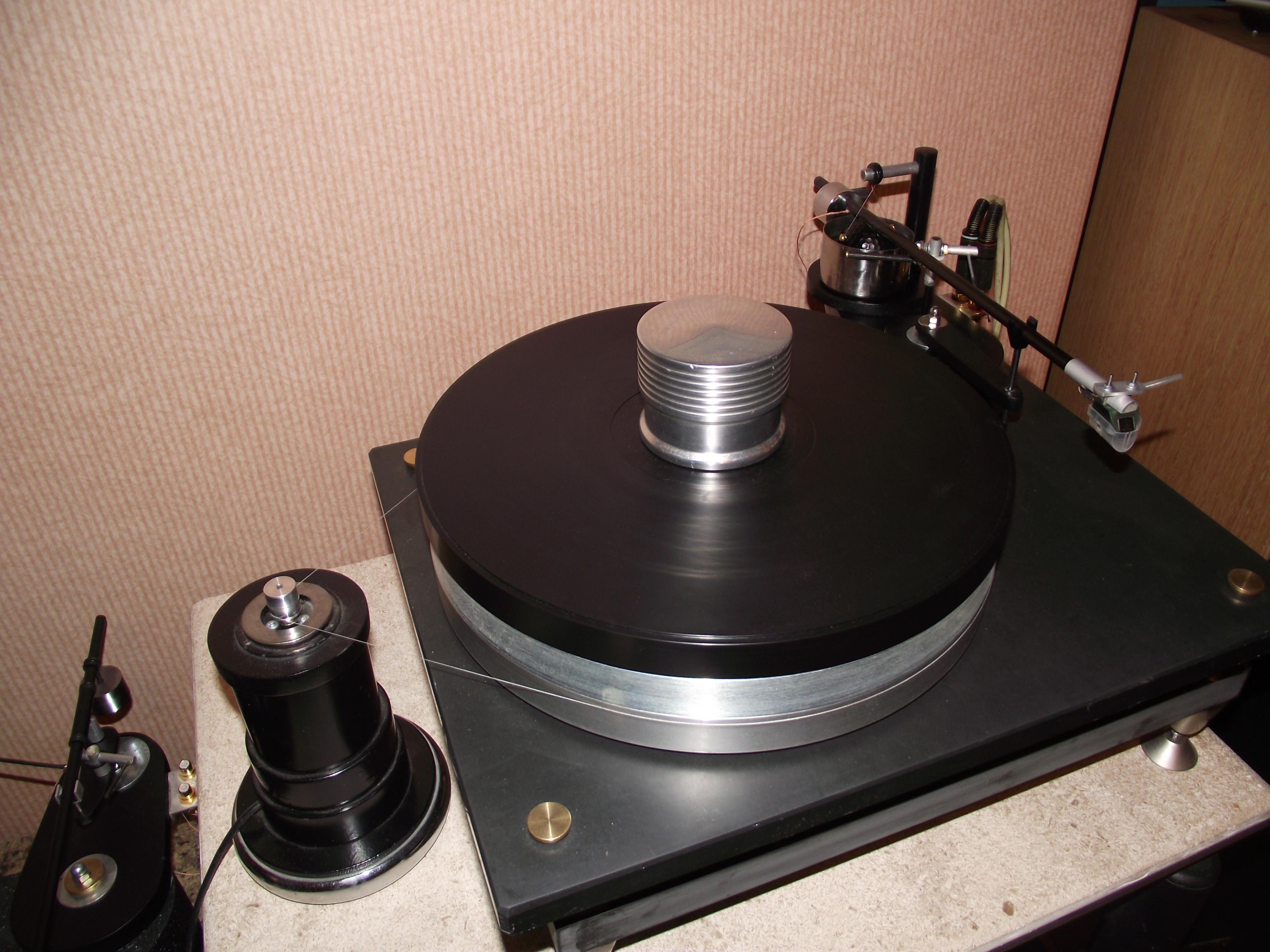

Hello Everyone. Here are pictures of my current 'favourite' deck. It started life as an LP12. The bearing, sub platter and two outer platters are all LP12 sourced. The top platter is delrin. Motor is a Maxon DC with separate power supply. Drive is via one fine silk thread. The whole lot sits on two slate slabs (bottom one needs a little finishing off).
Arm is my version of the WTL arm-one word superb-see my contributions to the WTL debate. Cartridge currently an AT OC5
How does the whole set up sound? Better than anything I've previously had by a country mile! It hasn't been cheap to build but then again, considering the quality of performance, it's not been expensive to build.
