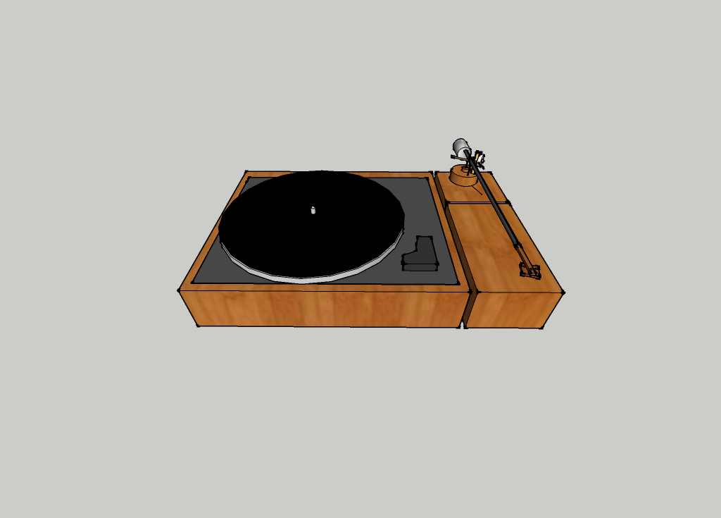

a drawing of the first "Nanook turntable". Just a good re-plinth with a 219😉 . Once I get a feel for this, I'll try the one for the Dual 1214. After that I'll be doing a "free form" plinth (hopefully to create my own idler drive).
I';; finally cut the first layer of the Lab60 plinth , then adjust the template to represent what the second layer should be. And so, and so , and so on. Until the mechanism, including motor is completely enclosed.

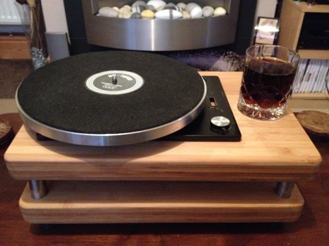

Well it's been a busy day down the shed. We've had a bit of sunshine so Having taken measurements and drawn the template it was transposed onto the top board and cut out. I decided to go with the fixed top plate as opposed to floating and to keep it on top rather than sunken. It does look good and the drive is now almost silent. I have cobbled together a platter to sit on top of the BSR standard which now gives it a full size and looks good. Pictures to follow for your opinions 🙂

So far it has cost me:
Two bamboo chopping boards - £30
Four walking stick finials - £3
A pack of long screws - 75p
A BSR turntable - free
Four chrome legs - free ( salvaged and made from the support stem of an old dead steam cleaner )
To finish I will require:
A length of power cable and plug. I intend to use a lead from a computer.
A switch box for the RCA connectors giving me a dual input to a single output to an amp. I may splash out £15 for a four input box that I spotted online which would then allow me to connect in the Saturn and another turntable or arm without the need to keep disconnecting.
An arm support for the DIY unipivot arm.
The parts for a well tempered arm although I pretty much have these down the shed apart from the fluid.
Paint for the top plate.
A possible replacement bearing for the BSR.
The bearing in there is in perfect condition but may not be the best in the world so trying out a second may give it a better chance of improvement although for my money what is going to improve? It's near silent, it spins at the correct speed on all four chosen speeds. It's solid as a rock, it looks damn cool and for under £40 and a clunker put together down the shed from old bits and bobs by some old bodger without an engineering degree to his name I'm very pleased with its outcome. 😉

The platter I have is only a seven inch! I have come up with a solution to the problem that works involving three blocks of wood, three two pence pieces (damn I should have added that to the inventory) and a spare aluminium platter that I had down the shed.
I may have a mate machine me three replacements and have these rubber topped to give a little bit of additional sound insulation but will see what the sound is like when I connect up an arm and stick a record on.

I'm under no illusion that there are much better decks out there, indeed I have three turntables down the shed that I could have used for this threads project but I wanted to see if I could:
a. improve the BSR from the form that it was in,
b. have a go at working with the plinth form that I had chosen (at a cost level that I could walk away from if it didn't work) and
c. meet my own challenge to produce something that performs well, looks and sounds good (to me at least) and have fun down me shed as I give it a go.
So far a and b have worked well, c is there all bar the sound trials which will happen once the arm is connected up. Watch this space 🙂

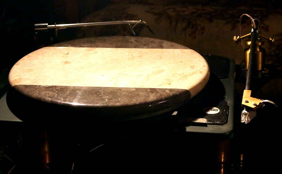

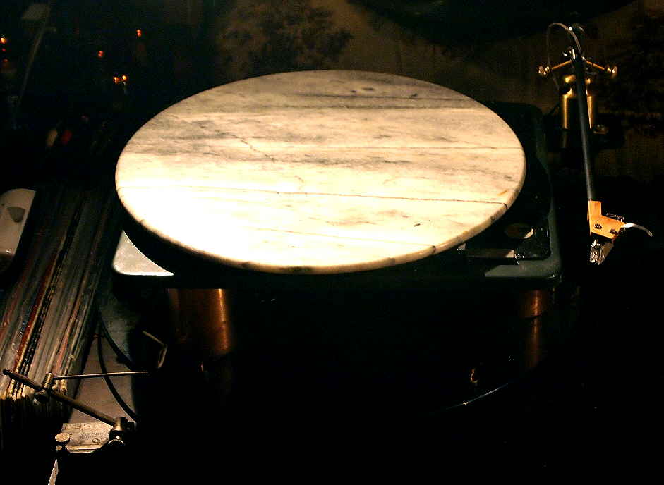

I thought that I'd be able to do this Online...But now that this has arrived, I find that it's 1/4" too Thick and is Way Heavy...To do this Right will take some Trips to 'Bed Bath And Beyond' Etc..At least I have a Nice Marble Cheese Board...

I've been working all day trying to get a good template made and drawn out in sketchup. I'll post the first layer when it is cut.
The fun never stops 🙂 .
sled108: good idea, but stone can get very heavy. I don't think I like the idea of a platter much heavier than about 2.2 kg ( or close to 10 lbs.).

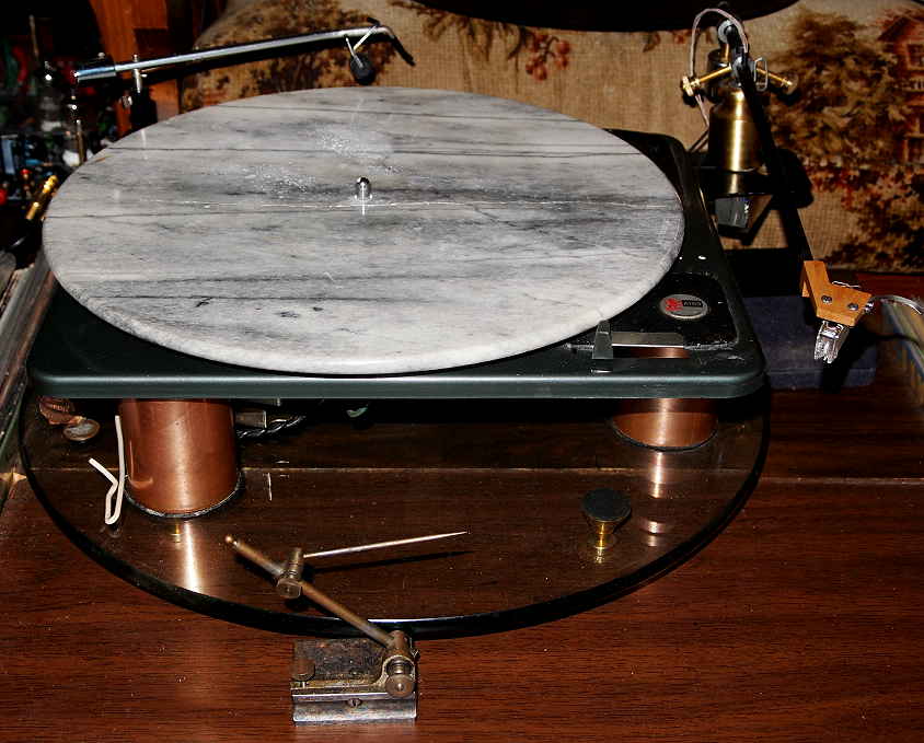

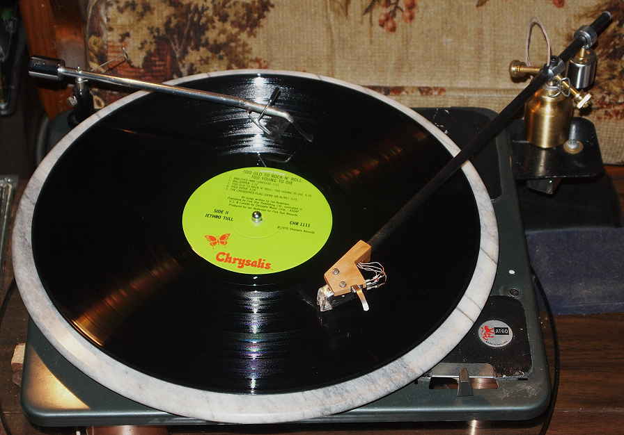

I didn't think that this would Work, but it Did...a 13" Marble Platter, with No Center Spindle Hole, only the Needle Gauge to True it...And It Works...Why is it so Hard to find a 12"-1/4", 3/8" Round Marble?
If you can find one, all that you need to do is to Carefully Center an Old Lp and Tape it...Then use a Dremel Tool with a Conical Stone Bit to Make the Hole for the Spindle..

Nice one Sled how does it sound? The Beast had a glass platter from a Systemdek and I loved it.

I'm just getting into the 'Critical Listening'...To tell you the Truth...It Sounds the Same as when I had 3 Old LPs taped together under the Felt Mat...But, it Looks a Hellava Lot Sweeter...And, I'm still just Marveling on how I managed to Punch the Hole 'Dead On True'...I think I'm Watching it Go Around more than Listening now...
I think the Next thing to Listen for is if I should Run the Felt Pad, or Right on the Marble....
On the glass platter I ran a felt pad as I felt the sound was too 'tinny' without. I tried a rubber mat but this dulled it too much. On the Saturn although it has rubber nipples on each of the pods that the record sits on I still have a stiff felt pad for the same reason.
Yeah, I think that I'll run it like This for a While...On the Mat...
