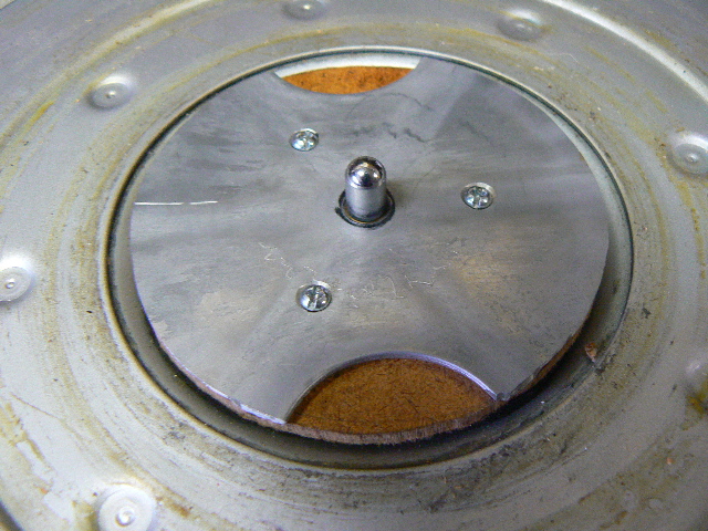

Here are the photos. The kludged spindle is from a cheap Sony, I believe. The BSR has a conveniently recessed center so I cut out the center of the Sony platter and fitted it into the BSR with a masonite spacer and a thin foam pad that let me do adjustments in two planes so the platter runs true and flat. I cut out the Sony spindle leaving enough to mount it to the bottom of the BSR. I centered if by taking careful note of where the original BSR spindle was mounted. Sort of by guess and by golly, but it worked. As I was taking the photos I found the noise I thought was the spindle bearing was actually platter rub that resulted from insufficient support under the bearing. A slight push upward ended the noise so even with added weight, the bearing was fine.
Damn, I was all set to trash an orphan project, but now I'm going to have to keep it.

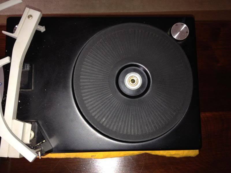

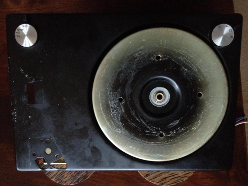

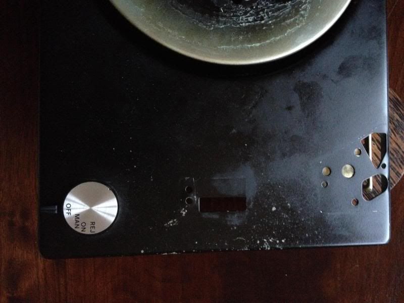

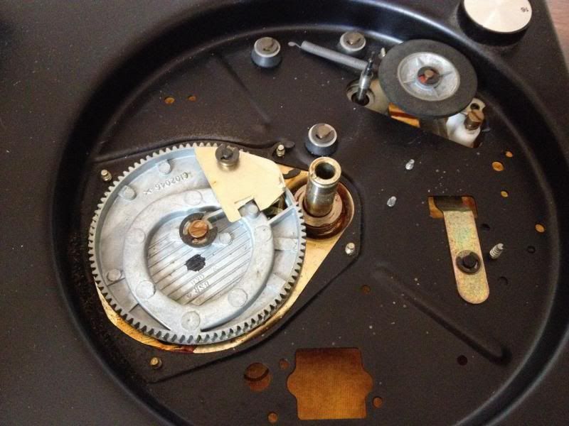

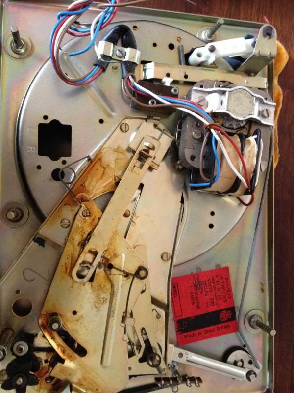

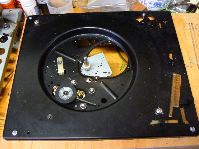

Well the strip down has begone. I'll stick some picks up later but for now I can say that the old BSR is an idler drive and had a bit of noise when I stuck a plug on it and fired it up. I am however pleased to say that it runs nicely on all four speeds from 16 to 78's
This is what I've started with:
The auto changer and return mechanism isn't required so most of the gubbins underneath has been removed. I'm now left with:
The gaps where the tonearm setup and the size selector were housed will need to be sorted out. I'll need to decide if I'll cover it or fill it with car filler. The base needs to be smoothed down and painted. The two dials will remain although the on/off dial now only has two options.
Plugged it back in and, having taken out all the gubbins, has left it running almost silent 🙂 just the very faintest, and you have to have your ear right up close to hear it, hum from the motor. All speeds run correctly and change as they should. This little pile of shhhh... rubbish is already starting to throw out some pleasant surprises. 😀
Next up will be sorting out a platter, a plinth for the base to fit into, sorting out the base plate and a long extension so that my 24" tonearm can be fitted 😉

Squiffy: You're moving pretty fast. The old BSR actually looks to a pretty reasonable piece. I suspect that arm must have been the worst of it (and all the mechanicals as per the usual changer bits).

Not really Stew, its been a waiting project for some time and the thread has encouraged me to dig it out and have a look at what I had. It's been a wet day in Squiffyville so having grabbed a couple of screwdrivers and me trusty adjustable mini wrench I started the dismantle in the front room (way to chilly down the shed). It needs a good de-grease and then re-grease.
The plinth template discussion is eagerly awaited 🙂 The gap at the edge of the base plate is not very wide in places so will not give a great margin for error. I'm also thinking about a sprung plate within the plinth which would then leave the plate sitting flush with the plinth top.
Idea for the plinth is to have it long and thin. This would then allow a 9 or 10 inch arm on one side with a longer 12, 14 or even longer arm coming in down the long side. Also the extra space would allow for some kind of switching phono setup to plug both arms in then onto the amp.
Plinth design and material is another awaited discussion. Layered ply, solid wood, box type, etc etc. I have my eye on a large kitchen chopping board. Lovely looking but hard to work with the rudimentary tools that I have. I believe MDF is not great for plinths so staying away from that. Double layer 'skeleton' style is looking very appealing though I know it's not your own personal choice for your project.
