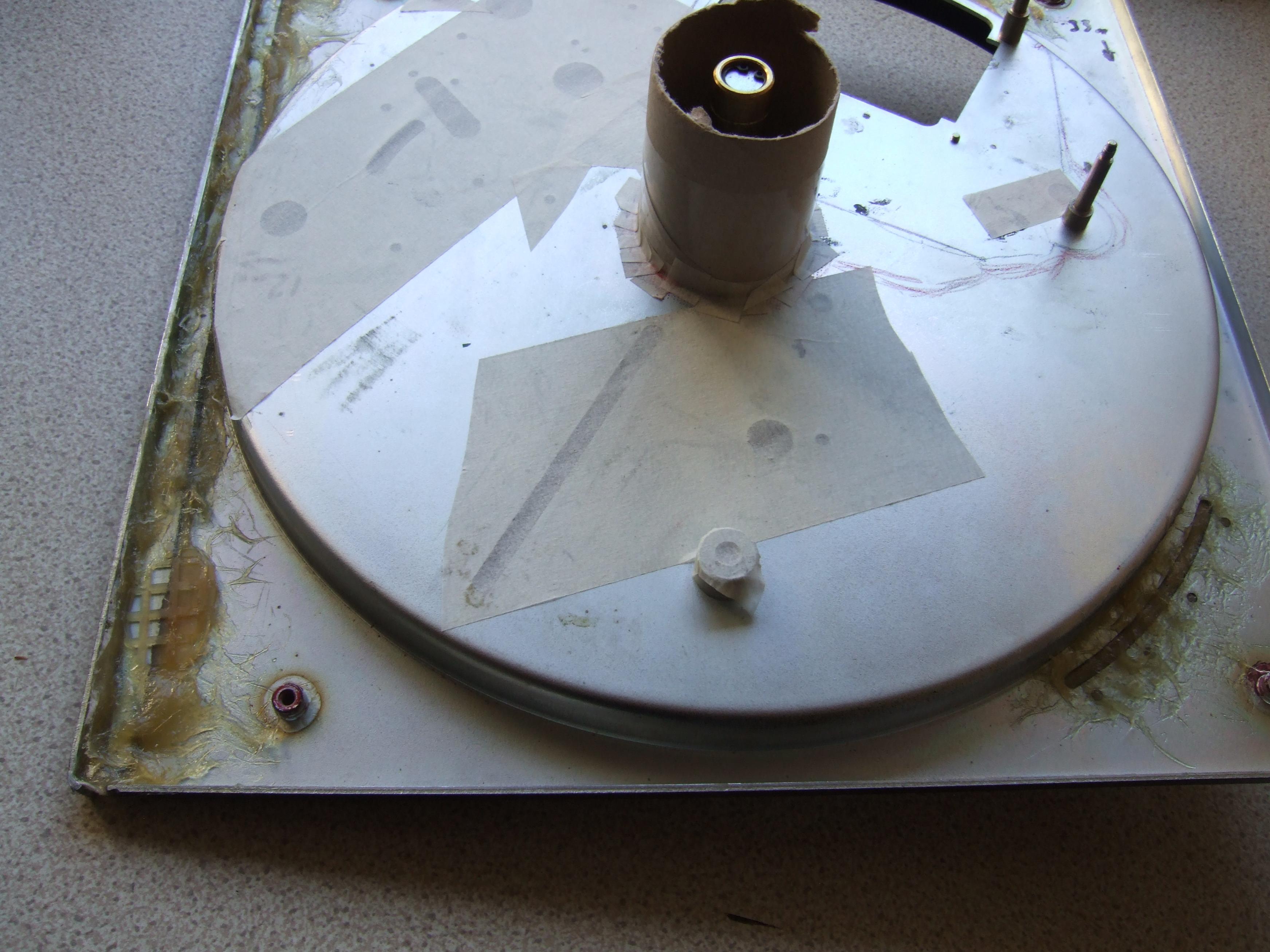

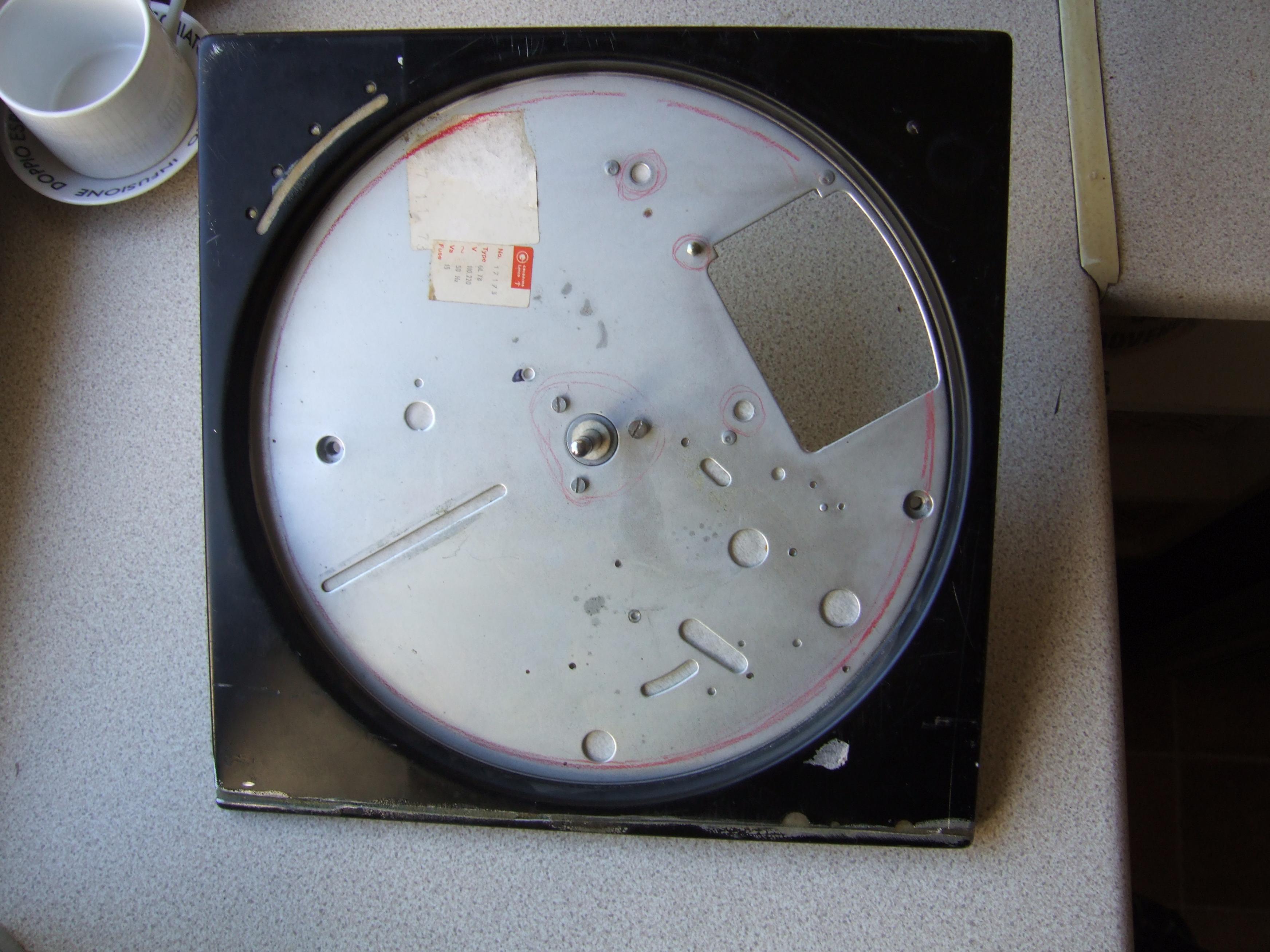

Ok as stated earlier mines a Knackerd old Lenco 78 Idler Drive.
First pic, Platter completely stripped.
Second pic, Plater cut & then stuck back together, with fiberglass impregnated resin (nasty stuff) & some masking in place.
Third pic, Plater now a different shape & almost for resin.
As it's going to take a bit of time for me to get the resin, I'm buying 20kg
so lots of sticky & potentially messy hrs ahead…
The masking etc will need to be very carefully done, so as not to let this stuff get out of control.
This is where most of my time on this project will be for some time.
& at the moment I think it will take 3 resin pores to get it to what I think will be right for this deck.

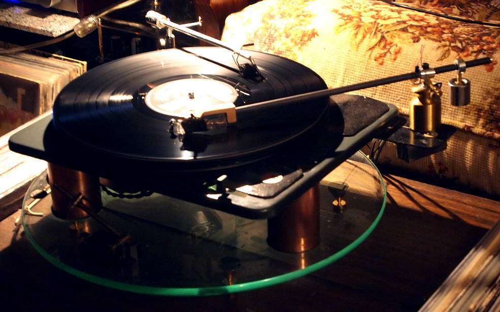

I just started with a Lenco L75.
Removed all not necessary parts.
Putted the chassis on alu. leadshot stuffed; tubes assembled on a piece of 20mm "panzerholtz" .
Swapped the Lenco bearing for a home brewed one by Jos, a LencoHeaven member.
And not to forget stacked platters. Two Lenco and a 30mm Clearaudio acrylic platter on top.
I`m still not sure about that stacked thing, because I think the quality of motor and bearing are the most important.
The benefit of a chassis on "studs " : you can simple demp the chassis local by one ore more removable studs.
Hans.
