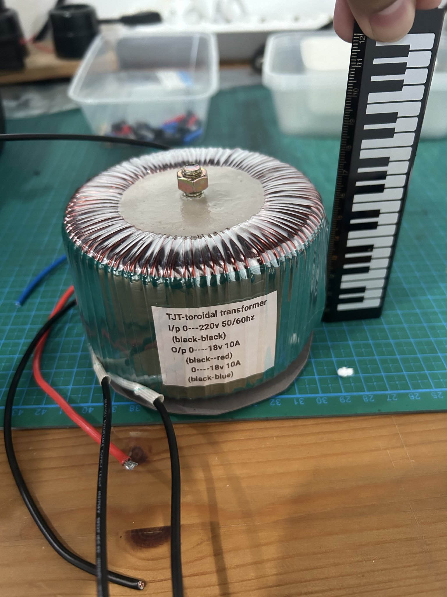

i’ve bought transformers to prepare my build, its output 18-0 x2 with 10A each, so 360VA in total.
I know Mark suggested to use 300VA 18-0x2 Antek 3218 and I’ve seen others using 4218 (bigger ampere).
I checked the dimension of Antek 3218 that is 12.5cm D and 7.9 H. But mine is 10.5D and 6.5 H
Will this works?
Thanks!

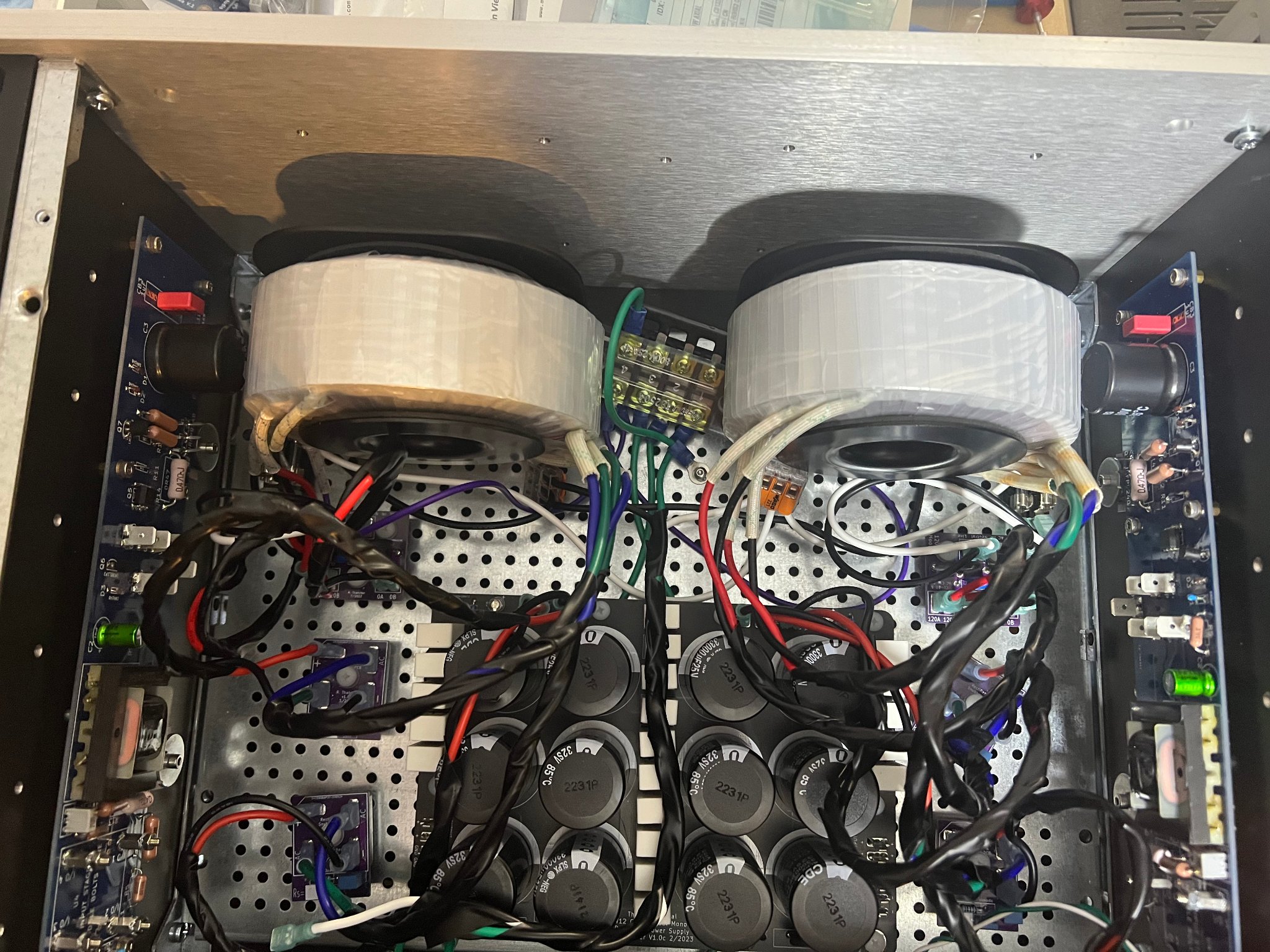

It probably depends more on the case and the power board. I'm using 2 x 200VA from antek - the depth on them is 3.9". Its a little tight but there is still room. It likely helps to mount them vertically - thats how mine are. ( I went dual 200s so a little different than the normal build )
You can see from how my layout is there is plenty of room but its kinda tight. I have the coils mounted as far to the front as I can.

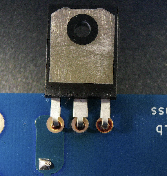

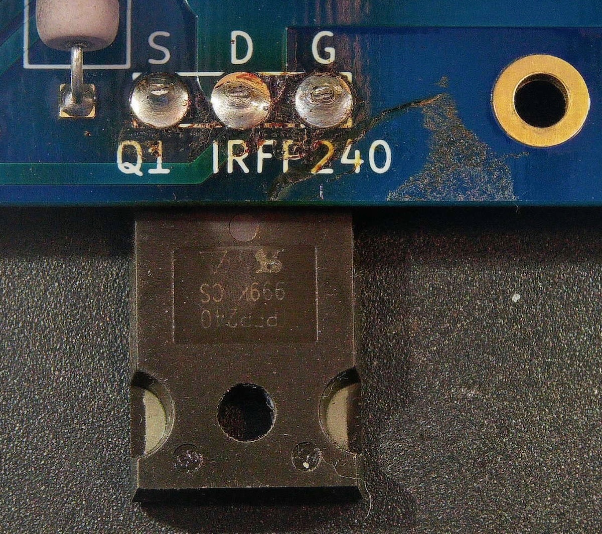

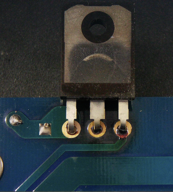

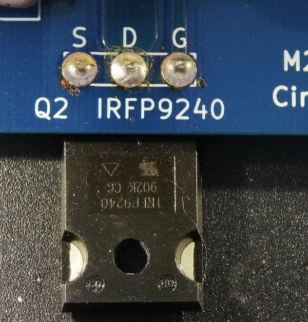

I need some help figuring out what happened to my M2X and how to fix it. I’ll try to make this as brief as possible but it’s a long story. My M2X has been playing perfectly for 5 years. A couple of weeks ago I bought a new stand to accommodate all the pieces I’ve added over the years (eg: turntable, Iron Pre, Pearl 3, and LX-Mini crossover). All the other units worked perfectly as well. Once I completed moving everything to the new rack, the system seemed to work as expected but I had little time to really listen to it. Yesterday I sat down to listen to some records and it did not take long to realize the system did not sound right. The left channel sounded full and lively while the right channel seemed dull and lifeless. I knew something was not right. Actually it’s more accurate to say I smelled that something was not right because about that time the smell of overheating electrical parts was becoming stronger and stronger. I immediately turned off the M2X which was the source of the burning electrical smell. Upon further inspection I also found the full range speaker unit in the right LX-Mini had blown. The cone completely separated from its attachment and the little round cap in the center was blown about 2m away. I would have expected a very loud noise as the speaker self-destructed but there was none. Odd. In my past experience foolishly high volume was required to demolish as speaker. I long ago learned for the price of a tweeter to turn the pre-amp to zero before turning on new equipment or a new set-up. That appears not to have helped in this case.
I opened up the M2X and really couldn’t see where the burning odor was coming from so I removed both amp boards. I checked the PSU and it was operating correctly. The 2.5 amp slow blow fuse was intact, and Mark Johnson’s softstart board continued to work perfectly. The amp boards were another story. The left one showed no signs of thermal abuse. On the right amp board Q1, and to a lesser extent Q2, showed signs of overheating. I also noted a small charred piece of tape that had been used to tie some of the internal cables had separated over the years perhaps aided by the recent moves of equipment. I found the scorched piece of tape sitting on the legs of Q1. In have no idea if the tape caused the problem—though I doubt it since it’s not conductive—or if it’s just another victim. It made a gooey mess on the legs of Q1. The attached photos show the effects of overheating on Q1 and Q2 on the front and back sides of the right channel board.
I have checked all the interconnects in the system to assure that they were in the right places and that none of them were shorted or making contact with circuit parts and wires. I also inspected the M2X carefully for shorts, loose wires, or additional heat abused parts. Everything appears to be as it should be. I am at a loss to explain why the amp’s right channel fried itself. My limited knowledge of circuits and experience as a user suggests three possible sources of the problem: a short, an over-voltage as for example too high a signal input voltage, or a spontaneous component failure however unlikely that may be.
I’d like to solicit your advice on 1) how to trouble shoot and fix the circuit board, and 2) how best to insure that I have eliminated the cause of the failure. Just replacing Q1 and Q2 doesn’t seem like the best thing to do since I don’t know what caused the problem. I have DVMs, a Siglent Oscilloscope, and a Siglent 3 channel/30V Lab PS available for trouble shooting. Milpitas input boards were installed during the failure; I have all of the other M2X input boards available as well. I have not included the customary pix of the amp boards because they have worked well for years and show no signs of damage or change. The system itself is working great with a replacement amp and speakers so I am pretty sure that at this point the problem resides in the amp.
Thanks for reading this long post. I look forward to hearing your thoughts about what to do next. I need a plan.

All the MOSFETS I've cooked have shorted between the Source and Drain. I'm making an unqualified assumption that you can check for shorts without removing Q1 and Q2. IMHO determining whether Q1 and or Q2 have passed away is the logical first step. I'm sure others will chime in here.
Dan

Audiobear - Looks like your power MOSFET thermal interface solution may have eventually failed. My crystal ball is very hazy and I can't see your previous mounting arrangement. For long term stability, you want:
- a proper large format washer on the component to spread the pressure evenly, I use a Hillman 3/4" diameter washer, and it's quite thick
- a springy steel split / lock washer between screw head and said large washer
- proper mounting pressure - for my output devices, I use a fixed torque T-Handle specified for 1.0 Nm
Never underestimate thermal-cycling and effects. Over time, this cycling can absolutely cause a loss of this critical / required component-to-heatsink clamping pressure.
The MOSFETS were mounted on alumina ceramic pads with a light layer of Superlube Silicone Heatsink Compound. Washers were as you describe and I use a 0.9Nm torque wrench. Can I guarantee that this joint was properly torqued? I honestly don’t know. It had not occurred to me that thermo-cycling could have loosened the lock washer and nut. It’s too bad both sides are now disassembled. I don’t recall the nuts being particularly loose when I disassembled amp, but it’s possible.
The MOSTFETs clearly need to be replaced. I’ll do that first. I’ll check the components that can be checked in situ but there’s not many downstream of the transformer. I have a test rig with heatsinks and power supplies. I just may see what happens with new MOSFETs installed. What else should I check before applying voltage to the boards again?
