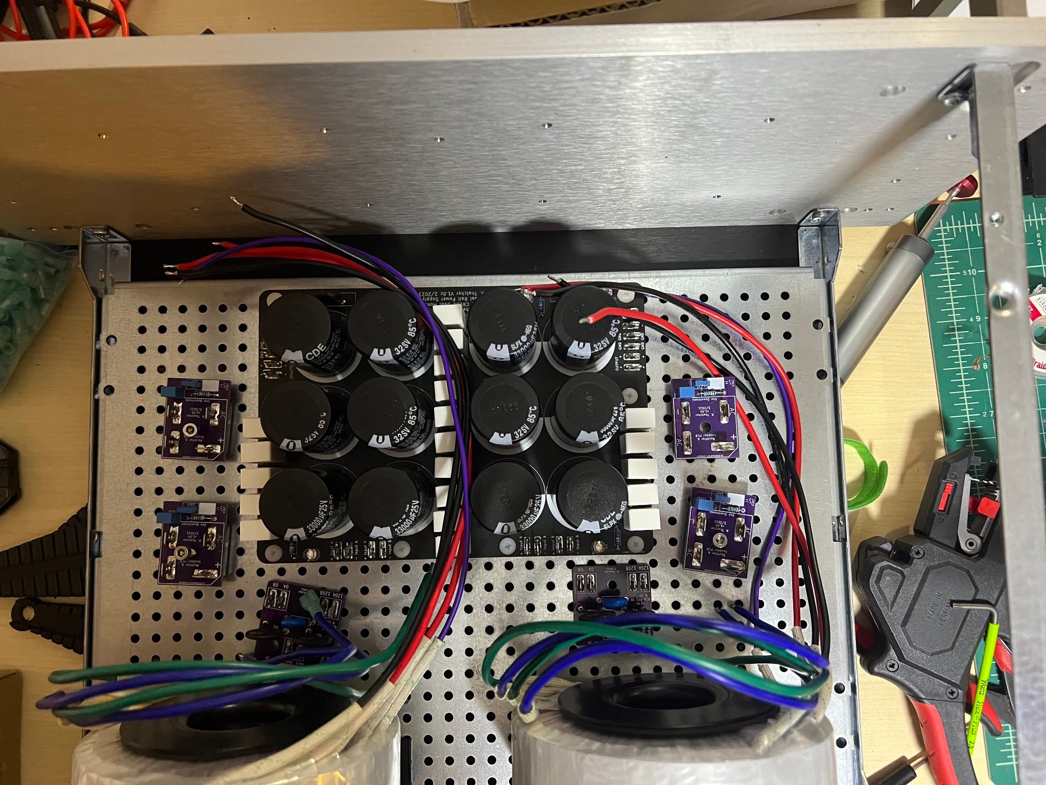

Progress 😉 Waiting on some crimp connectors so I can wire up the rectifiers.
I'll probably go with this layout - any concerns having the rectifiers near the amplifier boards? Should I move them back by the coils - its a little tight in there but I could probably make it work - put the rectifiers in-between the filter board and the coil on either side.
Question on the toroid. Is it worth getting a toroid cover for each or just have them as I have them?
I would suggest drilling out the snubber board hole so the bolt head passes through to the rectifier base, not applying load to the PCB. I made magic smoke come out on a couple fuses when the the snubber board shorted to the metal rectifier case through the solder mask.
my answer is try it without then try it with. find out for yourself if worth it.
Oh I'm going nuclear on the rectifiers - nylon screw, nylon standoff and ... yep nylon nut 😉 No shorting for me. I saw the post on the shorted rectifier and do not intend to repeat that one!I would suggest drilling out the snubber board hole so the bolt head passes through to the rectifier base, not applying load to the PCB. I made magic smoke come out on a couple fuses when the the snubber board shorted to the metal rectifier case through the solder mask.
I'll check on the diameter of the screw head and see if I can drill that out - good idea! To be honest though, I can go fairly light on the tension and just use my soldering iron to melt the nylon so it never loosens!
Also of interest? Because I'm spreading my AC out across 4 freaking rectifiers the current load on each should be pretty low. Its what like 1.5 amps total spread by 4? These things should be cool to the touch!

Each rectifier will see the 1.5A if each channel has its own power supply board.
Is the case of your rectifiers plastic or metal? Shorting of the snubber board is an issue only if the rectifier case is metal. If your rectifiers have a metal case, you will need to leave a gap between the snubber board and the rectifier. The screw is not the path of the short. The reason for drilling the snubber board is to allow the screw to bear directly onto the rectifier.
Looking at your picture of post #6,915 it looks like you have the power supply boards at the front of the chassis and the power transformers at the back of the chassis. That is not good for the amplifier as the amplifier board has a signal transformer mounted toward the back of the chassis. The power transformer should be located as far as possible from the signal transformer, so the best location for the power transformers is at the front of the case.
