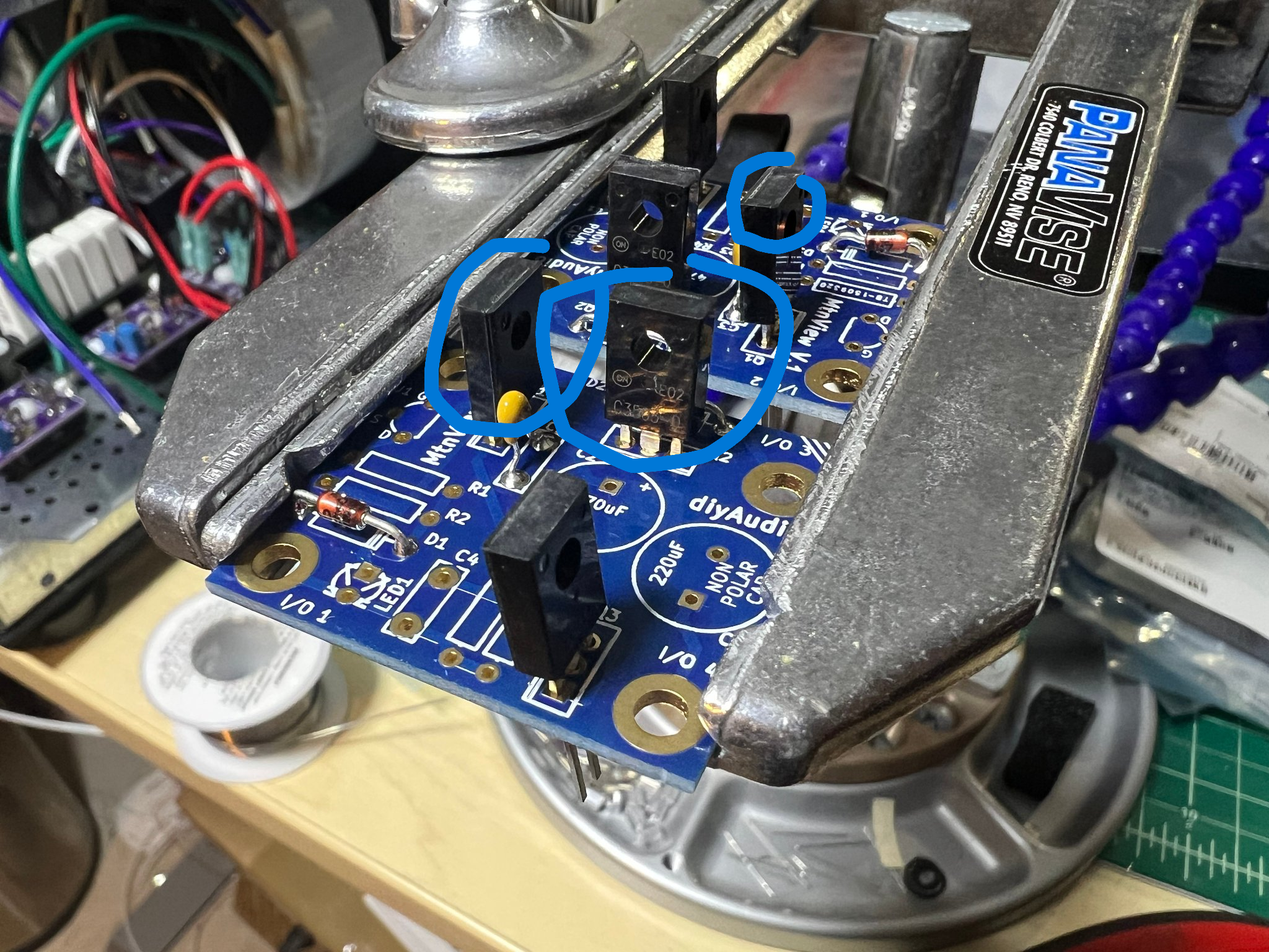

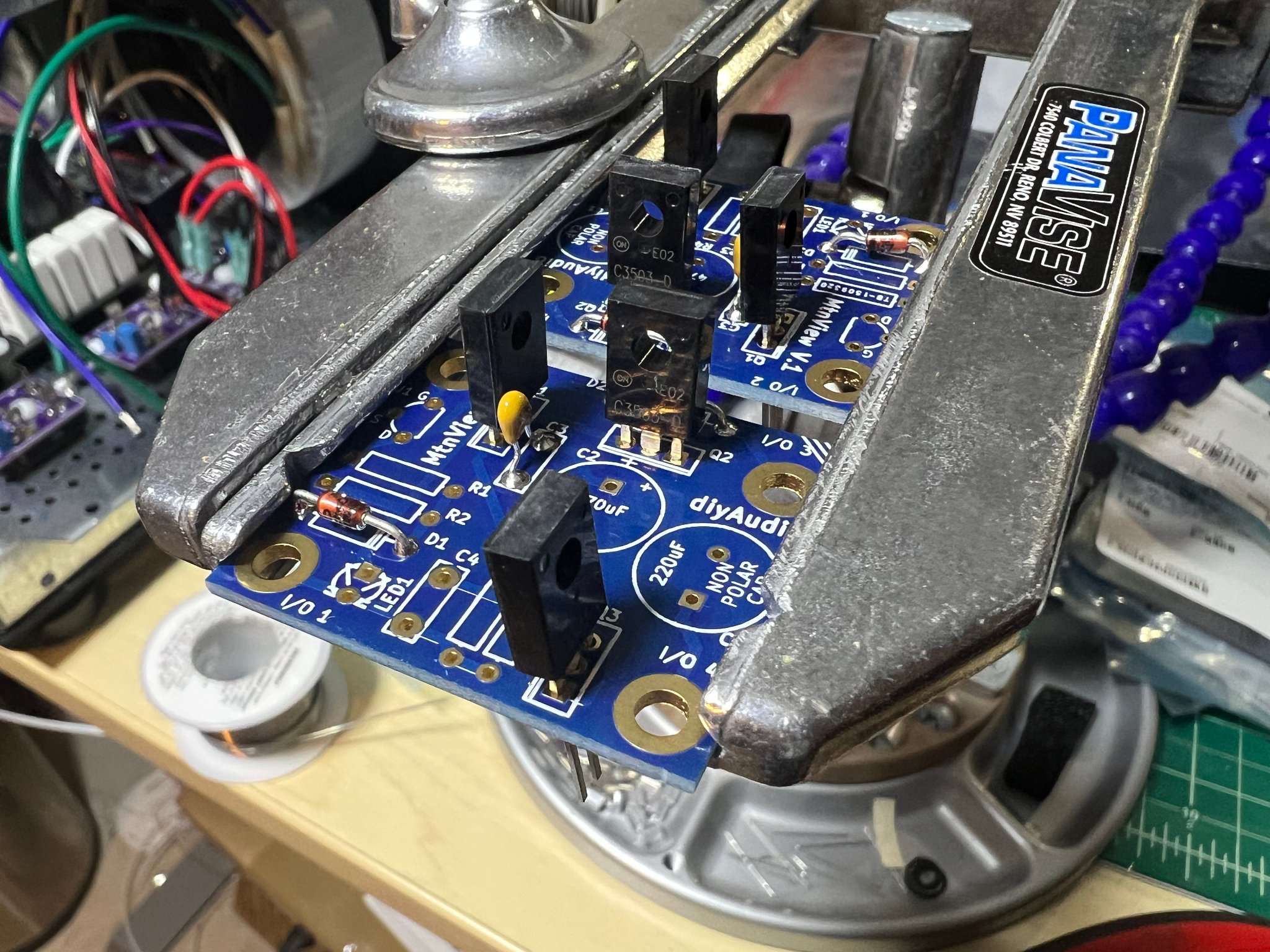

I'm building the mountain view input stage - do I have these transistors oriented right? The "back" ( legs closest to the flat ) lines up with the line on the pcb. I think its right just looking for confirmation!
Next up is the led and resistors.
Yes, if everything is perfect, then that's correct re: you're understanding. In fairness, in your photos .. I can't be certain that you followed that practice. Could just be the photos and/or my eyes, but some of them look reversed.
What I'd do in your case (for learning and for quadruple confirmation) is to examine the datasheet for the parts you purchased against the schematic. It shouldn't take more than a couple minutes vs. the potentially lengthy period of repair if for any reason the parts you purchased have a different pin-out than what was used to create the schematic. Rare... but it happens. Then, you'll have every bit of confidence that they're all in properly vs. someone with really bad eyes looking at a photo. Others may be able to look at the photos and the parts designations and tell you with more certainty.

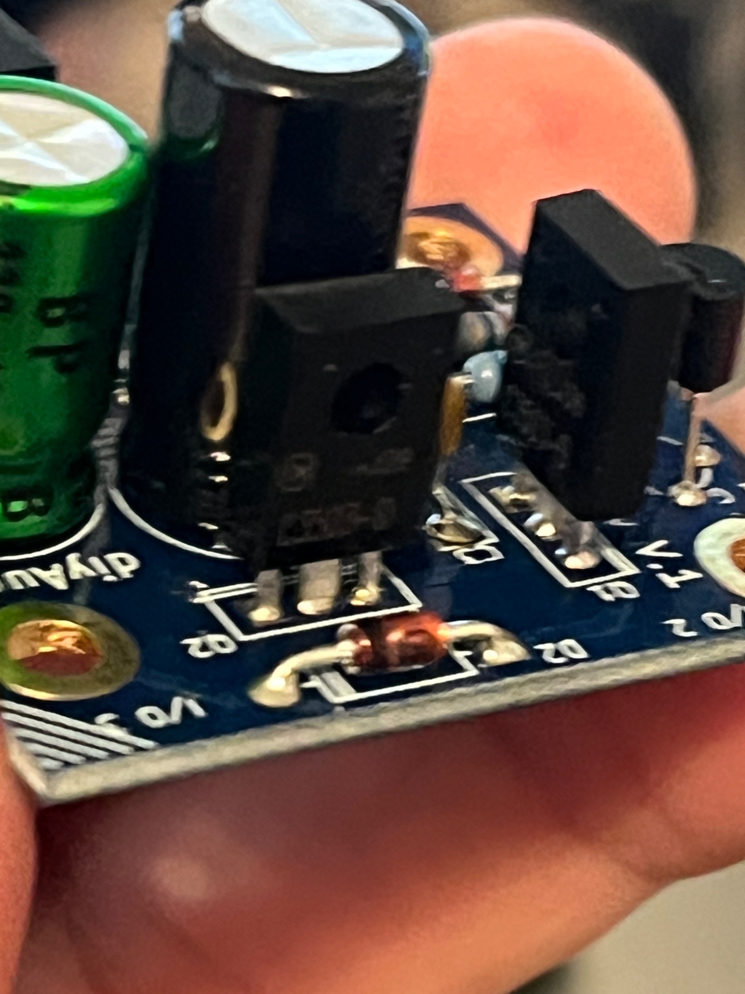

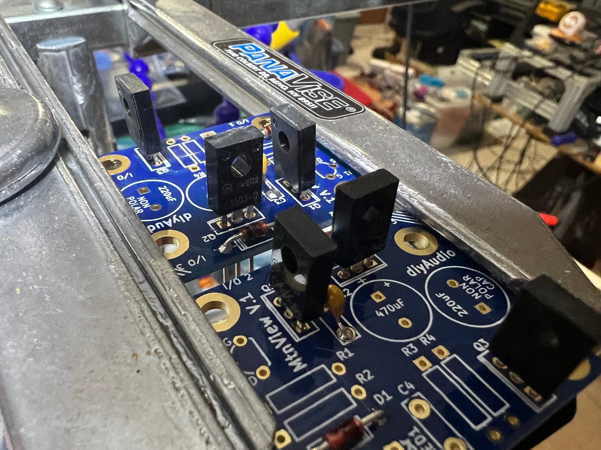

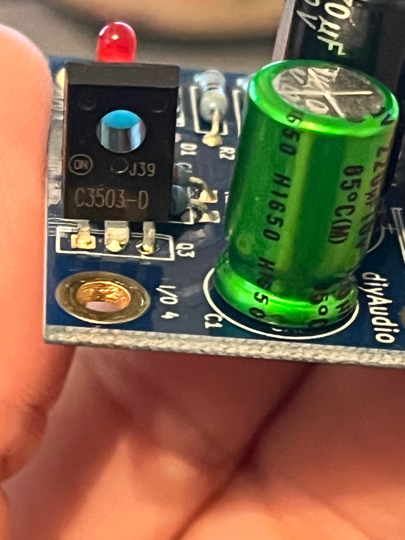

I just looked at my Mtn View boards and Q1, Q2, Q3 are all reversed. As @cubicincher said the "double line" on the case outline is the Back/Heatsink side of the transistor case. - so case writing should be opposite the double line

@bilsch - If I were you... I wouldn't trust anyone's eyes. I'll repeat my recommendation - Check the data sheet and confirm.
As an example -
This person sees theirs as "reversed" ... I actually see them as correct to the typical practice in their photos.
In your photos, I see a few that I'd say don't look correct or at least don't seem to match between boards. I see a few others that look just fine as I mentioned previously. The only way to know with certainty is to triple check yourself.
I circled what I'd triple check below, but if I were you... I wouldn't trust me as the final decider of whether your amp will work based on a photo and my bad eyes.
Cheers!
Edited to add - What I'd also recommend is orienting both boards the same way as you solder them. That may (or may not) help.

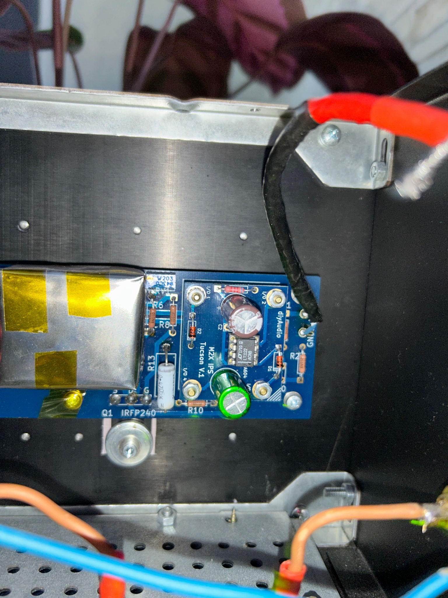

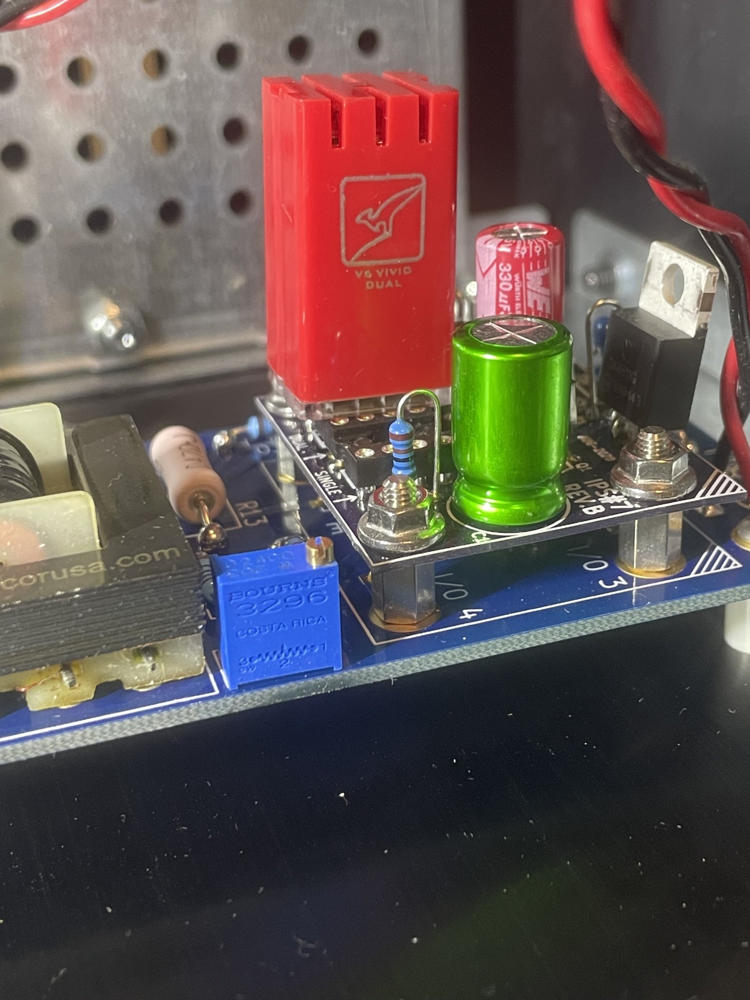

A few years have passed and I got a malfunction. Loose connection in the snubber module resulted in the lack of a positive power rail. It started with a floating offset and ended with 11v on the speaker output. Fortunately, I have RTR Speaker Protection modules. They also earned money for themselves 🙂
By the way, I changed the card to Tucson with LT1122 and decided that it was finally time to finish the other daughterboards

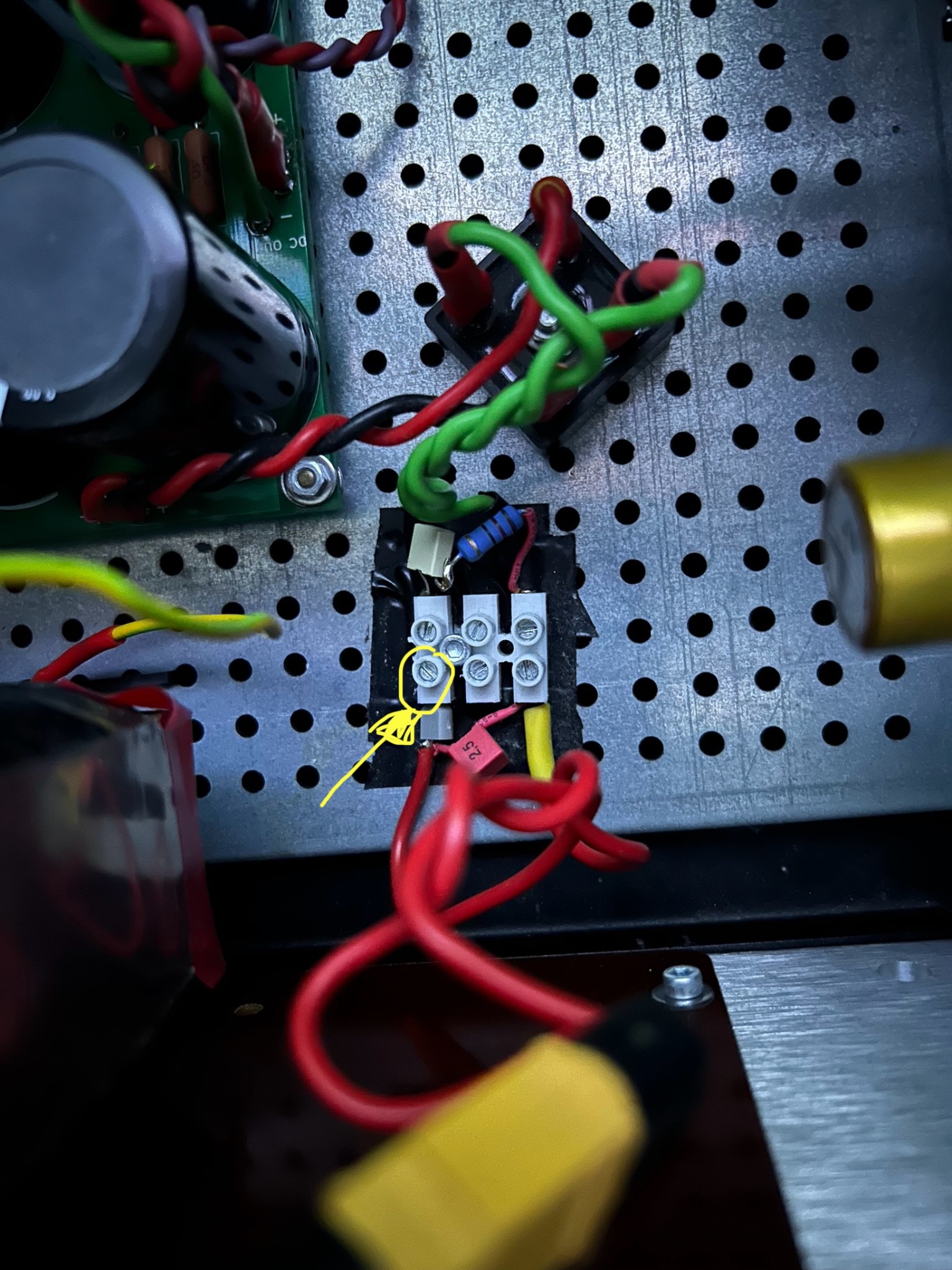

Snubber module?
Did one of the connections to the rectifier become dislodged?
I am trying to visualize what could have happened. My guess is that you may have one of the cute snubber boards that slides over the monolithic rectifier pins.
Mainly, I am trying to determine if the failure mode:
  • had anything at all to do with the "snubber board" which I find unlikely, or
  • if you just had rectifier connection come loose (more likely), or
  • it was something completely different.
Could you please describe what connection came loose and what type of terminations you used and/or if you directly soldered the connections.

^ You have lived and learned.
You may know it now, but you should not solder multi-strand wire for use in a terminal like you are using. 🙂
I rely heavily on something very close to this. My memory is not perfect, but I am pretty sure @Mark Johnson was the one that recommended that I try it. I got mine in early 2020 according to my purchase history, and it has served me well.

Yes I was the (M2x + ferrules + specialized crimper + super cheapo assortment at amazon) evangelist. They make life sooooo much easier when wiring up an M2x. I believe ferrules are required by the electrical code in Germany and perhaps elsewhere; bare wire (either stranded or solid) into Euroblox connectors is forbidden.
An underappreciated feature of ferrules is that you can shove and crimp two stranded wires into one ferrule. So you can have Vpos_left and Vpos_right DC power wires to the left and right channels, sharing a single ferrule and a single Euroblox connector position (cage).
