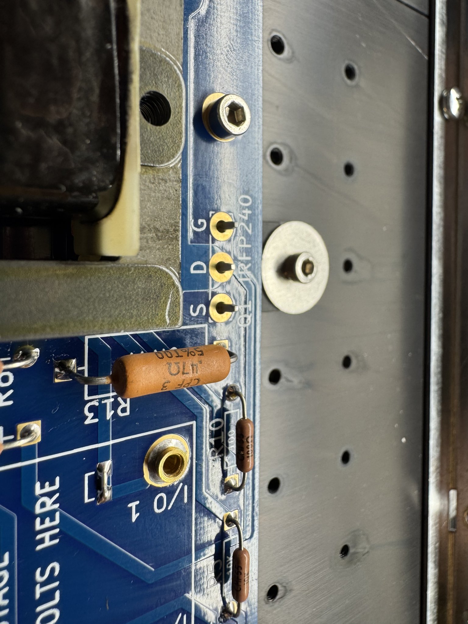

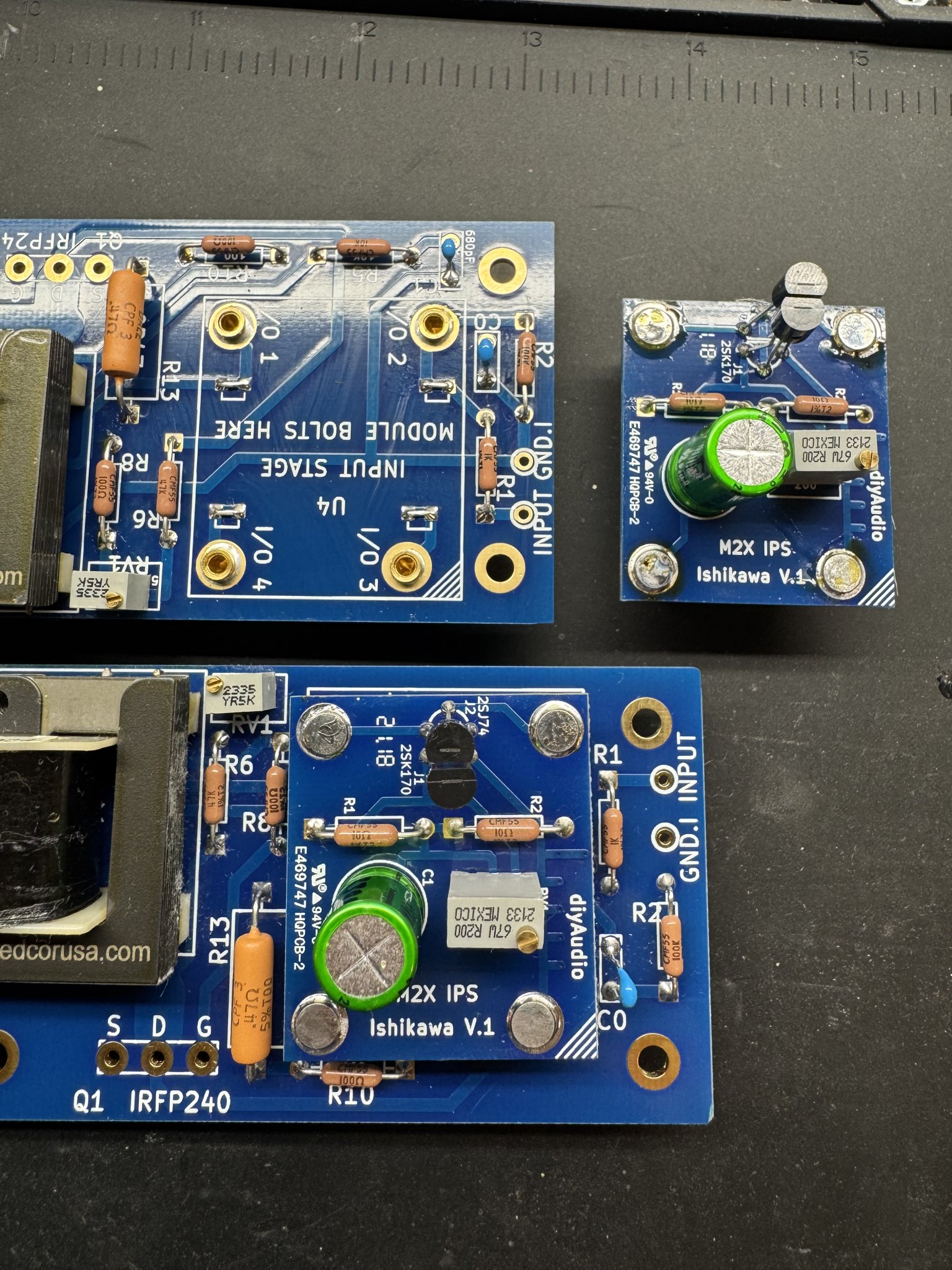

My experience with M2X is that it can be made very silent if Edcor transformer is screened so it will not pickup any noise from environment (power transformer, rectifiers etc.).
Further to what MEPER said, I'm not sure if it is the IRFPs that cause the 500 uV noise figure. I have built my M2 with Toshiba 2SJ201 / 2SK1530. To get the noise lower than 500 uV, and in order to have it nearly silent on my 100 dB/W speakers, I had to magnetically shield the Edcors. I also had to work with careful wire routing, and have put a magnetic shield between power transformer and rectifiers on the one side and CLC and the amp boards on the other side.

All good feedback - my question with the output devices really stems back to the idea of removing as much noise as possible.

In all of these amplifiers, PSU layout and isolation from interacting with the amplifier circuit will be the dominant factor in noise, not the inherent circuit noise. Specific to M2X, look at what @chede said - PSU isolation of the power transformer and bridges, wire routing, and shielding of the signal transformers will make the amplifier significantly quieter. This is echoed by @pfarrell , @SkyPirate , and other builders throughout this thread.
