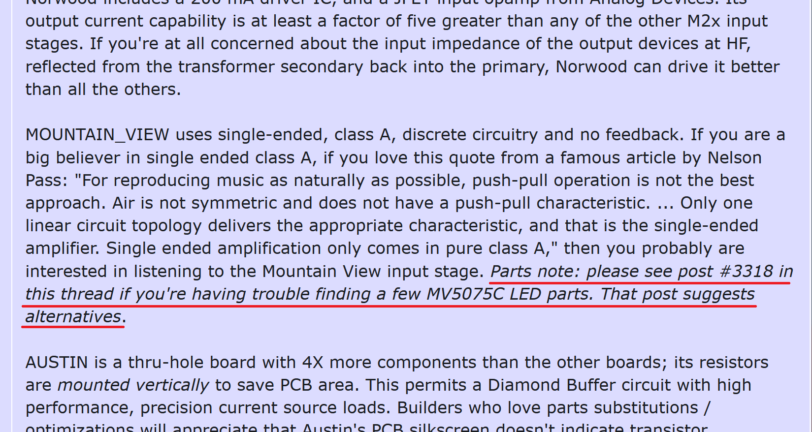

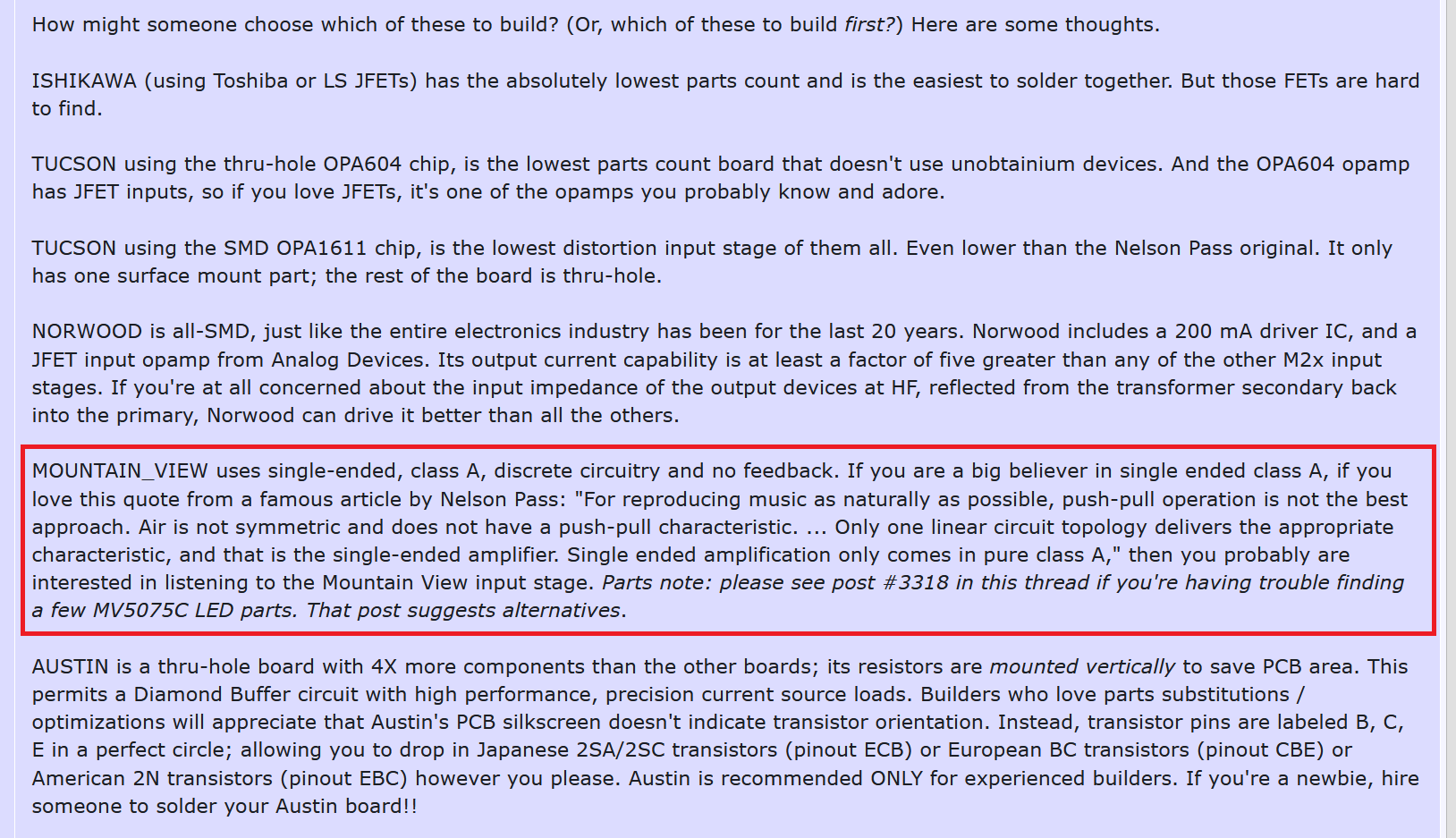

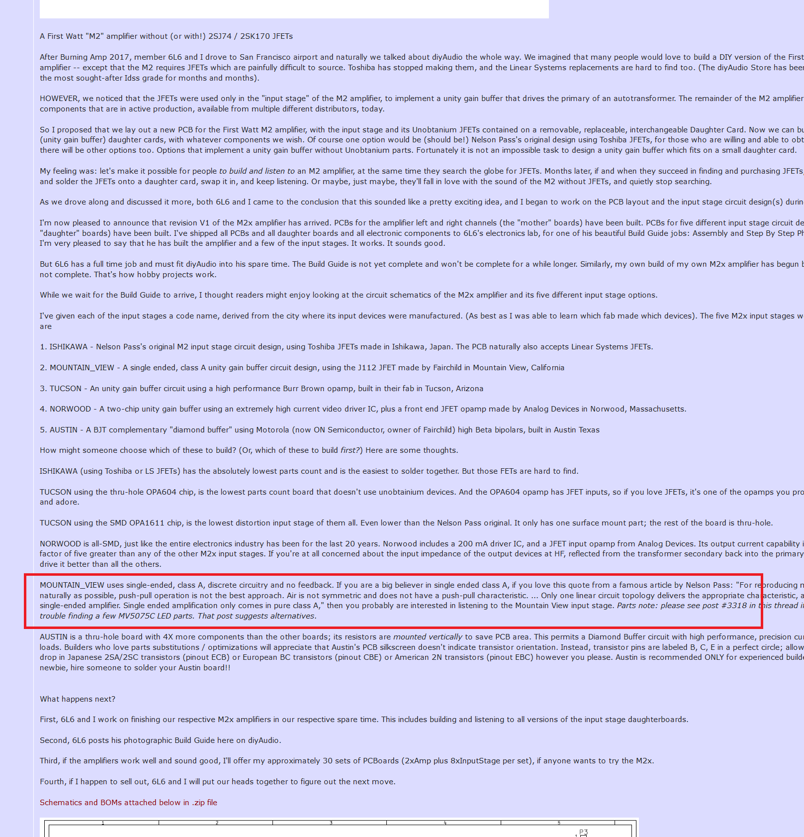

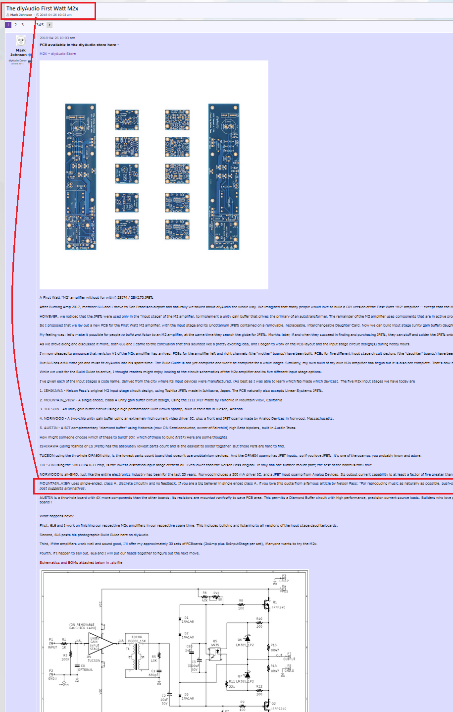

Here's post #1 of this thread, which all M2x builders should read.
In the attachments below, I gradually zoom in upon a paragraph of particular interest, within post #1.
_
_
yea I overlooked it initially - my mistake!Here's post #1 of this thread, which all M2x builders should read.

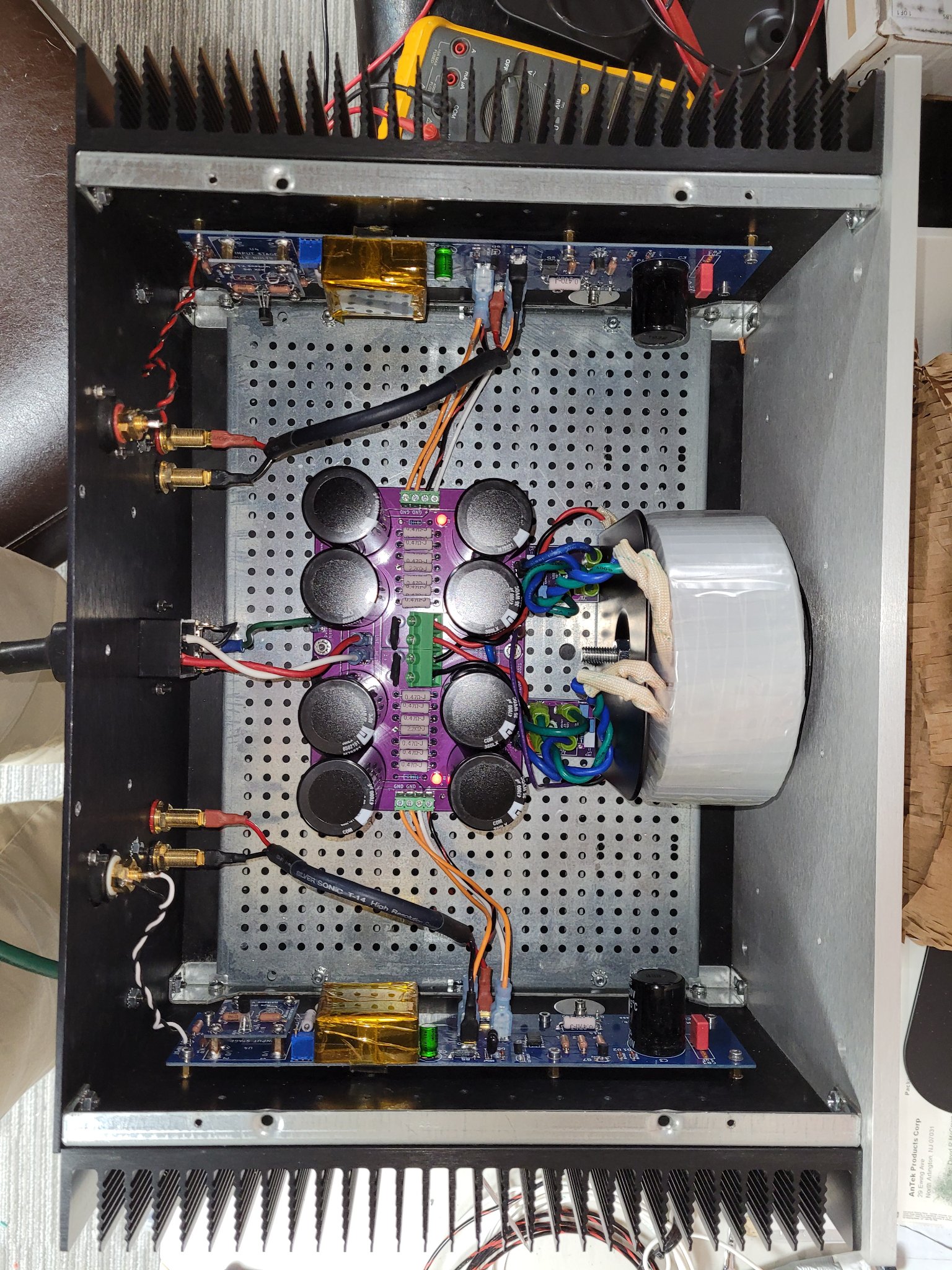

BTW, just finished building a stereo M2X, from the boards and Edcor transformers I bought a few years ago (too many other projects got in the way). Built up a pair of the Ishikawa boards and the above said Tucson boards as input. Used an Antek AS-4220 transformer I had in hand, a nice compact dual rail decoupled power supply board from Randy Thatcher populated with 47000uF/35V CDE elcaps. Nothing special or innovative, just took advantage of the experience of all the participants in this thread (whom I collectively thank!), including tips on layout and Mu-metal shielding. As a result, the amp worked perfectly on first powering, +/-24V rails, very low and stable offset voltage (after adjustment and warmup), and AC noise of under 2mA at the outputs. Very quiet on 91dB/1W speakers. Breaking in, but is sounding really nice.
First impression is the Ishikawa boards are a bit soft sounding on the bottom and a little closed in, but put in the "Sparkos Tuscon" and they were tauter on the bottom and had a larger presentation and therefore tend to prefer that in the amp. I plan on building a pair of the new Milpitas boards to try as well. I will have to get the "Cedarburg" boards to try since I have a few AD797 op-amps around.

Out of curiosity what did you do with the edcor? Is that just a diy shield around it? What, other than Kapton tape, are you using there? How necessary is it?
The Kapton tape is holding the DIY Mu-metal cover together and provides electrical insulation from the autoformer terminal pins. I bought a sheet of 0.01" thick Mu-metal on Amazon and cut out/bent a box covering the Edcor using the plans posted in this thread (a number of times). I have linked a recent post concerting this shield, but do a search and you can find alot of discussion concerning this (recommended).
Thank you for the kind words.. The MuMetal boxes were a bit of a challenge. I made a few practice versions to get the hang of it. The one in the pic above was not as pretty as the other. In any event, I bought the MuMetal from Amazon, as well as Kapton tape. PFarrell was kind enough to send his template...
As far as whether it is necessary, you can follow the discussion and experience others have, it helps to reduce hum pickup by the autoformer induced by the power transformer magnetic field. I installed mine from the start, so cannot really say how much it helped. Power transformer orientation and shielding also helps. I did not shield my power transformer, other than the vertical mounting bracket and belly band shield on the ANTEK transformer.

Hello bilsch,
I also made covers over the EDCORs (post #1580 in this thread). I made them out of 1mm thick copper and MU-metal (0,1mm) inside.
I think it would not have been strictly necessary in my build, because I had no audible hum at listening position.
I would build your M2X without the shielding over the EDCOR and would listen. Is there audible hum?
Then you can check where it comes from. PSU, groundloop, shielding of EDCOR...

To the extent the shielding may have helped in my case, I have no audible hum with my ear right next to the woofer or the rest of the drivers (no buzzing either). It is as dead quiet as any of my other builds. So if you DO have an issue, adding the shield will likely work if hum pickup is the problem.
