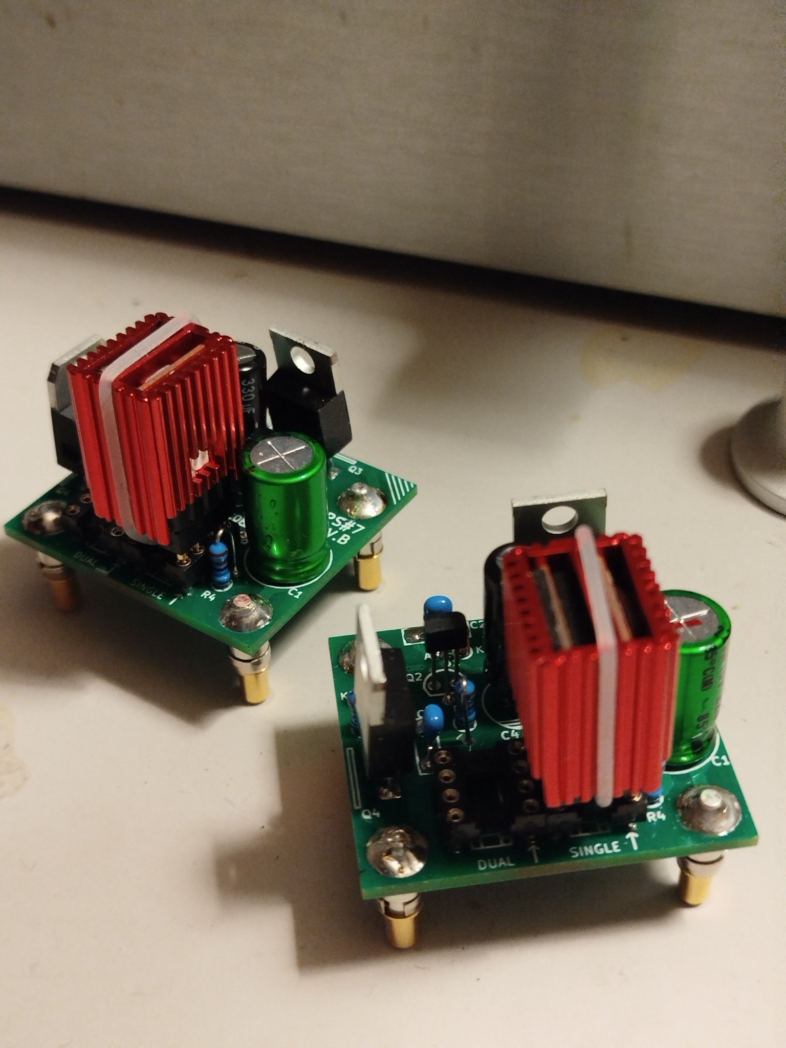

Thank you for another beautiful daughter board - Milpitas !

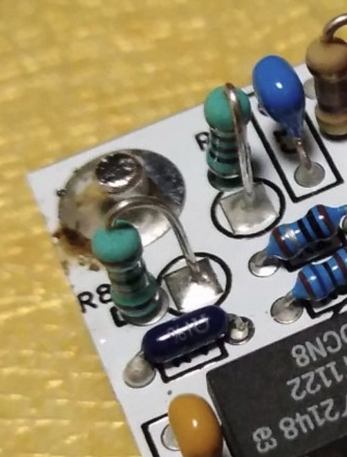

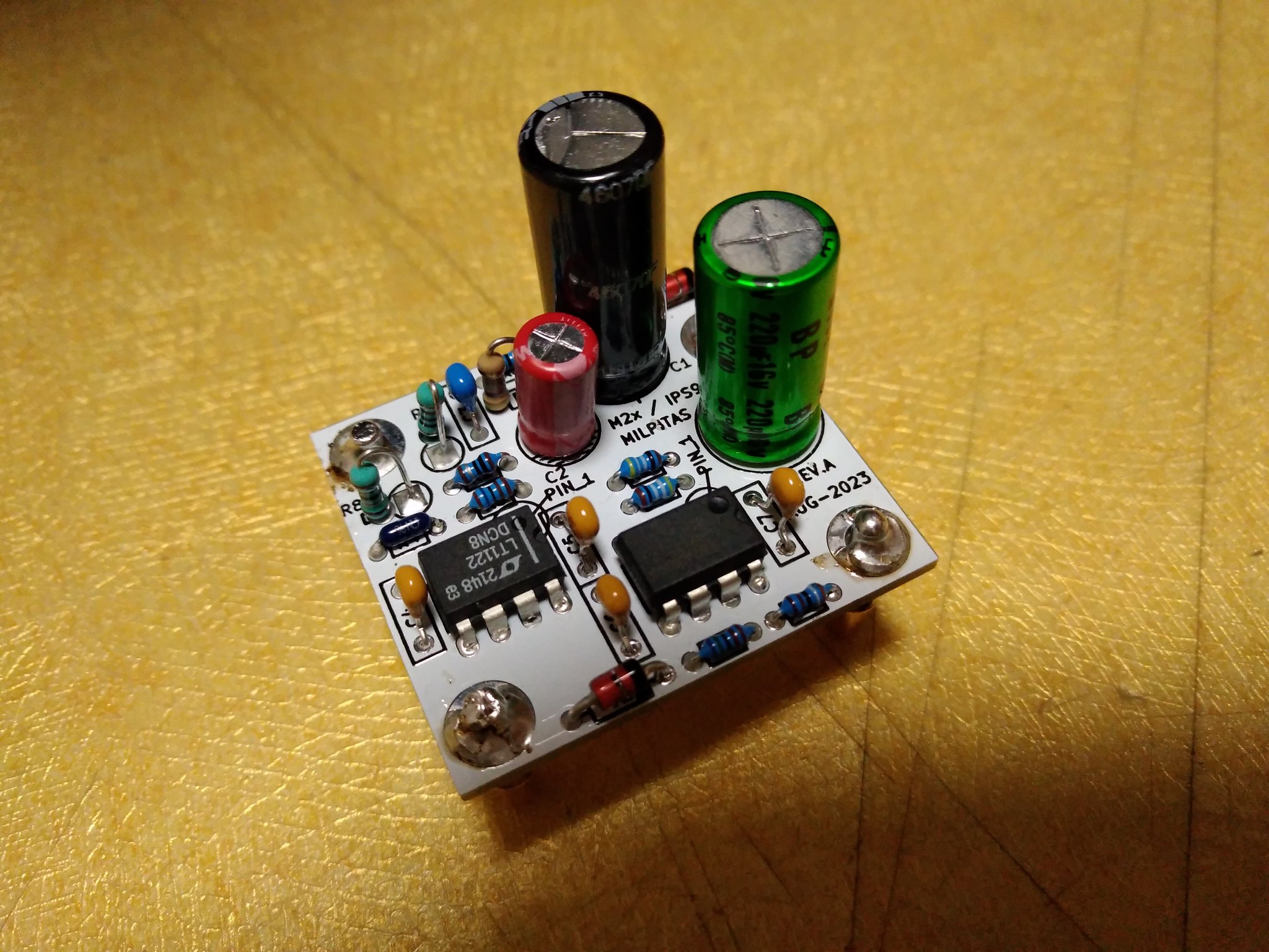

A possible cold solder on the black component?
(and it seems there are solder on the area with screws so ..this part seems weird. But not clear on the picture)
I’m assuming Mark’s PCB screen shows that the resistor body should be at the circle? Plus possible cold joint?

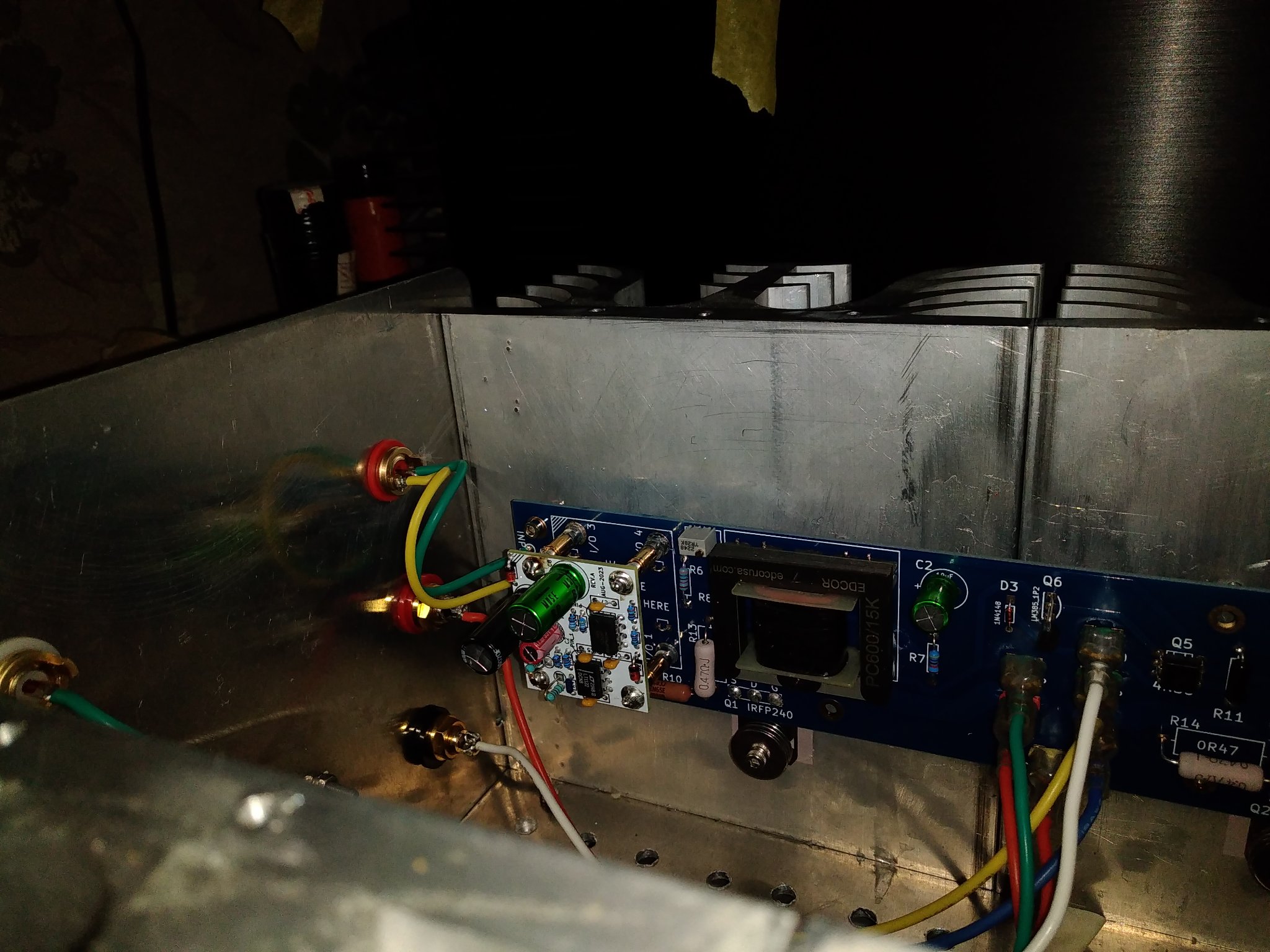

(I understood the welding close to the screw: this is for the quick connection, better shown on the amplifier pictures above)

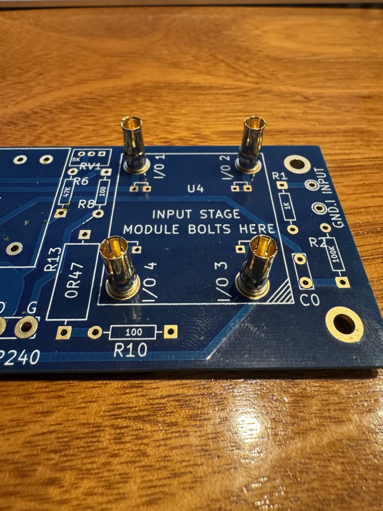

M2x daughter cards have four electrical connections to the motherboard, one connection per M3 bolt hole.
I think it's likely that "a daughter card with a symmetrical input" would need more than four electrical connections. That means it would not actually be an M2x daughter card.
If you and your colleagues design an interface circuit which takes Ian Canada DAC symmetric input, and which has an output that can drive the auto-transformer of an M2x, you can physically mount your interface circuit wherever you like. It doesn't NEED to use the four bolts on the M2x motherboard; that's just a convenience which lets builders perform board swaps quickly, without soldering.

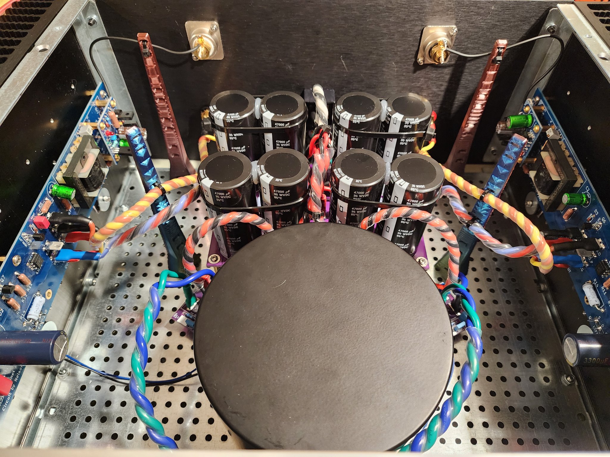

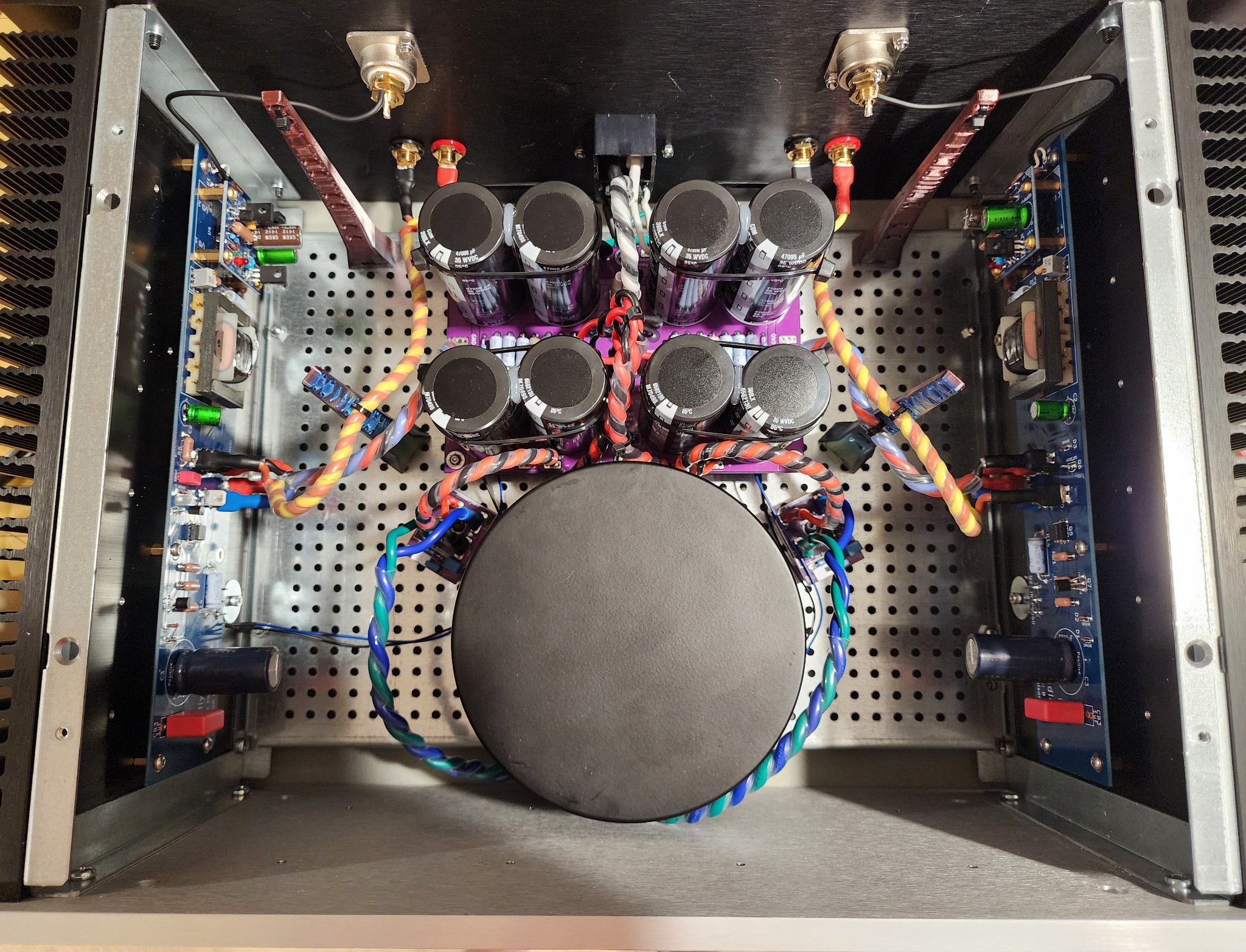

A new M2x is born today. Chassis is Modushop 4U Deluxe with linear PSU using Antek AS-4220 and @rhthatcher stereo PCBs w/ rectifier snubber boards. Wire is all 16Ga BNTECHGO with XHF heat shrink twist wrap (input wire is Mogami W-2381). Current IPS is the Mtn View. I purchased the main boards prebuilt with the IPS from @deafbykhorns a year ago and all I did was add the 9240/240 FETs for the amp boards.
I just wrapped up bias check and setting DC offset after cooking for over an hour, then verified music would play.
I'll follow up with listening impression(s) and lessons learned post when time allows.
Thank you to Papa and @Mark Johnson for this great design. I also must thank @ItsAllInMyHead for lots of support with my silly noob questions along the way.
I gotta give a special shout out Thank You! to @6L6 for all the great build pics, thoughtful advice, and amazing support to help troubleshoot a couple issues I ran into.
Feels so good to finally have music playing. It's a Festivus Miracle!

It looks like you've been going to wire twisting school at night. Are these plastic wire standoffs an invention of yours? I have never seen neater wiring than that! Congrats!
