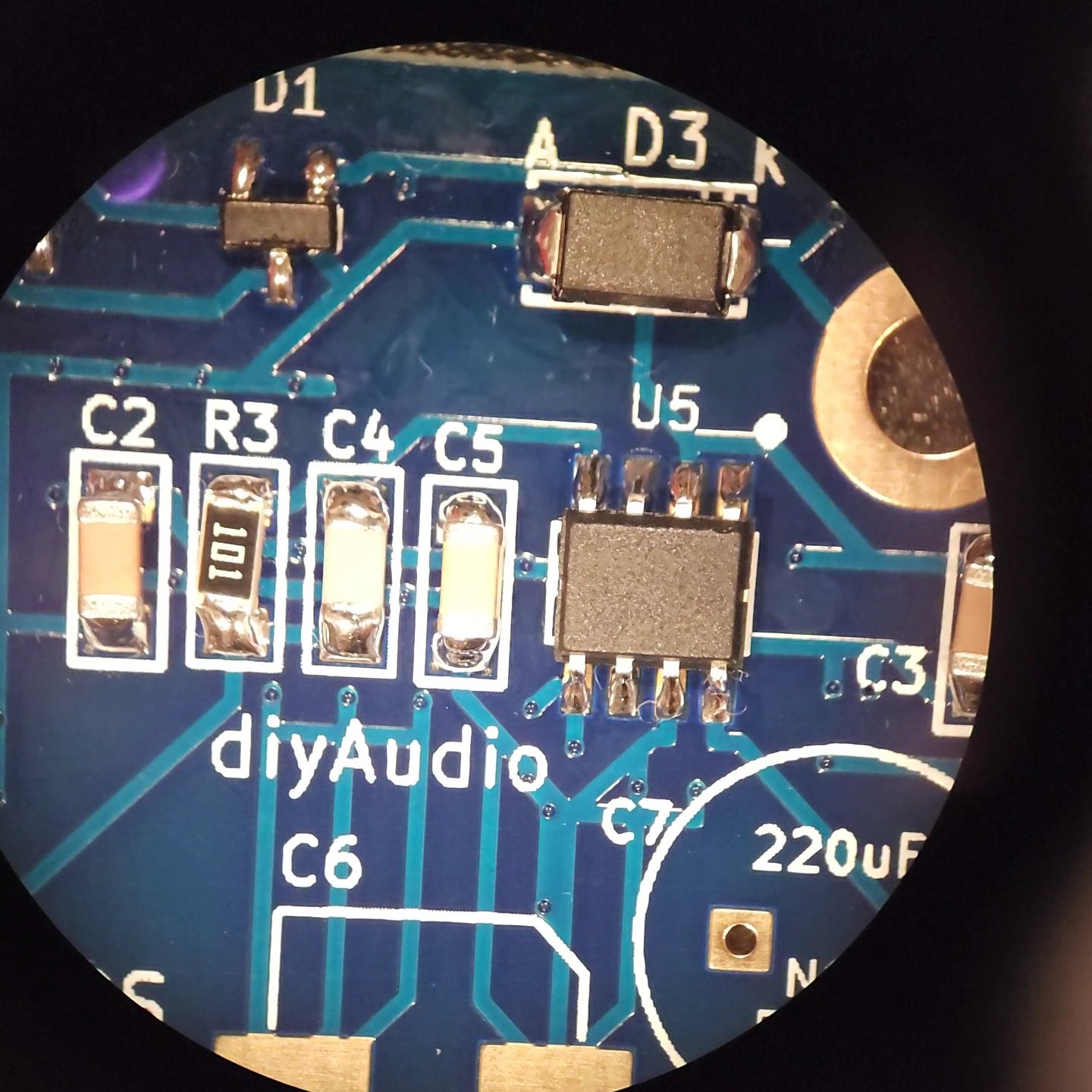

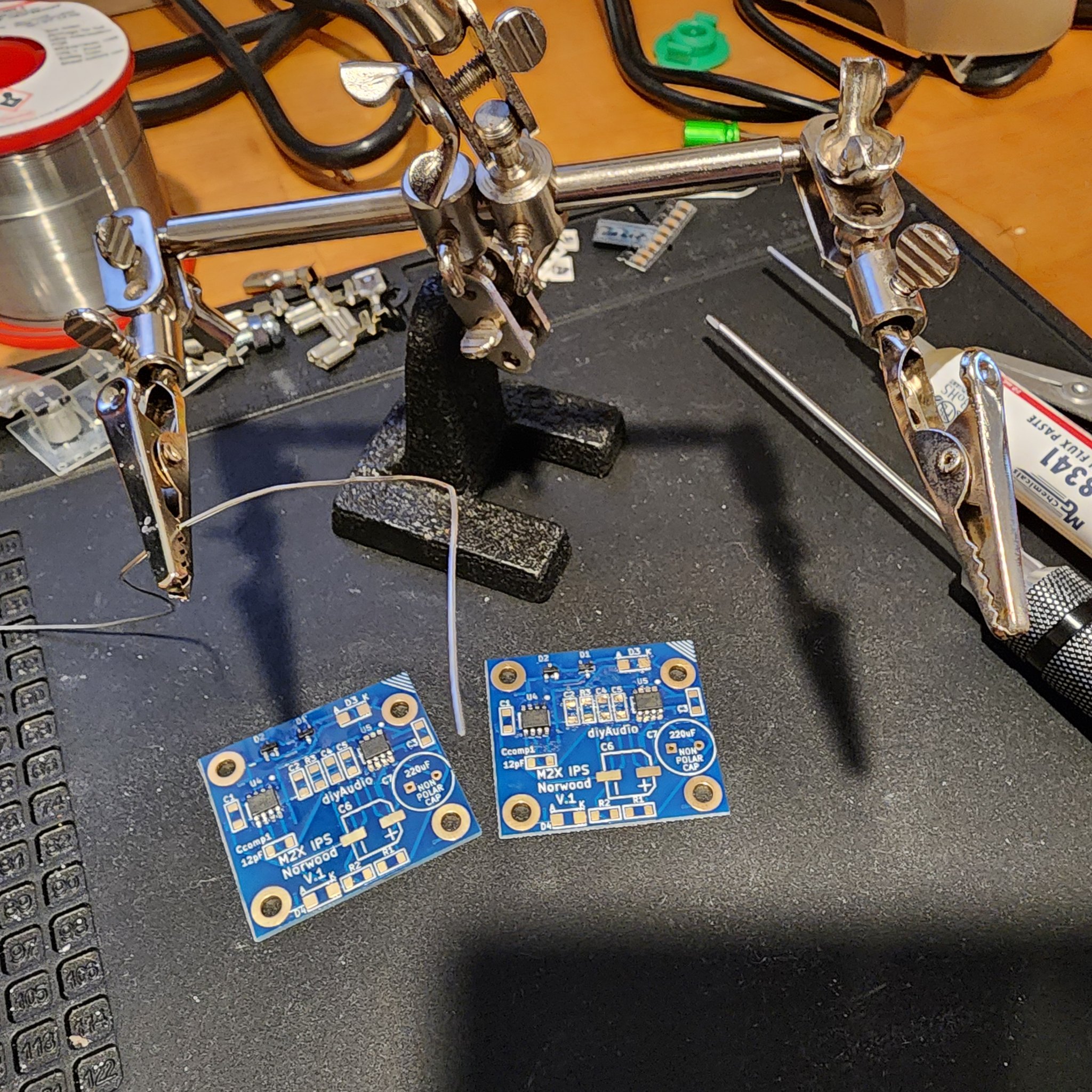

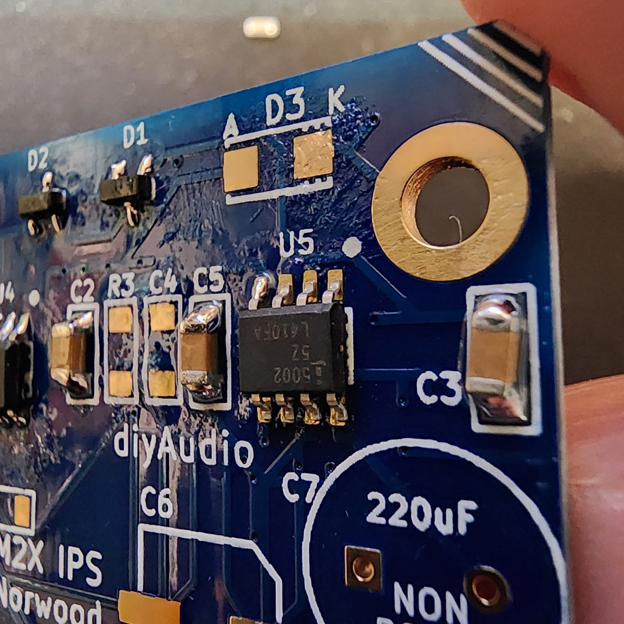

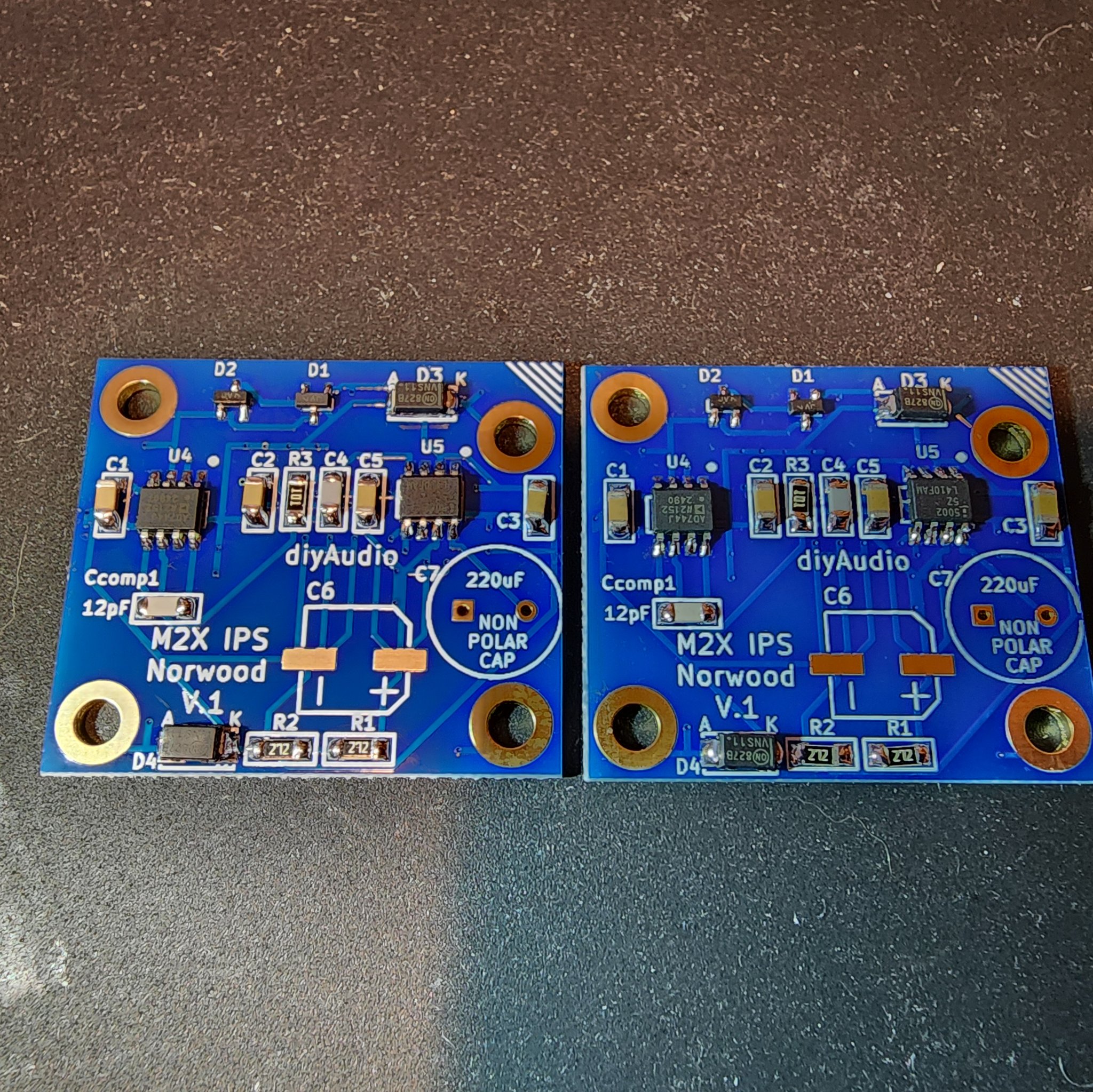

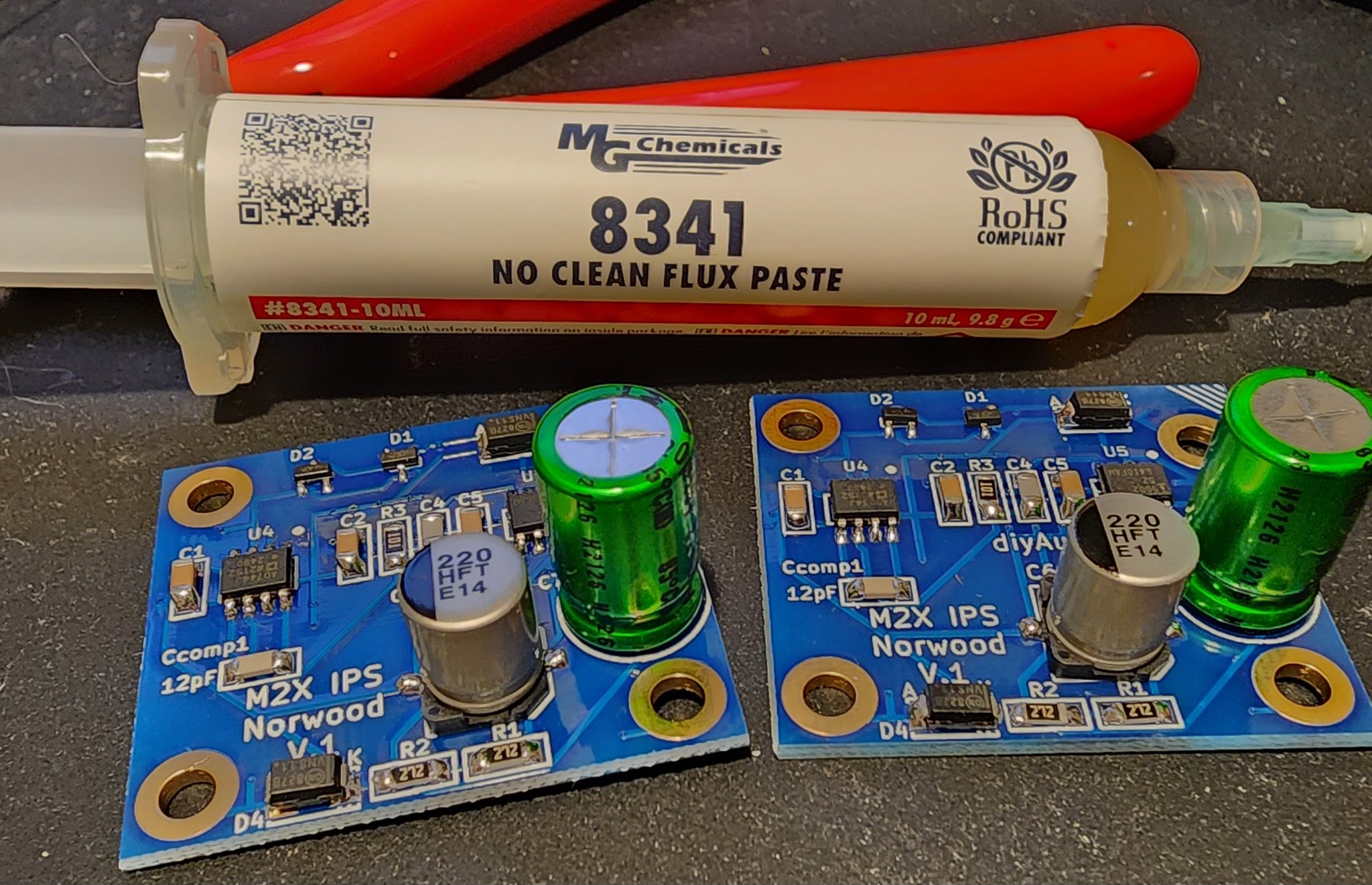

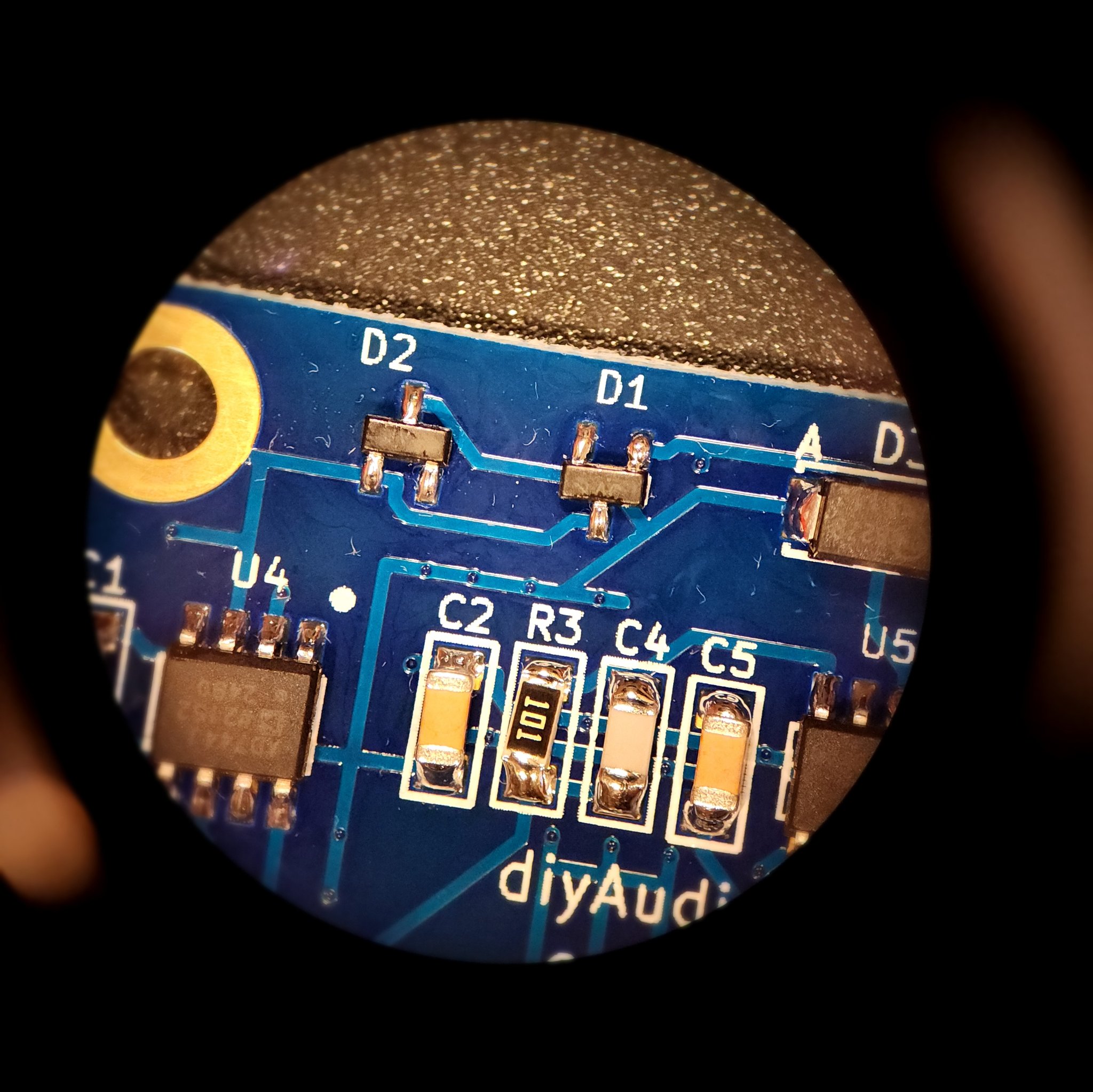

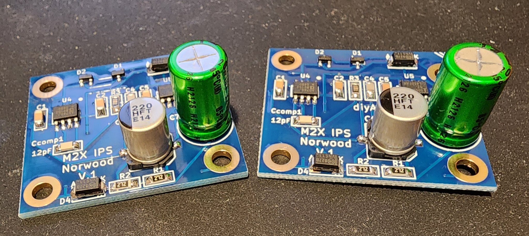

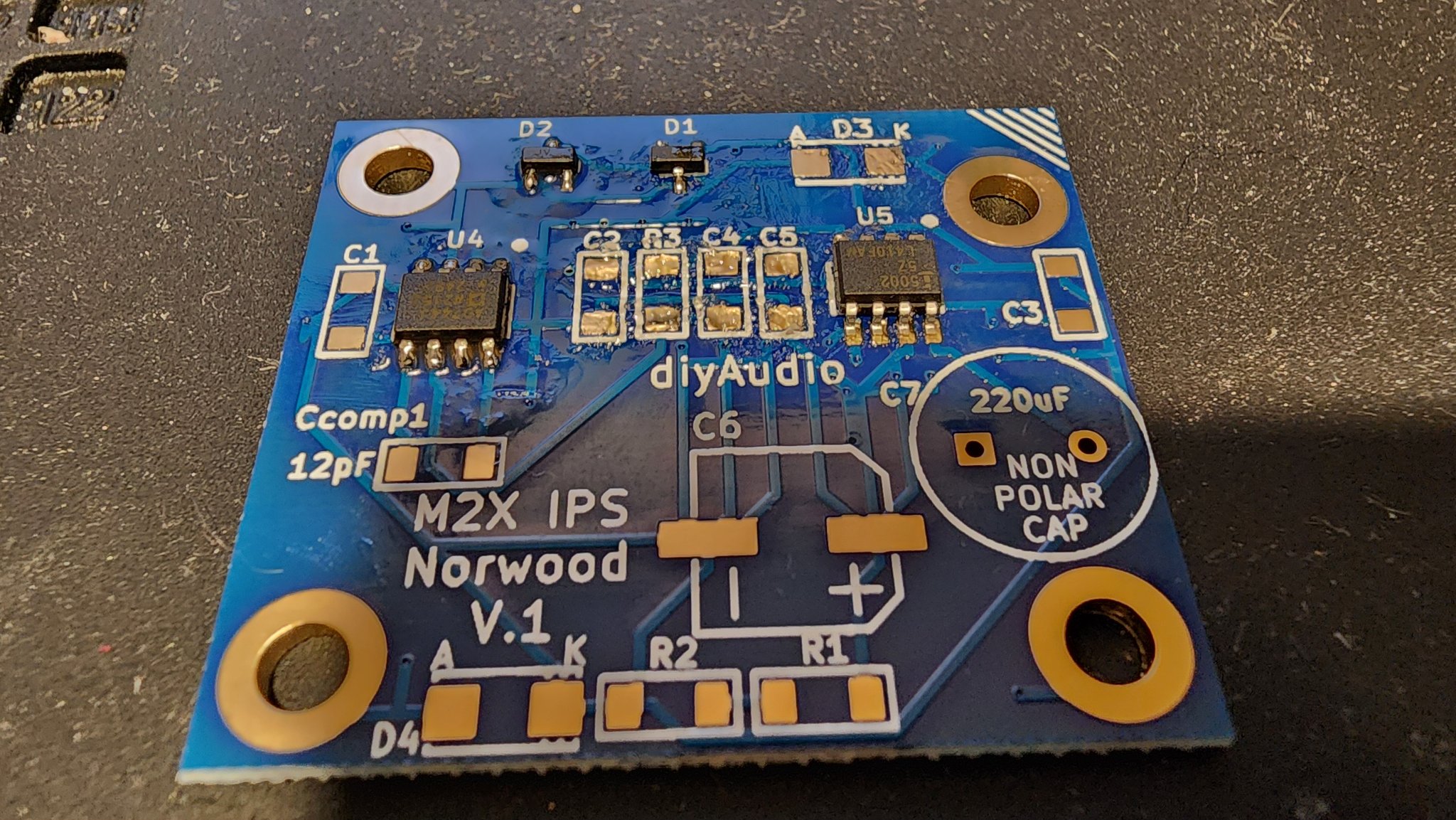

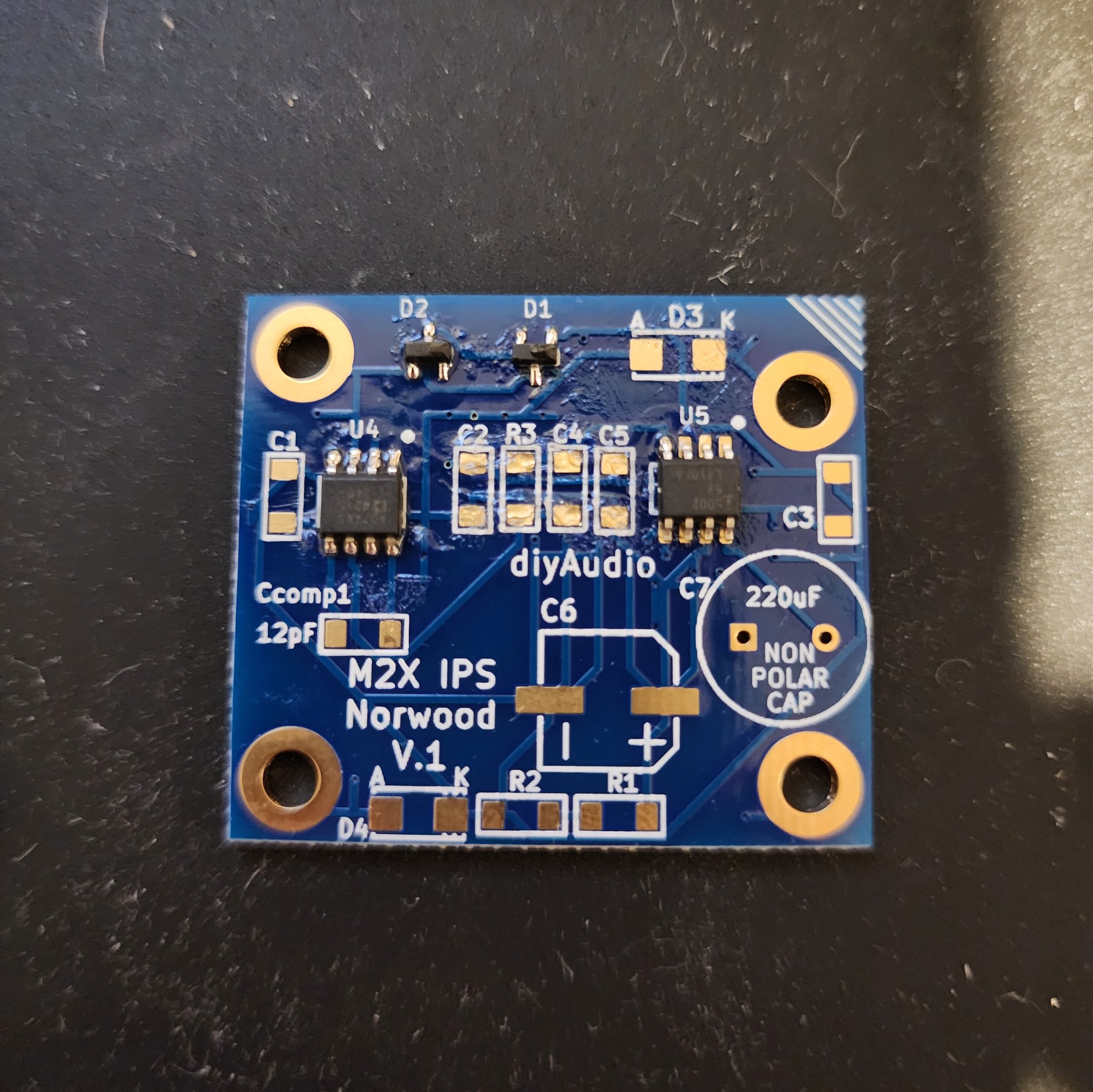

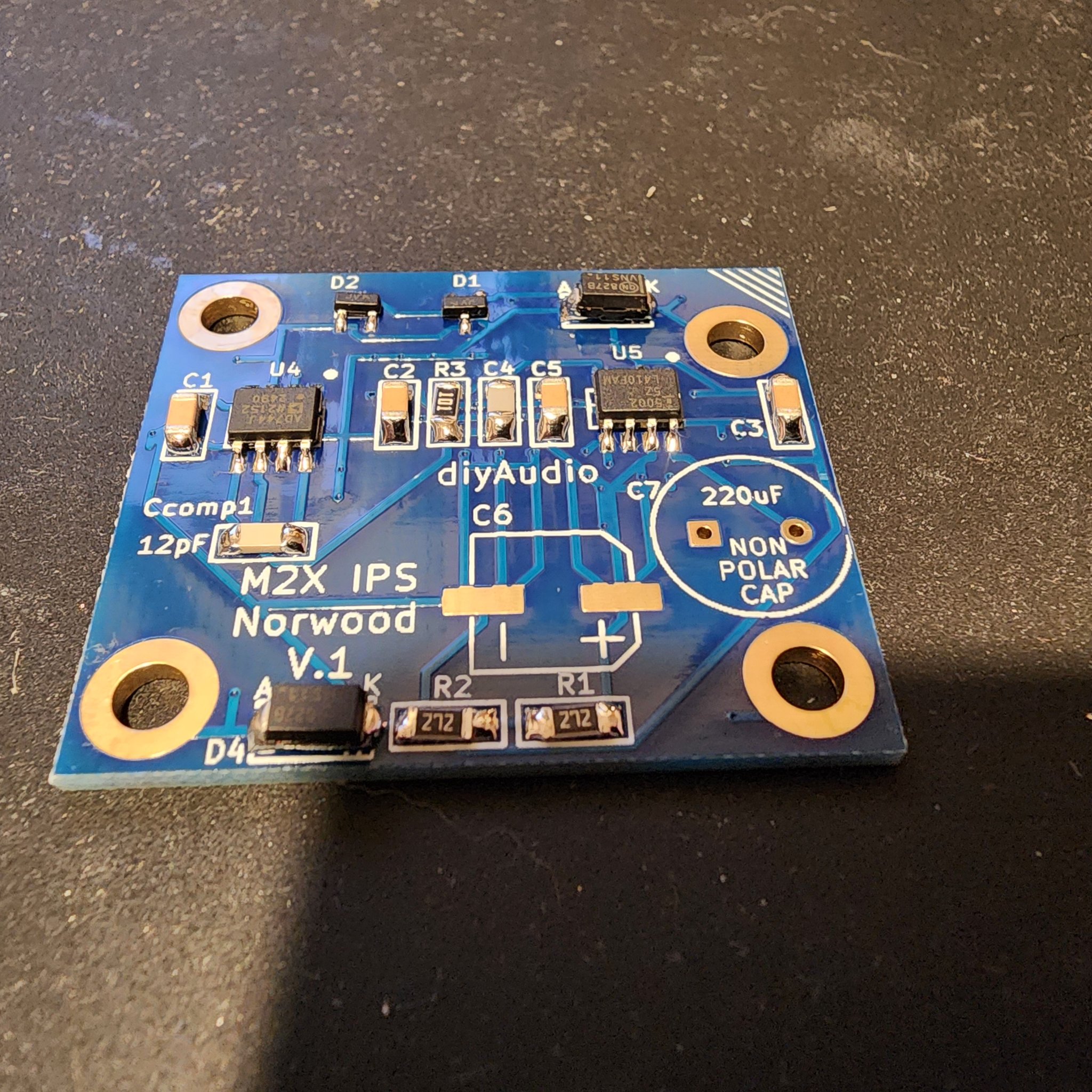

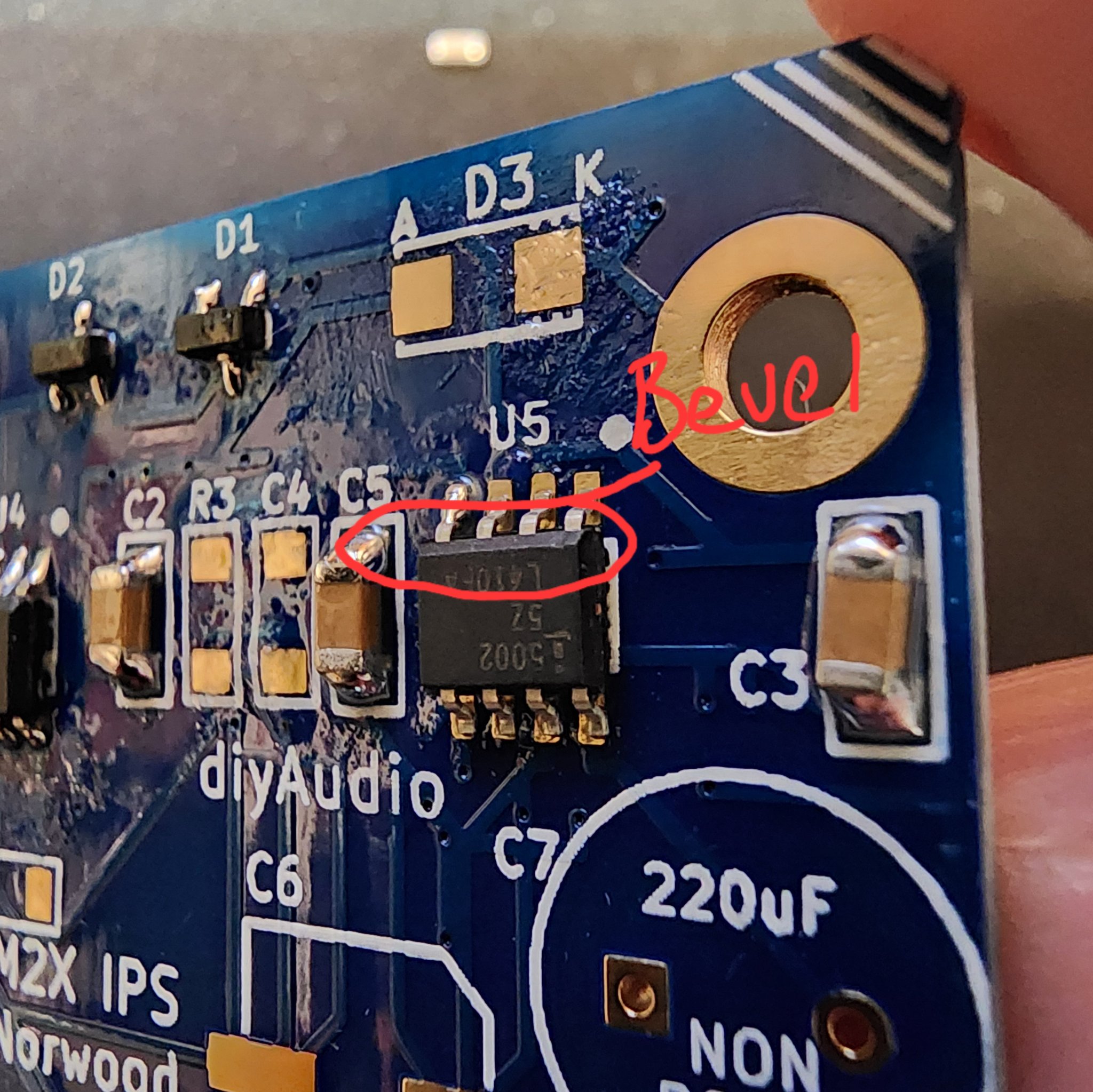

Built up some Norwood boards.

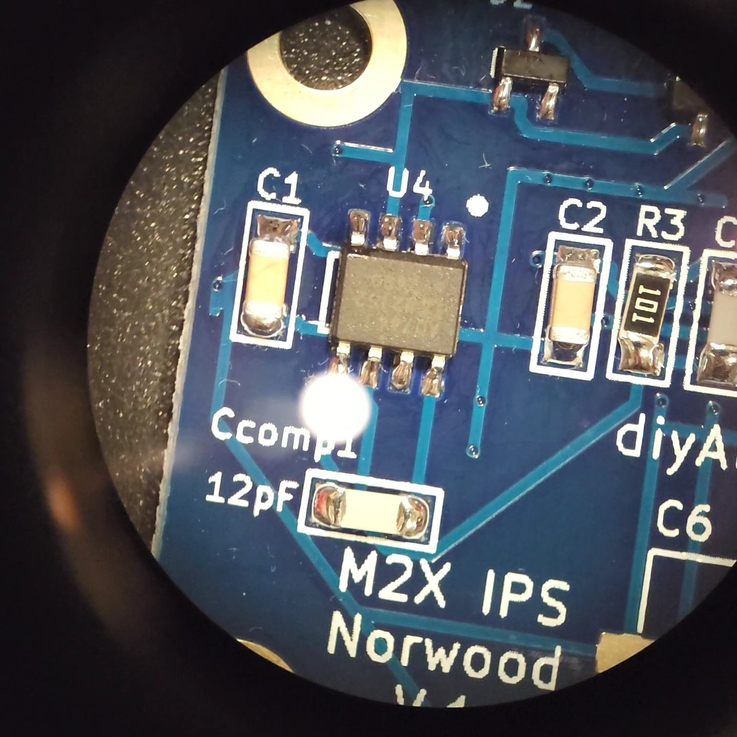

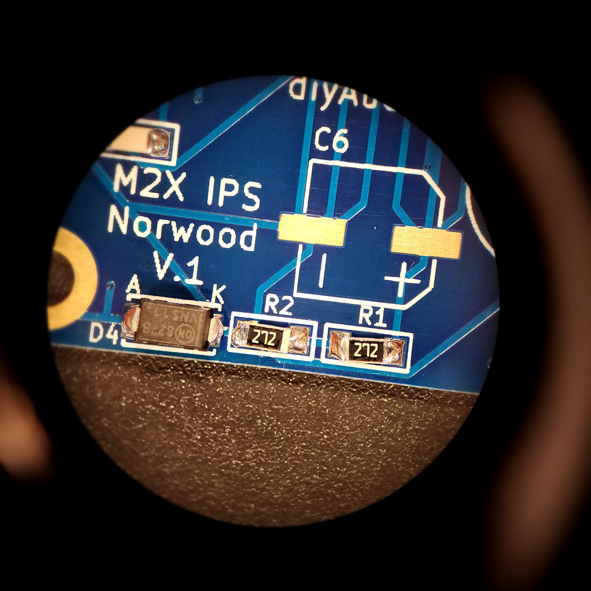

Sharing pics to help others. Note the flux on the pads prior to soldering. I used MG 8341 paste for reference. Also note that the IC 5002 bevel is on the "top" of the board when looking at the PCB board when the silkscreen is read upright. Both of the IC silscreens are upside-down relative to the PCB board silkscreen per Jim's "notes for builders 2018". That was a bit tricky for me to grasp and I gotta say thanks for @6L6 for helping confirm the correct orientation.
Cleaning the boards with 99% IsoP after all the SMD parts were installed was pretty simple. Be sure to do that before soldering in the two larger components.
The images below include zoomed in shots from a stereo microscope.
