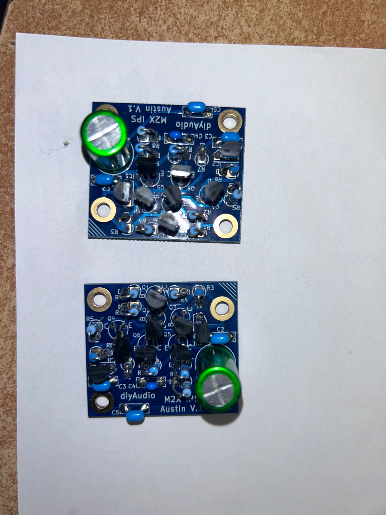

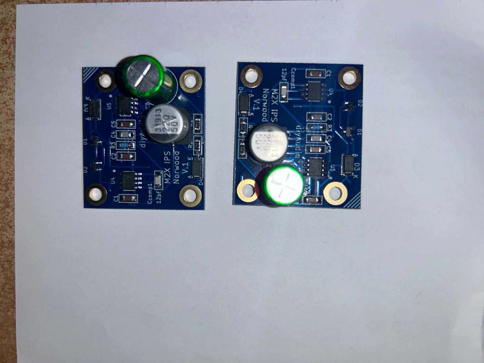

I have finished the last DB. Running on the laboratory power supply without problems.
Austin at 10mA ,Norwood at 16mA

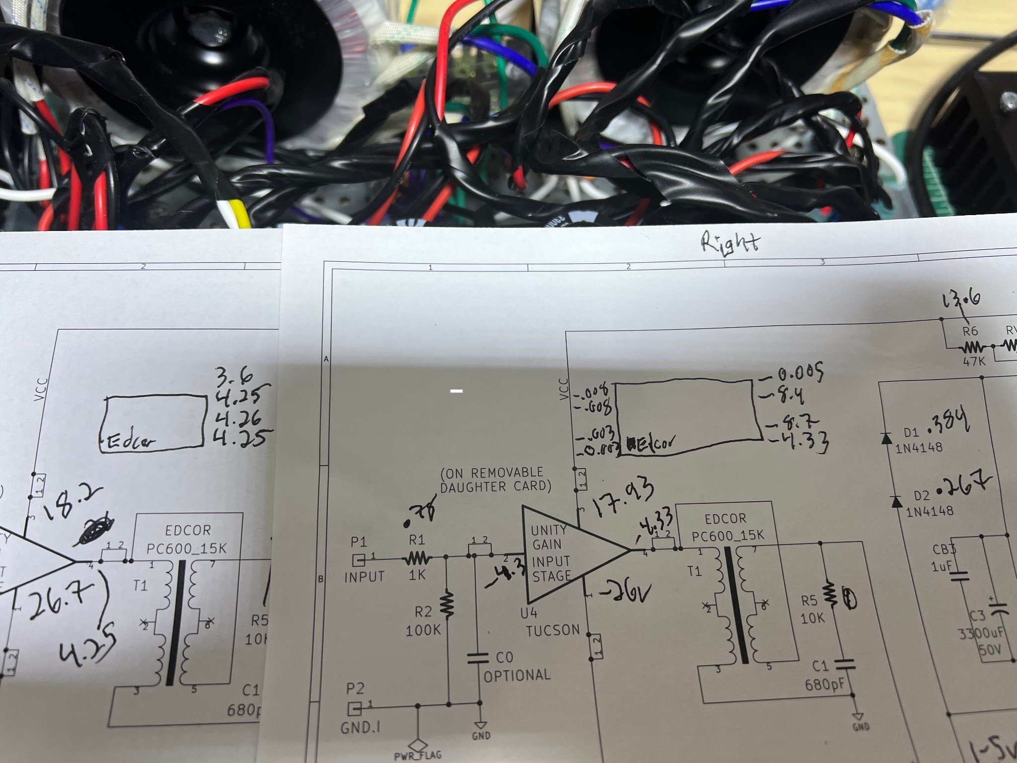

Ok I think I may be onto something.
I took voltage readings all over the freaking place. I had to take the channels / power supply out of the chassis to do it - I just could not get in there any other way.

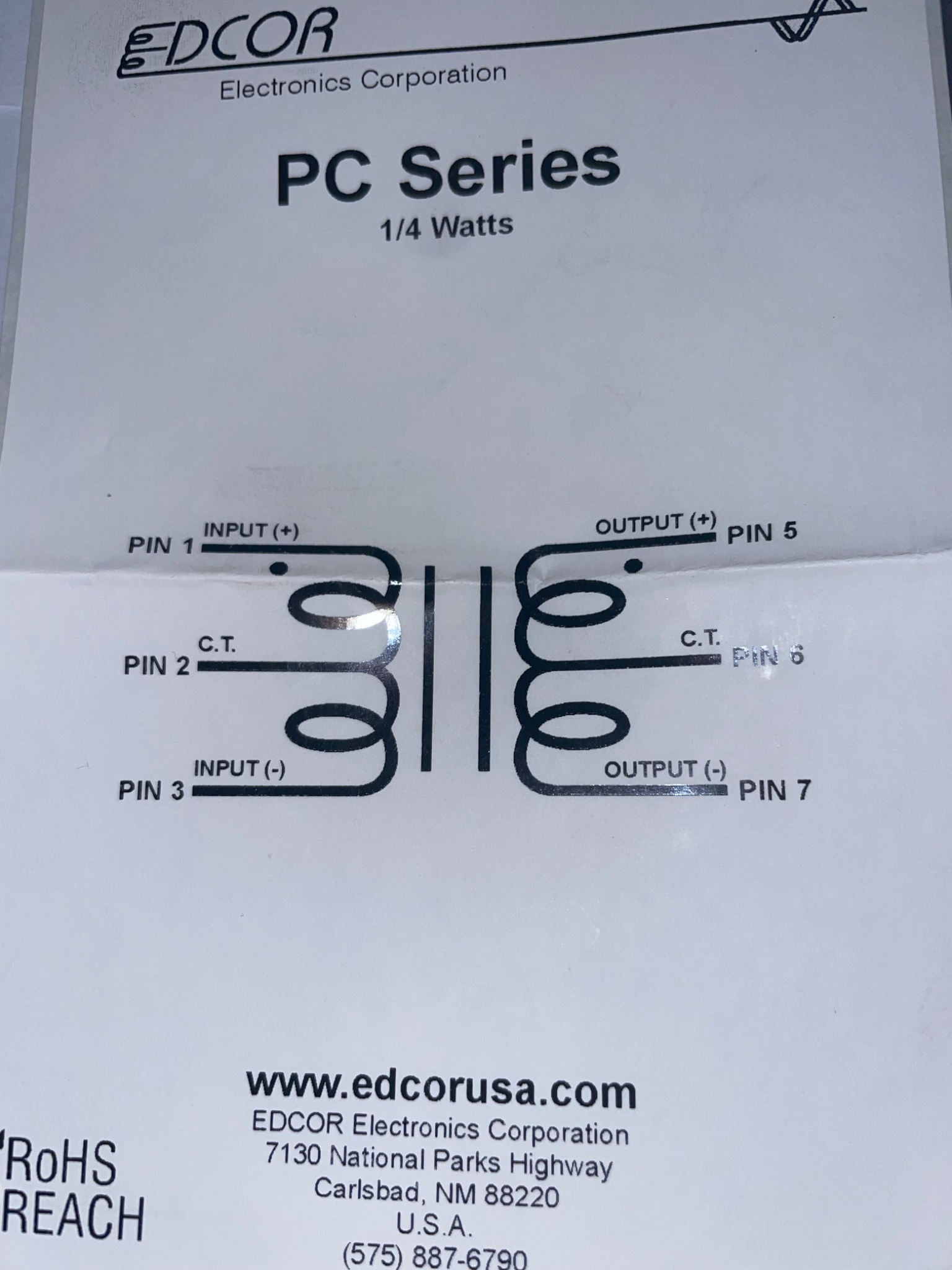

I don't know the pin mappings on the edcor. The left and right of the image below are working on the left and not working on the right. There is a big voltage difference on one of the pins between the edcors.
Thoughts? Is this looking like a bad (maybe damaged?) edcor? I'm going to take the bad board off of the heat sink tomorrow and look over the solder joints for the edcor.
I have voltage readings of each board on all resistors and the diodes. I can attach if anyone is curious but the big difference here is the edcor. I also managed to get my flir working so I have top views of the thermal - you need flir's software to get readings but it is pretty neat. I took the thermals with the edcor covers on - tomorrow I may fire it up and take again after an hour or something so the temps equalize - maybe that'll prove/show something?

When I say little sound its ... pretty significant in terms of the difference. The voltage readings on the left side really don't match on the right.
Left / right, bottom up
4.25 / 4.3 - that is close enough imo. Match
4.26 / 8.7 - wait what? Thats .. approx double from the first reading on the bad channel
4.25 / 8.4 - still approx double that seems wrong
3.6 / .005 - thats way off
Either something strange happened or maybe I just got a bad one? Could I have damaged it - yea absolutely. I understand whats going on in the edcor to make sense of that - why is it double ish on the right on those other pins and then suddenly 0 ish. That seems off.
Assuming that pin maps to pin 7 on the edcor diagram below that low voltage would absolutely explain why the sound is super low on that channel imo.
Anyone able to explain / reason whats going on here?
So i did not look to see whether it was detecting ac or dc. It was in auto.
Each reading was with the ground attached to ground and then on each respective pin walking down the line
