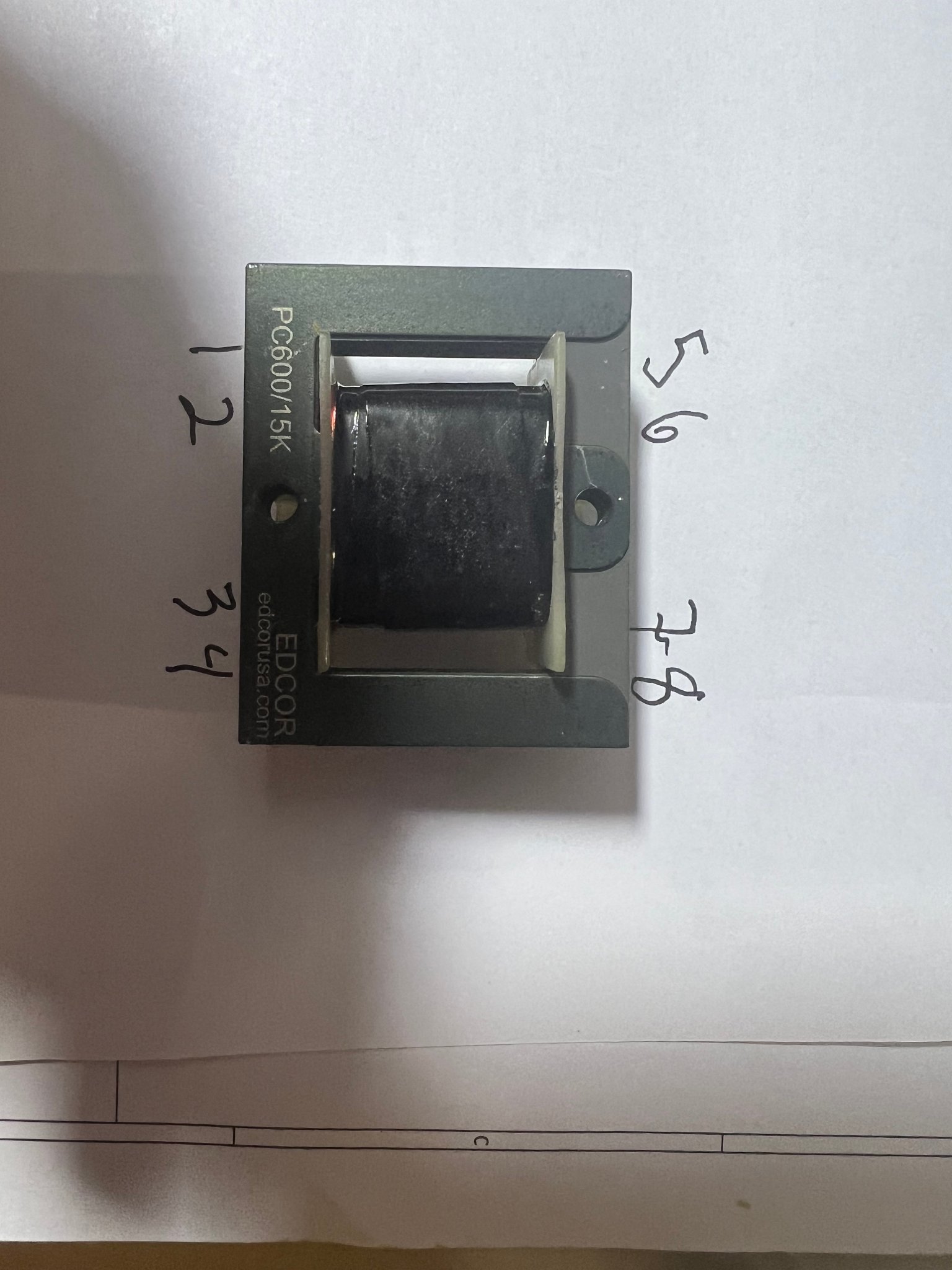

With the meter in beep (continuity) mode, are 5&7 connected?
So no beeps ;( I verified the multimeter was in the right setting - if I tap the ends I get loud noisy beep sound. Between these pins its dead silent. I checked the same pins on the one where sound seems to be working ( was at least! ) and it too is silent between those pins. Are both bad? I'm not sure what I should be seeing/hearing here
You have both transformers removed?
Are you sure you're measuring the correct pins? Having the same problem on both points to a measurement error more than an identical dual failure. (although it's not out of the question...)
Yea I am really confused on that point.
So at this point the working board still has the edcor attached.
Attached is an image of what I think are the pin mappings - maybe I have the wrong mapping? There is no pinout on the edcor itself so maybe I just have it wrong?

yea that I can see!
OK now that I see the proper pin mapping I had pin 5 across from pin 1 - its across from pin 4 so I was not giving logical readings sorry about that!
Ok with actual pin 5 and actual pin 7 I get no beep in continuity mode and 0L ( eg no connection/reading ) trying to measure the resistance.
With the "good" board I get continuity / beep and a reading of 234 ohm ( pins 5 to 7 again )
