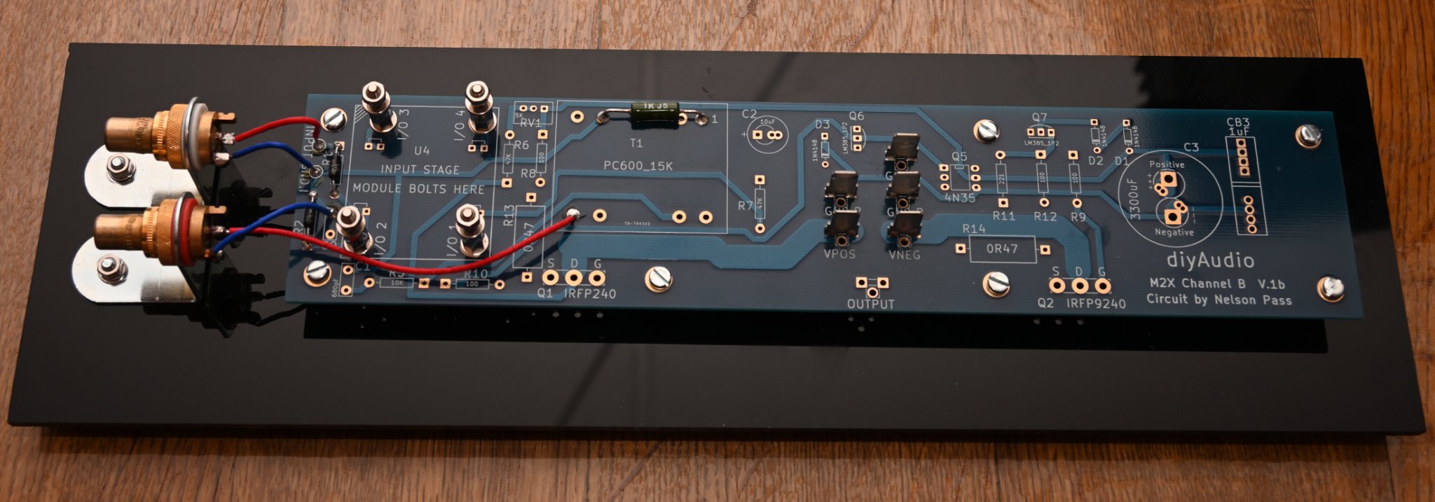

So that i can avoid frying input stage boards in the future how does one go about testing one without going direct to the amp board?
I have a bench supply and can set voltage and current but iirc you need positive negative and ground right?
Is there a way to use this kind of supply to test the board with limited current and hopefully avoid frying things?
I built myself an input-board test bench (requires an extra amp board). Only a couple of input resistors are required and a load resistor. The green power resistors sits there as load (1k) just so the input board output stage has a bit of load. The RCA in/out for easy interfacing. For power the usual connector are used.
Both my M2X boards are now out of the chassis (mono blocks) as I reuse chassis / PSU for my ZM F8 build 🙂
Such an input board test bench can be built "from scratch" using these "DIY solder boards".
Edit: for limited current use a lab-PSU that has current limiter.

How are you powering it though just using the power supply from the amp?
Do i just take the plus and minus and connect to vpos and vneg of the board? Where do i get ground?
I used a lab supply that has dual supply. Then it can be connected as a symmetrical supply by serial connecting the two supplies. It is like serial connecting two batteries. Then the "center-point" is defined as Gnd and you have V+ and V- relative to the Gnd-definition.
I just connected Gnd to Gnd-terminal and V+ to Vpos and V- to Vneg terminals indicated at the amp-board.

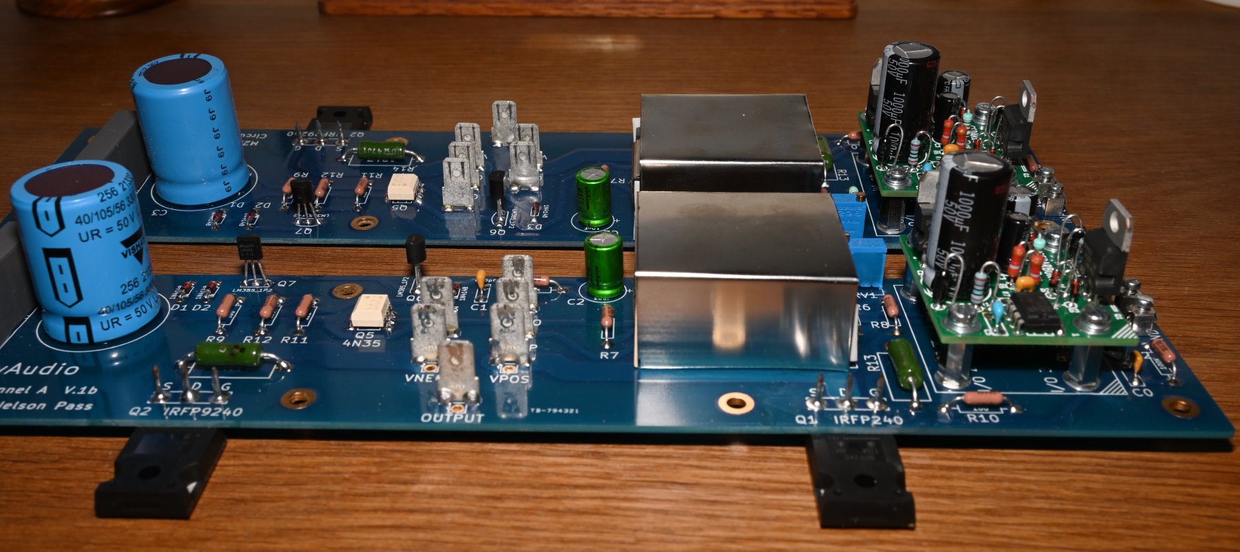

I test my input boards with this: https://www.etsy.com/listing/1033151079/m2xyarra-format-breakout-test-board?click_key=74bf430a07adceb02ff11fc965234e5738291f53:1033151079&click_sum=c9e5121f&ref=shop_home_active_16&pro=1
Plug it into my bench supply and then run the tests I want to run on my scope. I do this with EVERY new IPS board. It ensures that I don’t plug a lemon IPS board into my M2X.
It also helps with perfectly aligning the male D sub connectors on new IPS board builds, provided you build the test breakout board properly with female D sub connectors.
