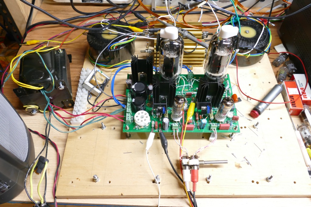

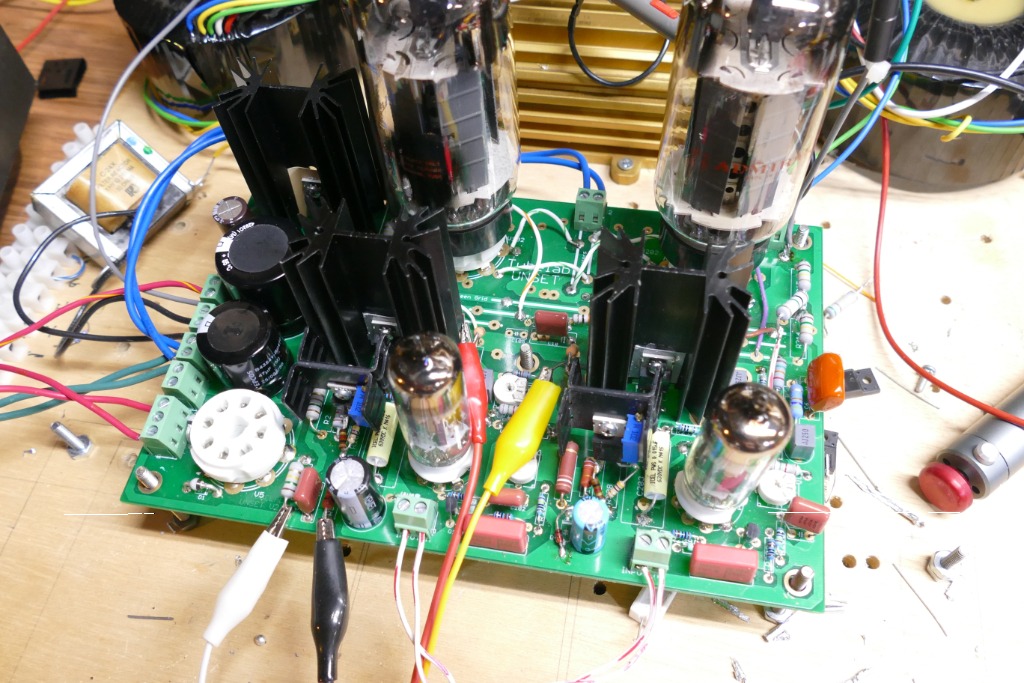

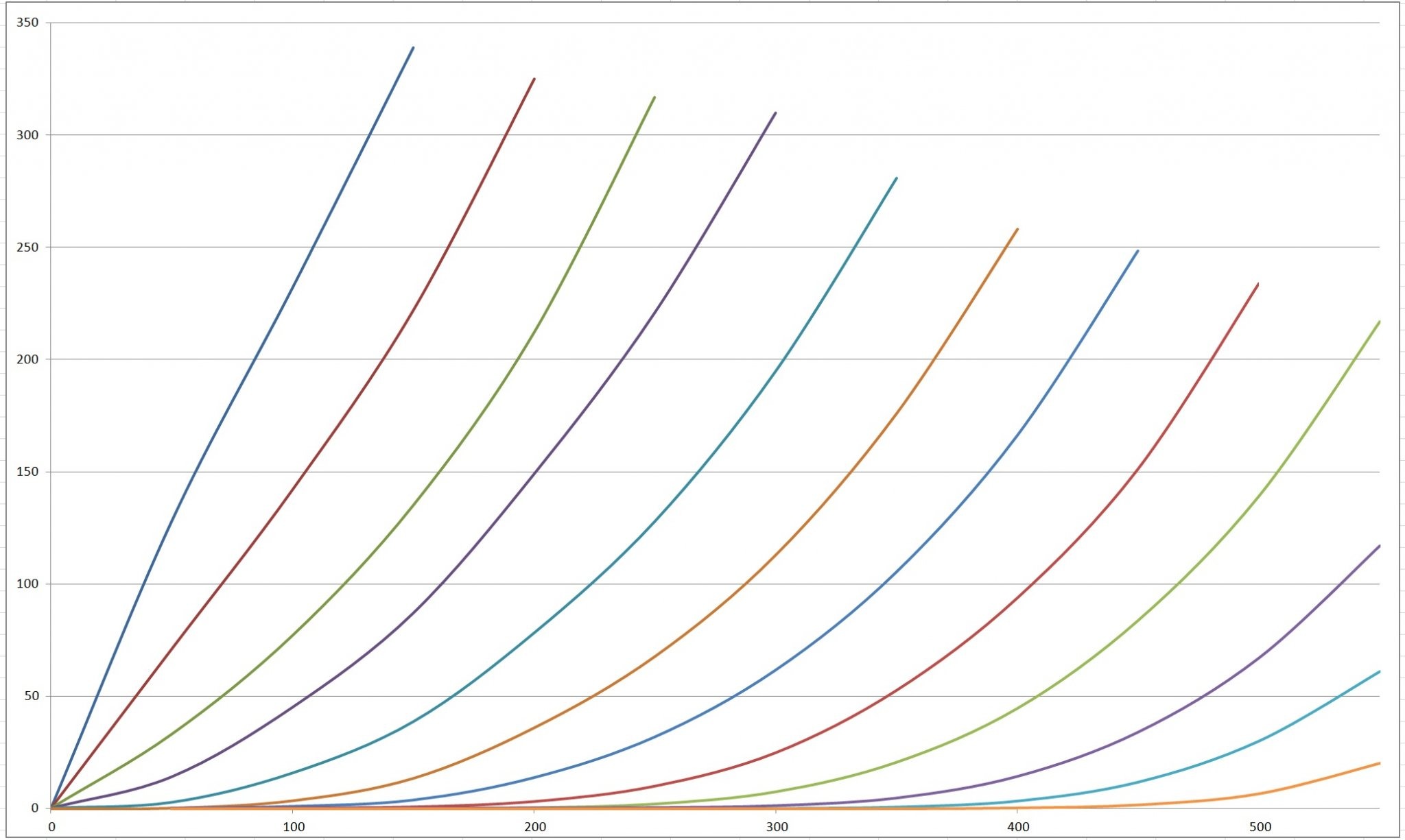

The circuit shown in posts #1 and #2 are very similar to an amp design I did called UNSET. SET is a common abbreviation in the vacuum tube audio world for Single Ended Triode. UN because there are no triodes in the design but the composite tube / mosfet curves are very triode like. The first picture shows a set of curves hand traced from a tube / mosfet pair. The UNSET is a two stage amp design with a voltage gain stage and a power amp stage. The major difference is just the size of the parts. The gain stage looks just like the circuit in post#1 except that the gain device is a small signal vacuum tube. Resistive loaded and CCS loaded (post #2 with a single IXTP10M45S) versions have been built. High power (20+ WPC) amps need the CCS to get enough overall voltage gain. The second stage uses a larger P fet on the heatsink and a fat TV sweep tube for the gain device. The load is the OPT. This board runs on 350 to 650 volts. The UNSET board is seen in the second and third pictures. The CCS chip is on the little heat sink.I can’t wait to see what you do with them! Your input has been invaluable, as always!

In post #87 I called the tubeless UNSET the FETSET. In post#88 I was asked:I can envision a complete UNSET amp design with no tubes. There are some serious SiC fets rated for 700 volts available today for about the same price as a big tube ($20). I doubt that I will ever build it due to the flak that it would draw. Nearly 20 years ago I used a mosfet source follower to drive the grid of a 300B triode in an amp I called the TSE. When I posted it here and elsewhere on the web the response was overwhelmingly negative. Some even suggested changing my name to Transistorlab. Little by little people built them and liked them. Someone took one to BAF and the Transistorlab flak went away overnight. Today I still sell quite a few TSE-II boards. Sticking "sand" into a tube amp will always draw flak from the purists, much like stuffing an all electric drivetrain into a 1957 Chevy. Progress is slow to be adopted by some. An all silicon anti-tube amp with an OPT is much like the 57 Chevy that was debuted at this year's SEMA show.
This thing keeps circulating around in my brain and popping up every so often, so I keep thinking about it. I even dug out an old breadboard but decided that it was too much work to make it into what I want. Now that there are some ready made boards it should be easy to build a FETSET. It would be possible, and probably easier to eliminate the OPT, but I have some decent Toroidy 600 ohm OPT's capable of 20 to 30 watts that I got for a cathode follower output stage, some 650 volt SiC J-fets, and a heat sink big enough for two boards, so I'll have to put them all together. Real tube amps have OPT's, right? I'll know more once I have the boards in hand. The question is whether to build a stereo preamp and a stereo power amp, or a pair of two stage pre / power amp boards.Awesome ideas! Love the name FETSET!
One question: why do you need an OPT at all? Here in Pass Labs land, we routinely run 1-2 amps of bias current at lower voltages. Couldn’t that work?
