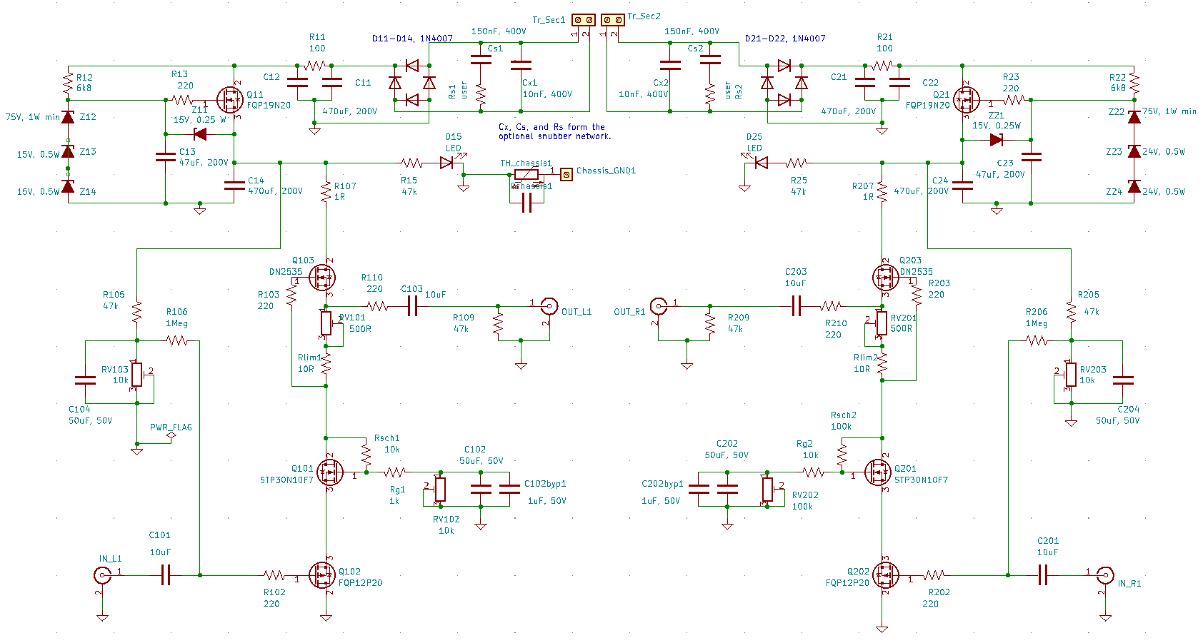

Isn't the latest schematic in post 487 https://www.diyaudio.com/community/threads/schade-common-gate-scg-preamp.380487/post-7137702 rather than as indicated in the opening post?
That is correct. I will revise the first post now. Thanks!Isn't the latest schematic in post 487 https://www.diyaudio.com/community/threads/schade-common-gate-scg-preamp.380487/post-7137702 rather than as indicated in the opening post?

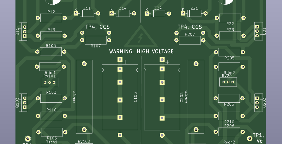

PCBs have been ordered. I will send PMs to everyone on the list by tomorrow.
Side note (regarding chassis): is there a universal spacer mounting? (like the side panels have of the pre-drilled amp chassis fins)?
Using the latest schematic I made a new parts list for the resistors and the capacitors.
Don't know why is is so stretched out. I had the columns at minimum width from where I coped this.
Time to get those parts on order.
R11* | 100R | |
R12* | 6K8 | |
R13* | 220R | |
R101? | 47K | no longer there |
R102* | 220R | |
R103* | 220R | |
R104? | 220R | no longer there |
R105* | 47K | |
R106* | 1M | |
R107* | 1R | |
R108? | 82K | no longer there |
R109* | 47K | |
R110* | 220R | |
Rg1* | 1K | should this be 10K |
Rlim1* | 10R | |
Rsch1* | 10K | should this be 100K |
RV101* | 500R | |
RV102* | 10K | revised value |
RV103* | 10k | |
C11 | 470uF, 200V | |
C12 | 470uF, 200V | |
C13 | 47uF, 200V | revised value |
C14 | 470uF, 200V | |
C101 | 10uF | |
C102 | 50uF, 50V | |
C102 bp | 1uF | |
C103 | 10uF | |
C104 | 50 uF 50V | |
So that is a standard, that can be used to request Gianluca to cut holes in the nascent pre-V-chassis. Is there an elaborate [precise] name to refer to or just this generically?I put PCB holes on the baseplate mounting hole pattern. Hopefully that will help.
It is a 10mm x 10mm hole pattern on the baseplate. The new PCB will fit that. I'll pm Gianluca and get some more details. Would be good if the chassis can fit the current PCB.
Latest Schematic:
I will add notes and the parts list tomorrow.

Haven’t sent our PMs yet. Figuring out the cost including shipping and Paypal. Hope to do it tonight.
JLPCB tells me PCBs are in production!
