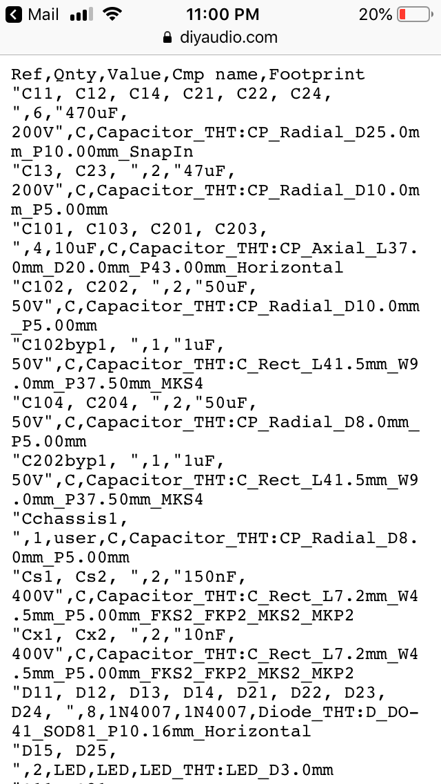

Attached is a schematic PDF and a text file (CSV format) showing the footprints used in KiCAD. The schematic has a few notes. Hopefully, this is enough to get you started. I am also preparing the parts list and a write-up on the schematic and power up, but that will take a bit of time.

Is it possible to also have the first file in PDF, attached file is what I see when I open it.
No clue what this means...
I don’t need it personally since I always select my components once I have my PCB.
