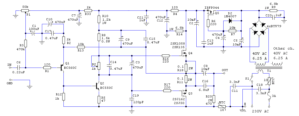

Are all the resistors rated 1/4 W unless otherwise noted ?

There is space on the board for 1W fir all resistors. The 100 ohm in the PS must be 1W. All others can be 1/4 W. But let me confirm.
Big resistors sound better. If 1 watt are available that is what I am ordering.
In a fit of obsession I have decided to use a 50 uF PP for C102. Will use a 0.47 uF as a bypass or maybe one of ZM's 1uF yellow caps.
I know I have asked this before but things have changed since then - I am going to use this with a TDV style amp using THF51s - does one really need a 10uF output cap feeding another 10uF cap at the input of the amplifier? Would like to use the money for other things and figure one less cap would be a good thing.
I remember there was a good reason for the input cap on the line stage but is the input cap for the TDV amplifier redundant with the line stage having an output cap?

Seems like 50uf/50v Radial caps are tough to get from Digikey or Mouser with the footprint suggested. Any alternatives like 47uf or 56uf is fine for C102,202?
Thanks Vunce and I love those Polymer caps so will get the 56uf/63v 🙂post#578

That looks like a PP output stage and is different from the SCG topology, which is single-ended. The SCG also has an N- and P-channel device but the sound goes from the gate to source of the bottom device and then comes out the drain of the top one.
You can drop the input cap on the TDV amp without any consequence, assuming you are building the one in Post 26. Don’t drop the cap at the output of the SCG pre. But you can reduce the size. I have used 1 uF without problem in the past. Smaller values roll off the low end.I know I have asked this before but things have changed since then - I am going to use this with a TDV style amp using THF51s - does one really need a 10uF output cap feeding another 10uF cap at the input of the amplifier? Would like to use the money for other things and figure one less cap would be a good thing.

There is 47k on the output on the pre, which will be in parallel with the input of the next stage. If that is TDV, then you are driving 10k. The two in parallel gives about 8k. The output cap and 8k form a high pass filter. Using 1 uF, I get 20 Hz as yhe -3db point, which means roll off will begin before that. Doubling it to 2 uF gives 10 Hz. More than enough.
Thanks very much for that.

That’s great! The 10 uF is there to ensure the pre can drive anything without losing low end. But of course you can play with it 🙂
The input 10 uF can be lowered too. Even 1 uF will work fine there.

R11, R12, and Rsch1 are really the only ones with somewhat moderate dissipation.Are all the resistors rated 1/4 W unless otherwise noted ?
