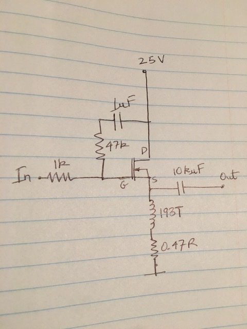

Check out this follower. I have been listening to it the past week. It sounds really good. Okay, it is not quite a VFET but it comes close.This thing keeps circulating around in my brain and popping up every so often, so I keep thinking about it. I even dug out an old breadboard but decided that it was too much work to make it into what I want. Now that there are some ready made boards it should be easy to build a FETSET. It would be possible, and probably easier to eliminate the OPT, but I have some decent Toroidy 600 ohm OPT's capable of 20 to 30 watts that I got for a cathode follower output stage, some 650 volt SiC J-fets, and a heat sink big enough for two boards, so I'll have to put them all together. Real tube amps have OPT's, right? I'll know more once I have the boards in hand. The question is whether to build a stereo preamp and a stereo power amp, or a pair of two stage pre / power amp boards.

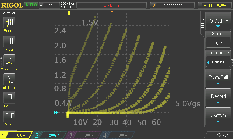

It is basically a Zen amplifier with a depletion mode MOSFET (IXTH6N50D2) and instead of taking the output from the drain, you take it from the source (no voltage gain). The depletion mode simplifies the biasing, which is provided by the load (choke) plus a bit of extra resistance (0.47R) to get it in the zone. The Schade network is there but you could probably omit it and get good sound. I measured (and listened) with the Schade network and it has got a very nice second harmonic dominant profile, and it sounds like that. Sweet with a nice front to back spread, great instrument separation. Distortion is kind of high, about 0.5% at 1W, climbing to over 1% at 4W, but it stays second harmonic dominant. This is at 1.4 amps of bias. The preamp must be able to drive the 1k input. SCG does just fine with that.
Obviously, this does not use the trick of a second device, like in the SCG preamp, but it is a fine example to listen to and I'm learning a lot. With higher bias, you could get lower numbers. See Nelson's original Zen article and the Zen Redux as an example of how distortion can be lowered with higher bias.
IXTH6N50D2 follower amp schematic:
Here's a pic of the I/V curves with the 1k-47k combo (IXTH6N50D2).

Isn't the 47 kOhm & 1 uF combo just making a low pass filter, considering it is referenced to the PSU?IXTH6N50D2 follower amp schematic:

You could do a son of zen style implementation but that would null the second harmonic and you don’t want that.
I thought it wouldn’t do anything either but it clearly does. I measured it. It lowers overall distortion slightly but more importantly, it makes the second harmonic the dominant one, even at higher power.Isn't the 47 kOhm & 1 uF combo just making a low pass filter, considering it is referenced to the PSU?

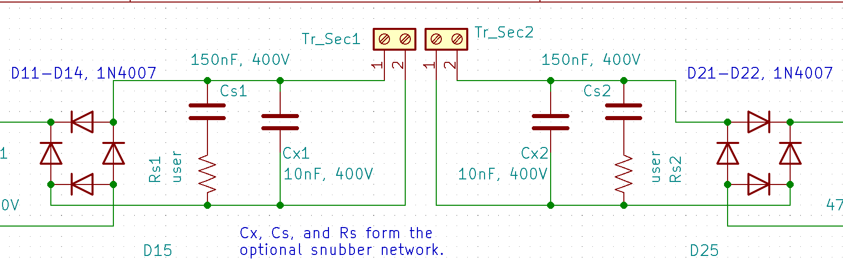

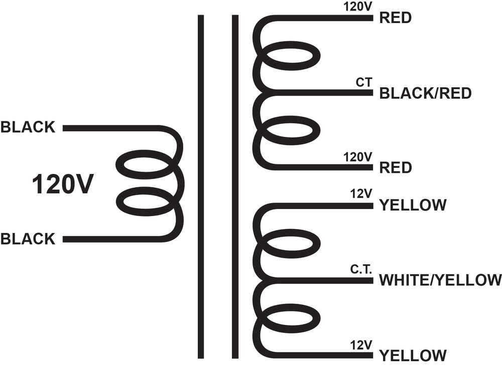

I would use just the CT and one 120V line and wire it in parallel for both channels. That will work. Preamp draws about 70 mA, so you want at least 25VA.
Thanks @ra7 . So its 70mA for each channel or in total?
This is trafo I have and I was thinking of using 1/2 of secondary for each channel.
https://edcorusa.com/products/xpwr054-240v-100ma-ct-24v-2a-ct

No, 70 mA total for both channels.Thanks @ra7 . So its 70mA for each channel or in total?
I have not seen the CT being shared between two bridge rectifiers. Not sure it will work. Here's the PS schematic. Wiring the CT and one 120V secondary to both sides should work fine.
