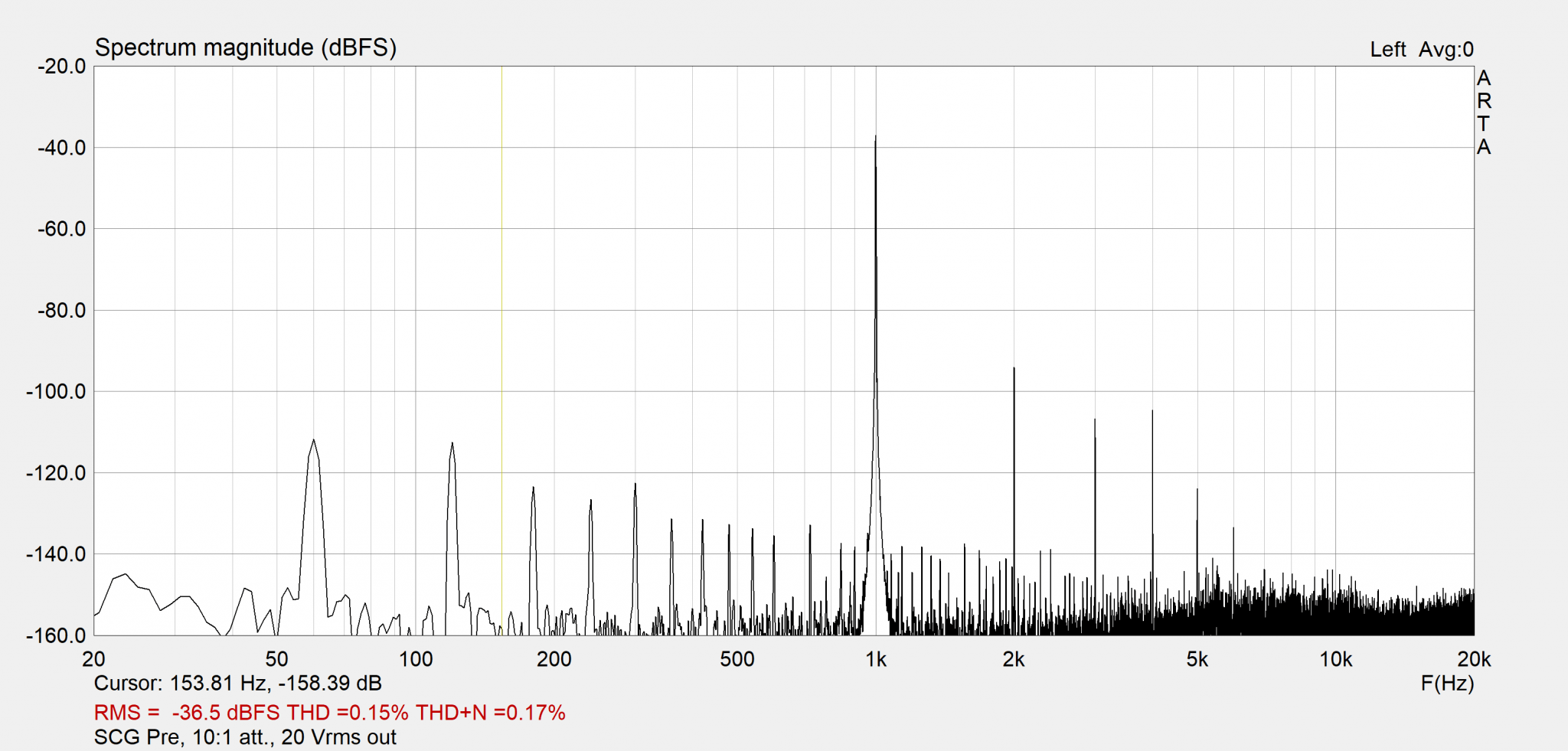

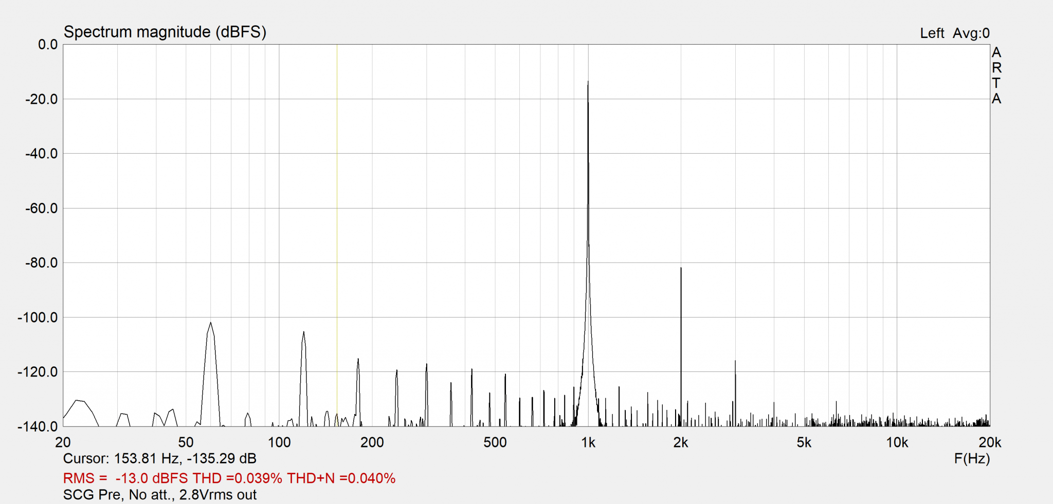

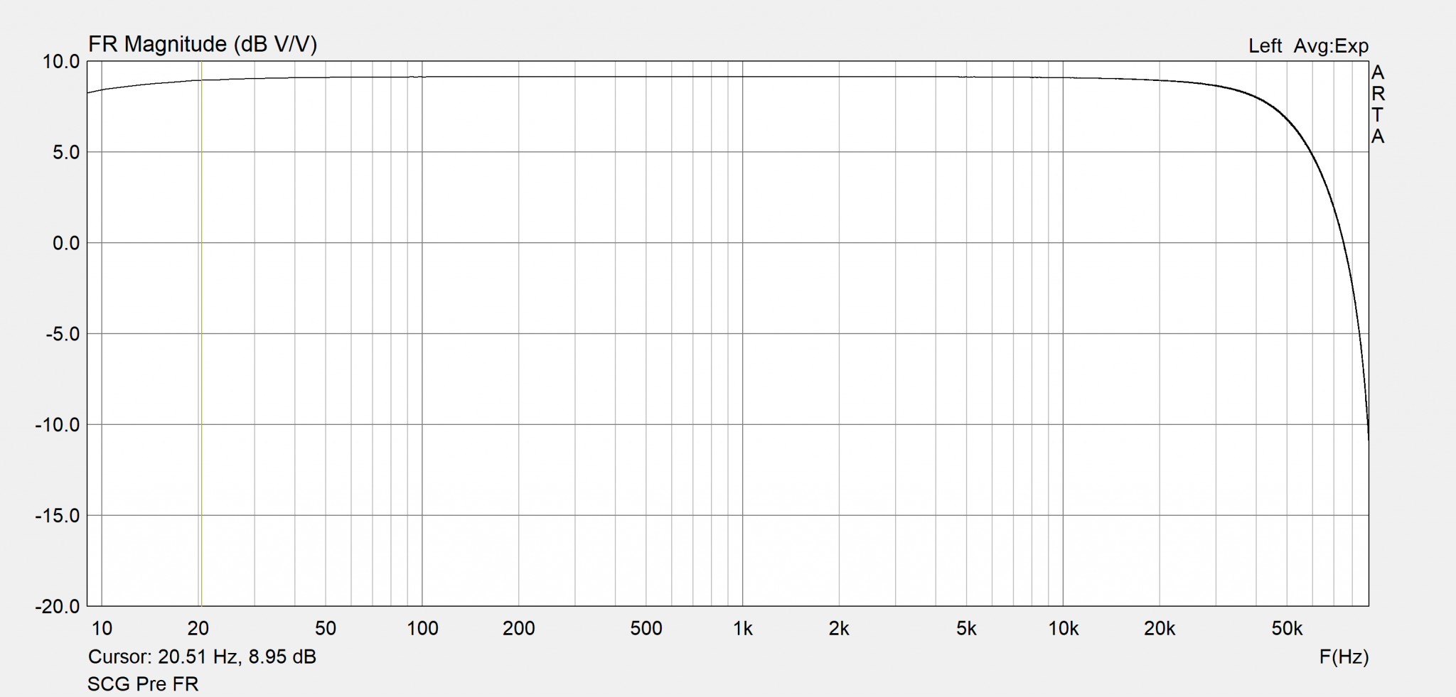

Latest set of measurements.
Frequency response. Nothing surprising. -3 db point is below 10 Hz and above 50 kHz.
2.83 Vrms out. No attenuation applied. This one uses a EI core trafo that does produce more noise in the chassis, but still all the PS noise is below 100 db.
20Vrms out, 10:1 attenuation. That is about 56 V peak-to-peak. This will drive an F4 to full power. Higher harmonics show up, but look at that second. It masks the others and the total isn't that much higher than at 10Vrms (not shown, 0.11%). In these pages, Ben (@Ben Mah) had hypothesized that the SCG's distortion may not be rising, as opposed to the 300B, whose distortion was rising with level and gave me the perception of being overly sweet. I think these charts confirm the hypothesis.

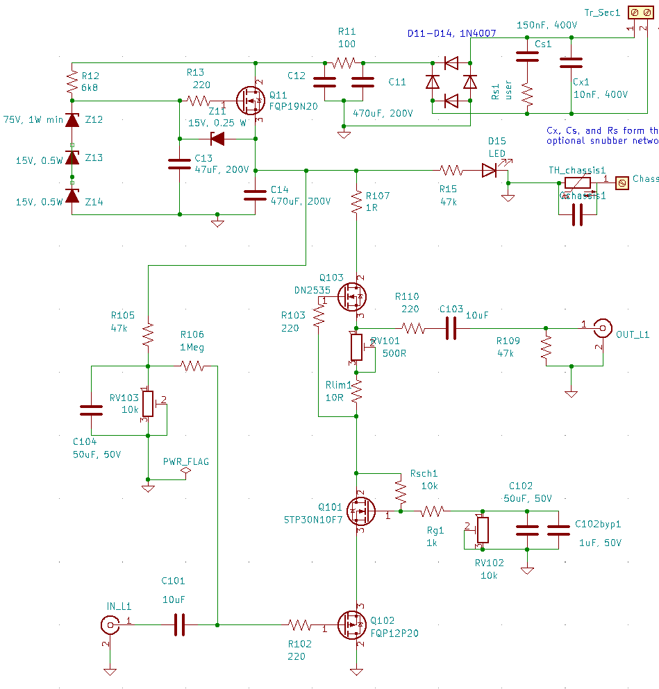

The zener string regulates the voltage to 123V, so voltage in excess of 123V is needed for the regulation to be effective. The amount of excess voltage needs to take into consideration voltage fluctuations from the wall. Excess voltage is dropped by the 6k8 resistor preceeding the zeners. The higher the excess voltage, the higher current flow through the resistor and subsequently through the zener string. The resistor is sized so that the current needed to drop the excess voltage when it is at its maximum does not cause the zeners to exceed their power dissipation rating (derated for low heat and long life).
The minimum voltage feeding the resistor and zeners needs to be higher than 123V when the wall voltage is at its lowest.
As for zener noise, my understanding is that lower voltage zeners are less noisy than higher voltage zeners. Having filtering (C or RC) after the regulation also reduces noise.

The minimum voltage above the zener string is the Vgs of the MOSFET. I would shoot for at least 7-10V above the zener string.
The schematic below shows the zener string total as 100V, which should be enough, but you can go higher than that. Lower than 100V is not recommended. I just used the parts I had on hand and ended at 112V.

Preamp circuit needs 100V minimum. Regulator needs 7-10V, say 10V. So, that's 110V. Plus a few for filtering (R11).
If you had a 100V secondary on the transformer, it would give you about 140 V out. At 35 mA total current draw (reg, circuit), R100 will drop 3.5V, say 4V. That would still put you well clear of the 110V target.
So, transformer secondary should be between 100-120V. The more the difference between the reg input and output, the bigger the heatsink on the reg FET. Currently, I have a little clip on sink.
A word on the regulator: This is a classic zener follower regulator, where the output of the FET on the source pin follows the input on the gate. And we fix the gate input with the zener string and kill the noise with C13. It is pretty much the same from the BOZ and BOSOZ preamps from Papa. In my testing with the SCG, it sounds as good as a shunt reg (I have one from K&K audio, based on Salas's shunt regs).

@ra7, any reason why you deliberately leave out the Rs1 value in the snubber circuit?Thanks Ben! That pretty much answers all of Rick's questions. There is filtering for zener noise. See C13.
In order to get an accurate Rs1 value, the transformer should be tested on the Quasimodo jig and oscilloscope.
https://www.diyaudio.com/community/...rmer-snubber-using-quasimodo-test-jig.243100/
I include the snubber components only if I Quasimodo’ed the trafo. Otherwise i omit them.

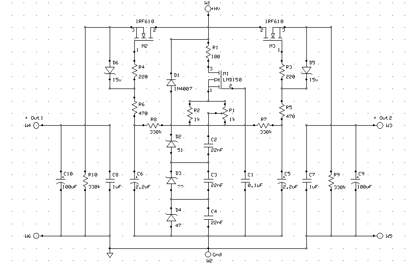

I know that for the zener string, to act as a regulator, the voltage would need to be more than the value of the zener string.
These are not exactly low voltage zeners. When I think low voltage I presume under 12 volts. I have no idea how the industry classifies them. Would the trick thing to do to use ten 12 volts zeners in series?
I have no idea how much of the zener noise gets past the mosfet so I have no idea how much the zener noise matters at all.
I was thinking of more of an over voltage protection versus regulation with the zeners to reduce their noise, if it is even a factor.

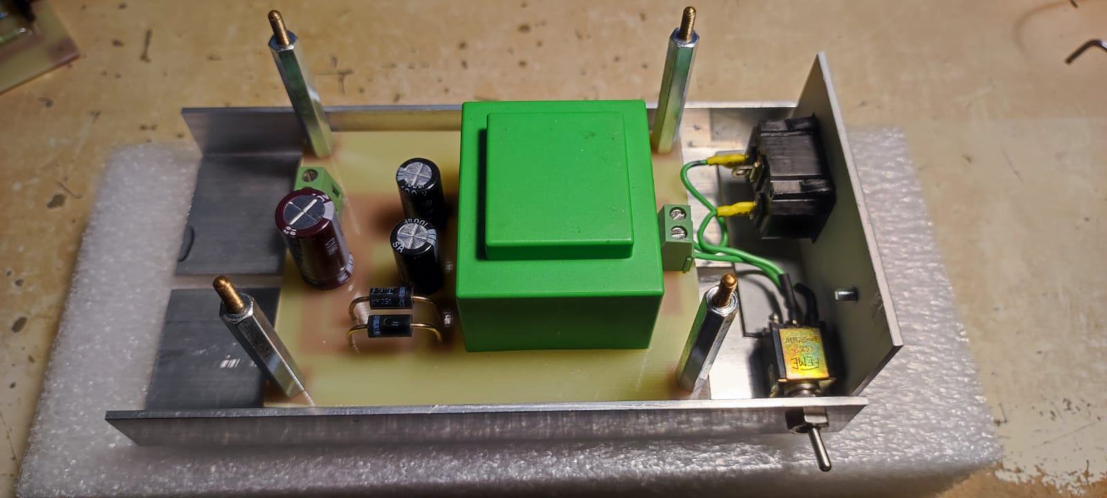

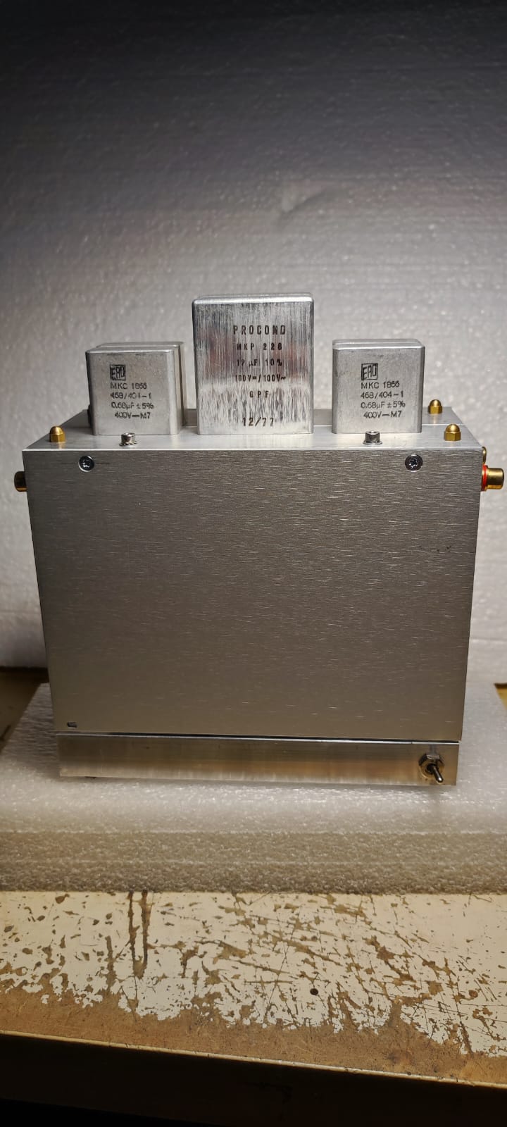

My take on SCG (thanks Rahul for this gem).

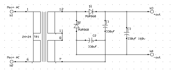

PSU: after a transformer 24+24 VAC (chosen because of its availability - and therefore cheap price...)
I've put a voltage doubler, for a VCC of 115V about. The raw VCC is then filtered and stabilized by a regulator - not so different from ra7's one: (schematic published on italian magazine - Costruire HiFi issues 48-49-50). An interesting feature is that it has double output, but voltage reference is shared. Pictures will follow...

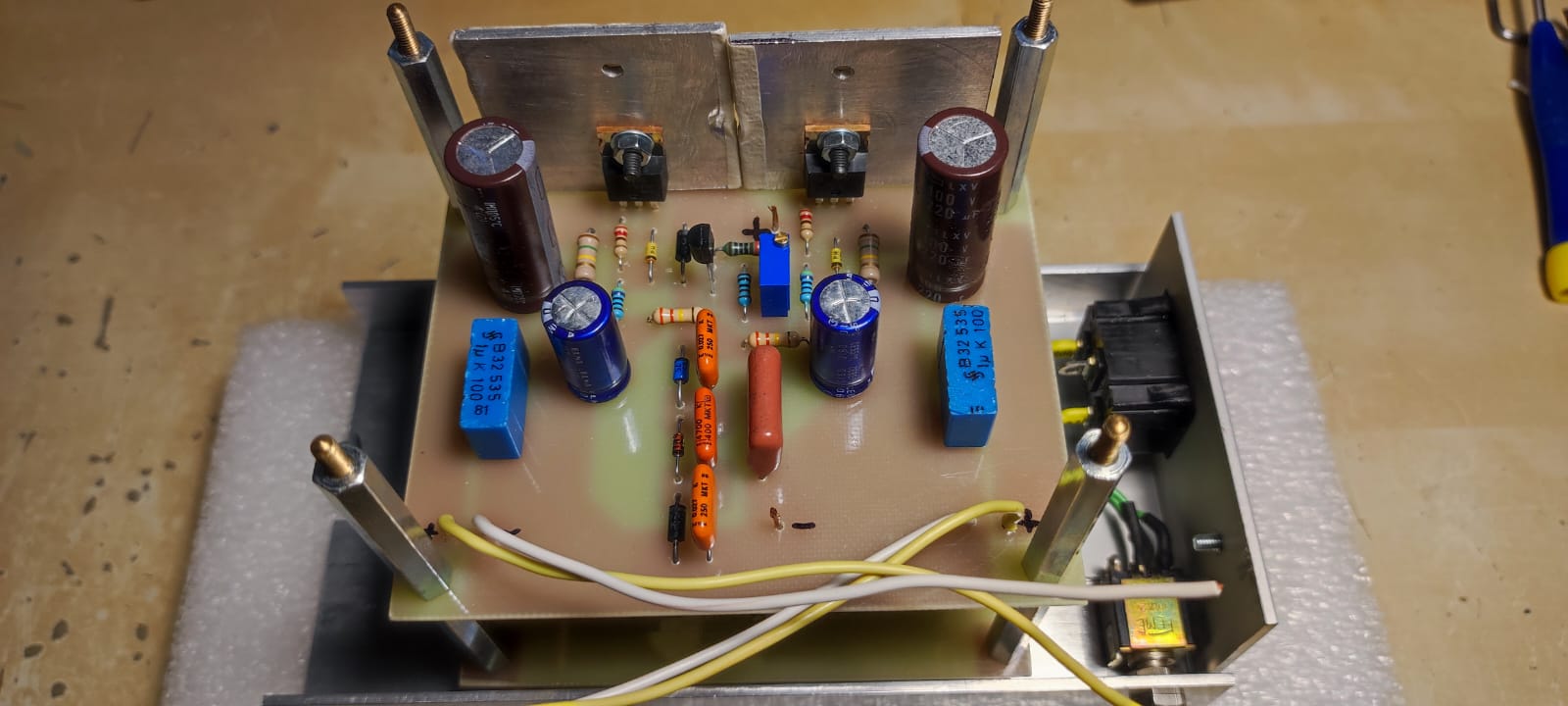

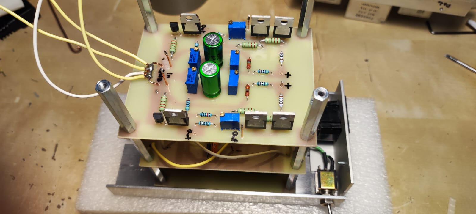

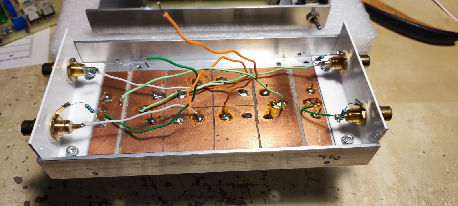

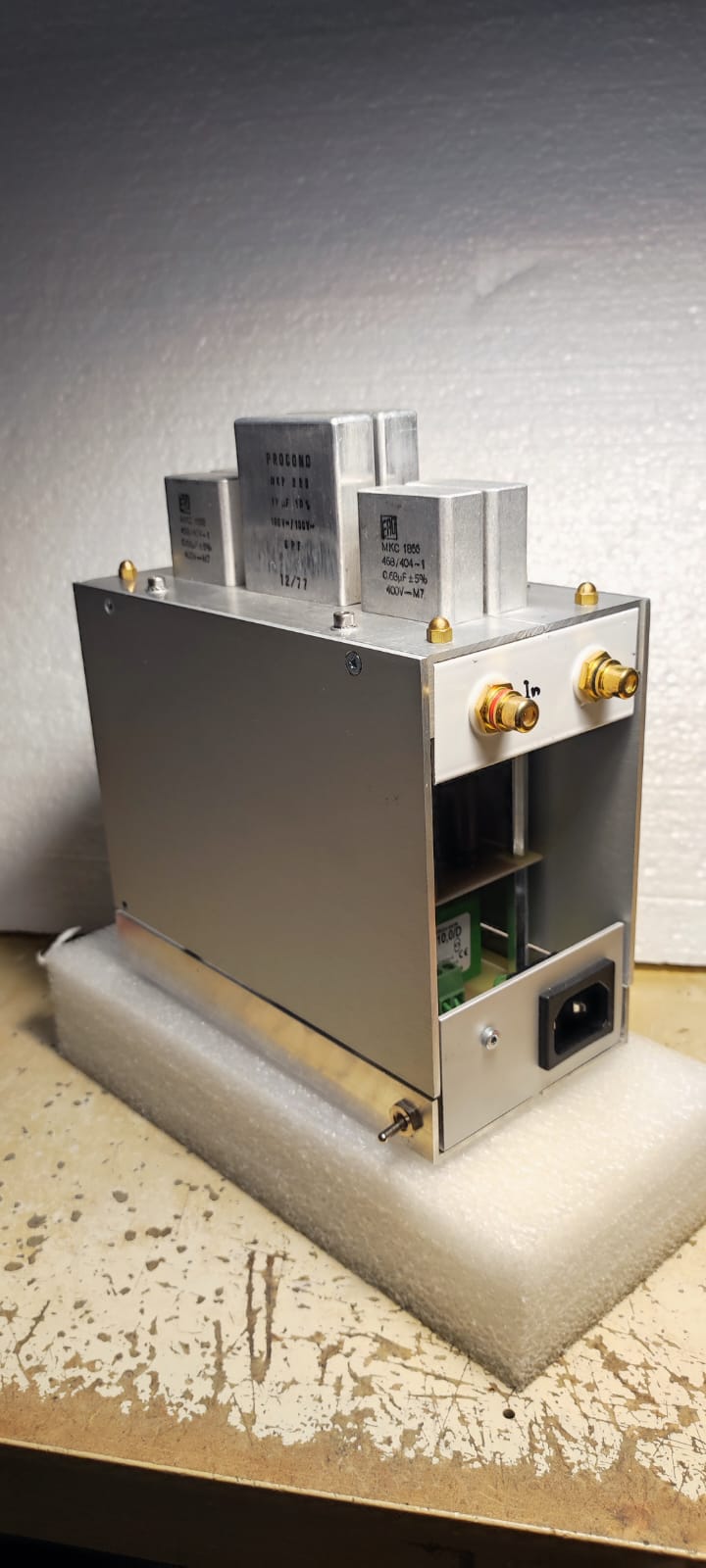

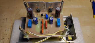

This is my multi-level car park 😉
Ground floor: Trafo and voltage doubler
First floor: V regulator (2 x 100VCC)
Second floor: SCG
Flat roof: input and output capacitors (parallel of 2 ERO MKC on input, Polypro 12uF on output).
All the aluminum parts has been cut by hand, the PCBs are handmade. Cabling in the purest rat nest style...
