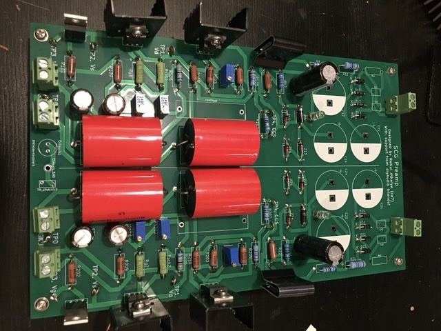

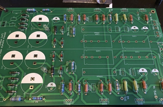

Progress. All resistors, diodes, and zeners are in.
And done, except the PS caps that arrive later this week. All told, about two hours of effort. Solder slingers like you guys will knock this out in an afternoon.
Five points for correctly guessing the identity of the red caps 🙂

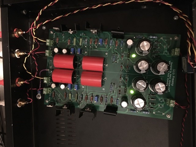

Got it working! Worked straight away. LEDs are working, voltages are good, the pots work. The boards are good. Would like to run some measurements over the weekend and make a couple of tweaks to the board. And then we'll be ready to get boards for everyone.
