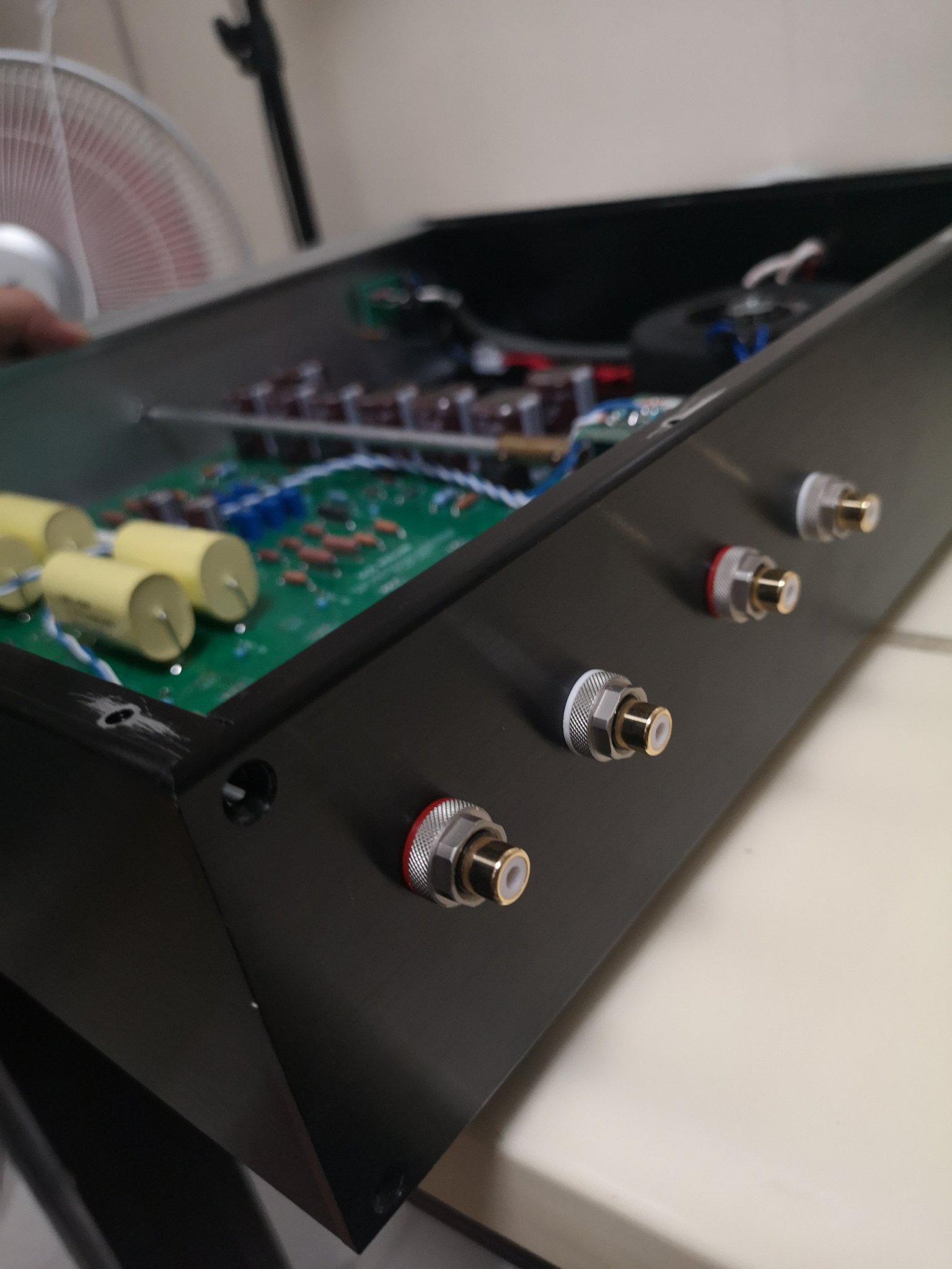

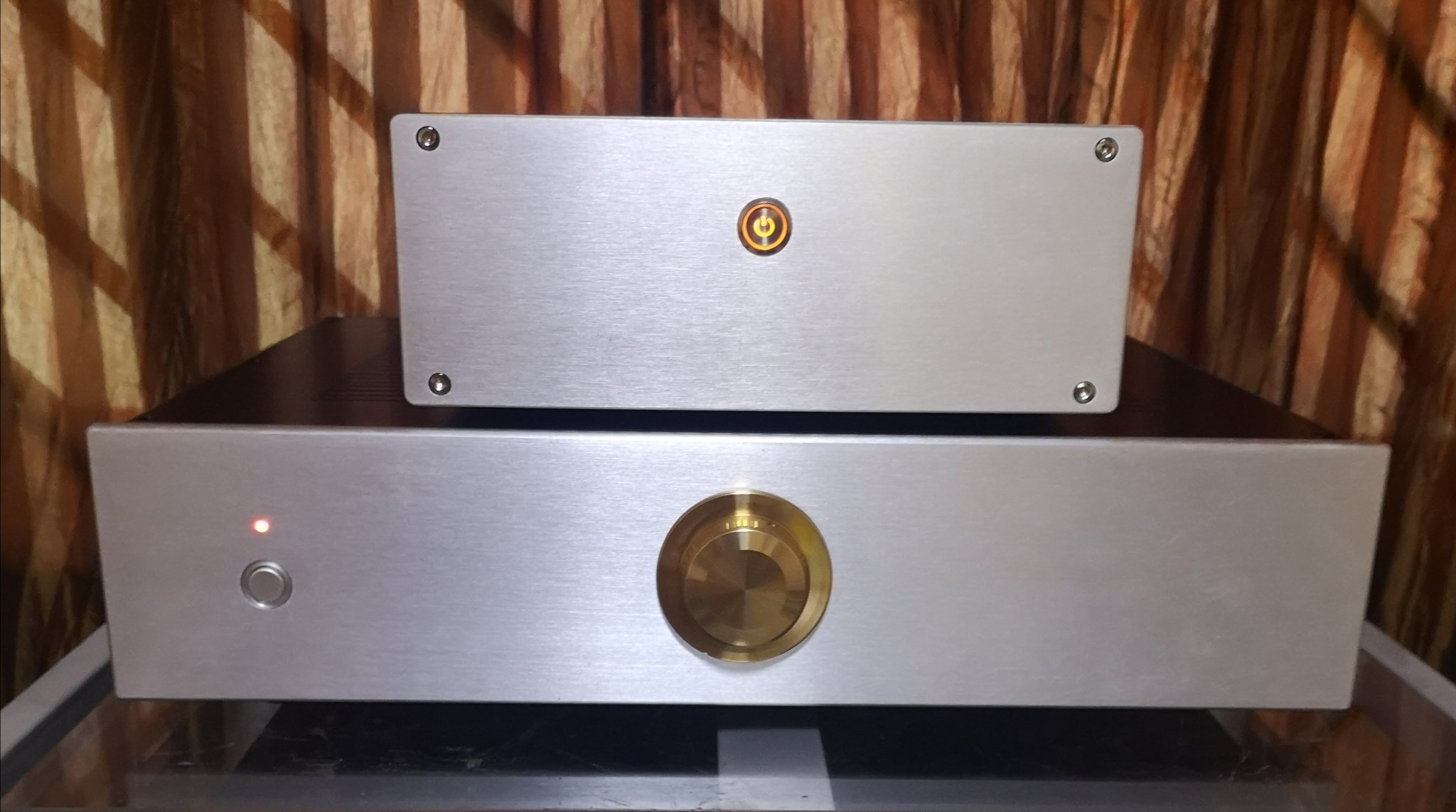

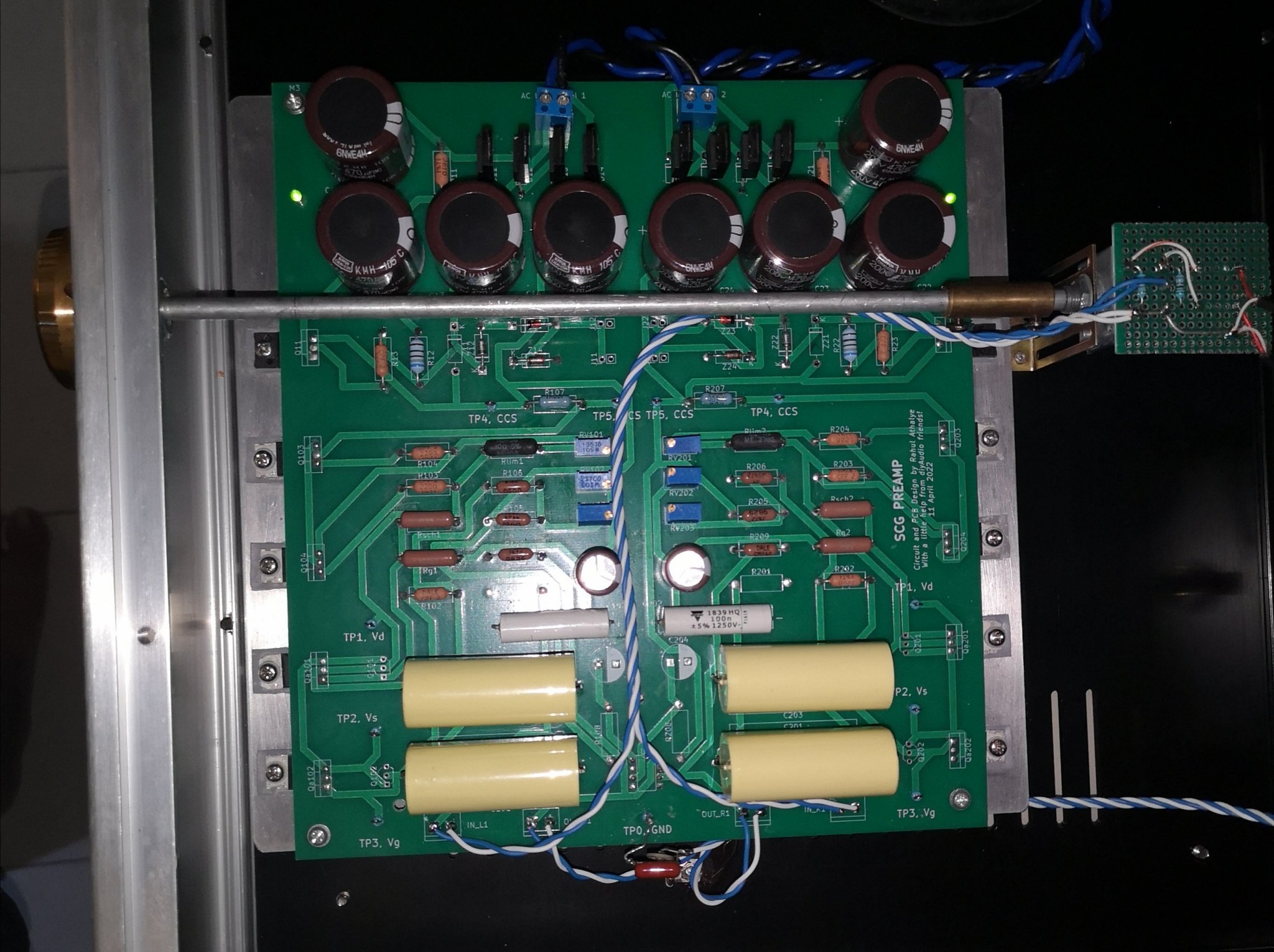

Glad to announce that my preamp has been completed. The smaller equipment on top is my Dorati Dac. They make a perfect marriage. i have to say it again, this preamp is sounding so good that i can listen to music for many hours.
That is beautiful! Love that golden knob and the look! Just amazing!
And so happy to hear the positive impressions! That really makes my day
Nicely done! That looks great 🙂

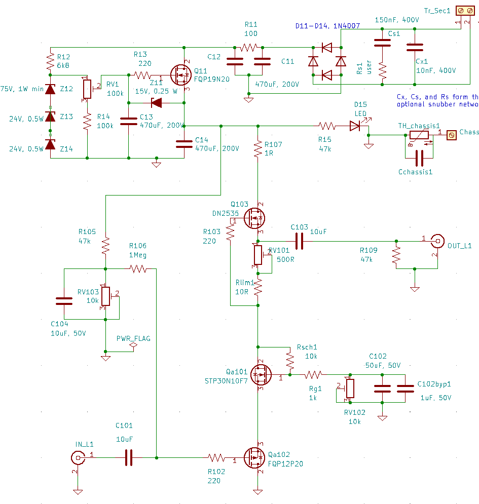

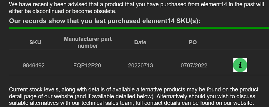

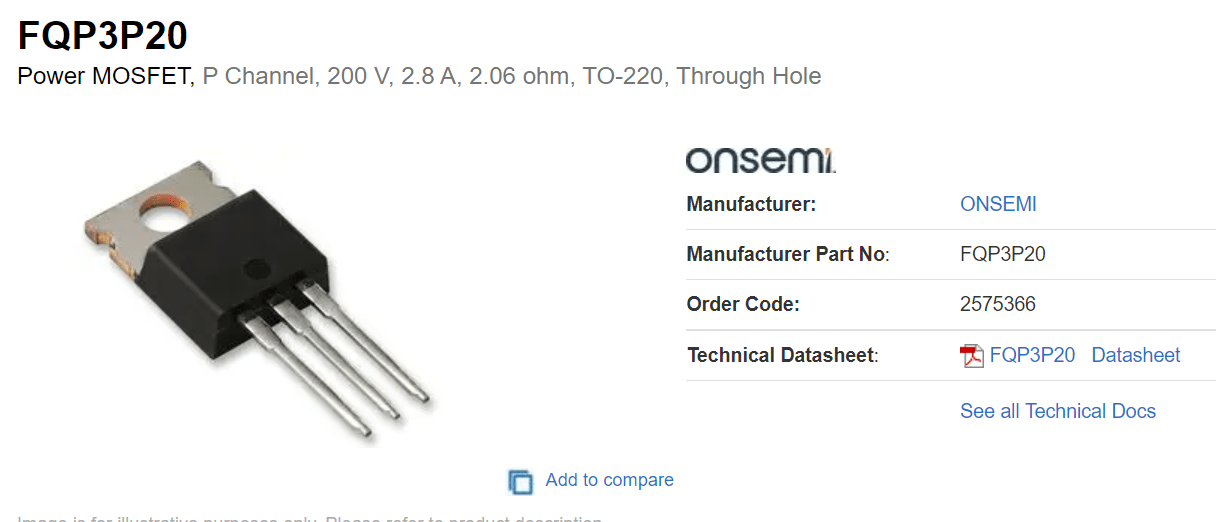

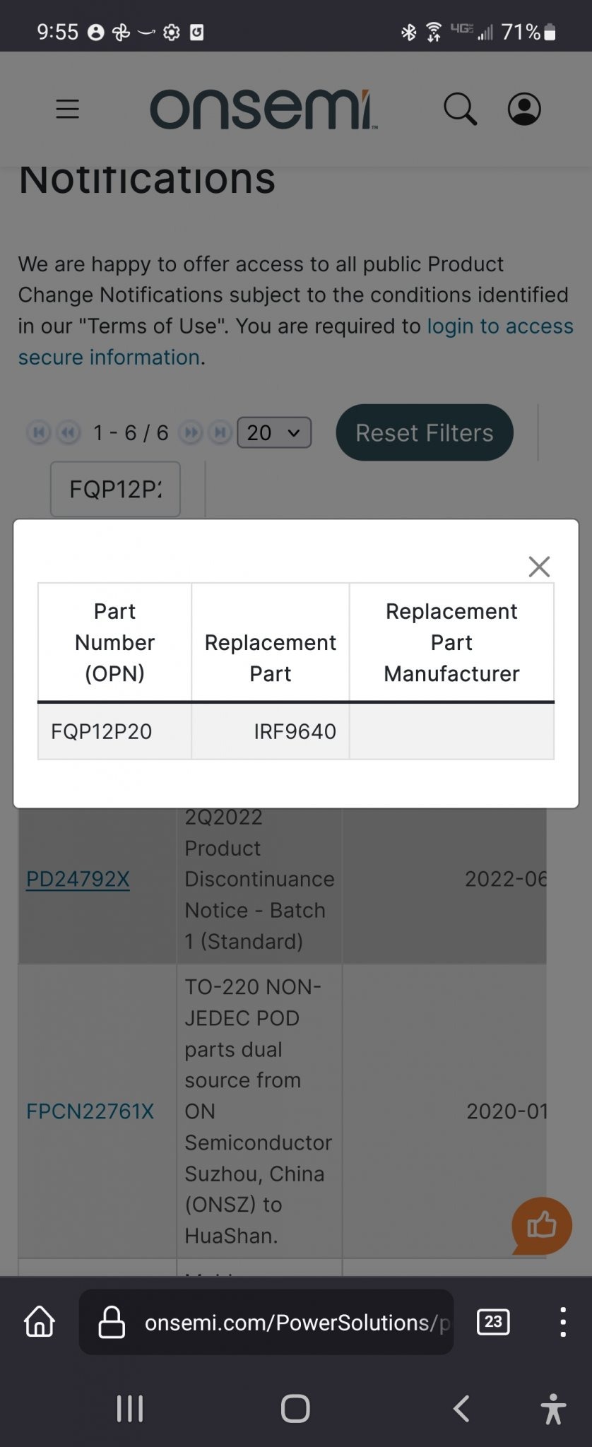

IRF9640 listed by On as replacement
Updated schematic. One channel shown. You could skip the trimmer in PS and connect the gate of the FET directly to the zener string.

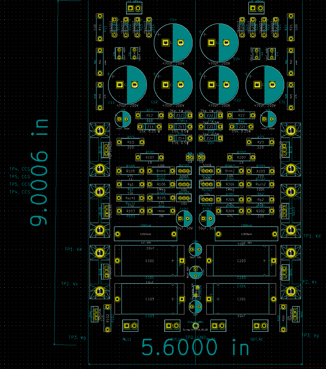

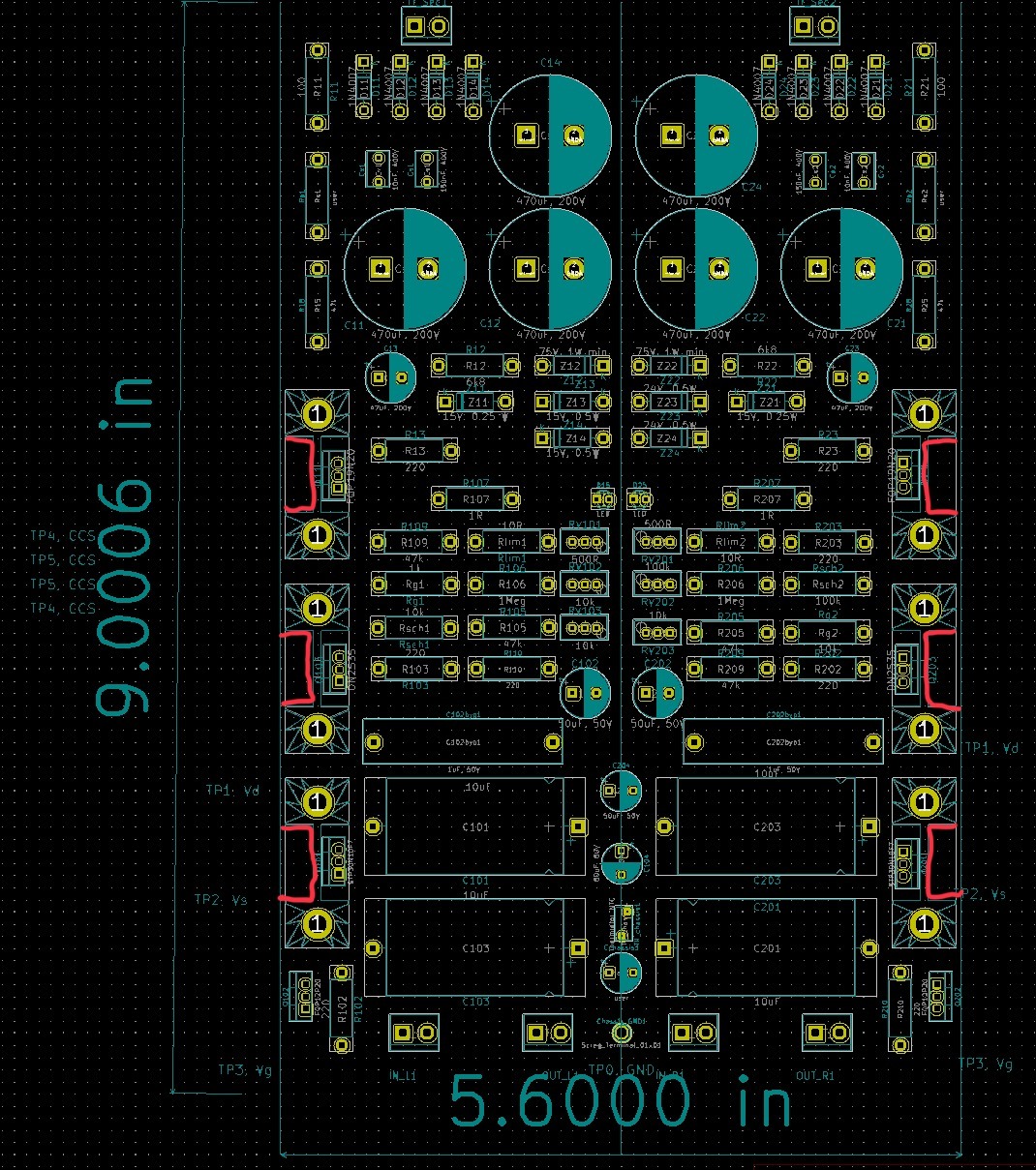

Here's what it is looking like. It is like a Led Zepp song--it comes out different every time. Though this one does bear resemblance to the previous one. The layout is tighter but it is still going to be a big board. Thoughts?
Could go tighter still with smaller 0.25W resistors, but I don't like boards that are very tight, or those that cannot be easily reworked. Still need to work on pad sizes and some other things on the list.
Looks pretty good so far Ra. I don’t think reducing the size of the resistors will save much space, the capacitors are the real estate hogs. But tweaking is a big part of the fun with SCG, decreasing the overall size of the board will also reduce component choices for builders. IMO, I’d rather have space for choices 🙂.
A suggestion, cut out the pcb behind the heatsinks to open up access to attach the mosfets to the baseplate. This will keep them mostly tucked under the pcb so they don’t add a lot of width to the overall footprint.
Good points. Now I'm wondering what would happen if I simply deleted the heatsink footprints. The non-finned ones work just fine with the amount of heat to be removed from each device. Getting rid of that heatsink footprint would save a lot of space.

By adding these small individual heatsinks it’s much easier to assemble vs having to attach the devices at the bottom of the enclosure w pads and everything. It kind of reminds me of the ACA mini which was very easy to assemble.

One can still use the little heatsinks even with the attachment posts not being there. This being DIY there is always a place for ingenuity. A small spacer underneath holds them steady as long as you are not going to ship them and even then it would not be hard to stabilize the assembly.. The cutaway would be an advantage. I am not worried about the cost but if it is surprisingly high then one could understand you not wanting to do that.
I would appreciate the larger board.
Looks like the resistors closest to the gates are much closer to the gates now - a good thing. I like those to be attached to the device just as we did with vacuum tubes at the socket. so now the end of the resistor not attached to the mosfet will not have too far to go to fit into its hole on the board. I know most of the folks who get the board will prefer to do it the way you have imagined it.
