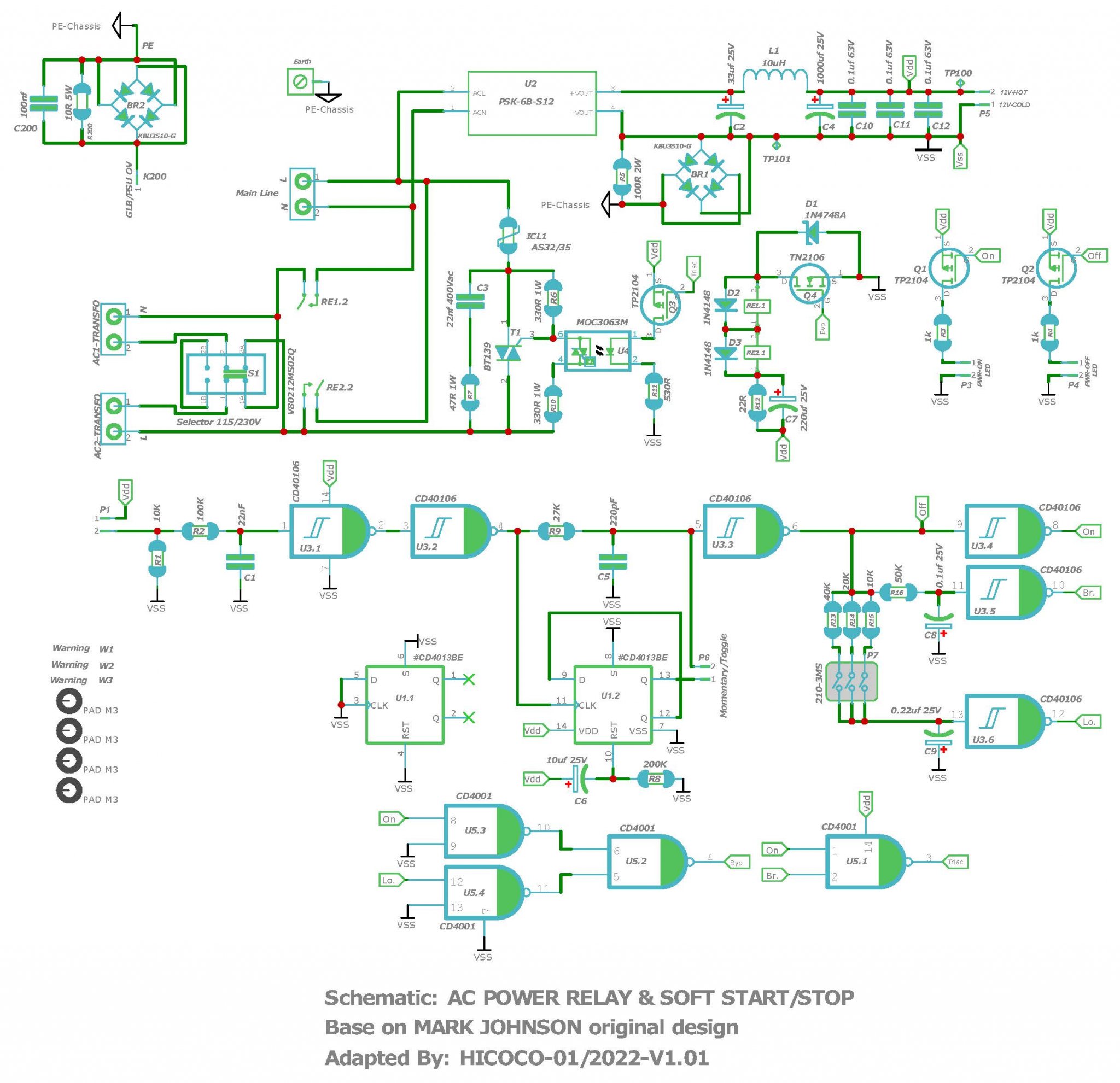

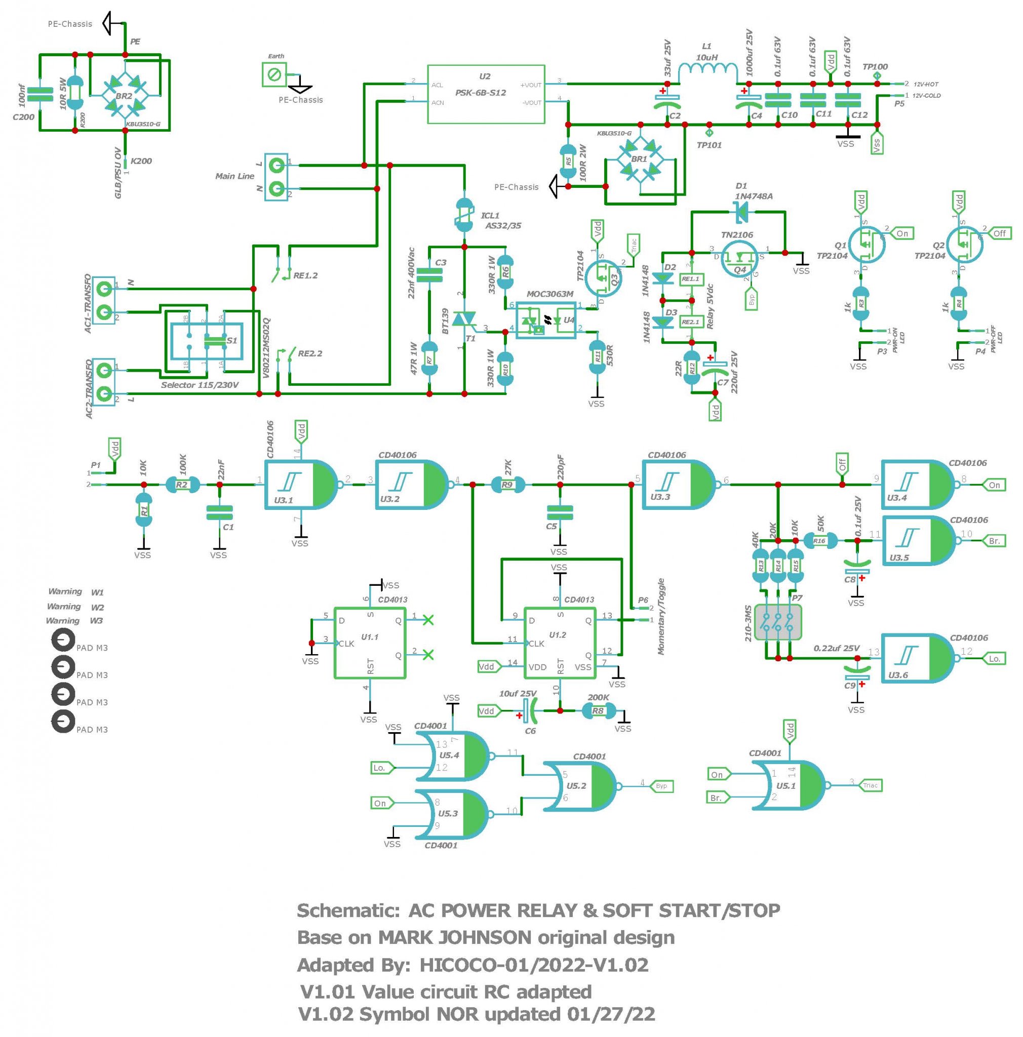

Thank you to Mark for sharing this design, So in the same spirit of customization I've taken this design to made 12V version with 2 relays, with a minor difference.
This is something that I really need to apply to a pair of APEX SR200 with a 625VA transformer.
I also need 12V for this project.
The CD40106 with 12V have a larger Hysteresis Voltage ( ~2,5V with 12V and 0.9V with 5V) so i readapted the R/C circuit to choose one of 3 possible delays (0.5, 1, or 2s). i can also adjust shorter or longer with the selector who have the possibility to have 2 or 3 resistances an parallel, I have to work and test little bit more to adapt better the values.

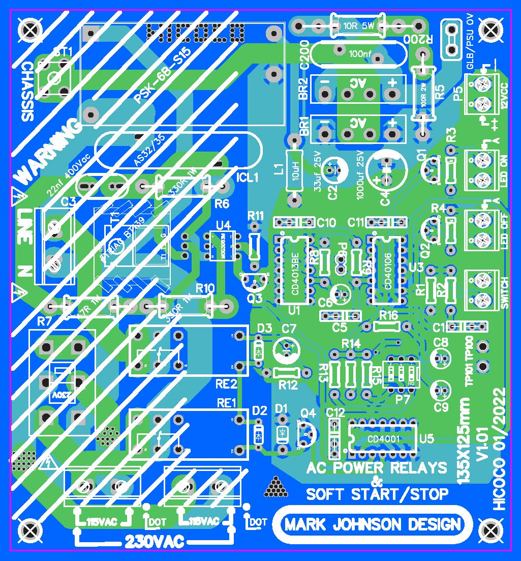

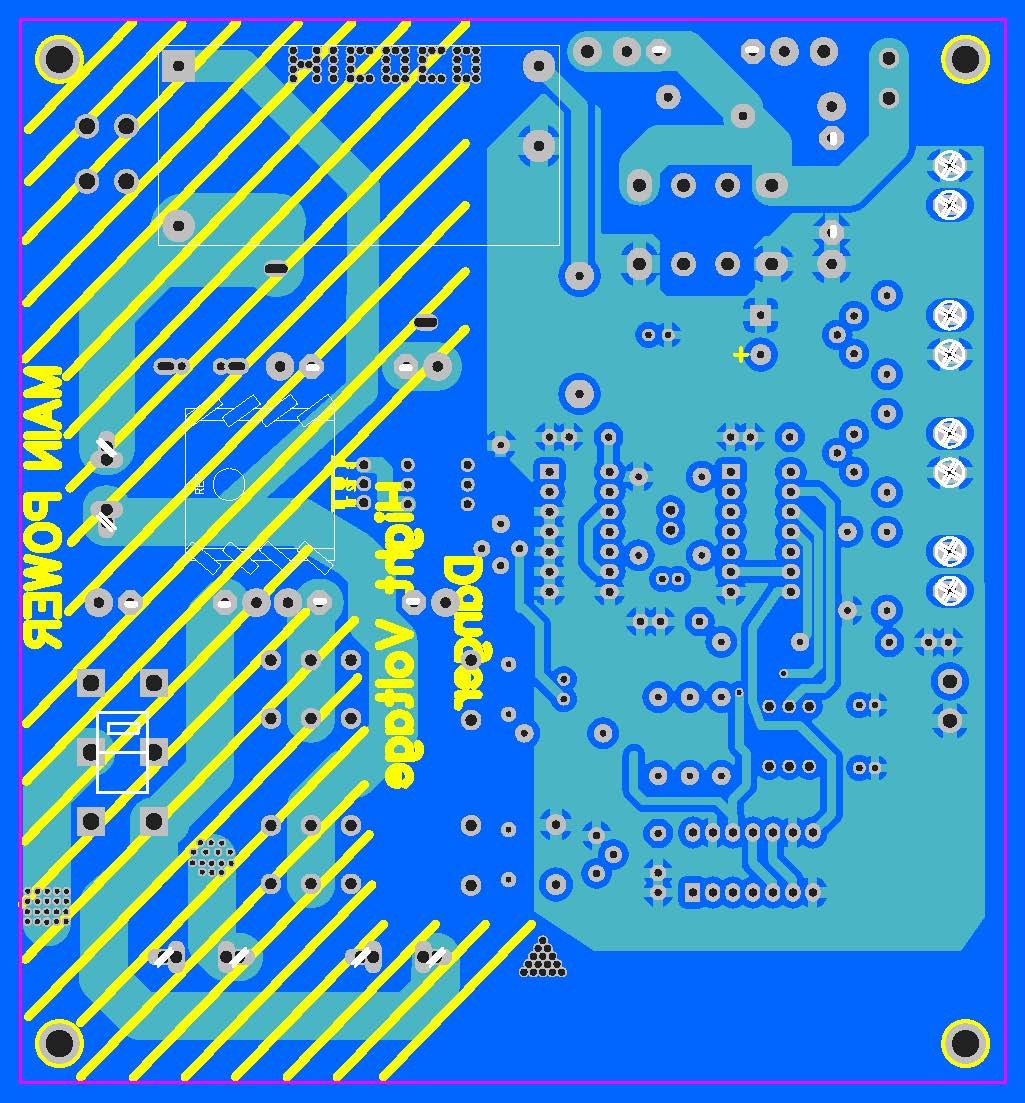

I'd like to get any comments on the PCB design before I send it to be manufactured. I should have spare PCBs if there's any interest in this version, and can share the Gerber files too.
I will do also an other version with 4 layers to double the high voltages tracks on the PCB.

Have you double checked your PCB's minimum "creepage" and "clearance" for 230V mains safety? I'm by no means an expert myself.
For people who are thoroughly familiar with digital design and reading schematics of digital circuits, your incorrect use of "NAND" gate symbols for the CD4001, will be confusing and irritating. CD4001 is a quad NOR gate; drawing it as four NANDs misleads people. Post #1 of this thread shows the standard NOR gate symbol.
Thanks to point me on this mistake i have updated the schematic with the right symbol, i saw also the Triac T1 have a wrong connection ( reversed). Yes i have enough clearance for 230V mains safety, i have 1mm and more .

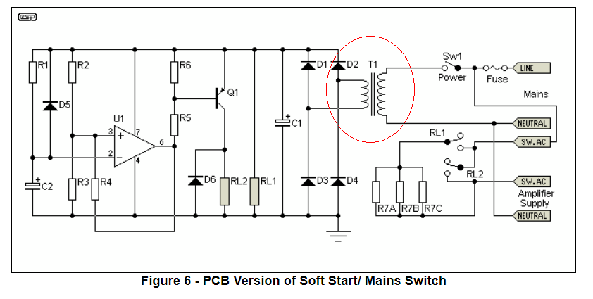

Can we use an auxiliary transformer instead of the AC-DC SMPS module?

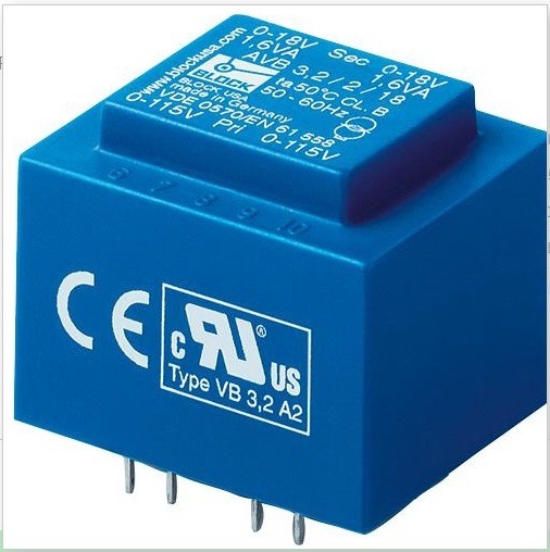

Rod Elliott's (project 39) is a soft start circuit using an auxiliary transformer instead of an AC-to-DC SMPS. Which means: yes, it can be done. You'd have to create a new circuit board and include the diodes, filter capacitors, and transformer. I always liked the looks of those tiny blue cubes made by Block Transformers, maybe one of them might fit into your plans. They're available at Newark but not Mouser or DigiKey.

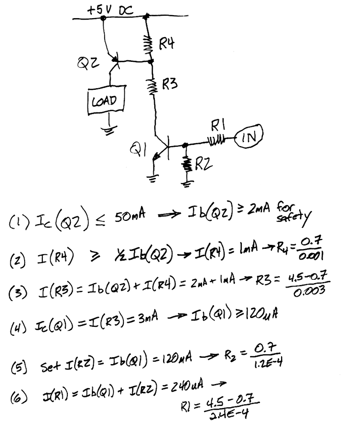

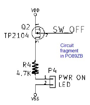

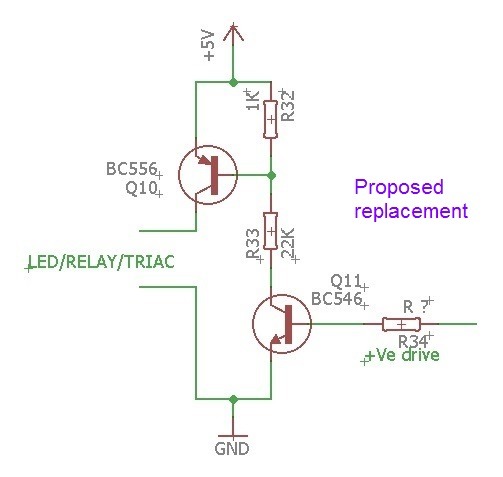

BUILDER REQUEST: HELP ME INVENT A WAY TO OMIT THE PCHANNEL MOSFETS
I received a Private Message from someone who wants to copy the PO89ZB circuitry into a new project, except replace the Pchannel MOSFETs with all-bipolar substitute circuits. Since I believe that ten thousand heads are better than one, and the collective experience and wisdom of the Forum vastly exceeds that of any one member, I am moving that request out of Private Messaging and here into the public Forum. Would anyone like to answer this person's inquiry?
Is the active-high-input BJT circuit, equivalent to the active-low-input PMOS circuit?
If your answer is "No", do you have any improvements you can suggest?
{ start by calculating the base current(s) }
_
Thank you,I think the (R33 / R32) ratio is incorrect and I doubt that the PNP's VBE will be big enough to turn it on. I recommend a thought process similar to that in the attachment.
_
In Eq.no 3, Hope you are assuming a VCE(sat) of Q1 as 0.5V.
