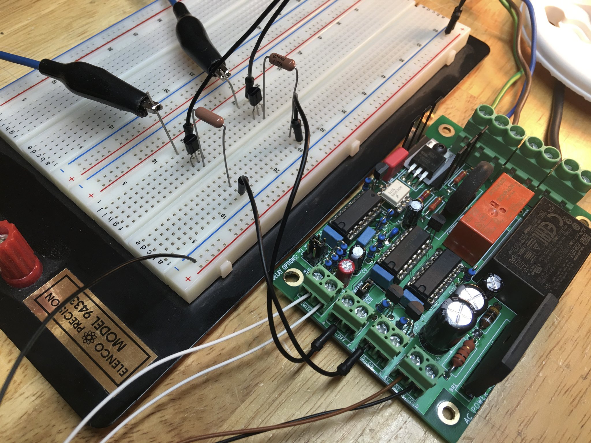

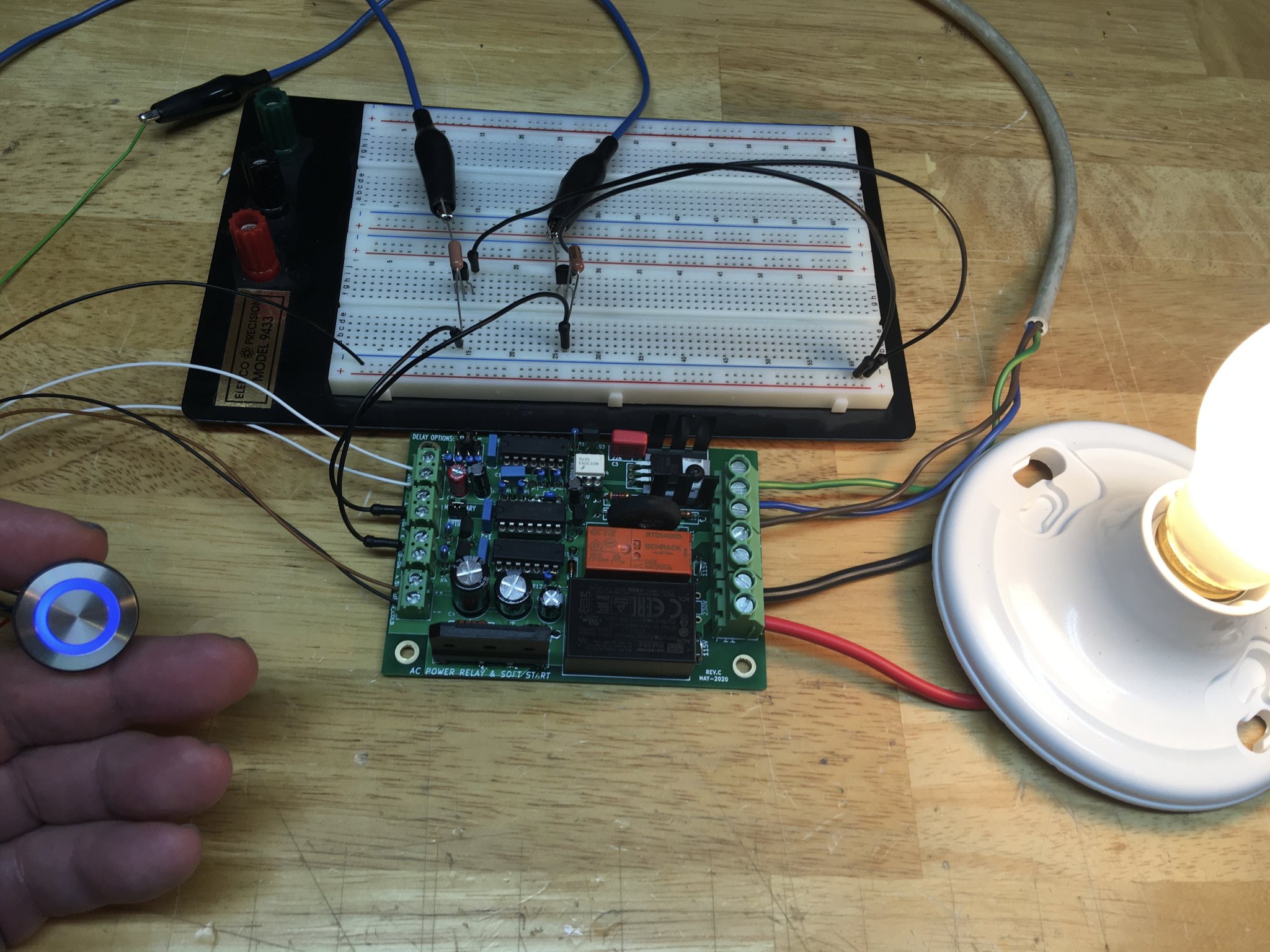

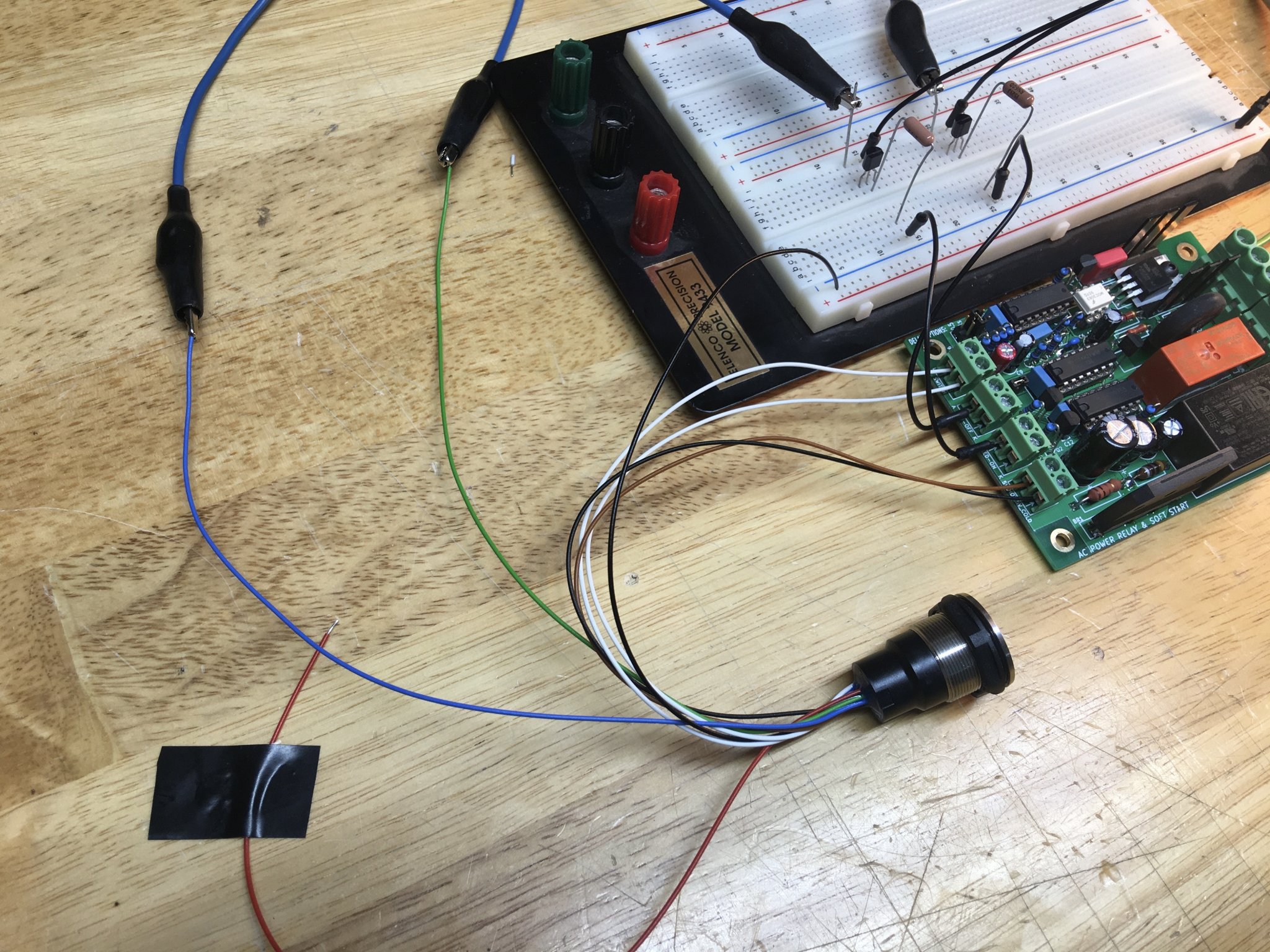

I finally figured out a solution this problem. I had bought a Bulgin capacitive switch with RGB LED's thinking it would be a plug in solution...it wasn't. After a lot of head scratching I eventually figured a way to make it work with the addition of just two NPN transistors and a couple resistors. The transistors are simply used as a switch to connect the LED cathode to ground. When either the "on" or "off" LED output of H9KPXG is hot, it in turn puts a current on the base of the transistor making the emitter and collector a closed circuit to ground. It seems simple to me now, but believe me, it took a ton of reading and experimenting for me to figure this out. I made a drawing of the circuit as best I could.
