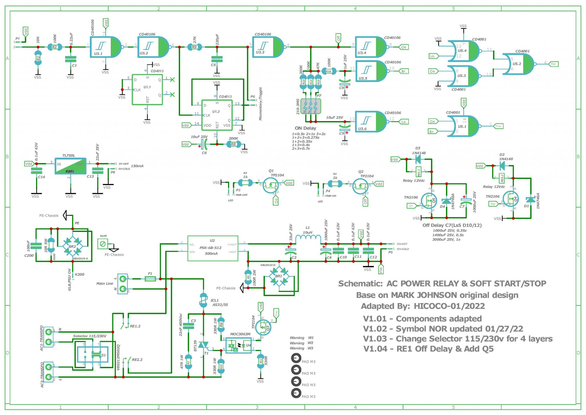

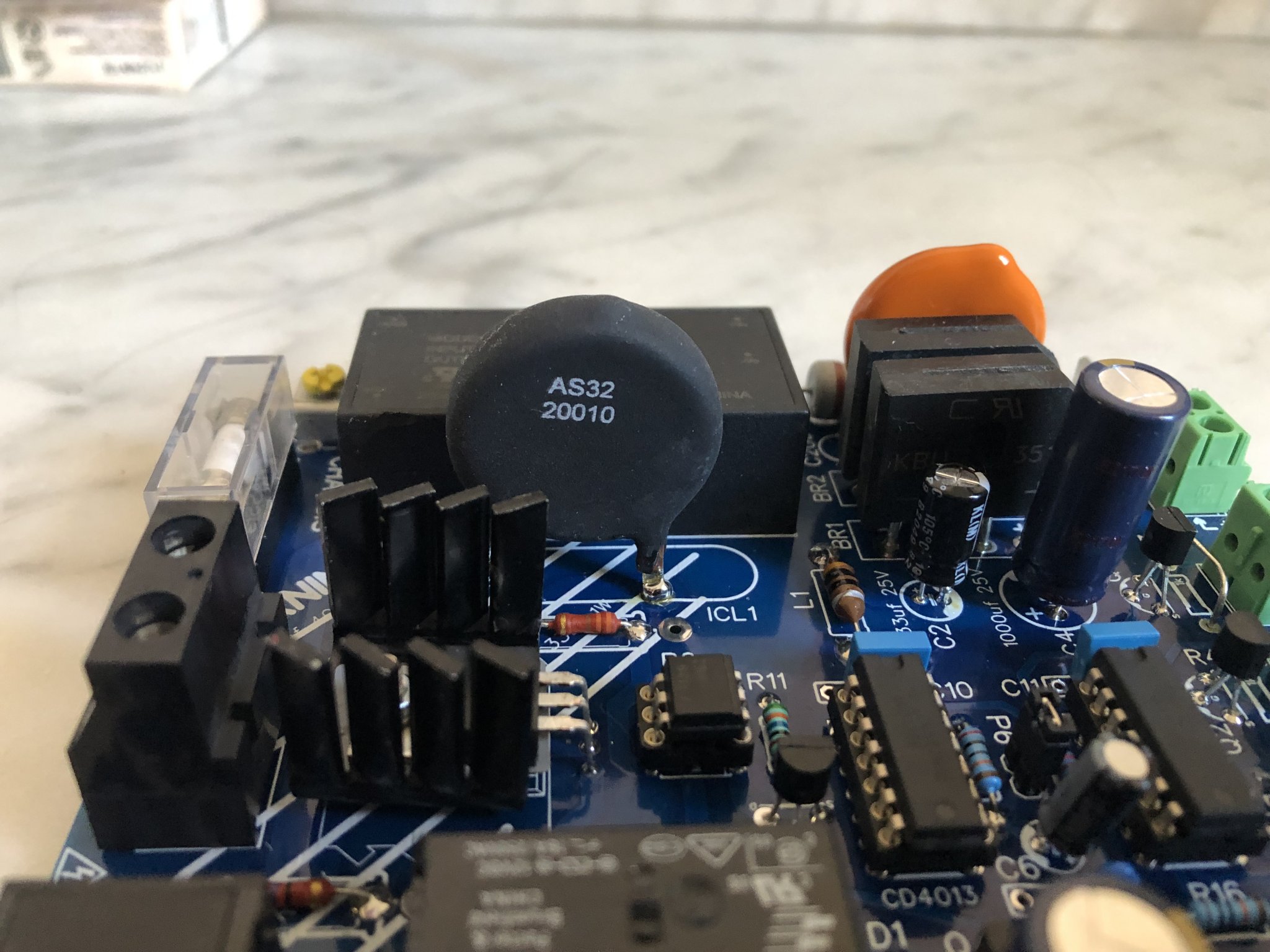

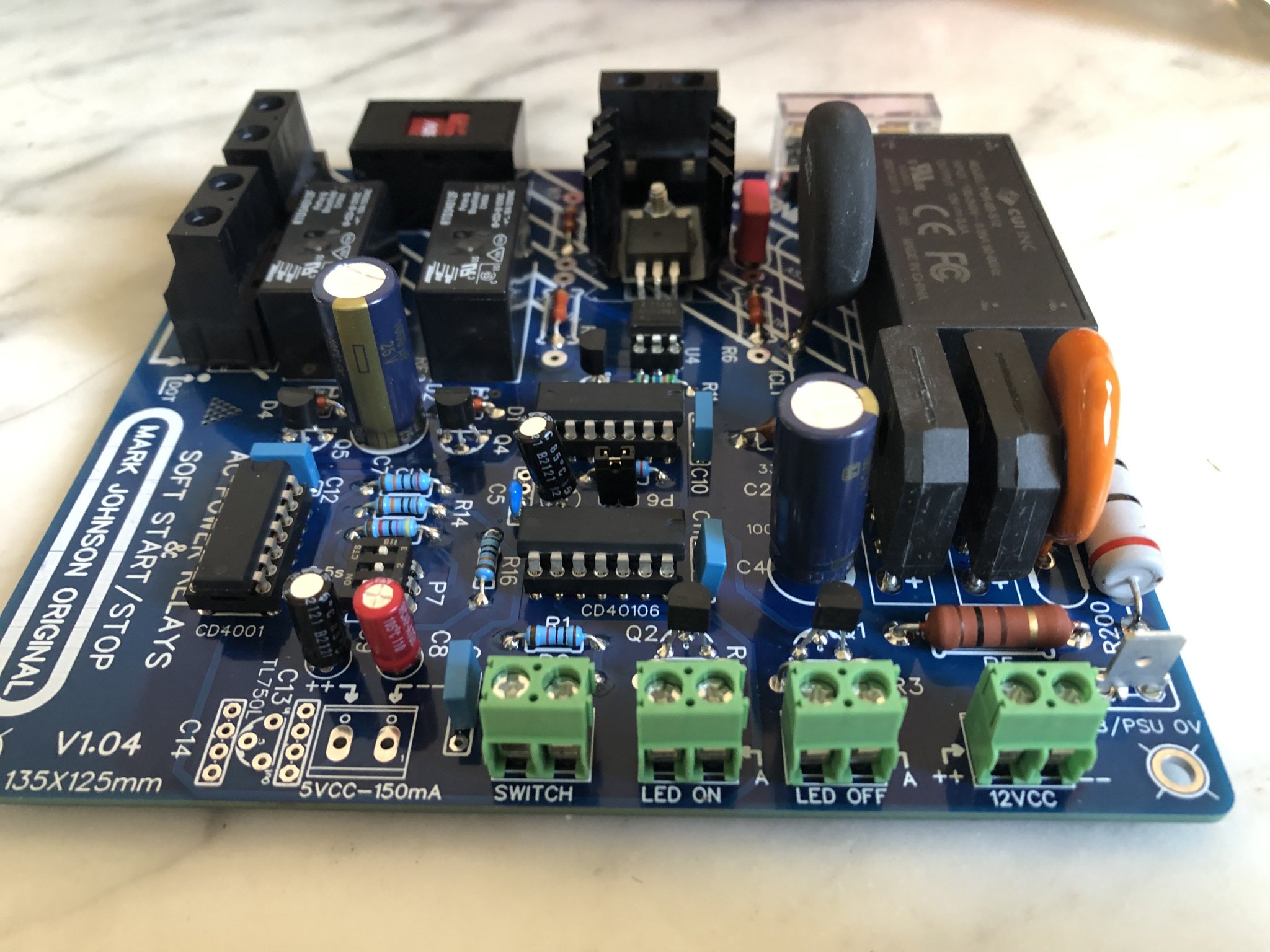

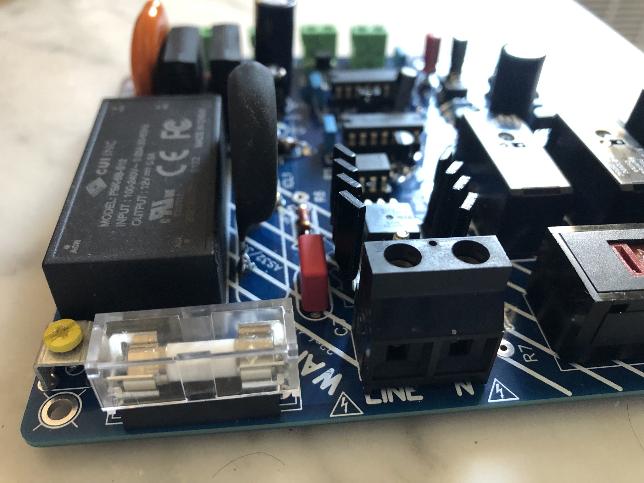

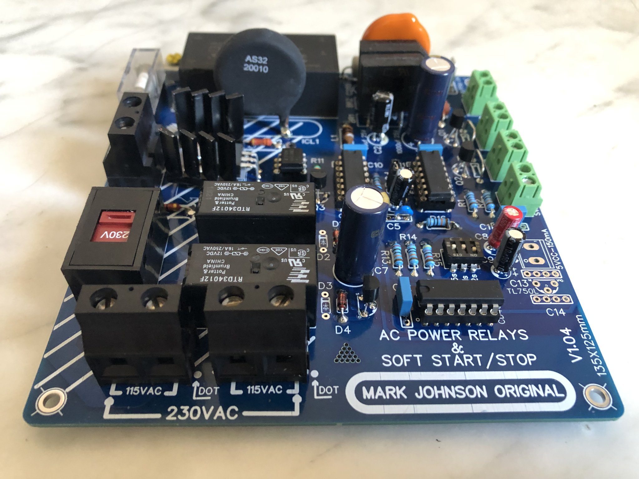

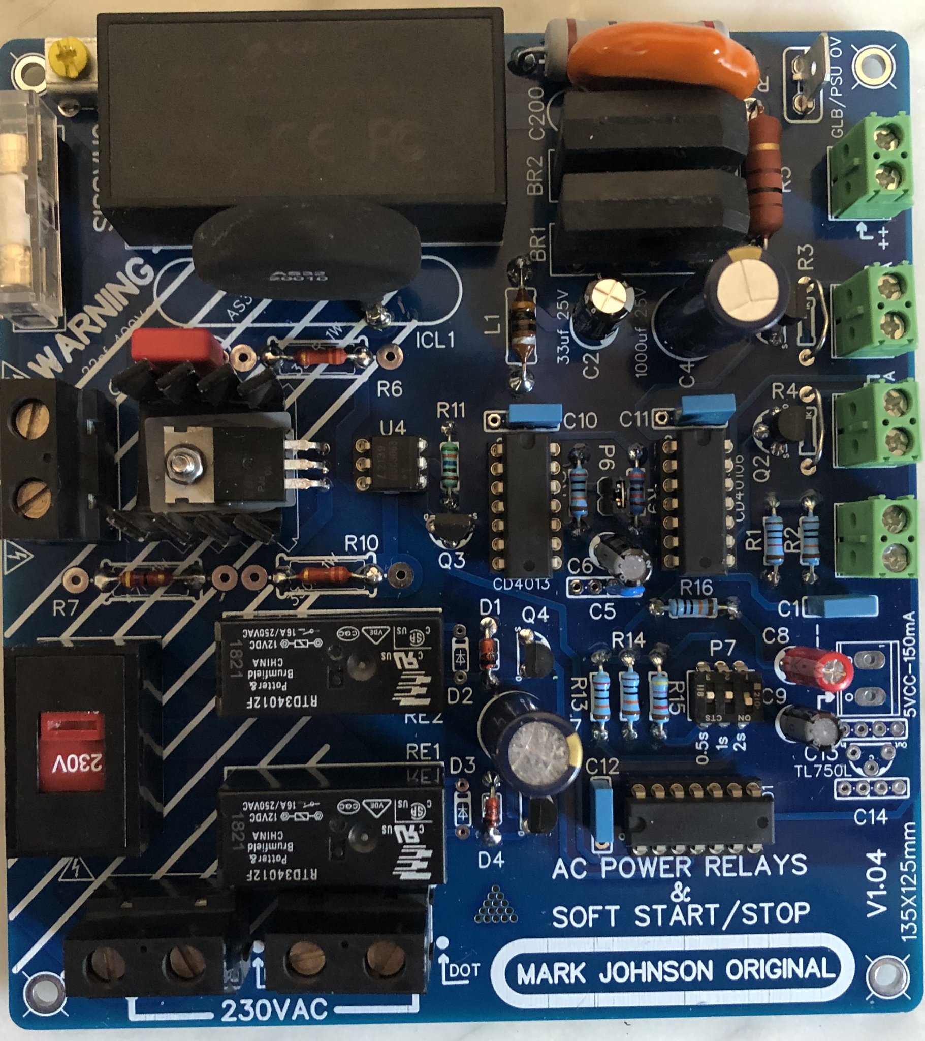

That is the new board to Follow my need and to be conform to EU regulations ( one Main switch and relay contacts in both L and N lines)
In switched off state there will never be any voltage on the primary windings of connected transformers.

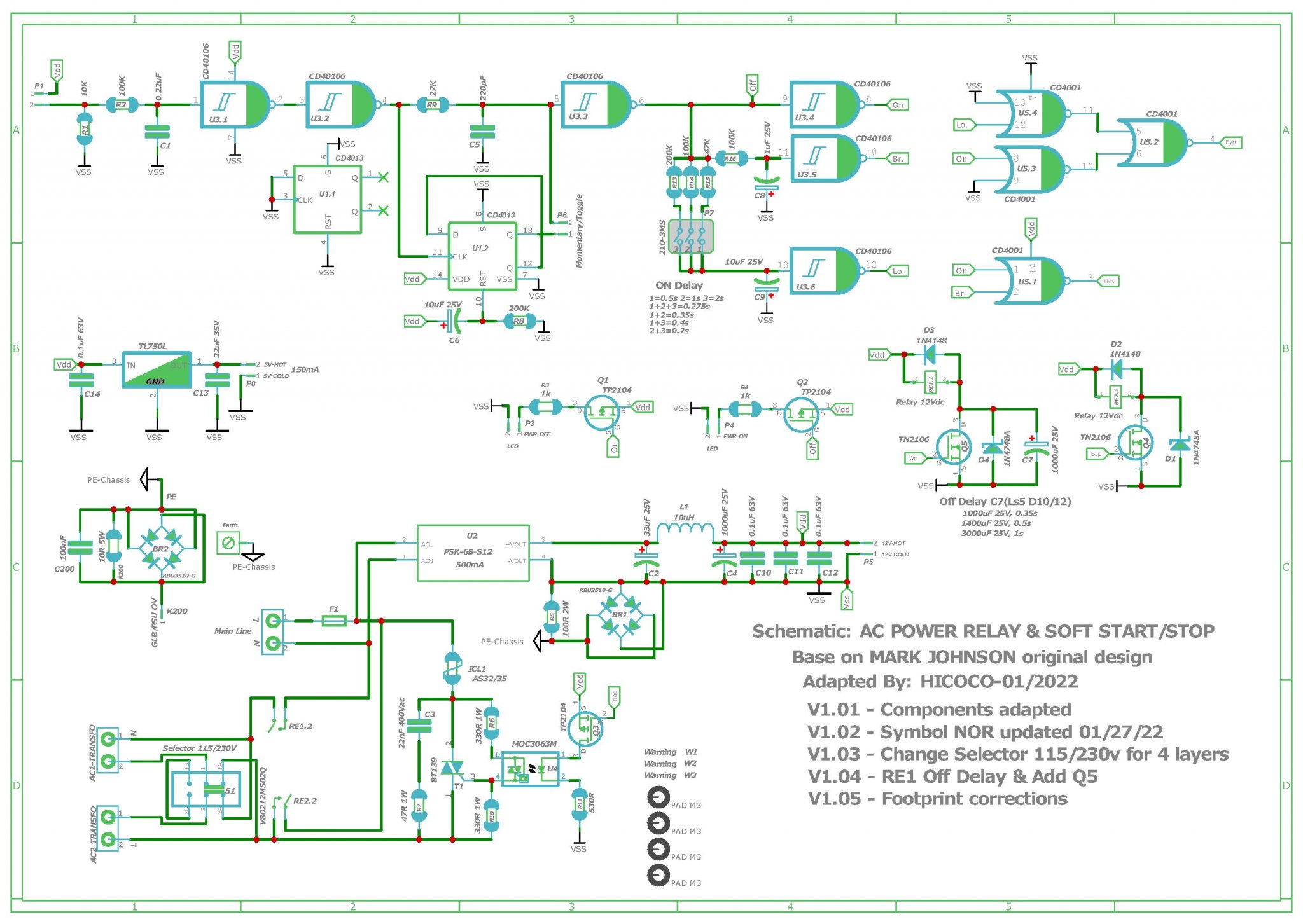

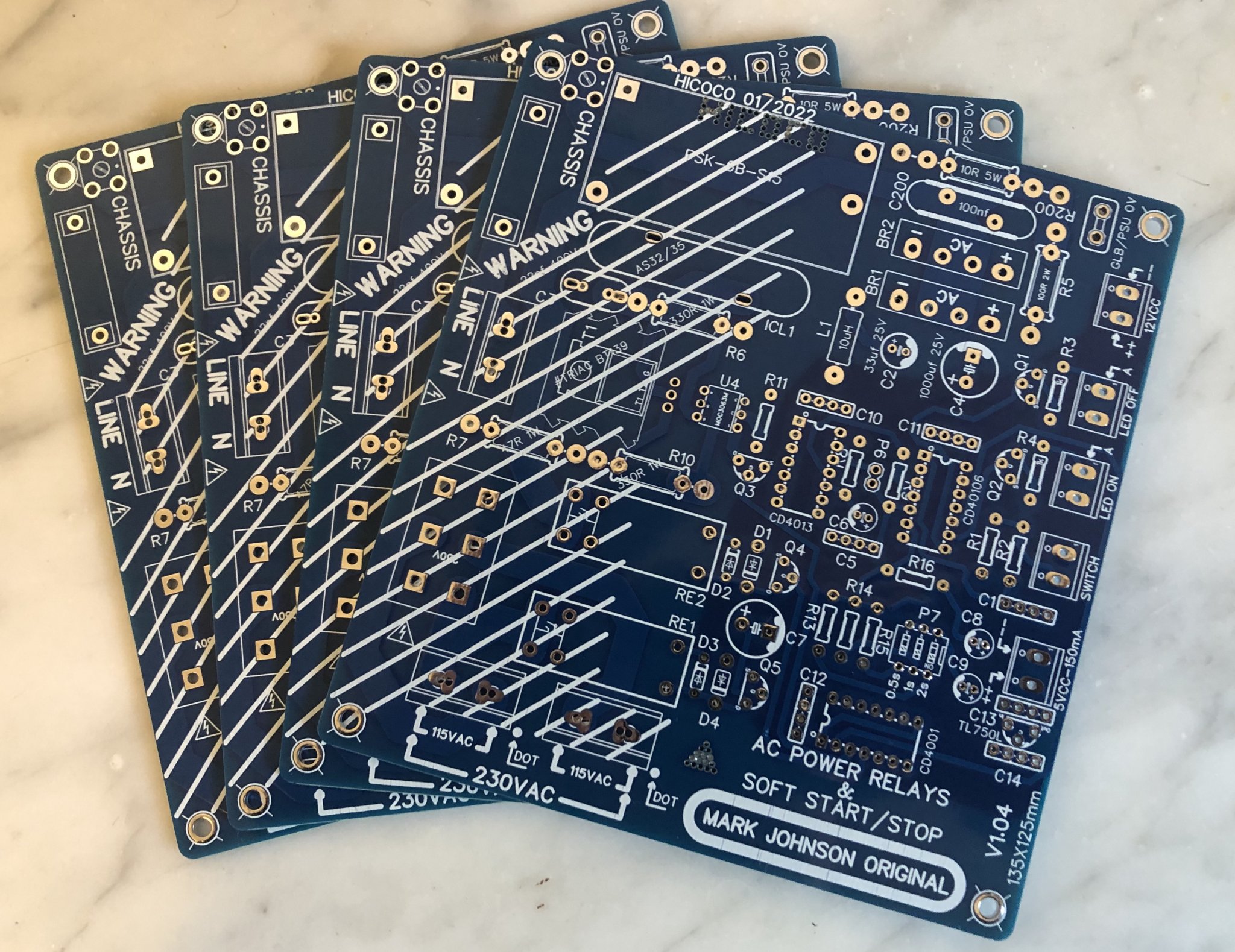

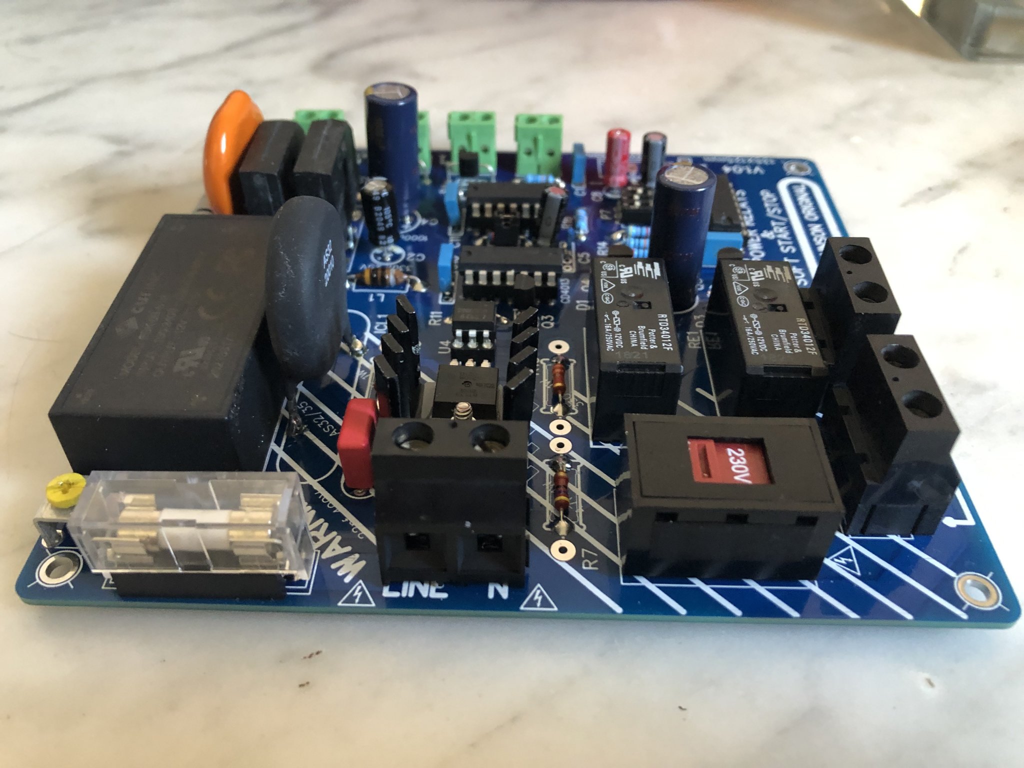

I have finish and tested the Board with 4 layers. The PCB Included a GLB circuit for the AMP PSU, and a +5Volt regulated.
The digital logic are powered from a AC-to-DC converter module.
PSK-6B-S12 From CUI is the one I selected, that is a 12V model, i could also selected MP-LDE06-20B12 from MULTICOM with the same footprint
Congratulations and thank you for making every aspect of your design available to all members!! Very well done.
It's interesting to see that you decided to use relays with 12 volt coils instead of 5V relays as in post #1. I've been having poor success trying to source 12V relays, the ones I'd like are 100% out of stock and backordered for months. Everywhere I look. Maybe 5V relays have become sold out too... For the Tuba high power regulator board, I actually used a relay with 24VDC coil, but that board has no CD4000 logic chips (VDDmax = 15V).

Couple time i lost the power and when the power went back ON, i had noticed that the fuse blow each time.
Recently I simulated the power cut and for couple of ms (hard to say for how long, that is very short time) the relays are switched on and off.
I plan to design a little Add-On close to the output connectors with a on-delay for 1ms or 2ms directly connected to the AC/DC power module output. May be you have a better idea?

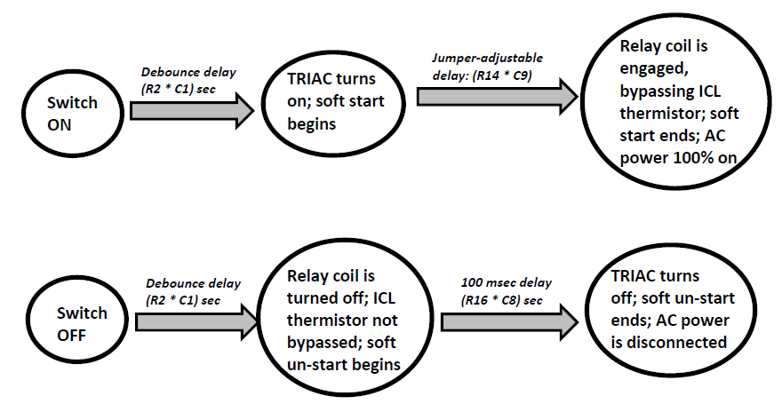

I think you might want to redesign the digital logic section of your board. You'll have two more state transition diagrams besides the two shown in post #1 of this thread and copied below.
One of the new state transition diagrams begins with "Mains power is lost while front panel switch is ON", and shows the sequencing you need your redesigned circuit to perform, in order to avoid blown fuses. Another new diagram begins with "Mains power is restored while front panel switch is ON" and shows your sequencing for the redesigned circuit, which prevents fuse blowing.
Remember that the +5V housekeeping power supply doesn't function when there is no mains power. It's an AC-to-DC converter and when the AC is absent, so is the DC.

I forgot to mention that I use a momentary switch, when the power is restored the audio equipment stay OFF, I have to turn the audio equipment back ON using the low voltage momentary switch.
I understood well that the +5V (+12V for my board) housekeeping power supply doesn't function when there is no mains power.
I believe also that happened to other builder..now i am not sure if the fuse blow.
I also updated the design with a On-delay of 1ms at the first time mains power ON and when the power is restored after been lost.
I don't see much option for the others boards already build, that of add an mains power on-delay with a new small board.
