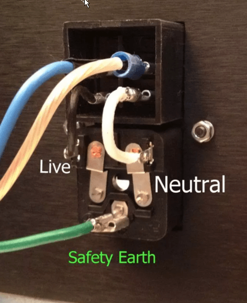

Perhaps use your DMM set to continuity and see if both fuses are required.
The picture is a bit challenging, but I concur with 6L6. You almost certainly have your IEC / switch wired incorrectly. Once again, a DMM set to continuity will confirm.
If you are unsure... here is how to check...
With no mains power connected...
Plug your power cord into the IEC. You should know which pins are live, neutral and ground. If you don't, stop, and look it up.
Remove all your wiring on the "back" side of your IEC / Switch.
Put one DMM probe onto each pin of your power cord.
Ensure a proper physically-sized fuse with continuity is placed into each of the slots.
Trace each power cord pin to where it transfers into the "back" side of your IEC. Mark each of those points using your choice of indicator on the back of the IEC. Confirm with a continuity check to each pin on your power cord. You should now have a ground, live, and neutral marked.
Remove fuses one at a time, and see if the continuity maintains to each of those points. That should answer your question.
Now to see if your switch was wired correctly...
Check which pins on the IEC / switch have continuity with each other. Flip the switch and see if that changes. Note that the intended switched output are the "top". You have already marked where the power comes in.
If you want to carry the current from the 'bottom', un-switched section to the 'top', switched section... while maintaining the relative left to right orientation of the live and neutral, where would you put the jumpers?
Install your jumpers. Check that you were correct by flipping the switch on and off. With the switch "on" do you now have continuity between the bottom section and the top section for your live and neutral? If so, mark them accordingly.
Install your "output" live and neutral into the top positions ensuring relative orientation of live and neutral. Your continuity checks between all pins have revealed that there are options, but one is certainly "cleaner" than another for your wire routing. I like 6L6's example in your pictures.
Check that you have continuity all the way from the pins of your power cord all the way to your intended live and neutral points as they enter the first functional circuit in your amplifier.
If so, reinstall your ground and check for continuity to all points where you intend to have chassis / mains earth ground.
If you do not, you may have a bad IEC / switch and/or additional trouble shooting is needed.
Note - you stated that you applied power before doing something like this to ensure you had it wired correctly. I'd avoid that practice in the future. You got somewhat lucky. Messing with mains power w/o a fundamental understanding is SCARY (to me).

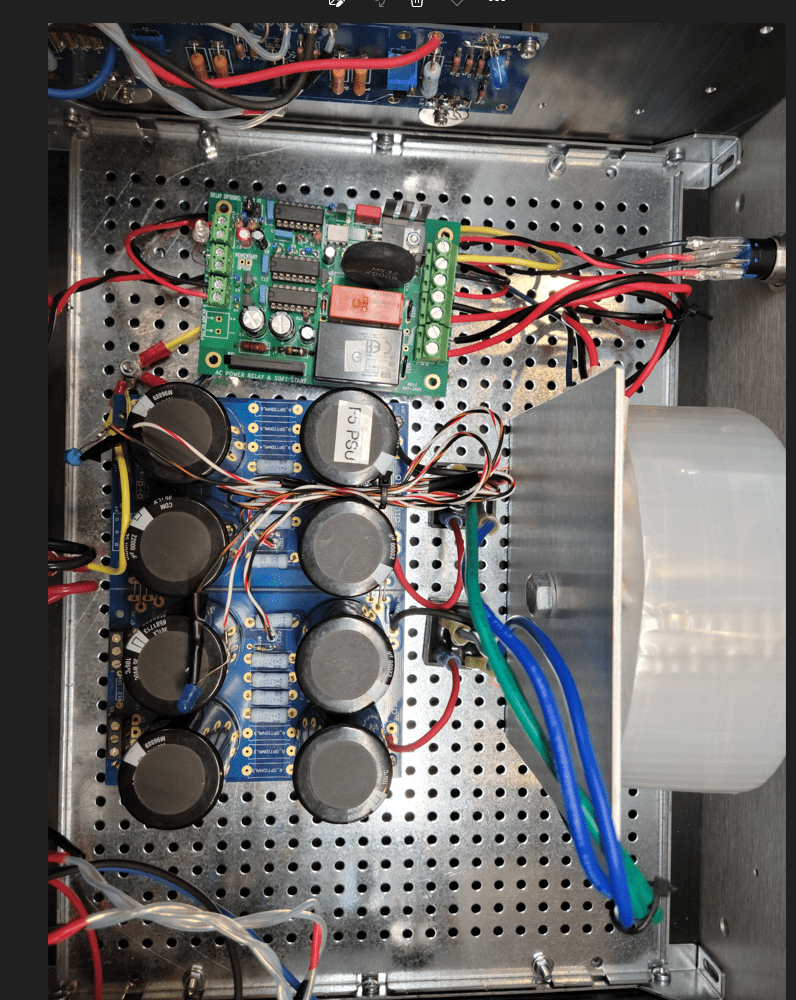

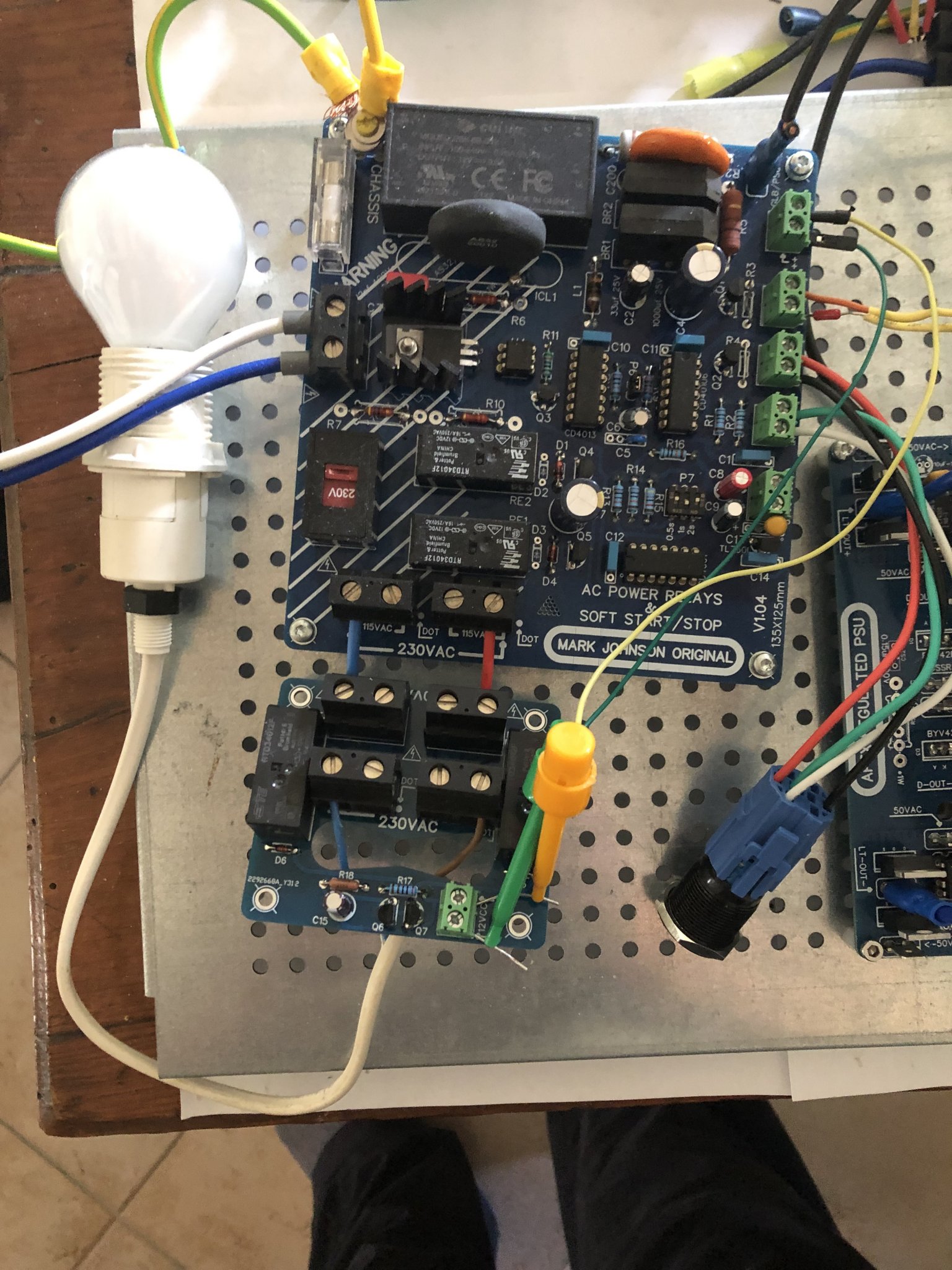

Ok. I've got a diyaudio IEC installed wired per the guide as attached.
When I turn the IEC on in back, the LED light on the slow start board lights up. But when I push the on button in the front panel on, I don't hear the click and I only measure 2-3 VDC. This holds true for 4 scenarios:
I have two different slow start boards and two different PSU board. I get the same results across all four of them.
I'm missing something very basic here, but I'm not seeing it.
Appreciate any comments.

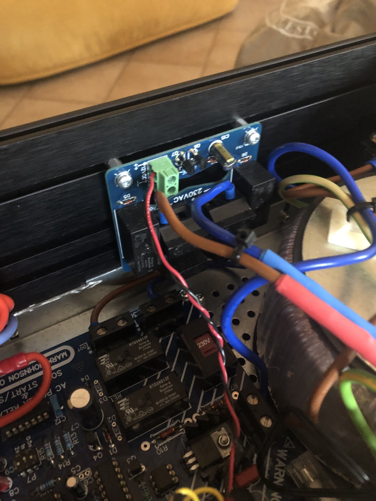

The mains inlet switch is ON at all times, and I turn the audio equipment on and off using the low voltage front panel switch.
Couple time i lost the power and when the power went back ON, i had noticed that the fuse blow each time.
Recently I simulated the power cut and for couple of ms (hard to say for how long, that is very short time) the relays are switched on and off.
I plan to design a little Add-On close to the output connectors with a on-delay for 1ms or 2ms directly connected to the AC/DC power module output. May be you have a better idea?

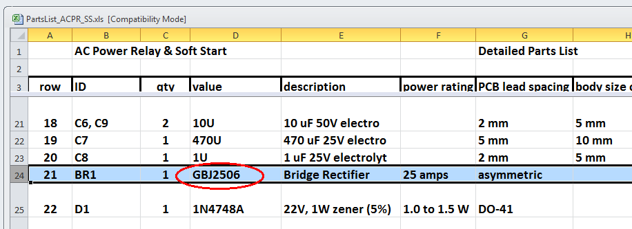

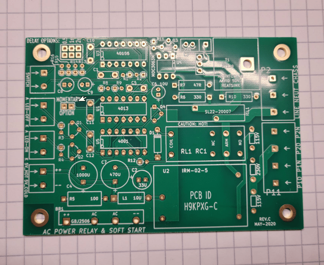

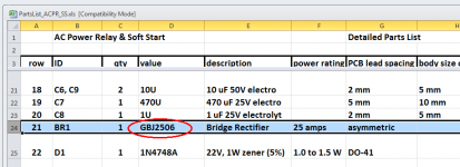

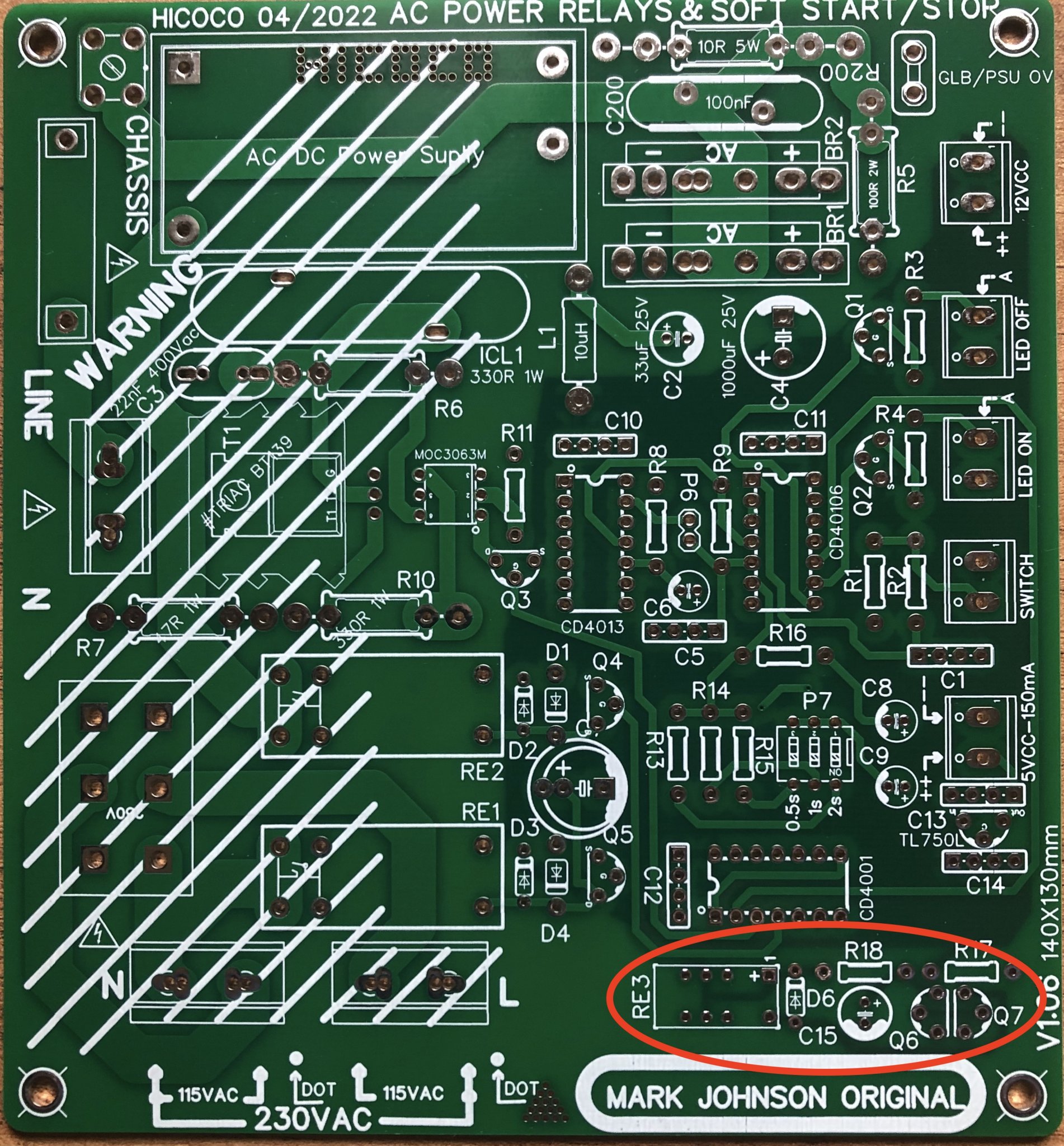

This PCB (id = H9KPXG) is designed to use a GBJ2506 bridge rectifier, as shown in the Detailed Parts List attached to post #1 of this thread (see image 1 below). This particular component is in the "GBJ" package, sometimes written "GBJ-4", and that's what the H9KPXG circuit board is designed to accept.
Because the circuit externally connects the bridge in such a way that its diodes are wired back-to-back, the datasheet reverse voltage rating is not terribly important. Diodes within the bridge will turn on whenever the external voltage exceeds +2V (or -2V) so even a 50V rated bridge is sufficient. I only specified the 600V model ( GBJ2506 ) because it had huge numbers of parts in stock when I built the prototype, in April of 2020.
Since the purpose of this bridge is to protect the user when a certain type of AC mains fault occurs, the bridge's current rating should exceed the home circuit breaker / fuse's rating. I picked 25 amperes . . . but there are some 50 amp bridges in stock today in the GBJ-4 package, at mouser.com. In the US where houses have 15 amp circuit breakers, any bridge rated for 16A or greater, would offer good protection. And 50 is certainly greater than 16.
