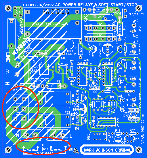

Ok. Maybe I’m having the issue because I don’t have a full load. I just have Soft start->transformer->diode bridge.

This is what your experiencing, "Phantom Voltage" and it was discussed very early in this thread.Not sure if this has been answered, so excuse me for asking again if it has. I am testing a board I acquired and almost done populating a second for a pair of F4 amps I am building. I got the switch led on and off working correctly, but I noticed the soft start is still allowing voltage to the primaries after being switched off.
Any help is appreciated
page-4, specifically post#65
Use Hicoco's version in post #613 aboveI was testing it, it does appear to work but I thought it would turn off ALL voltage when switched off but I still see voltage when the unit is turned off (4 Volts DC) after the diode bridged and 30 VAC at the primaries.
I have the original boards. Are there adjustments I should make or are you saying I should get his boards?Use Hicoco's version in post #613 above
