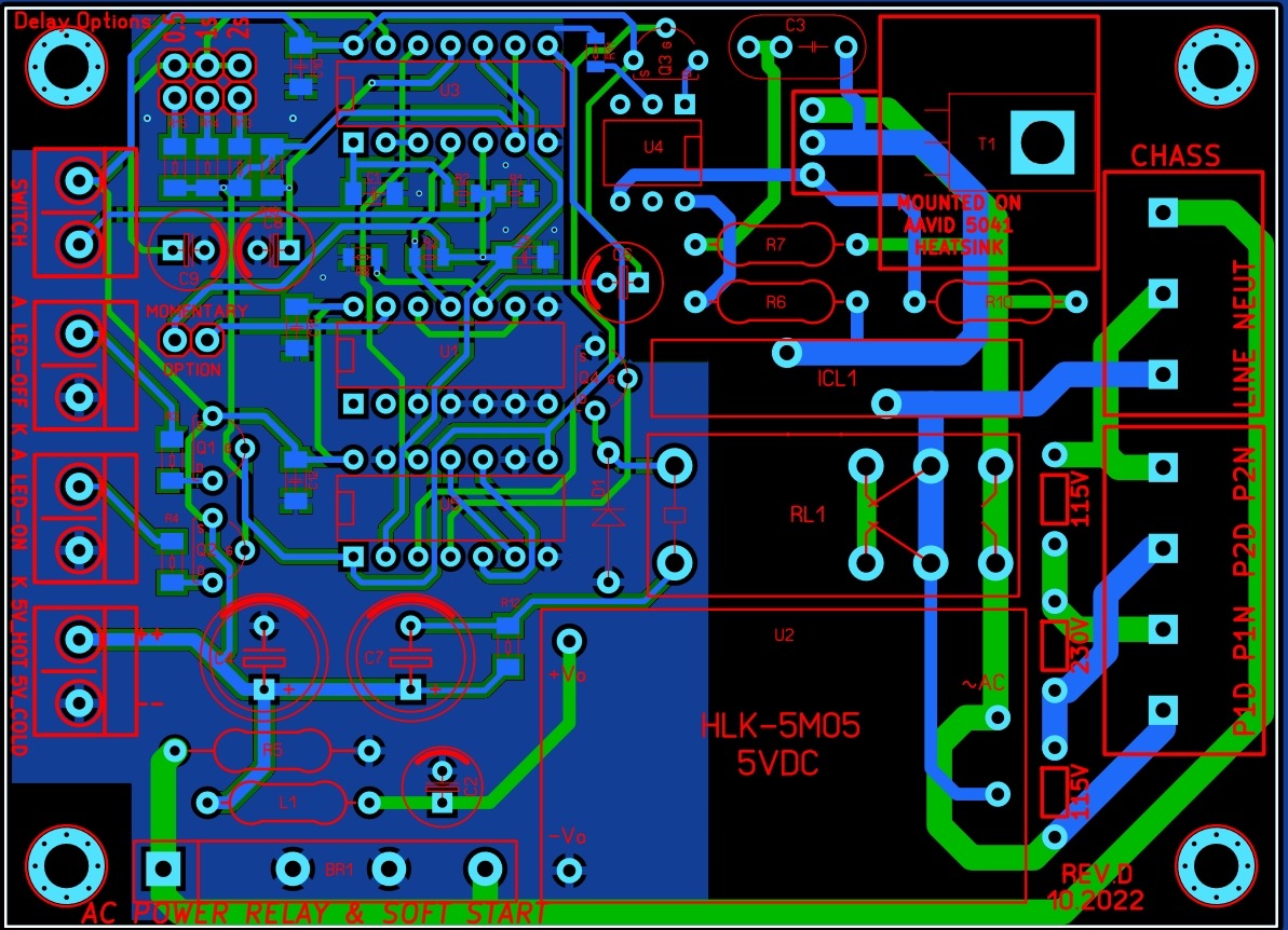

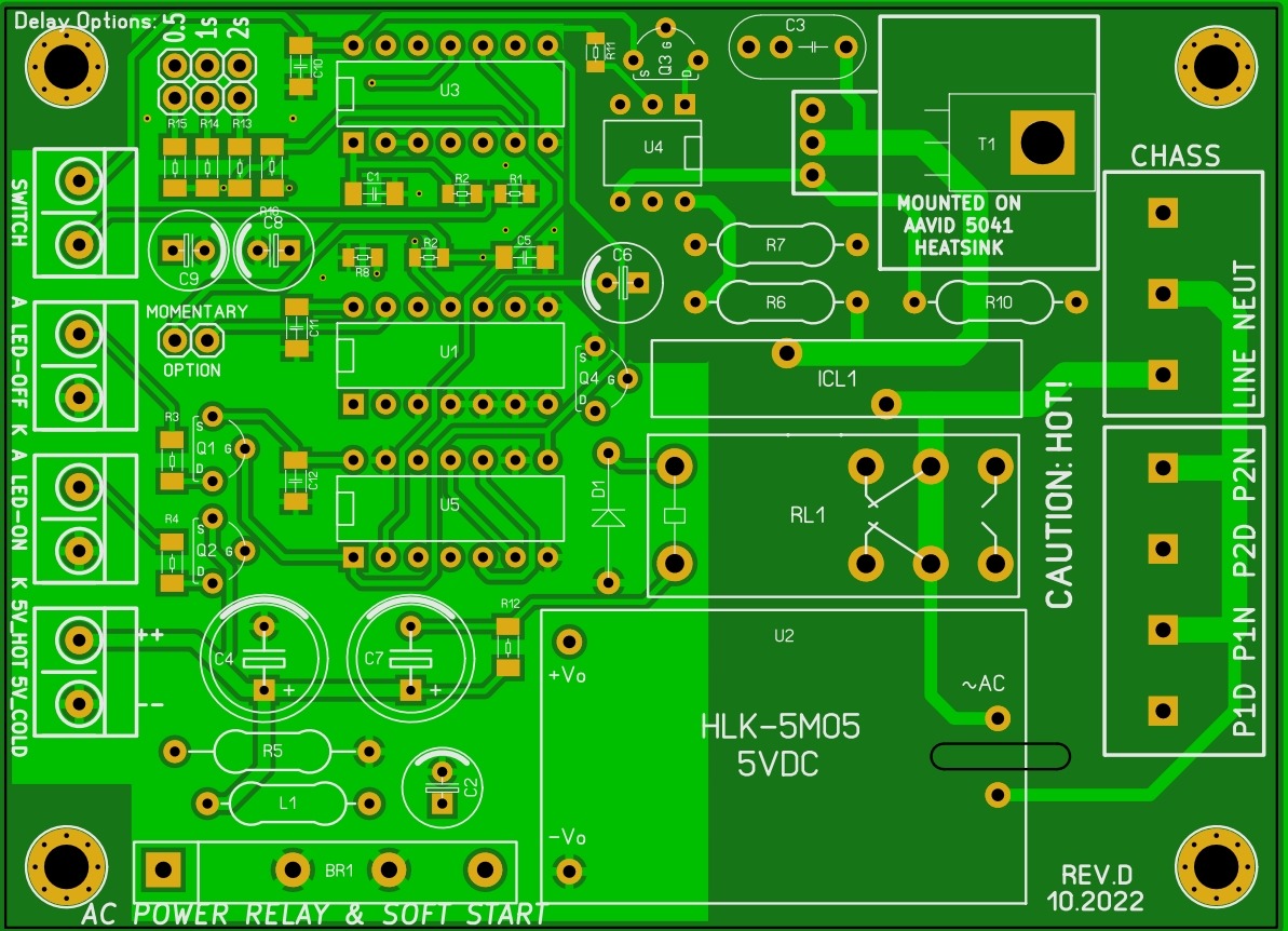

Looks like you've eliminated the user options to connect the transformer primaries either in series (230VAC) or in parallel (115VAC). Also looks like you've changed to a different AC-to-DC converter device, and as you noted, converted some thru-hole resistors & capacitors to surface mount.

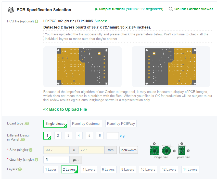

Checked, only 2 layers.
https://www.pcbway.com/project/shar...mains_relay_includes_soft_start_2e05ee9f.html
If you do not have the opportunity to order printed circuit boards on PCBway, I can share gerbers here no earlier than a month later.

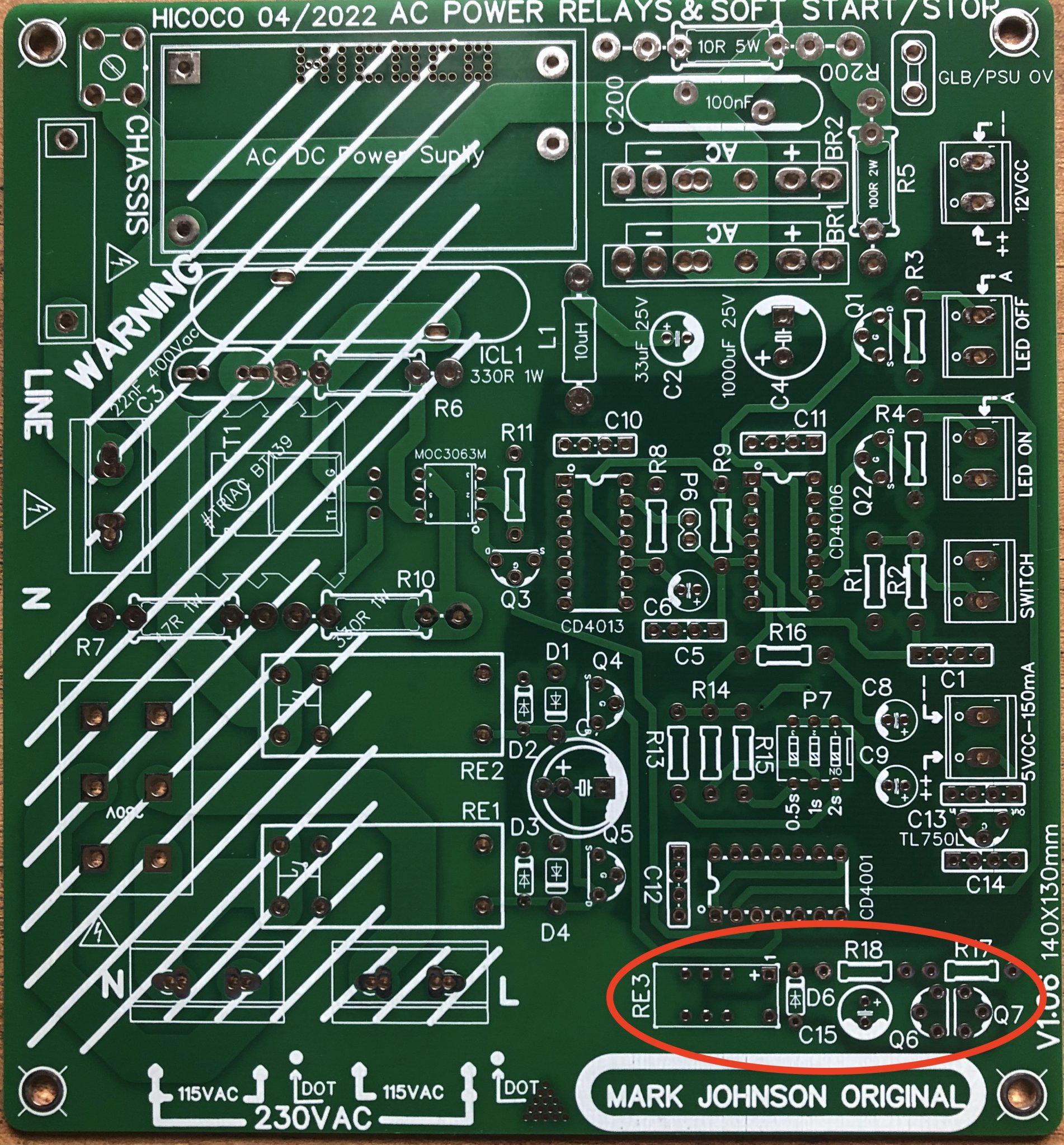

If you are in the EU, you should check out post #550.I got used to that I have 230V AC in my network. The converter used more affordable, IRM-02-05 did not find on sale.
Hi Hicoco, could you please post the gerber for your improved v1.06 board and maybe an update on Q6, Q7, C15, R17, R18 values.Yes with something very simple (I do not lost the power often), i just added a little output circuit with on-delay when the power come back. I also designed a new board with this function (red oval circle).View attachment 1093398
