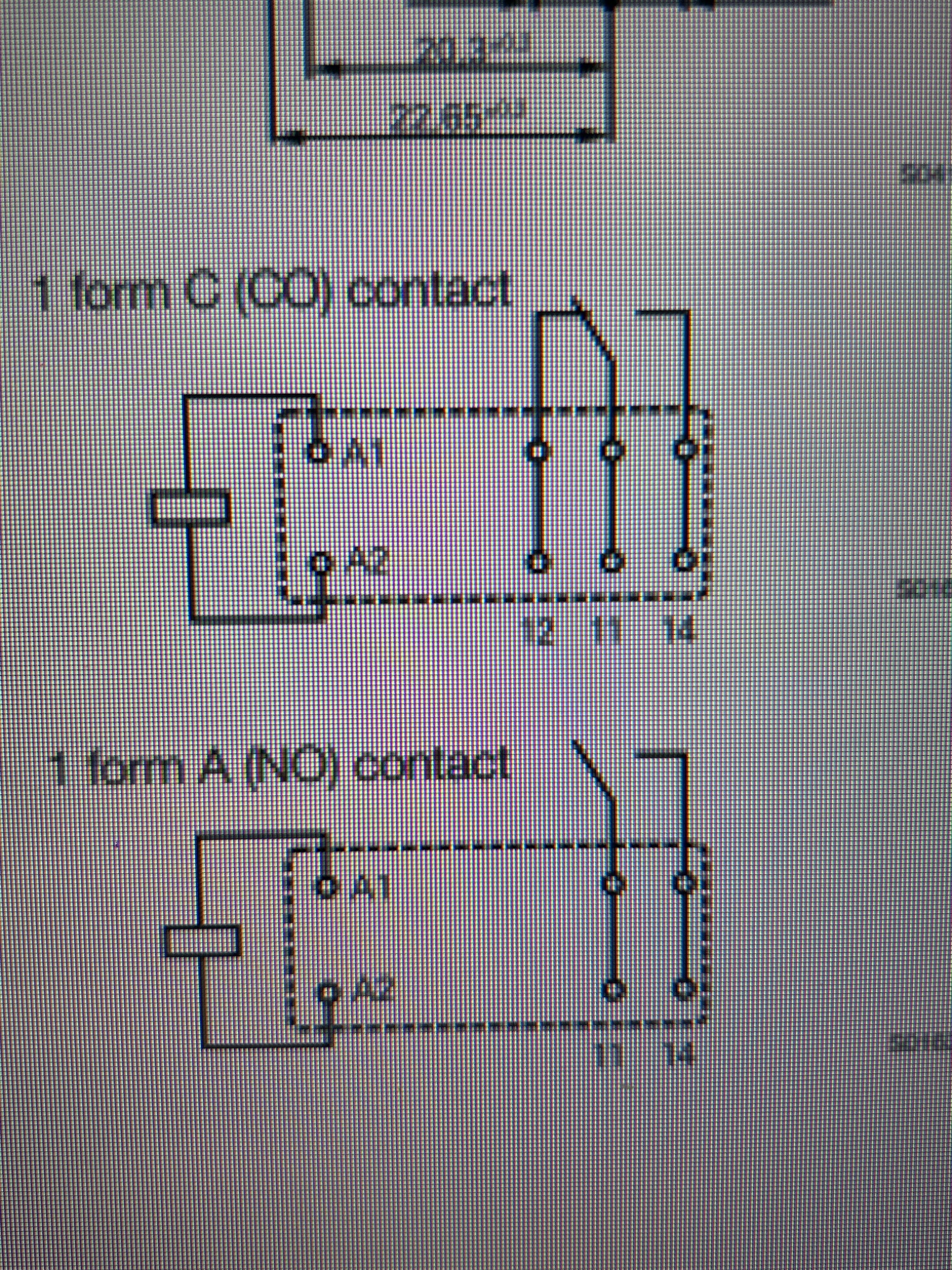

I pulled the thermistor on one of them and each time I check it it ranges from 28 to 35 ohms instead of the 20 ohms it’s rated for at cold temp.
I also pulled the relay and it seems to be reading correctly. Pins 11 and 14 are open.

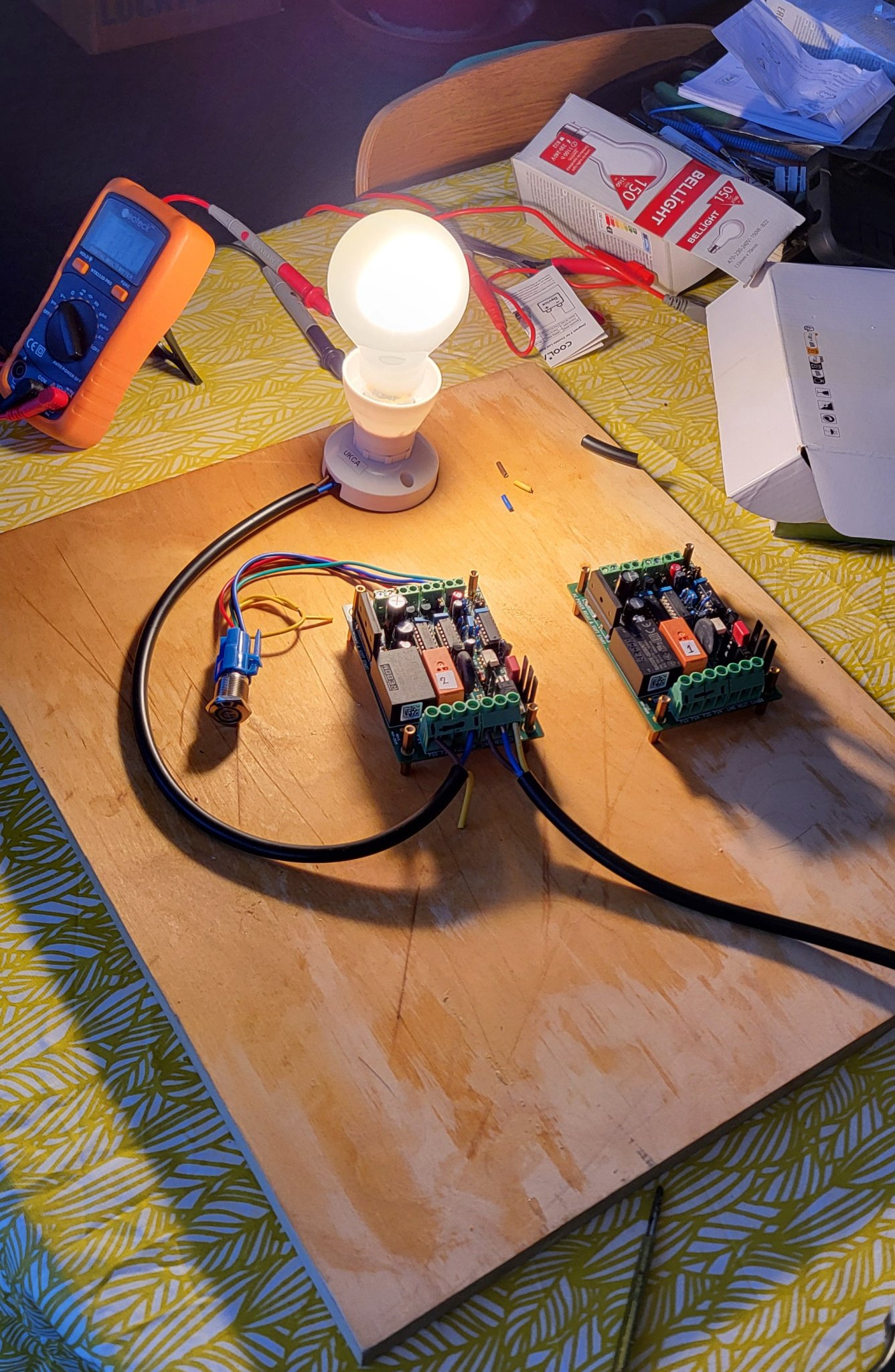

Ok. Here is where I stand on the board and I’m now thinking the board works as intended but my expectations were too high because one of my boards does operate differently.
I bought a 150w incandescent bulb and tried it on the board. The light turns on about 80%, then when the relay clicks on it is at its brightest.

NVM. I am reading from earlier threads that the bulb should dim first, then brighten, and when the relay clicks it turns completely on.
With my testing, the bulb turns on quickly to 80% brightness, then when the relay clicks it goes fully bright.

This is good!
So you know that the soft-start is working properly... The current limiter is being switched in at start, hence the dim, then after X time, the limiter is switched out and the bulb can go bright as the current is no longer being strangled by the triac.
